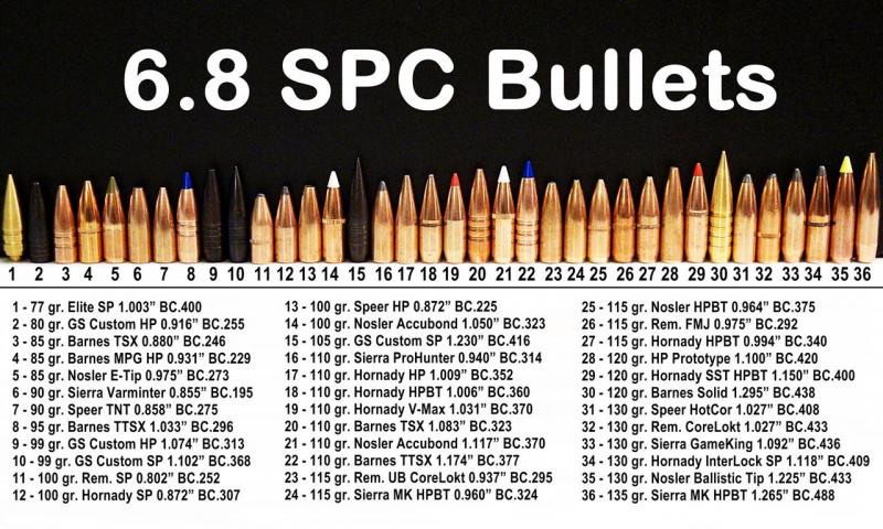

Most consider the bullets below as the usable 6.8 bullets. Not shown are the
90gr Gold Dot
90gr Fusion
115gr Fusion
90gr Nosler bonded
Hornady 100gr GMX
105gr Cavity Back
120gr Cavity Back
110gr S&B PTS
130 Berger Classic hunter
Out of the bullets shown #s 1, 10, 15, 24, 26, 30, 35 and 36 will not expand properly. Most bullets 130gr+ are not used in the 6.8.

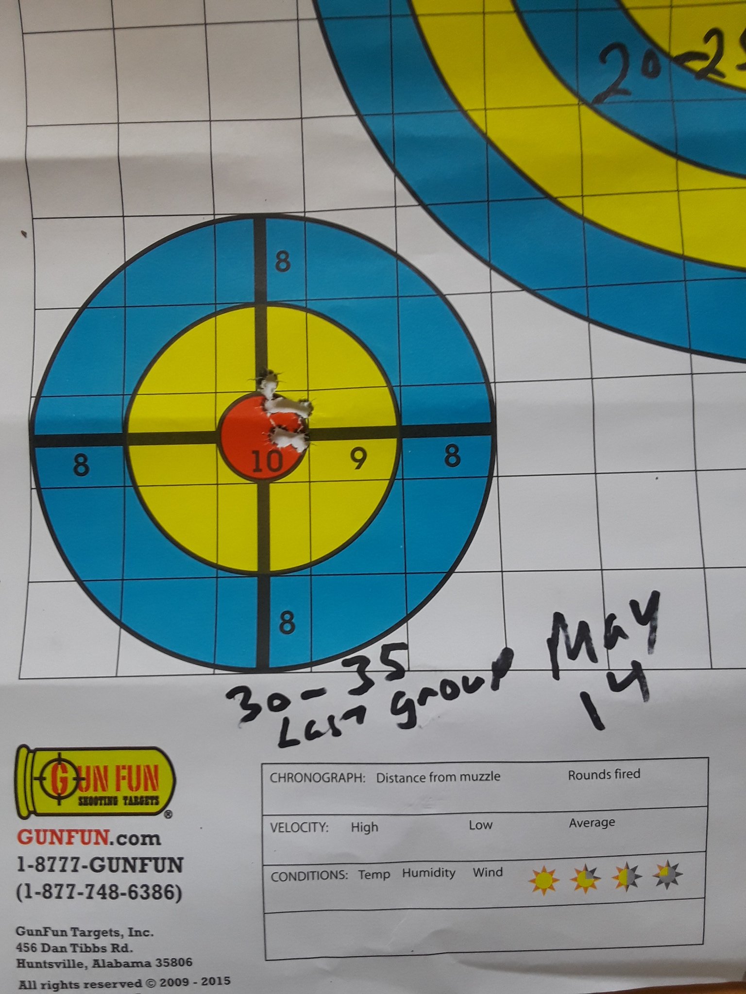

Todays grendel range report.

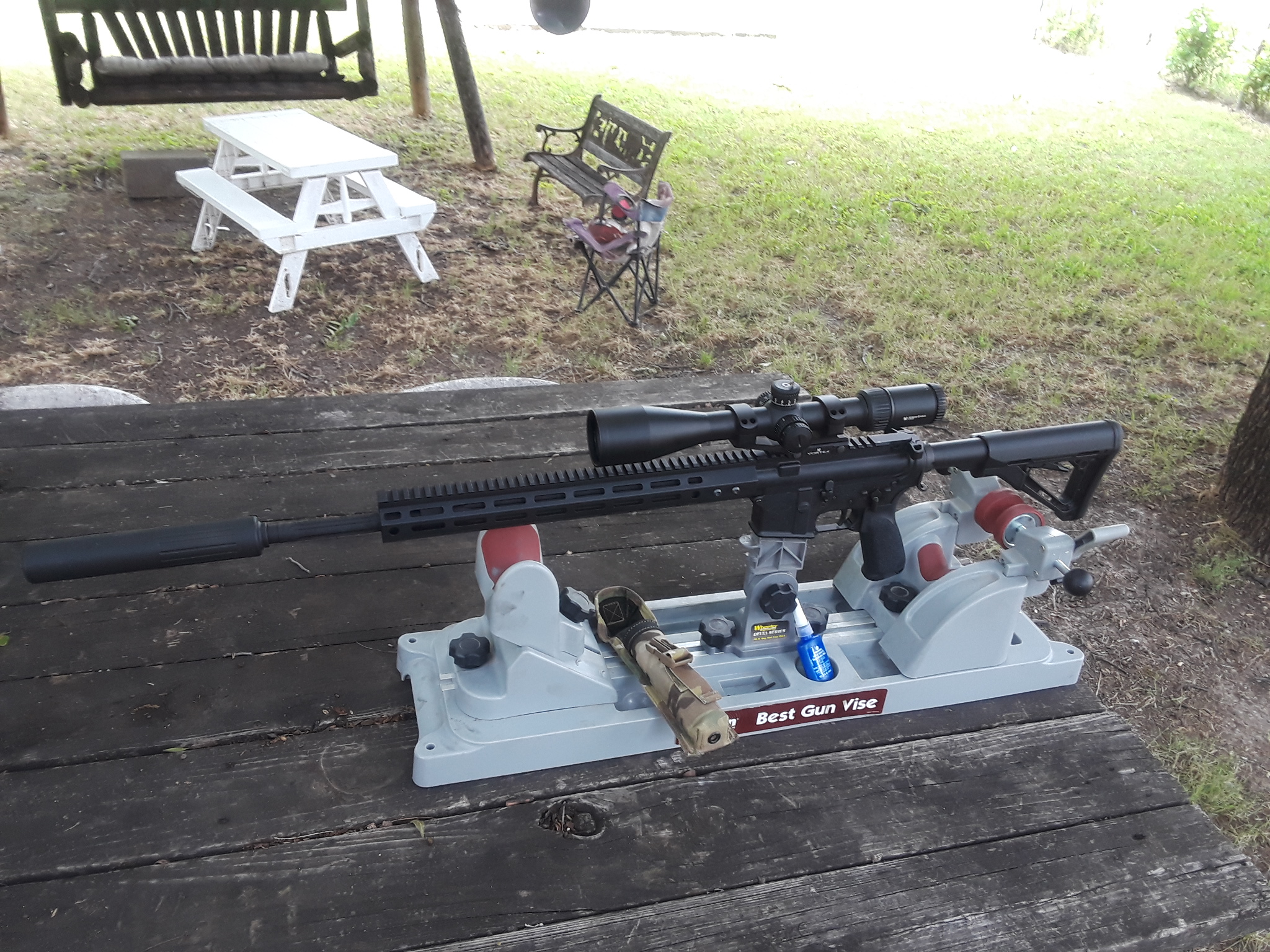

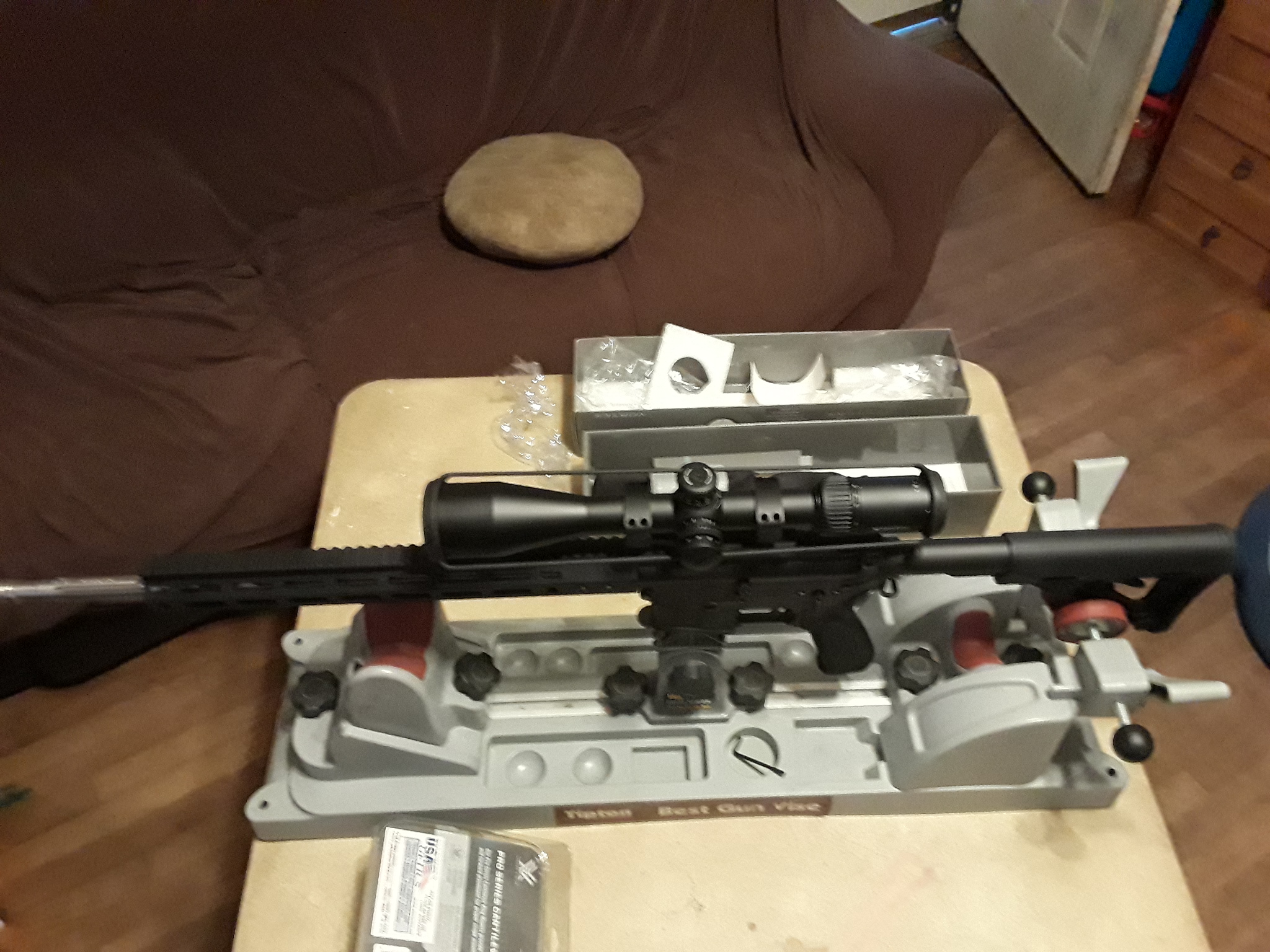

Got a half ass pix of my 6.5g with better scope. 4x24x50 illuminated.
51t can adapter actual 6.5g mags in transit, now to rattle can the ss barrel.
Think I will just run some cheap krylon and get over it.
