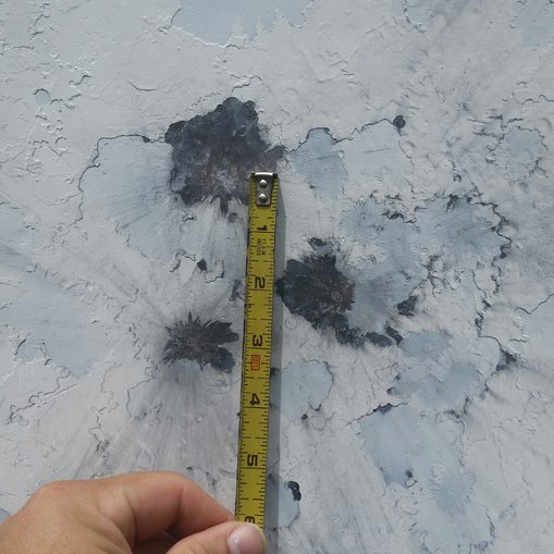

Well made the switch over to Nosler RDFs and I have to say I'm impressed.
Nosler 140 RDFs
Lapua Brass
Federal 205M primers
42.7 of 4350
Min Velocity: 2759
Max Velocity: 2770
Average: 2761
ES: 11
SD: 4.7
Taken with a Magnetospeed V3
Probably going to use this load at the GAP Grind in October.

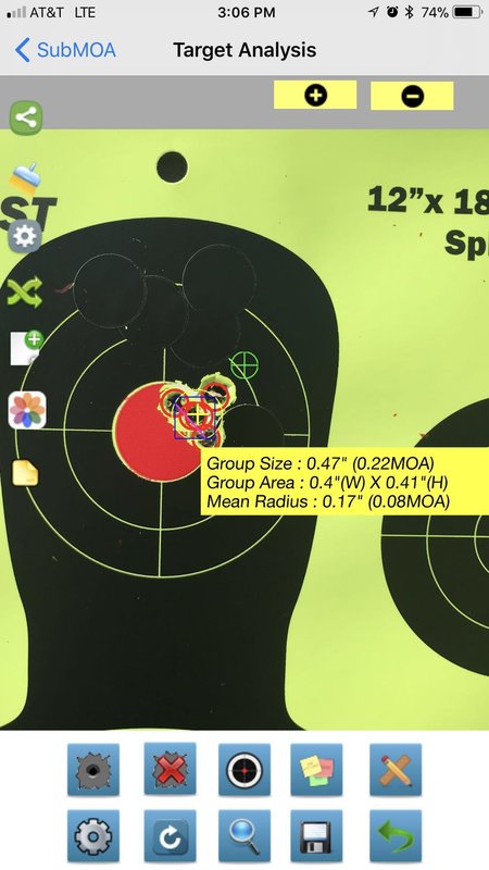

dannySH
Gunny Sergeant
Belligerents
Feb 13, 2017
532
97
34
3 shots @ 100 yards
Tikka T3X CTR 6.5 CM, PVA Nut Spencer barrel 24"
Hornady ELD-M 140 gr
Hornady Brass one fired
IMR 4451 41.4 gr
CCI LRP #200
CBTO: 2.2030" (.020" off the lands)
Average: 2735 fps

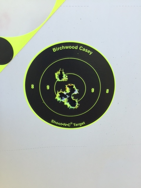

34
Albuquerque, NM
140 ELD-M
42.5gr H4350
1x Hornady Brass
CCI BR-2
Loaded 0.020" off the lands
24" Krieger, suppressed
Avg speed of 2831
SD 4.3
ES 11
Shot 0.23 MOA @ 100 yards out of my LRI.
