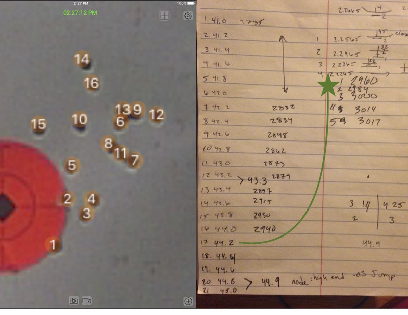

Sure! here you go! I pulled a screen shot off the iPad I was using to view and mark shots with the Target Vision and took a photo of my data book.
The Data book shows Shot# (coincides with shot marks on left side), then powder charge, then velocity.
Follow the green line to the green star to pick up 44.2-45 velocities. Those shots aren't marked on the target shown. Shots 2-6 didn't register on the LabRadar due to user error but I had the 2900+fps goal in mind at the onset of this testing. Sorry for the mess. Had I known that I was making this public, I would have been more organized.
Reactions: Archangel01

What's the testing method you used called? I watched at you tube about if a while back but can't remember... i am interested in giving it a try. So far I have just been shooting each batch at a different target. Would like to try something where I can eliminate the error of switching positions for each target...
Its called Ladder Testing and its covered in detail on the Reloading Forum. See the Sticky post Hand Loading for Long Range 4: Powderin' it for details. When he says read it over and over - he means it.. Read it
