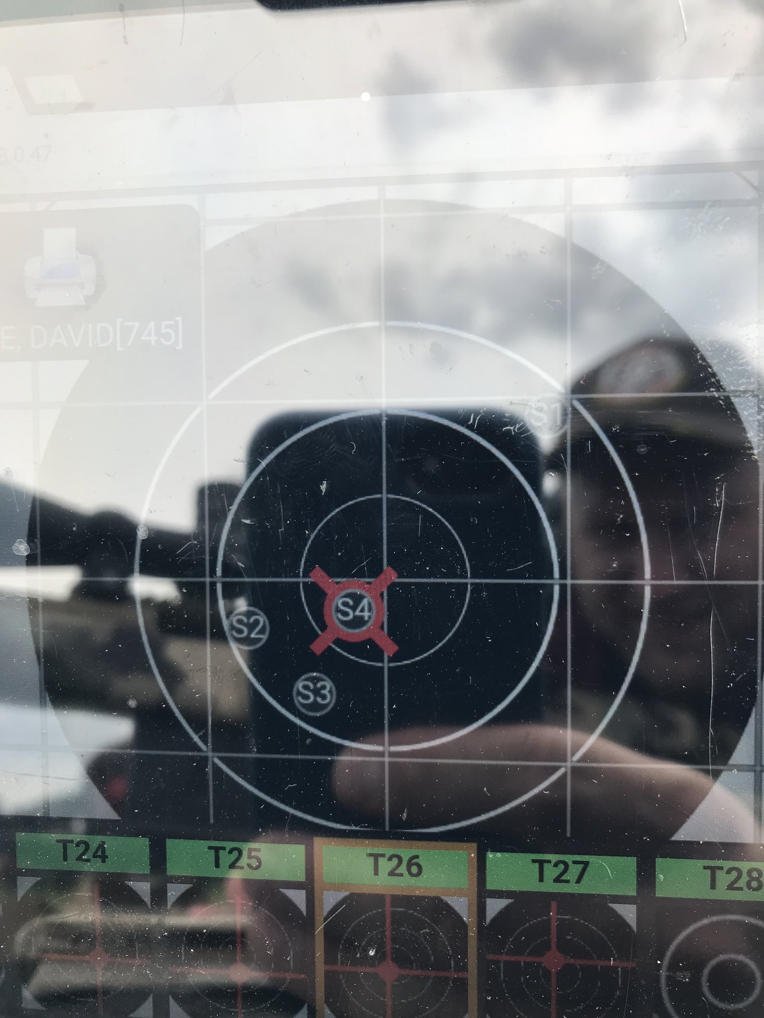

Savage MSR 10 Long Range 6.5 Creedmoor, 22” bbl:
142 SMK
41.5 H4350
F210 M
Horn brass FF/bump-neck die .289
Seated to “just shy of mag length”
1/2”-5/8” 5 shot groups, 109 yds
Vel 2,670 (4,500’ and 60*F)

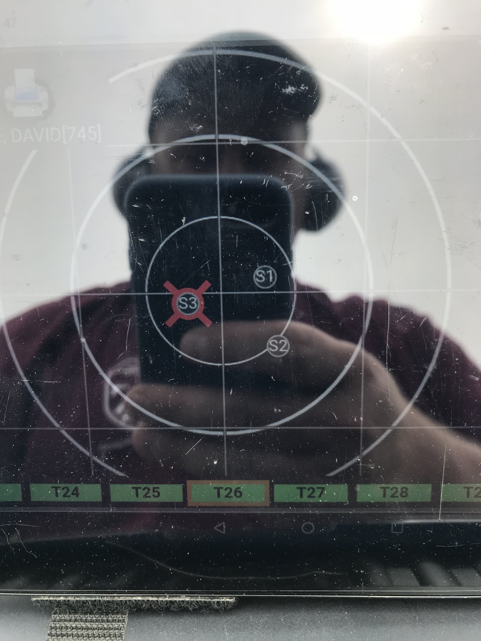

123 Hornady ELD-M
39.0 Varget
F210M
Starline Lg primer/FF/bump-neck die .289
Seated to 2.720 COAL
1/4”-3/8” 5 shot groups, 109 yds
Vel 2,840 (4,500’ and 40*F)
