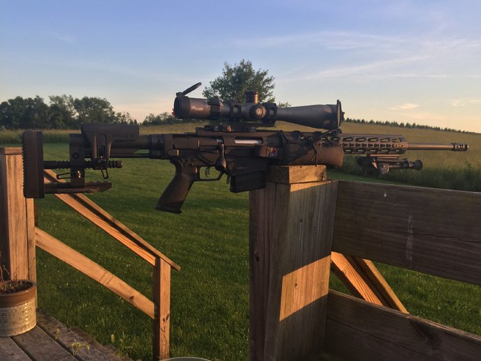

#29
Took my RPR into the field for the first time yesterday, wasn't even hunting, just setting up cameras and feeders for summer hogs. After loading up the 4-wheeler, was creeping my way to the front of the property homeward bound. This hog walked out on a part of the property I had not even seen hogs, so of course my rifle was put away. Made a clean 80 yard shot with 140 AMAX. ( to be fair, I was anticipating a shot on a coyote or fox so bullet choice may not have been correct to some, on a game animal I would only use an expanding bullet, eld-x perhaps.) Regardless, this round is phenomenal for thin skinned game, using proper round placement and bullet selection.
To properly answer your question, I beleive that a good, off the shelf selection would be 143 eld-x. Great stats as far as my limited experience is concerned.

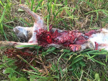

#46
Plenty, two of the bucks in that video were dropped by 140bthp.
That's interesting. I've had mixed. Blew a coyote in half with one, then my brother shot a coues deer with one and it acted like a FMJ. I had had great results with the Amax on coues, so I figured the BTHP would be fine. Must've been a fluke his didn't open, or it just opens better on larger mulies vs 80lb whitetail.
