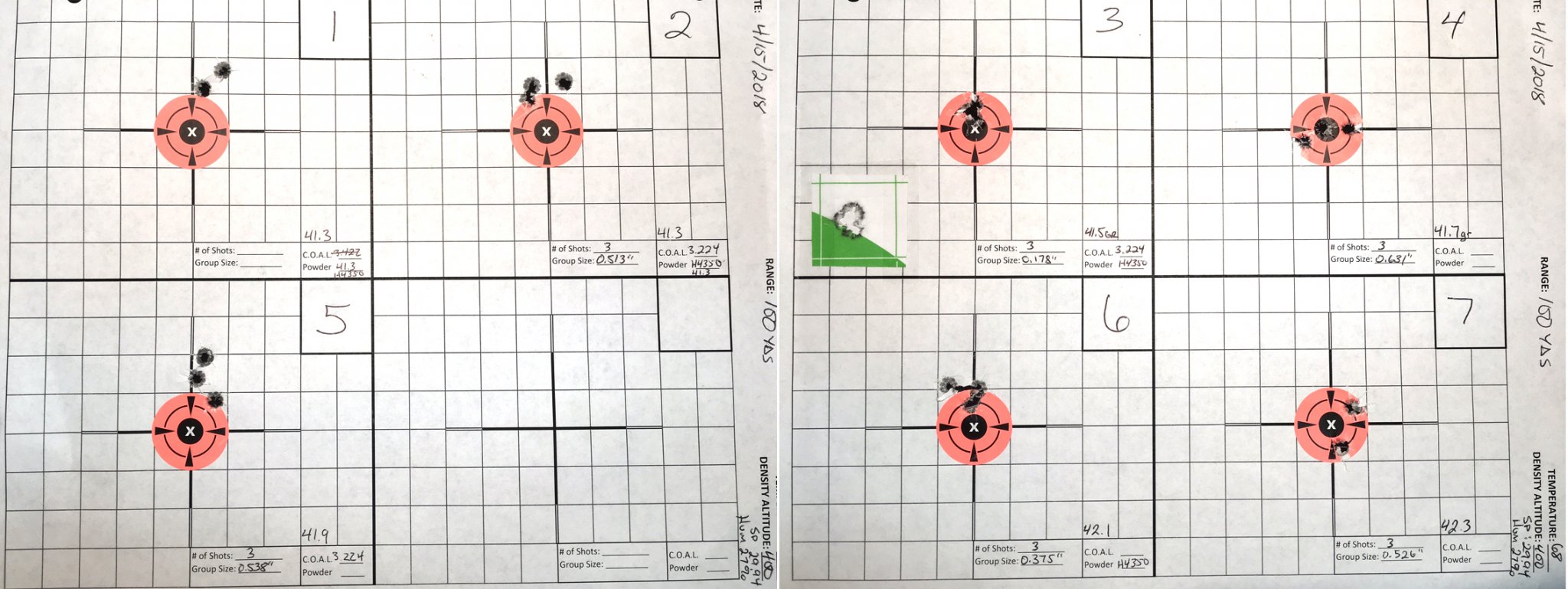

I have similar findings to the above post by 260284. I'm running H4350 w/ a 142gr Sierra Matchking.
*Note: I was getting higher velocities in the Starline brass as opposed to the Hornady Brass.
A more detailed comparison of Starline Small Rifle Primer Brass vs. Hornady Brass can be found here.
I'm running a 24" Ruger Precision Rifle in 6.5 Creedmoor.
Bullet: 142gr Sierra Matchking
Brass: Starline Small Rifle Primer
Primer: CCI 450
Velocities: 2667fps @ 41.5gr H4350
Location: Houston, TX
Altitude: 177ft
Avg Density Alt: 400-1400
