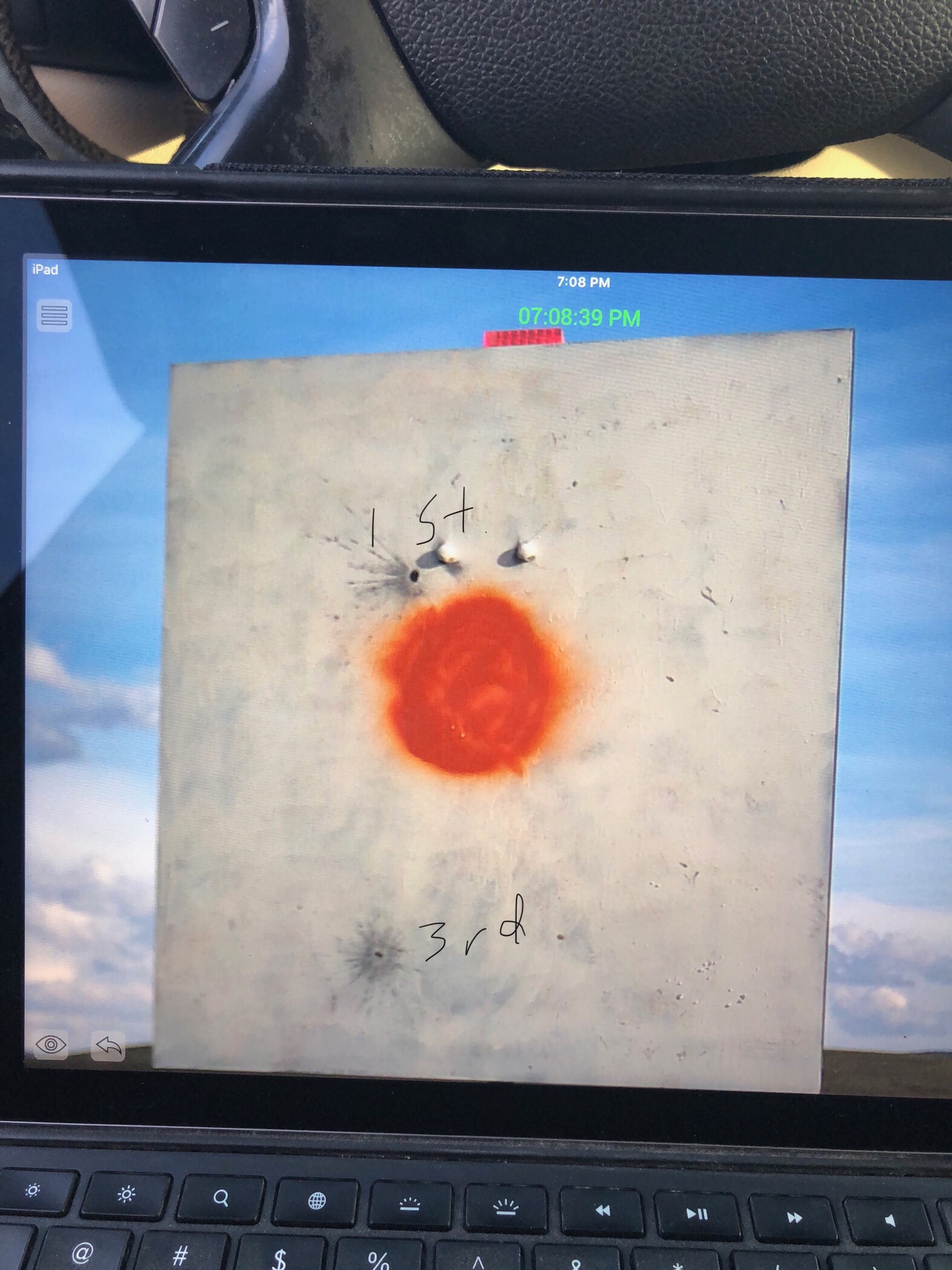

Any update for us? Thanks!
Finally got to play with some loads. We had an ELR challenge at the match this last weekend so I did a quick ladder from 49.4-51.8 gr RL26 in .4 increments. Speed was from 2999 to 3056. and the last three shots went into a nice little group. Settled on 50.5 loaded .020 off the lands. You can load 2-3 in a mag at this length but then they stick. For a true mag length you'd have to load 15-20 Thou shorter. This load shot between 3028-3046 and was just under .5moa.
The winds were 12-18 and switchy and but was able to get 3/6 on the plate at 1540 which was good enough to beat all the Lapuas and Cheytacs. Then just for fun decided to try the 2026yd and got lucky enough to get a first and third round impact. I'm pretty sold on the 150's at this point.

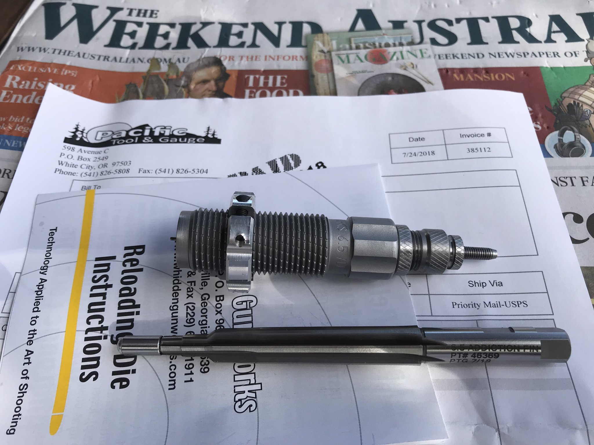

Are there any smiths recommended to rechamber a 260 CTR barrel? I'm thinking of doing the same thing that MTSLW did (I assume his smith was in NZ).
Josh at PVA has reamers, but you would have to contact him if he’s willing to remove the barrel to rechamber.
My Smith was Nemesis Machine in Butte, MT. I would assume anyone with a reamer could get it done.

A big thanks to MTSLW. I have a new (and my first) custom rifle in the works and this thread has inspired me to run a second barrel in 6.5 Addiction. I now have all the reloading components (reamer and die above, Lapua brass, Berger 130 gr AR H and 140 gr H and 150 gr SMK) and if i can just get the action and stock into Australia, I will get the rifle built. The other barrel will be chambered in 300 Norma Mag Improved (35 degree shoulder). I can't wait.
