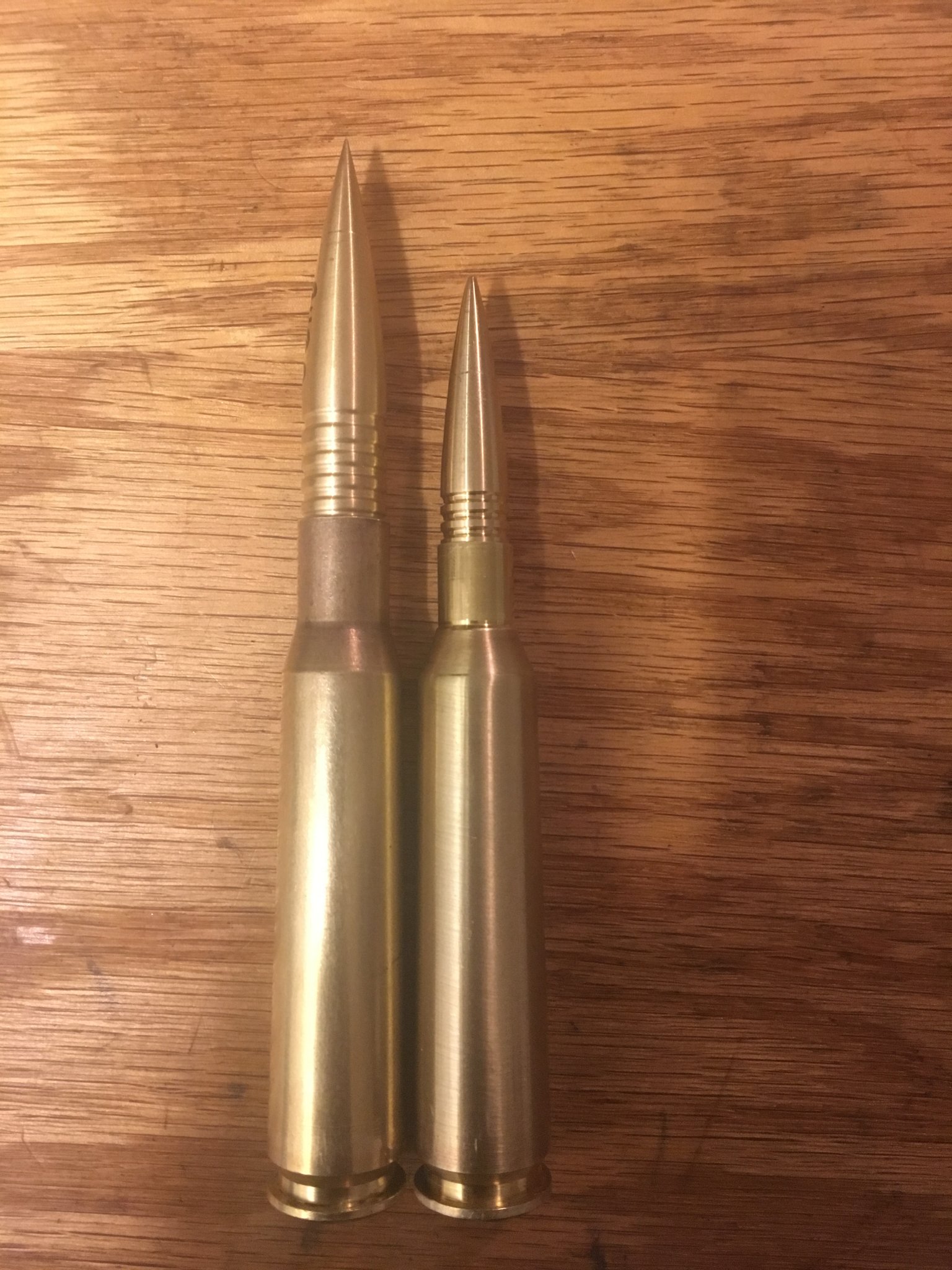

How about the 416Garrett. The pic shows a 50 with my 850+ Gr. Solid next to my 416Garrett and a 422gr solid. That 416 sends those solids at 3550fps all day long with no pressure and low spreads. Way awesome to run.

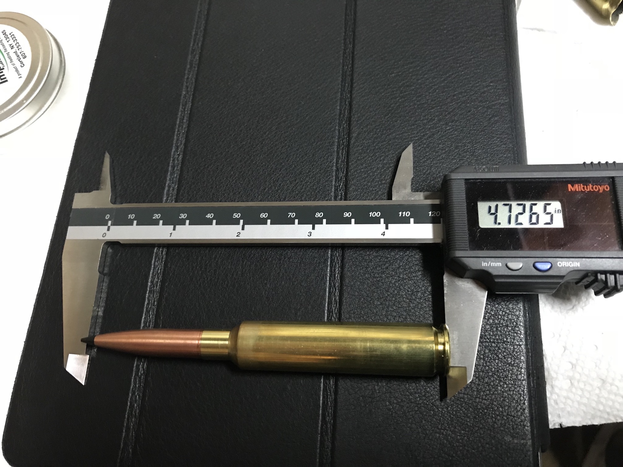

madppcs; looks like I'm late on this one but........I have an AR-50. I started loading 750gr AMAX w/215 grains of H50BMG at 5.68" OAL on my RCBS single stage. (Using once fired, neck sized, WW brass from shooting a ton of the Hornady 750 factory ammo over the years. ) It was barely 2400fps read with my Magneto Speed but easily 1/2moa 5 shot groups at 300 yards. So I agree with northern that 219ish is probably a good place to start.
I worked up gradually and now I'm at 235 grains which only yields 2600fps when the rounds are warm. Still 1/2moa at 300yds. I have absolutely no pressure signs so I'm going to try 240 grains next. Shooting for at least 2750fps and figure that should be no problem with the very long OAL I'm going with. I'll keep you posted but it may be awhile as I've been busy with other (gun) projects.
