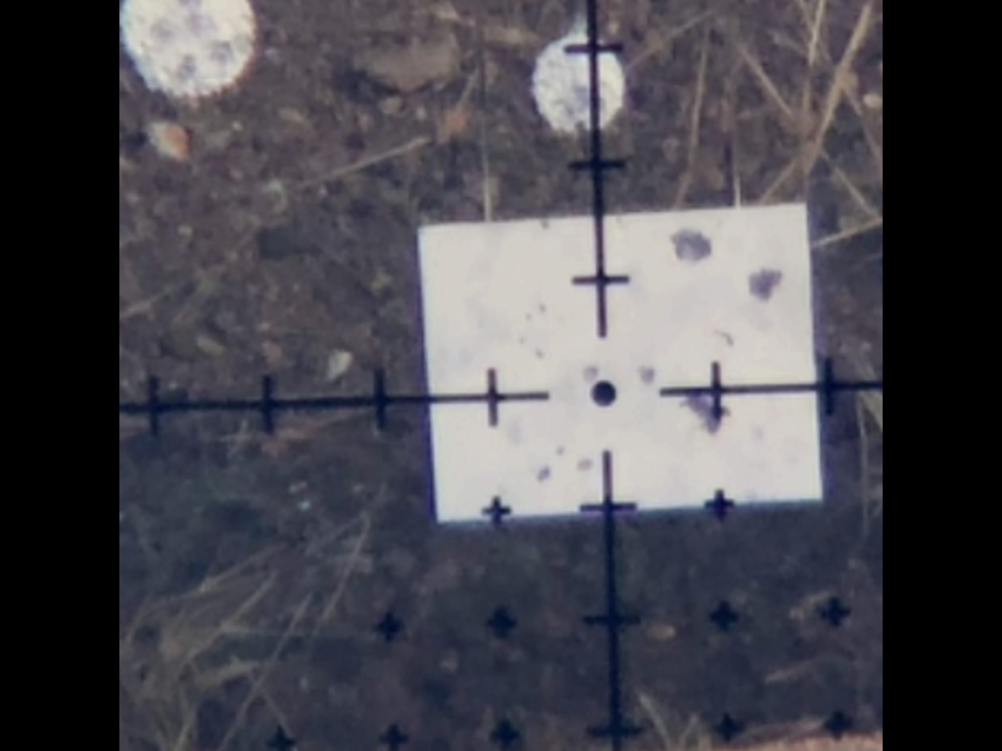

#28
4 shots at 10 o’clock to the reticle centre dot , 5th Shot landed in a previous CF impact , 500 meters
( approx 550 yards ) . Shot by multiple World Champion Stuart Elliott , testing a prototype optic .
Rifle was a sleeved BRNO mk1 action with a Shilen barrel . Apologies for poor camera phone optical
quality . Plate is hung canted .
EDIT : ammo was Lapua Midas .
