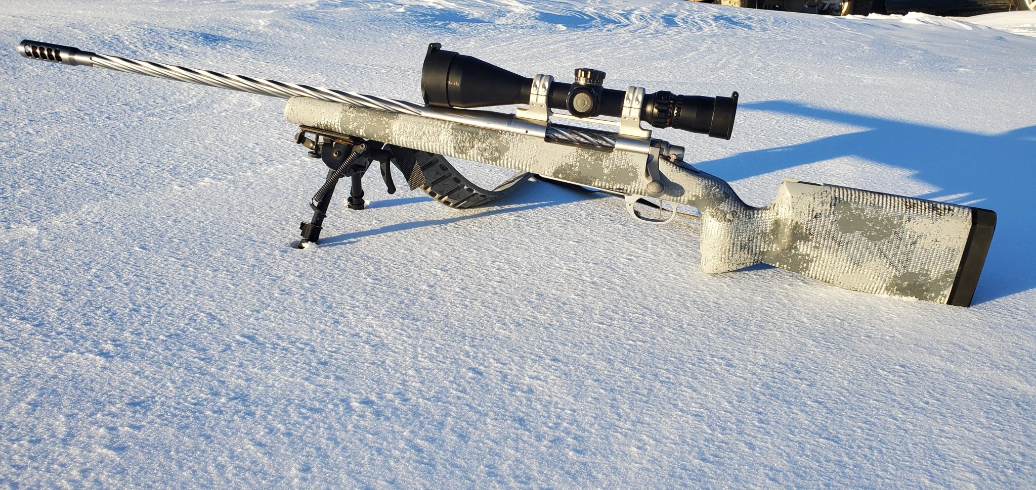

Rifle Configuration:
  • Action: Defiance Deviant Tactical
  • Barrel: Krieger MTU 9.3T 27"
  • Brake: Thunderbeast 338BA 3/4-24
  • Trigger: TacSport Single Stage
  • Stock: McMillan A5 Adj
  • DBM: Badger M5 CIP
Load and atmospherics:
  • Bullet: 300 gr Berger OTM Hybrid
  • Brass: Virgin Norma Brass
  • Primer: CCI 250
  • OAL: 3.690
  • Seated: -0.015 Jump
  • Powder: H1000 89 gr
  • Velocity: 2,825 fps
  • ES: 5.5 fps
  • 1,000 yds group:
    • 4.42" (3x shot)
    • 5.58" (3x shots)
    • 6.64" (4x shots)
  • Temp: 43°F
  • Elevation: 343'
  • Winds: 5-10E @1,000 yds, 5-10W @ Target
