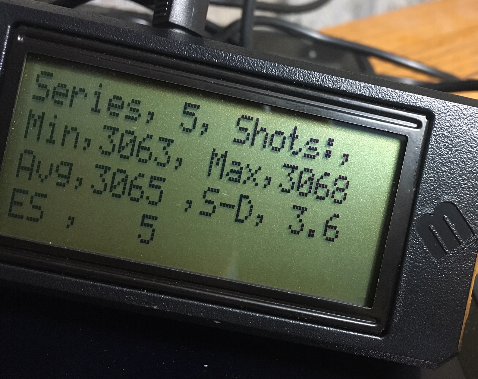

Savage BA110 Rifle modified with a 30 inch Bartlein barrel and Silencer Co Big bore suppressor.
Having great results with this load:
Lapua Brass
N570 - 98 grains
Hornady 285 ELD's
COL 3.81
3000 fps with magneto and radar

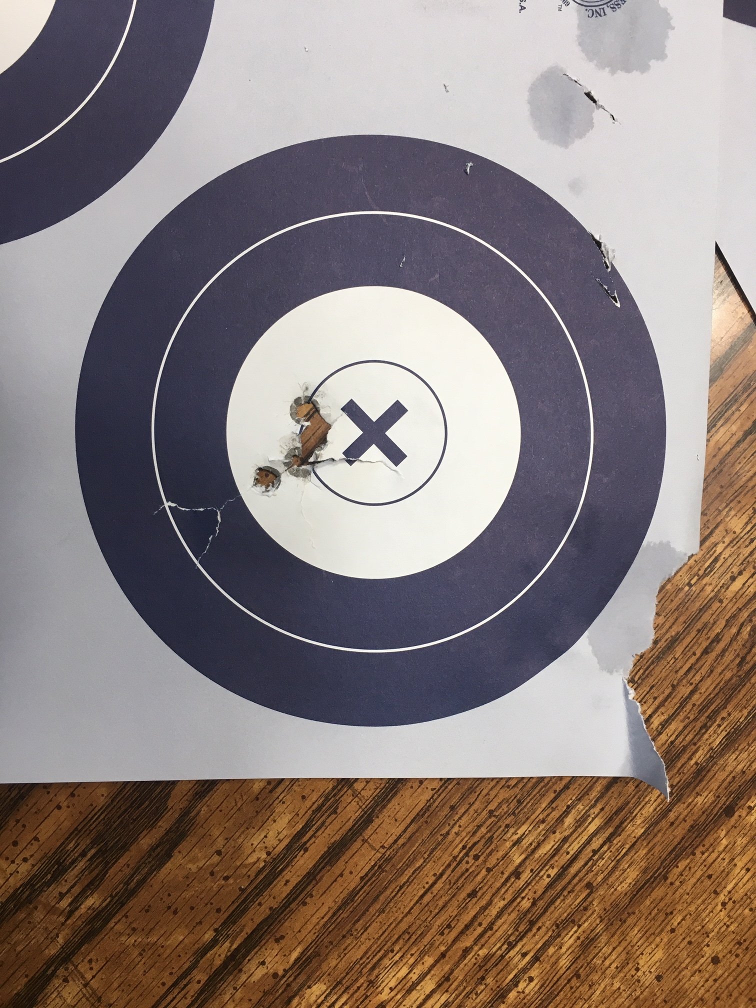

I've noticed the groups are tighter when using a front sand bag rest instead of the bipod when shooting off the concrete shooting bench.
Here's a few youtube links..

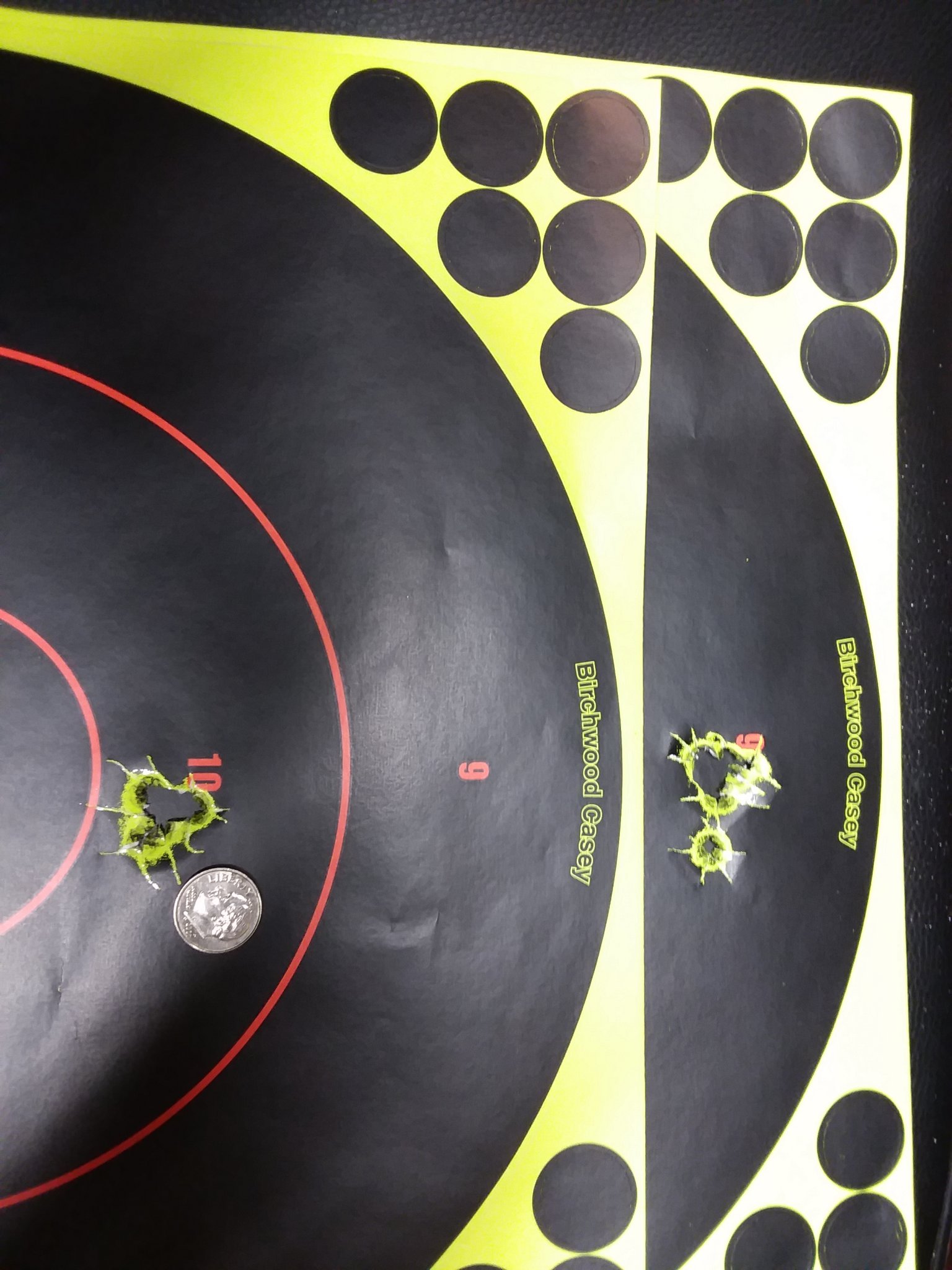

Finally have some data to contribute. First time shooting this rifle, or any magnum for that matter, for groups, so we'll hopefully see the group sizes shrink as I get more time behind it and see what it will do at distance.
Caliber: 338 Lapua Magnum
Action: Stiller TAC338
Barrel: MPA 26" 1:10 twist, short throat only allowing CBTO of 2.750"
Suppressor: AAC Titan-Ti
Bullet 1: 285gr Hornady ELD-M
Brass: virgin Lapua Brass, .002" neck tension
Primer: Win LR Mag
Powder 1: Retumbo 94.7gr
Velocity 1: 2851fps ES 20 SD 6.4 10 shots
Group: 1.420" ten shot group at 100yds. Not sure if firing fast, leading to mirage off the can, impacted this, as the group was ~.6 across, but stacked vertically in what looked like 2 columns of rounds. Perhaps also a sign of the barrel getting warm and whipping about. Fired all 10 within a 90sec window.
Bullet 2: 250gr Berger OTM
Primer: Win LR Mag
Powder 2: Retumbo 93.3gr
Velocity 2: 2861fps ES 29 SD 9.1 10 shots
Group: .988 for seven rounds (used the first three to get a rough zero). Had six which gave a .66" center to center cluster, so not sure if the flyer was me or the load/rifle.
Planning to do two more five shot groups with this and the 285gr ELD-M load in the coming weeks, but will shoot 2-3 5rd groups, with a few minutes in between each to allow the barrel and can to cool down and hopefully remove any potential barrel whipping and/or mirage impacting the sight picture.

I built a 338 LM for a customer who wanted an all around bullet for hunting and long range target. I decided to try the Hornady 230 ELD-X which are inexpensive and still have a BC of .610. New Peterson brass and H4350 which I have in abundance and use for other calibers. I was not sure who it would work out but was amazed at the result. My OCW results ended up with 87.2 g. Results below.
Reactions: Juggerxxx
towerofpower93
Belligerents
Jul 11, 2010
184
46
34
35
Interesting results. Care to give any more specs on the rifle and handload specs (barrel length, cartridge OAL/CBTO, etc)?
Thanks
Danco411
Arclight Precision
Belligerents
Aug 22, 2012
510
22
22
56
Fenton, Michigan
www.arclightprecision.com
It was a budget Remage build using the PTG B52 blueprinted Action with a McGowen 26” 1-9 twist match barrel in an AIAX Chassis. New Peterson brass neck sized and chamfered with a CCI 250 primer. COAL is 3.70. Didn’t measure the CBTO.
towerofpower93
Belligerents
Jul 11, 2010
184
46
34
35
Thanks much.
