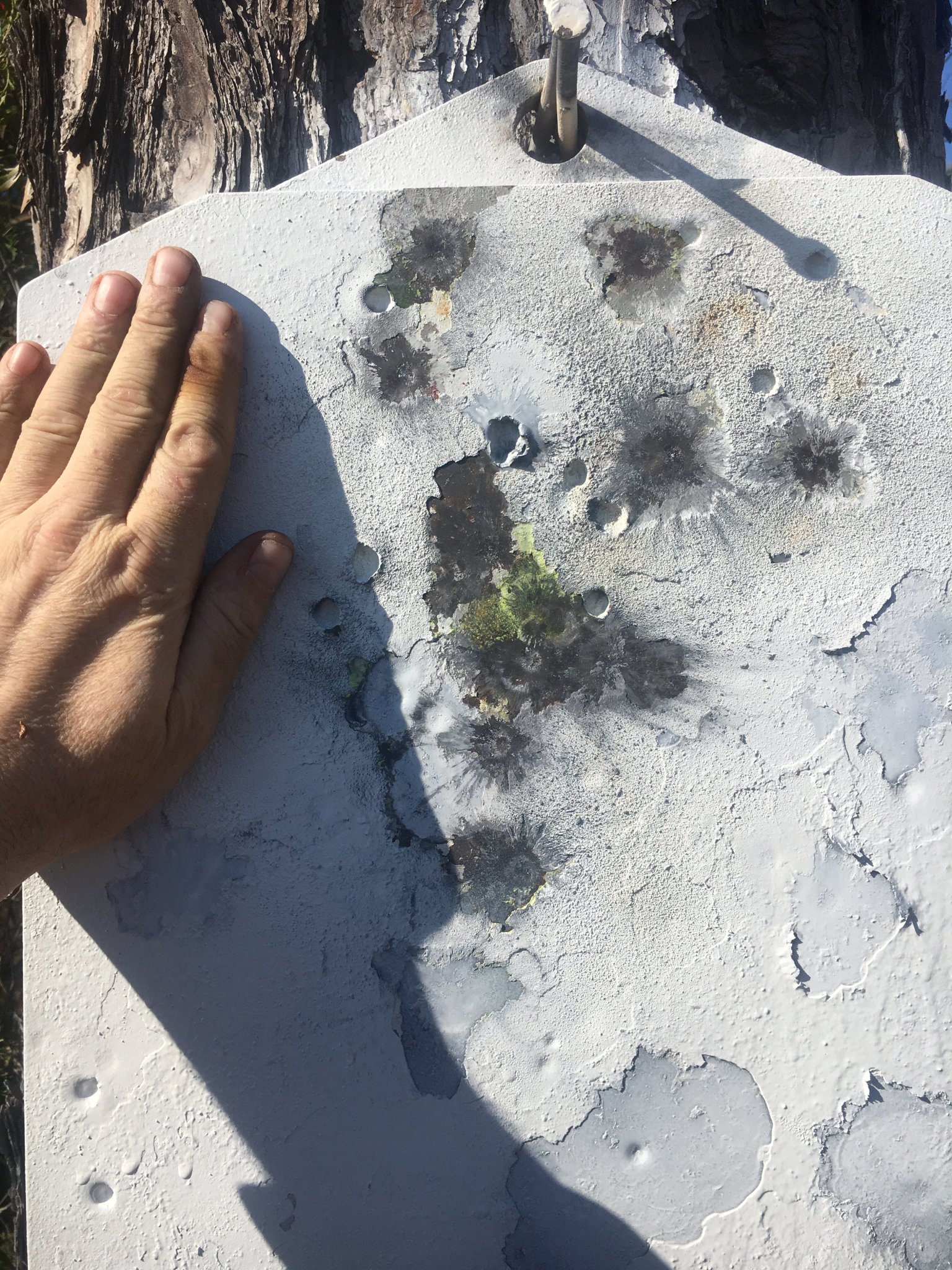

185 Juggernaut bullet
Lapua Palma brass, sized x 2
CCI SRMag primer
Varget 43.9gr, charges thrown on RCBS Chargemaster ( Use my load at your on risk!!!)
10 shots, 600yds 3.59"x 2.88", measured from outer edge of holes, greatest dimensions.
Rifle AI/AT 26" barrel
Avg velocity 2432fps, STD 8.2
(Patched holes are from shots with my hunting rifle checking scope settings) these Splash targets are expensive!, so I try to get max use and patch the heck out of them.

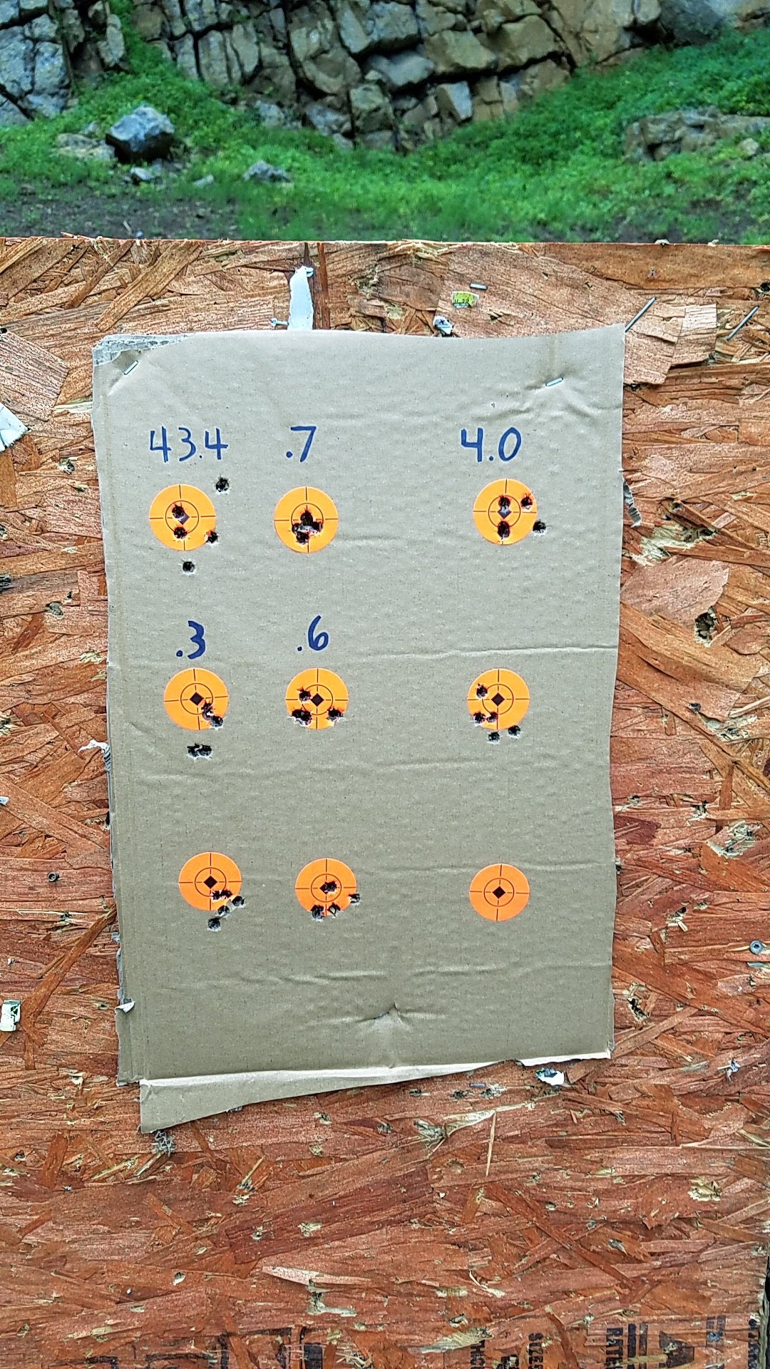

have to prove it with more groups but after OCW test this is what i got, i haven't seen much for this bullet so posting and will update after more groups.
168 Hornady ELD Match
43.7 gr Varget
Winchester twice fired brass
cases trimmed to 2.005
length to ogive: 2.245
chamber length to ogive: 2.308
Federal 210M primer
temp 73 F
Hum 87.79%
Pressure 101182 Pa
wind: none
Barrel 20" 1:12 remington sps tactical factory barrel
group size was just under .5" center to center (spotters are 1.5" spotters with .75" inner circle"
rounds were fired at target 1-5 then 5-1, let barrel cool and repeated. 5 shot groups. unlabeled groups were for unrelated testing. shot from bipod with rear bag (sock full of poly beads) Will update with velocities when i chronograph on next trip. hope this helps someone
could probably tweak it in more by searching around the 43.7 and playing with seating depth more

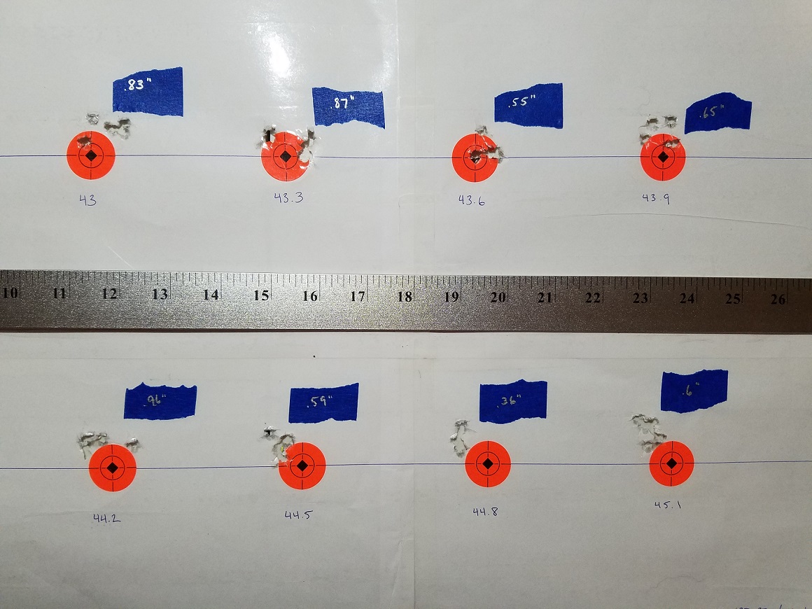

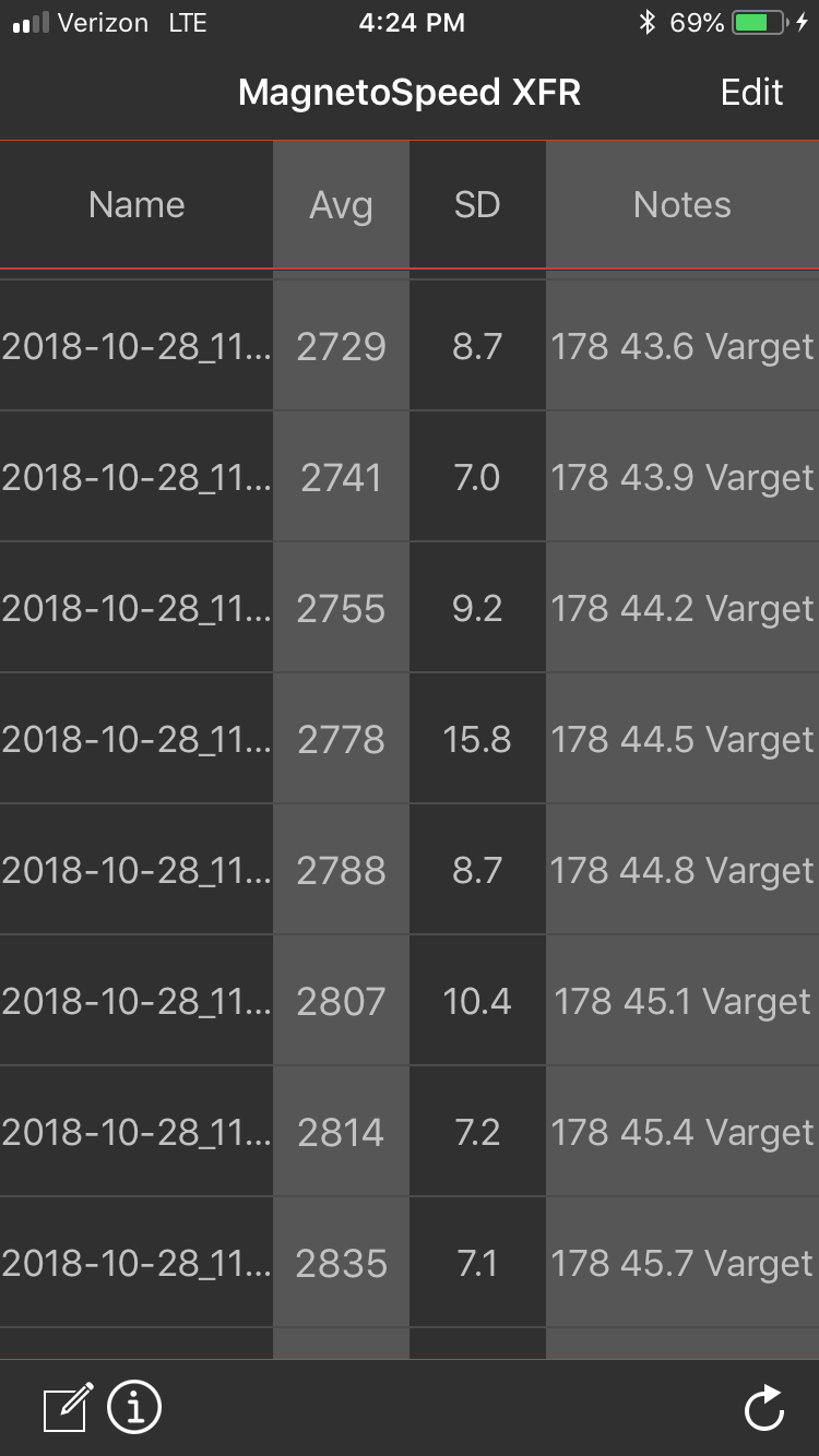

.308 Win, 178gr Hornady HPBT
LC12 Full Length Resize 1x Fired
2.0" Trim Length
CCI200
Varget 43-45.1 grain. (Hornady Book Max Load is 43.2)
2.806 COAL
24" M24 Profile K&P Barrel
LRI cleaned up Remington 700 SA
Slightly cratered primers from the start, but still rounded on the edges. Slightly stiffer bolt lift on the 45.1gr charge, noticeable but ever so slight.
Threw one shot on the 43 grain charge group when my neighbor popped off a braked 7mm RUM and rattled my fillings loose as I broke my shot.

Below is the data I have for the 178gr ELDx, Varget, Lapua brass and a 28” barrel. Never really saw any pressure signs. Slight cratering on the primes but that started at ~43.0gr.

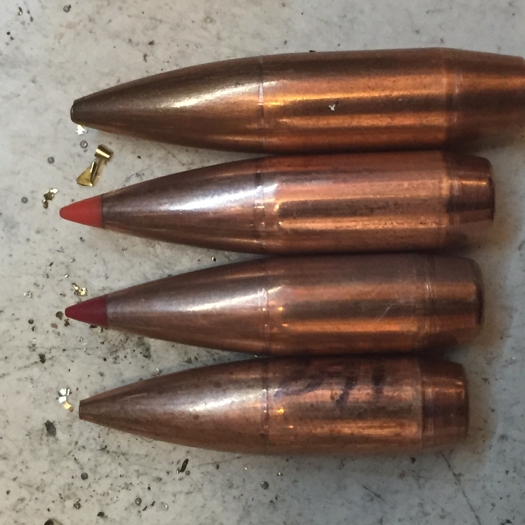

Anybody else crunching powder real good with 42.5 Varget and 180 sst’s
Well the Hornady 178 A-Max crunches with that load in USGI brass. Has IMR 4064 had burn rate variations lately? Worked up that load a few years ago, and this year I’m getting signs of max pressure using it with 168 ELDs.
Bearing length on the ELD is noticeably shorter than on the 178 A-Max. Lines are from the calipers at 0.300.
Top to bottom is 1980s 190 SMK,
178 A-Max
168 ELD-M
168 SMK
