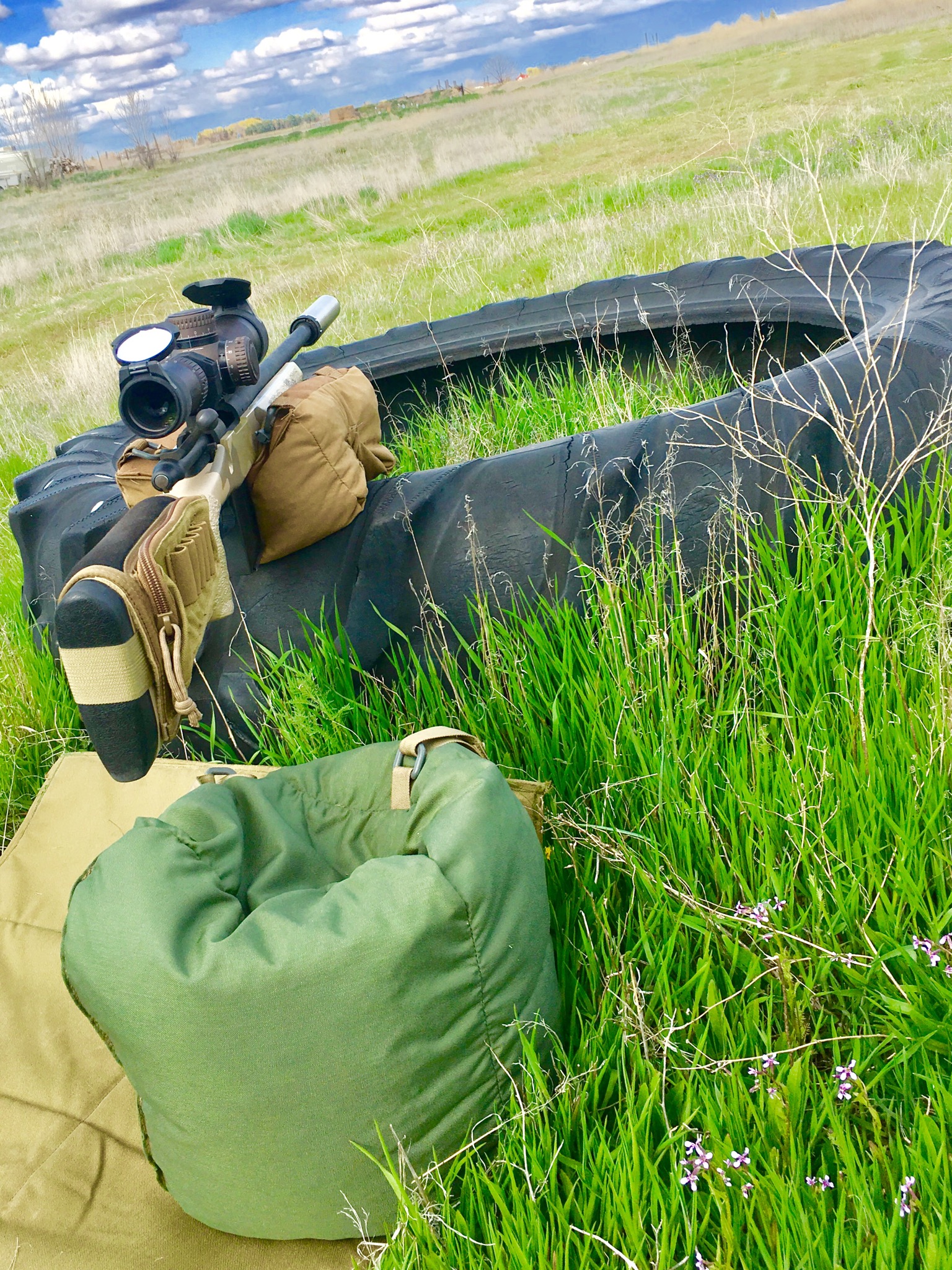

Yeah we’re rare for sure but I just can’t help myself but be addicted to shooting sports :)
Thanks for all the help everyone and I do take advice and apply it. I shot the 300wm in a PRS match last weekend just to see and sure enough it’s not great for it and what everyone is saying I find true. I don’t really want to burn the barrel out my 300 for the short range and heavy fire parts of a match.
I started another topic on here about 6.5cm barrel length. I plan on converting my 308 to a 6.5cm when I can get a barrel. I am probably going with a remage barrel so I can change the barrel out locally easy when I burn it out.
In the meantime I also put the razor gen II on the 308 and have started practicing positional shooting with it out to 325 yards which is the max I have on my range on my property.
