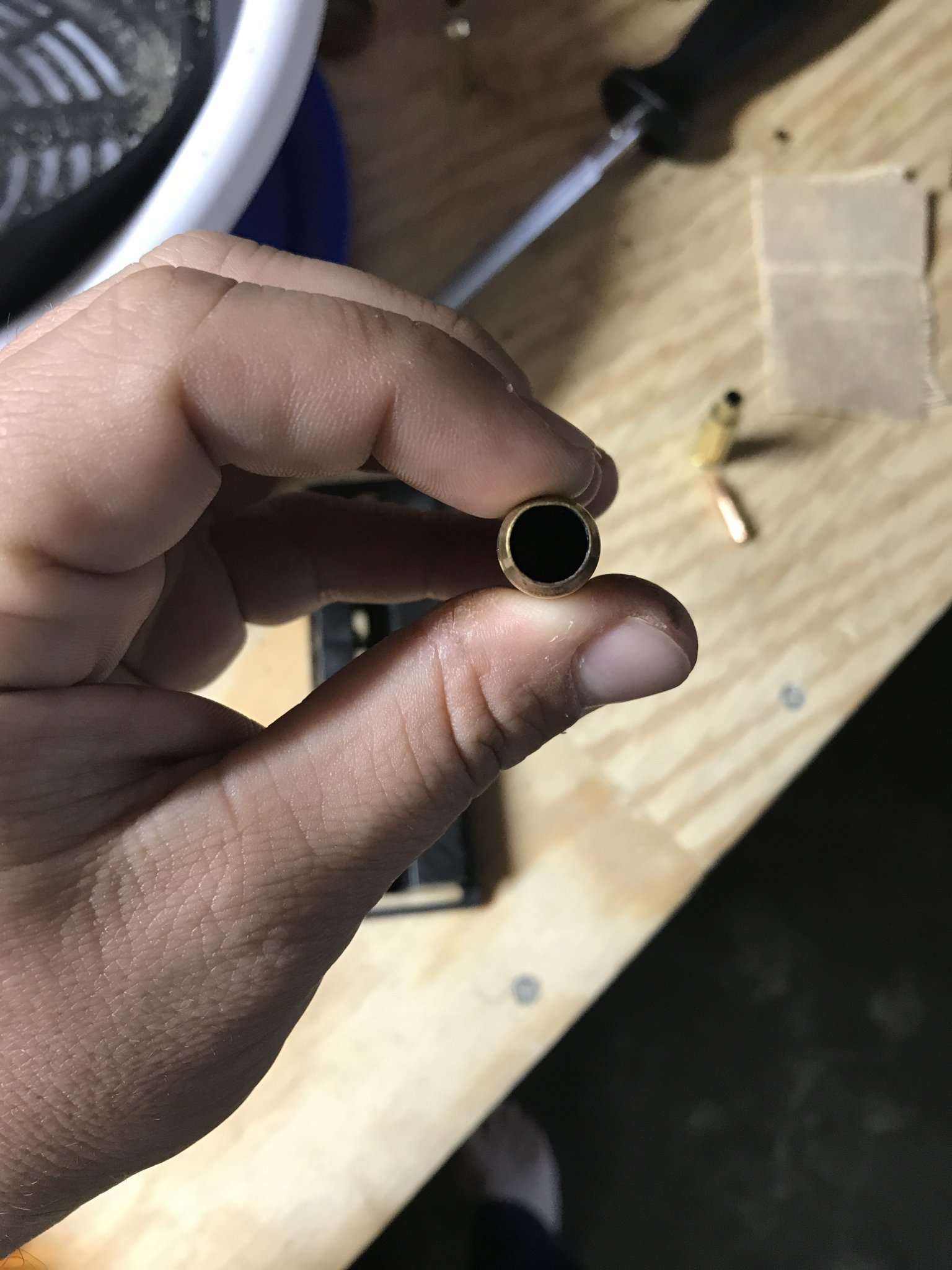

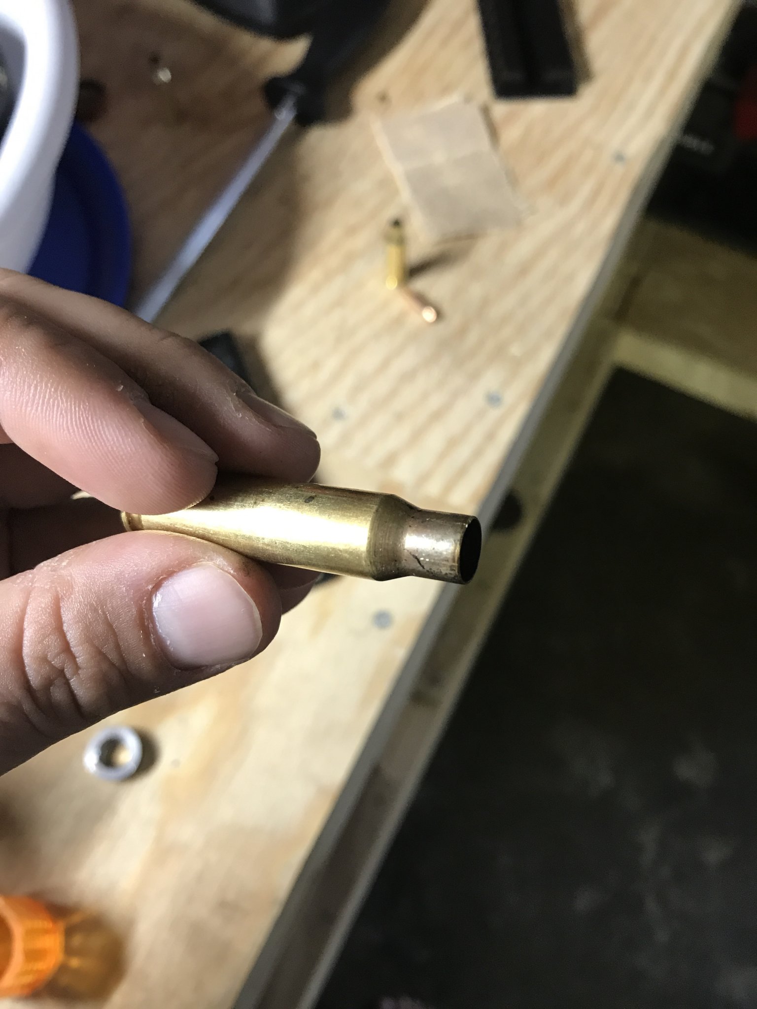

Initially I thought gas issue, and spent a significant amount of time playing with it to no success, yesterday I noticed the brass was receiving in’s interesting treatment. As indicated in the attached photos, there are two rake marks and the neck is slightly dented. This is the situation on all the brass regardless of whether the rifle ejected it, or if I had to mortar the case out.
After noticing the brass, I inspected the upper/chamber and there were brass shavings there from whatever is scraping the brass on the way out.
Any help on where to start on this diagnosis/fix is appreciated

I see the same brass marks on many of my and my friends semi autos. The marks on the neck are from the round being chambered and dragging on your feed ramps. The slight dent on top is more than likely from it hitting your brass deflecter.
If you are comfortable with it you can polish the edges of your feed ramps and that will help your neck scratches.

The dent isn’t from the deflector because the rounds I have to mortar out of the gun that do not hit the deflector have them also which was interesting to me Because that’s what I thought too.

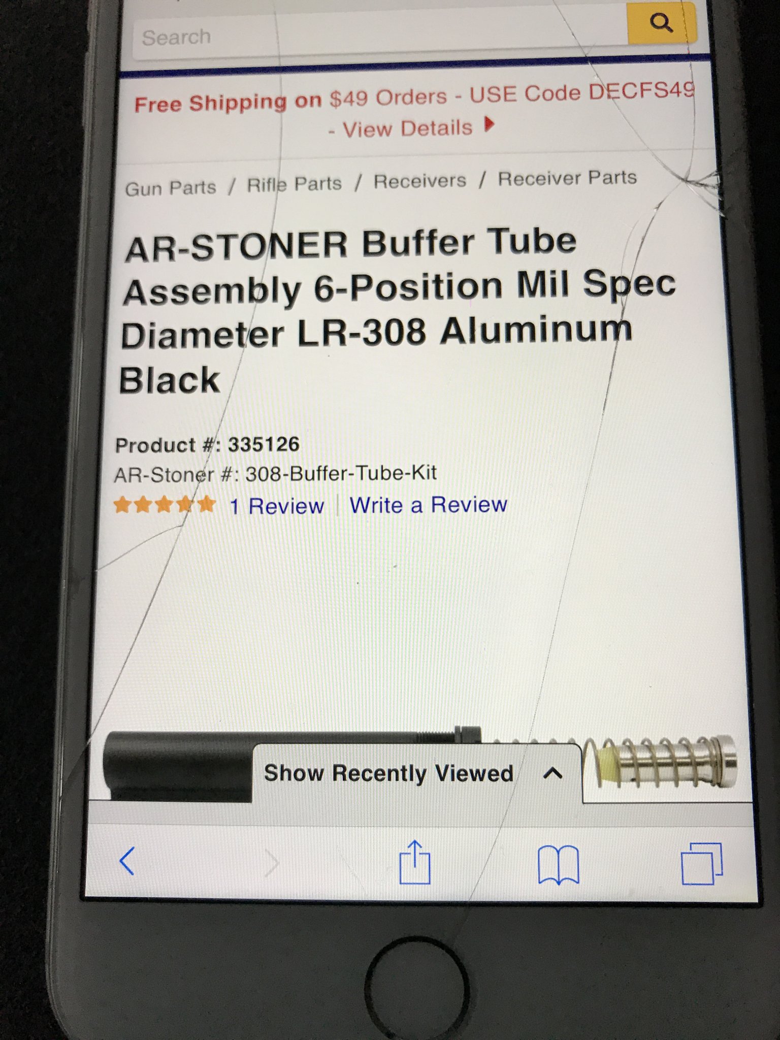

My next thought was buffer issue. Running AR stoner buffer tube kit (midway part 335126) for lr-308, I was thinking that’s the next place to look in the chain of events.

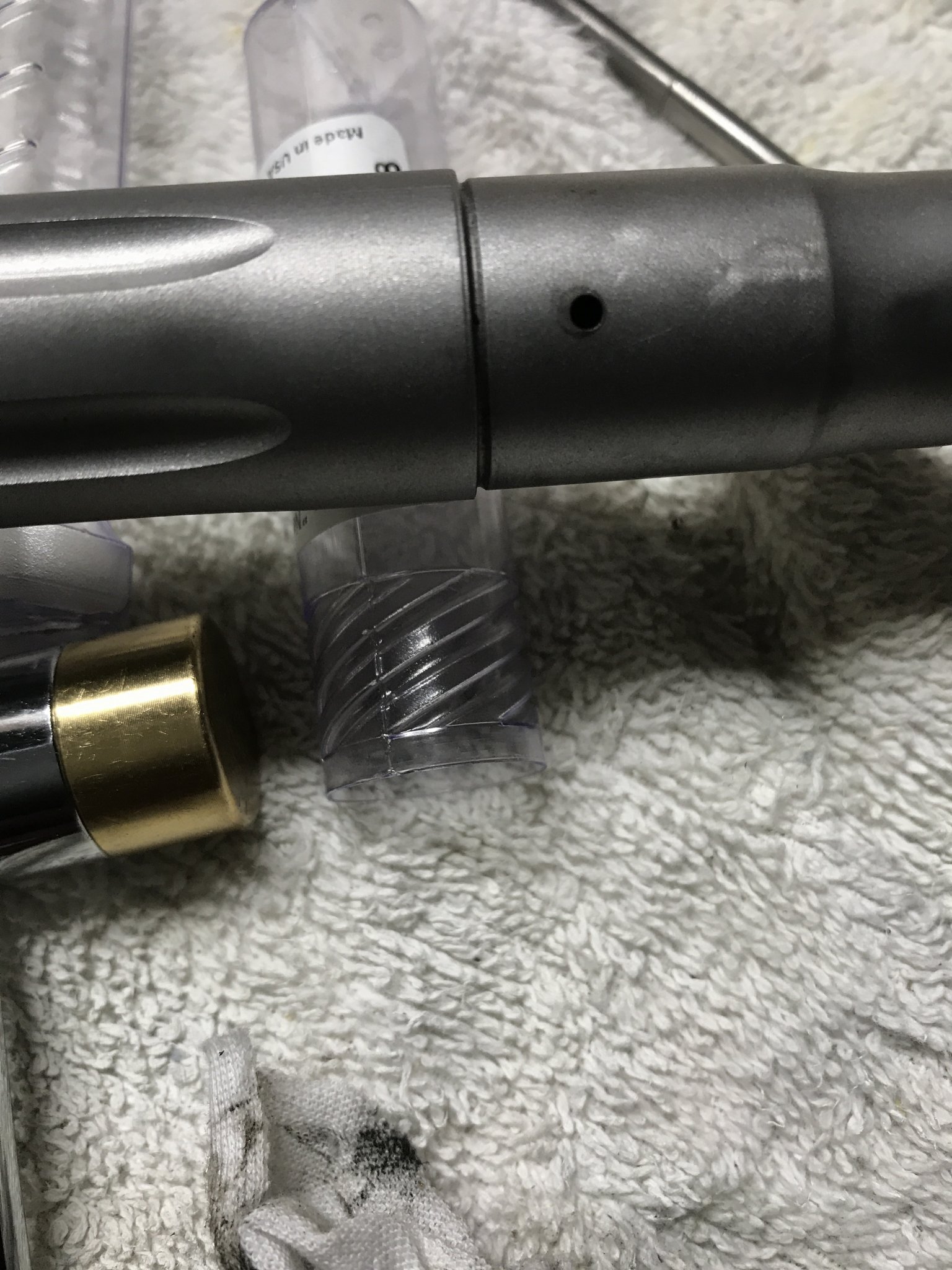

Here’s a picture of the gas port
Let’s keep hearing thoughts.
Tore the entire firearm down so I can inspect anything and provide whatever info needed.
Is it possible the buffer/spring are an issue?

If you are mortaring the rifle to get the shell to extract, it is as likely as not that it is ejecting with sufficient force to hit the shell deflector and get dented. If you drop an empty case on a concrete floor, the mouth can deform like that. It doesn't take much.
The scratches can be caused by the spent shell scraping along the locking lugs in the barrel extension.

gas port is slightly misaligned but not bad.
maybe I"m confused, is it hard to extract fired brass? Do you have to really bang on the charging handle to get it out?
Not super hard, just don’t want to pull on the charging handle that hard so I give it a light pogo

Here’s a question as I’m going back over everything... what are the differences in carbine and rifle buffer tubes and their respective buffers and springs. Doing some research, some I may have a carbine tube/buffer/spring. Would changing to rifle length be a possible situation to solve the issue?

What would be my indicator the gas block isn’t lined up, it’s a seekins adjustable, and the barrel has a notch for one of the two screws to orient it?
Just because one of the screws lined up doesn't mean anything. SLR, I think, sells a kit to drill the indents. The kit aligns to the gas port because the center to center distance can be like, either .400" or .450" between the screws. I would either buy one of the plastic gas port alignment kits or measure the distance on the barrel to the port and then the distance from the rear edge of the Seekins AGB to its port.
The spring and buffer you show is meant to be used with a 6 position mil-spec carbine receiver extension or buffer tube. You don't have enough gas it sounds like.
It’s all one package, carbine length tube, carbine buffer and spring. My question was asking if going to a rifle tube, buffer, and spring would make a difference
And I'm trying to not spoon feed you answers after I gave you a couple of videos to look at. If you're going to build ARs, learn how to troubleshoot them. What makes the BCG retract and eject cases? What doesn't yours do the majority of the time?
Do YOU think changing buffers matters at this point?
You didn't answer many of the questions people asked you trying to diagnose your problem for free before I responded. If there isn't some kind of mechanical binding that prevents using the CH to pull the BCG back and lock open on an empty magazine, then NO changing buffers isn't going to do squat at this time.
