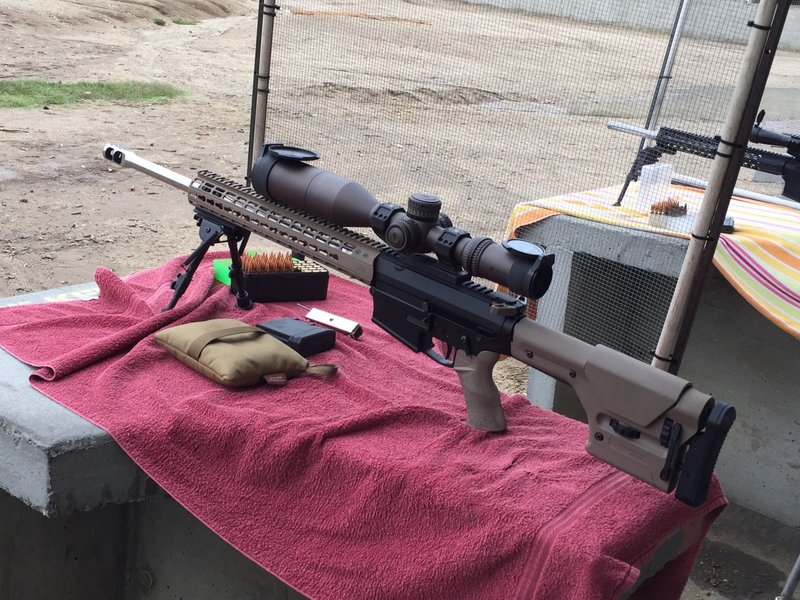

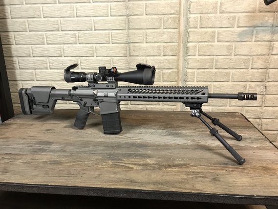

Let's see your gassers!
Here's one of my ex's
Mega Maten Monolithic receiver sets
GA Precision GAP-10 barrel 20" w/ BO Brake
Magpul PRS stock w/ JP SCS
Geissele SDE Trigger
Spuhr Mount
Schmidt & Bender 5-25 MRAD DT CCW XR

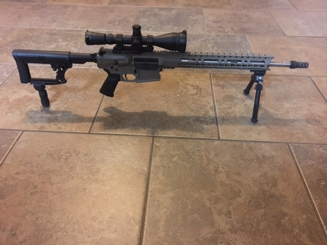

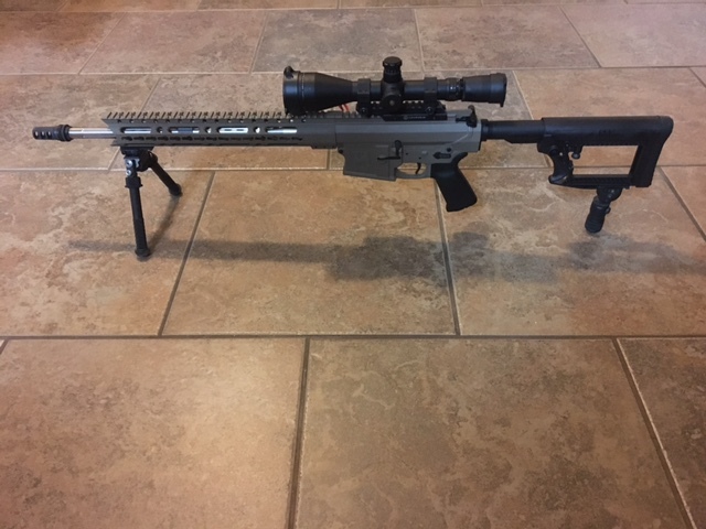

My .308:
MEGA MA-10 Receivers
JP 15" Handguard
Badger Brake
Syrac Adjustable Gas Block
Lilja barrel cut to 17.5" from 20" (rifle length gas)
JP LMOS bolt carrier group
JP SCS recoil system
Geissele SSA-E Trigger
Magpul ACS stock
Nightforce 3.5-15x50 in a Nightforce Unimount
This is the smoothest shooting .308 I have ever shot. Accuracy is as good as I can ask for.

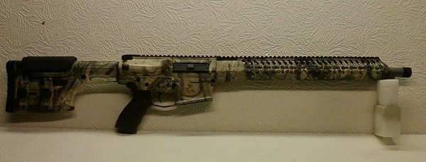

My first large frame AR build. 6.5cm built on a Maten set. Should get it out tomorrow morning to give it a test drive.

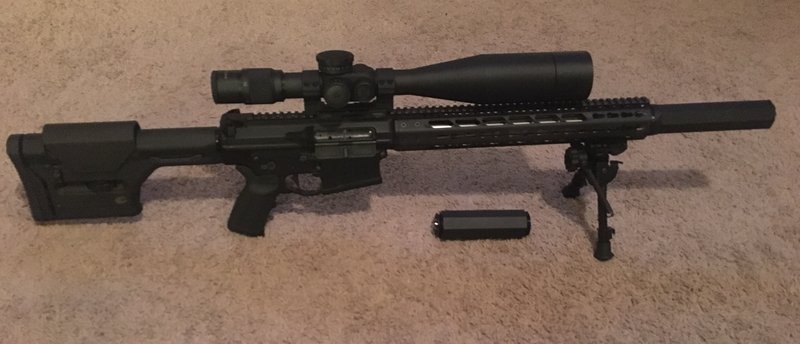

Just posted this in the new members section, but figured it made sense to add to the thread. Haven't tried it yet, but I have high hopes!
- Aero precision enhanced upper and grip
- Technical machining lower
- JP supermatch heavy contour 20" barrel with matched bolt
- Aero precision nickel boron BCG
- VG6 Gamma muzzle break
- Geissele DMR trigger
- Magpul PRS stock
- Atlas PSR bipod
- JP adjustable gas block
- JP silent capture heavy buffer
- Leupold Mark 4 rings
- Vortex Viper PST FFP

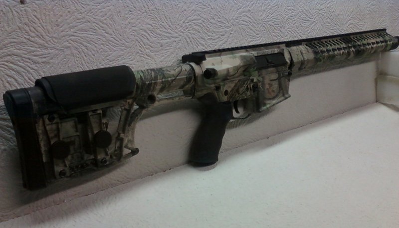

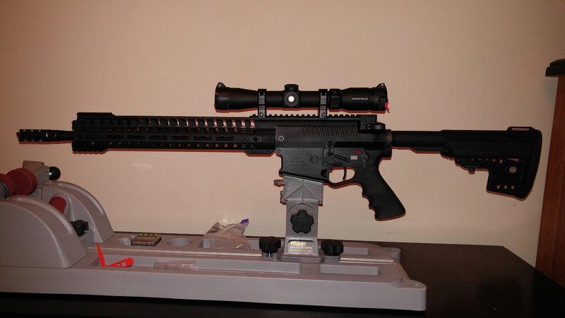

Just finished this California Compliant build.
I put 100 rounds through it yesterday and it ran great after I got the gas block dialed in. The SLR gas block is set to the 7th click open. The groups were @ .6 mils at 100yds, (2-ish inch)
All day long it would put 2 rounds on top of each other and then throw a flier. I hope that once I get a good copper base inside the barrel the groups will tighten up.
Aero M5 lower/upper.
Lantac BCG.
Proof carbon 18" 308 10-twist.
APA Lil bastard brake.
SLR adj gas block.
Gieselle SSAE FCG.
API carbon 12" rail. I had to go 85lbs on the barrel nut to get it lined up for the gas tube. It was either 85lbs or 35lbs, I went with 85lbs.
Vintage A1 stock.
Bullshit CA compliant kydex wrapped pistol grip.
Rifle buffer spring with Standard buffer.
KAC Micro BUIS.
Armalite dust cover rod (longer). The DPMS rod was too short.
Pivot pin was very tight. I had to do a bit of sanding on the pin and hole.
Vickers sling with MASH hooks.
Atlas B10 bipod. I will probably go with a Harris 6-9.
I am still looking for an optic. Probably go with a 12 or 16 power.
Edit due to spelling.......

Sure wish I could come up with a reason too spend $$$ on one of those Proof Carbon barrel's.
Rate now:
Tahoe333XSergeant
Rating: 3.0/5 this site
364 posts this site
Re: 308 AR/AR10 Build Info/Picture Thread
1:51 PM Last edited 2:05 PM by Tahoe333
[HR][/HR]
It was on sale over the holidays ---- Sale-bwahhh - thats what I told my wife!
Considering it was shooting 2" at 100yds, I am not so happy with it right now.
Edit = added text.

It weighs in at 12.3lbs without mag or ammo.

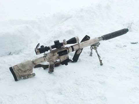

Here's one of my old AR10 rifles, built by RW Snyder... Badger brake, Brux barrel, Seekins AGB and tube, Apex Gator Grip handguard, SI Defense billet receiver set, Gieselle NM 2 stage trigger, JP SCS, Magpul STR, JP Bolt, wore a Steiner T5XI 5-25x56 in a QD mount, etc...

It looks like the SLR adj. gas block is hitting the rail causing random fliers.
I was thinking about trimming a small groove into the fat butter section of the rail.
I haven't been able to find a smaller gas adj. gas block.
My question is;
1-If I trim a u-groove into the end of the carbon rail, will this give me enough room between the gas block and the rail?
2- Can the carbon rail be trimmed without it splintering?
Tahoe333
Belligerents
Oct 4, 2012
367
12
22
49
Northern Utah
#11
Update - I just found out that the thick end of the rail has an aluminum sleeve on the inside the. I will cut a u-groove about half way through the aluminum sleeve.

I've been wondering how much impact does the gas block clearance really has. It's been common practice on bolt actions to check free float by running a dollar between the barrel and the stock. It makes me think now if such clearance is really not sufficient.

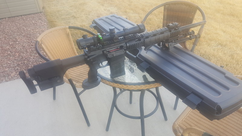

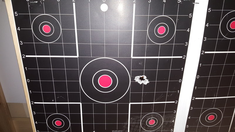

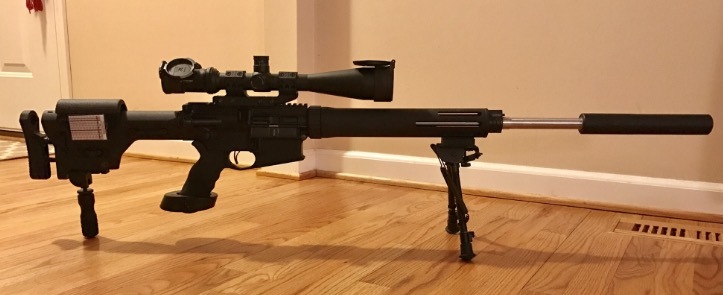

Testing out the "old" site. My JP LRP-07. Has the dual charging upper. I picked it up from another hide member from the scout site. SAS suppressor, Burris XTR II 4-20 in AD mount.
[IMG2=JSON]{"data-align":"none","data-size":"full","src":"http:\/\/i28.photobucket.com\/albums\/c208\/amphotericzenki\/IMG_0819_zpsswwbub9b.jpg"}[/IMG2]
I havent had time to really test accuracy, but I did shoot a quick MOA group out of the back of the truck off the cheap bipod when sighting it in. Smoothest AR platform I've shot yet.

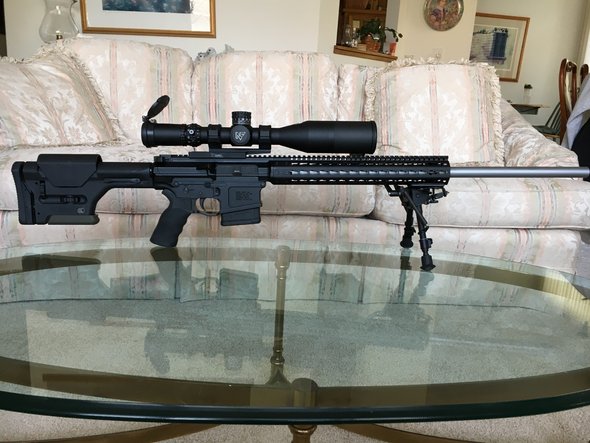

Here's my AR10T.
PRS stock
MDT recoil pad
God-A-Grip cheek pad
ergo grip
Elftmann trigger
JP rifles silent captured recoil spring
SLR Sentry adjustable gas block
TBAC brake
thunder beast ultra 9 30 cal
Accushot monopod
harris bipod
Spuhr mount
Viper PST 6-24x50 (now has a 4.5-30x50 XRS)

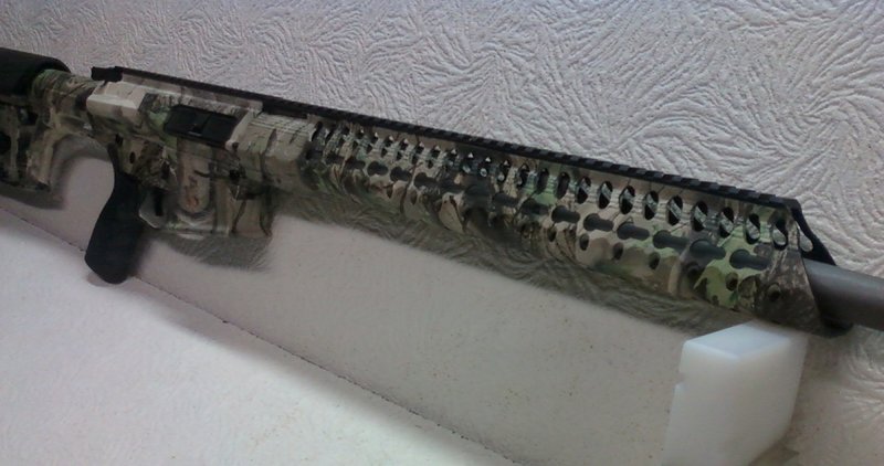

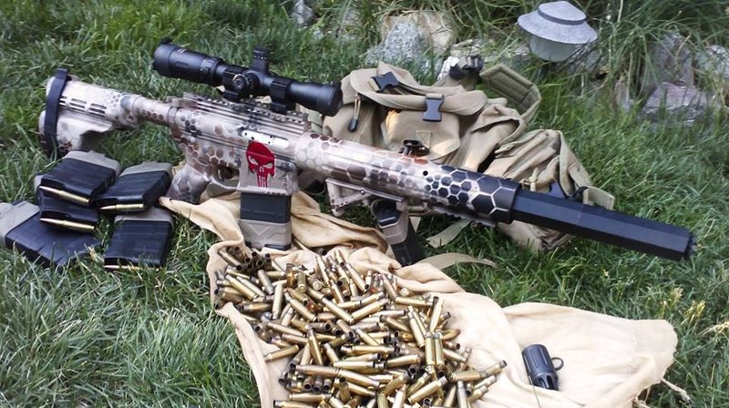

My election panic buy.
Predator Technology Group billet receivers (my buddies company)
Mcgowen 20" Hbar
SLR gas block and 16" SOLO rail
Geissele 2 stage
MOE rifle stock
Houge grip
Bushnell LRS 3-12 G2
[IMG2=JSON]{"data-align":"none","data-size":"full","src":"http:\/\/i.imgur.com\/VHV3lCX.jpg"}[/IMG2]
After Cerakote.......

#24

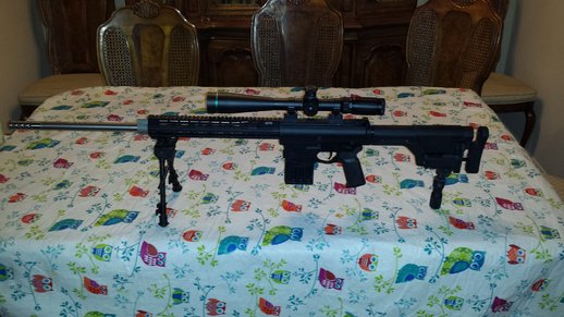

My newest AR-10 in 308 20" Krieger Barrel and Bolt JP Bolt and silent capture USO ER-25 Geissele trigger Mega Maten OSS can Upper was assembled by Krieger

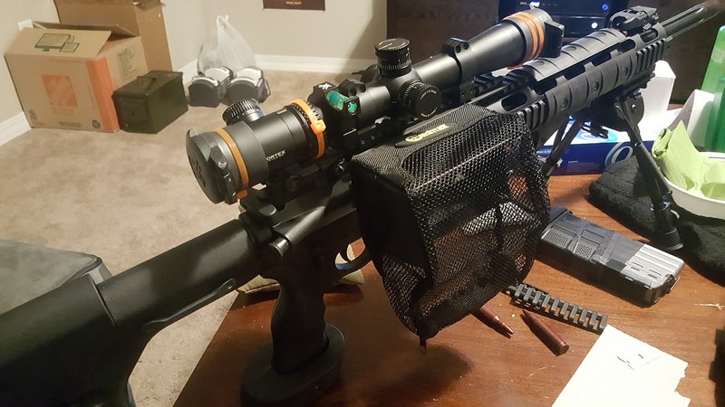

First AR-10 I built Full Mega gun with Geissele trigger and Vortex glass

#32
photo49516.jpg photo49517.jpg My humble DPMS G2 SASS and her first 5 shot group at 100 yards. I wasn't done sighting in, but the range officer called 2 minutes till close of range for the day, so I quickly put 5 down range on my only fresh target. I am now certain that the gun shoots straighter than I do LOL

#34

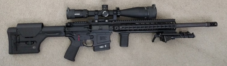

Mega MKM MATEN Mega Extended Rifle Length 16" Key Mod Set
-Geissele Hi-Speed National Match Trigger
-JP BCG with an HP bolt
-JP Silent Captured Spring (Heavy) W/Tungsten Weights
-Magpul AR 10 specific PRS stock
-Krieger 26" Heavy Match Contour 6.5CM 1 in 8" Sans Muzzle Break
-Nightforce 5.5-25 ATACR Enhanced MOAR-T Reticle
-Superlative Arms Adj. Gas Block

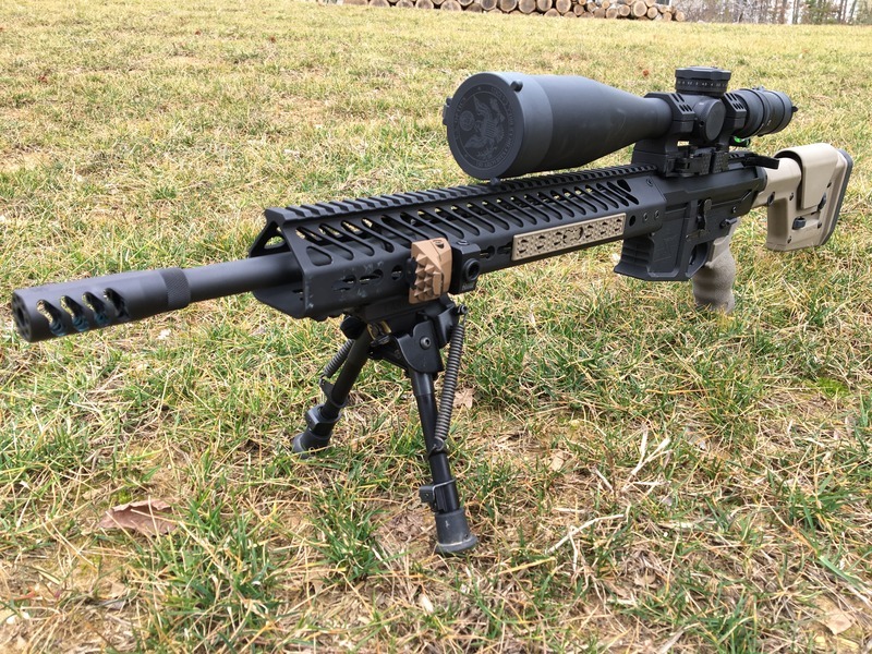

Here is my contribution.
-Mega ambi set
-Fortis 15" switch rail
-Seekins adj gas block
-20" Mega Arms barrel
-Aim nib BCG
-Geissele SD-E trigger
-Silencerco Saker
-Leupold mk8 in Spuhr sp4026 (I love that damn scope) [IMG2=JSON]{"data-align":"none","data-size":"full","src":"http:\/\/i.imgur.com\/2uBRJAw.jpg"}[/IMG2]
She shoots like this with 178amx [IMG2=JSON]{"data-align":"none","data-size":"full","src":"http:\/\/i.imgur.com\/1qKiwSY.jpg"}[/IMG2]
Pretty decent speed for 42.2 grains of varget in a LC LR case out of a 20" barrel [IMG2=JSON]{"data-align":"none","data-size":"full","src":"http:\/\/i.imgur.com\/flrLKbX.jpg"}[/IMG2]

#37
Wish my g2 recon shot that good
Sent from my LG-H901 using Tapatalk
Xinarin13
Belligerents
Mar 7, 2017
47
0
0
#38
Lol, I wish my SASS was as light as your g2 recon!
I'm extremely happy with it! I just worked up the FGMM 175 grain clone load I found on here and she is extremely happy with them :D
Now I just have to work on me and my accuracy ;)

I've fired most SASS platforms and she's definitely a keeper.
SF Edition 18" OBR in 308
Magpul PRS
Larue bipod
NF ATACR F1 5-25x w Tremor 3
M118LR hushed up w the Surefire can
Manfrotto tripod
(Missing clip on NVD,
Silencerco Radius / PEQ15 dep on mission requirements, sorry guys)
Right tool for the job gents.

My first build, 6.5 Creedmoor,
Aero upper
Alexandria lower
Ballistic Advantage 18 " barrel
superlative adj gas block
D Wilson BCG
Luth-AR stock
I did the hydro dip myself, first time don't think it turned out bad

Diamondback
DB10FDE
Parts added
-Leupold Mark 4 4.5-14 scope
-EGW HD rings
-Leupold riser
-Luth AR stock, so I could use a B&T monopod
-Atlas bipod
-Giessele, Hi speed national match trigger
The rifle looks great! and shots even better.
The first time at the range (after I sighted it in) I shot four consecutive groups at 100 yards with Federal Match 175 grain Sierra bullets. The first group was in the center, then top left. I put my Silencer Co Omega on and shot the only group not under an inch on the top right and the last group was bottom right.

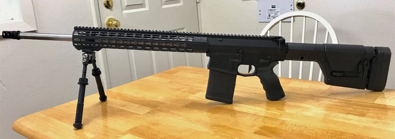

My PRS "Gas Gun".
- Mega Arms MATEN Monolithic receiver set
- Christensen Arms 20" 6.5 Creedmoor Carbon-Fiber barrel
- APA Lil' Bastard brake
- Aero Bolt Carrier Grouop
- Tubbs Flatwire Action Spring
- Magpul PRS buttstock
- Harris 6"-9" Bipod with Hawk Hill feet
- Nightforce SHV 4-14x50mm
