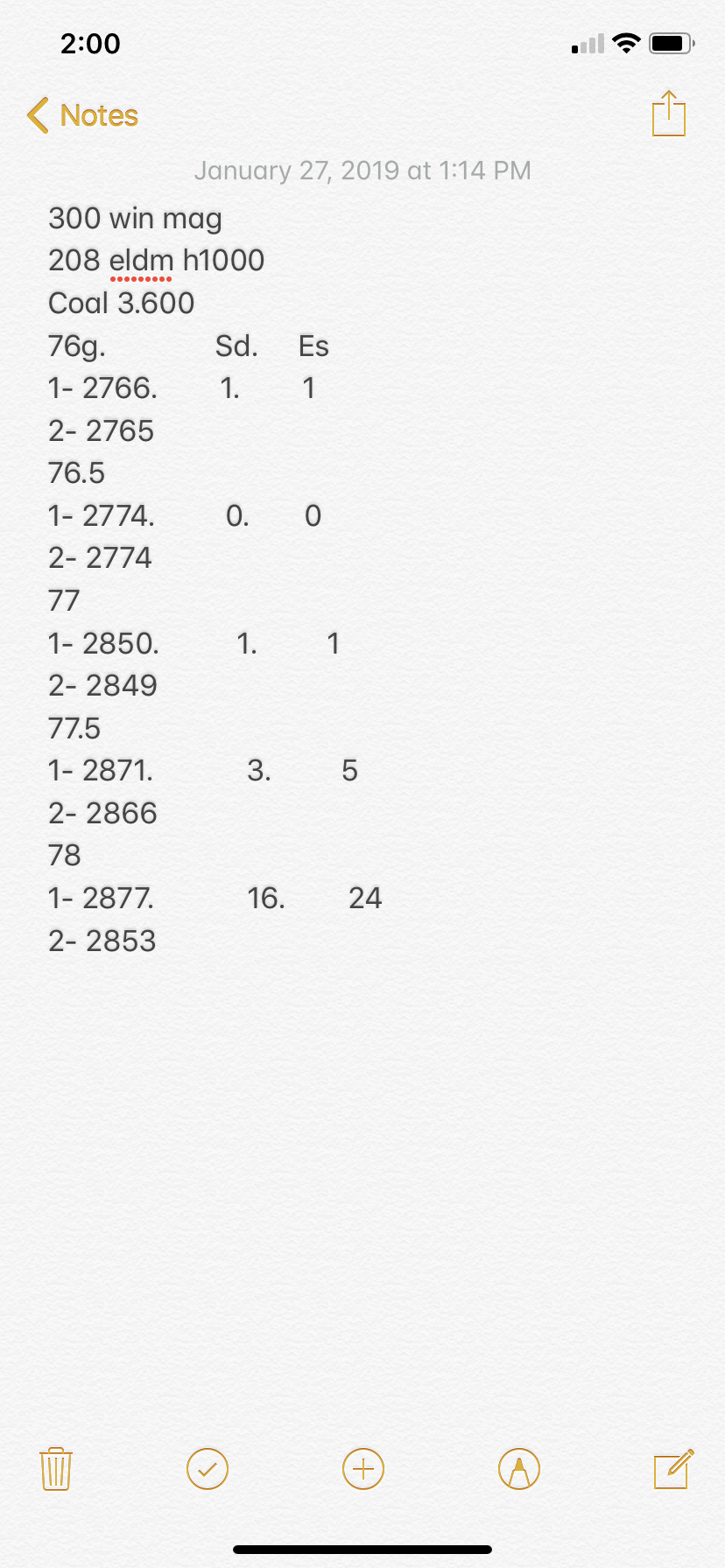

Anybody shooting the 208 gr. Eld-m? Planning to load them in win brass over h1000.
Work and family has kept me away a while, but getting back slowly.
I have a Tac 300 that “really” liked the old 208amax. Sweet spot on that was 76.0 H100 jumping .030. Used prepped and sorted Remington brass and Federal 210s. Working now with the ELDm now that my supply of AMAX’s is about gone. Right now got it nailed down to 76.0-77.0gr with all else same. Next time out will go in .3gr steps to see if anything jumps out of what already is looking good. Then will test for length. Right now, it seems to be just a tad faster than the equivolent in the AMAX. This is using a different chrony though...Magnetospeed then, LabRadar now.
Will report back in a week.

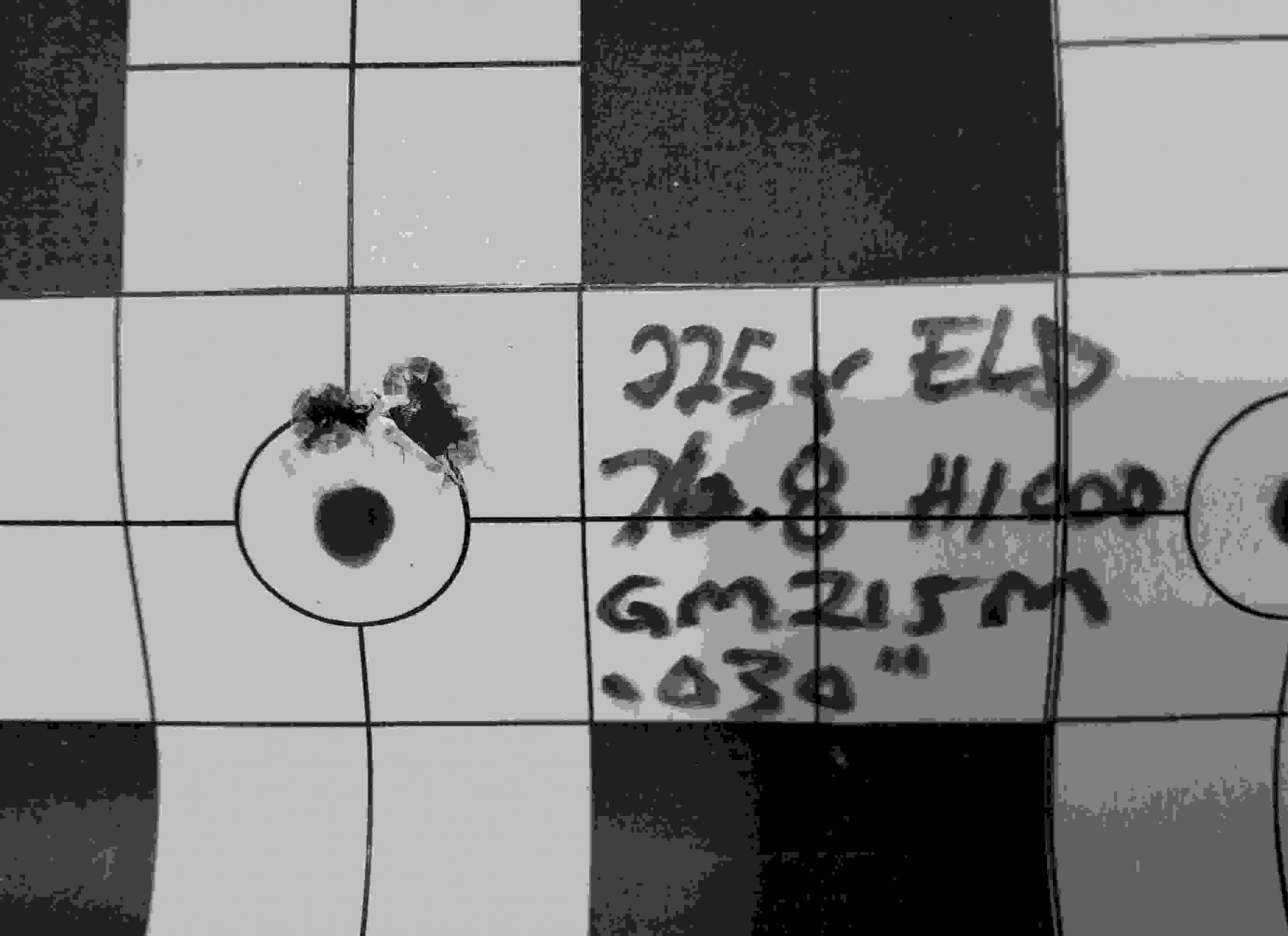

RPR 300 Win Mag. H1000 76.2 gr, Hornady 212 ELD-M touching lands 3.597" OAL, GM215M primers, Hornady virgin brass FLS and trimmed with necks slightly (50%) cleaned up, weight sorted brass and bullets. 2908 fps average (my SDs at 13). Shot a 3 shot group of 1.2 inches and another 5 shot group of 1.25 inches at 300 yds today. Many thanks to this reloading depot for giving me a starting point for my loads(y).
