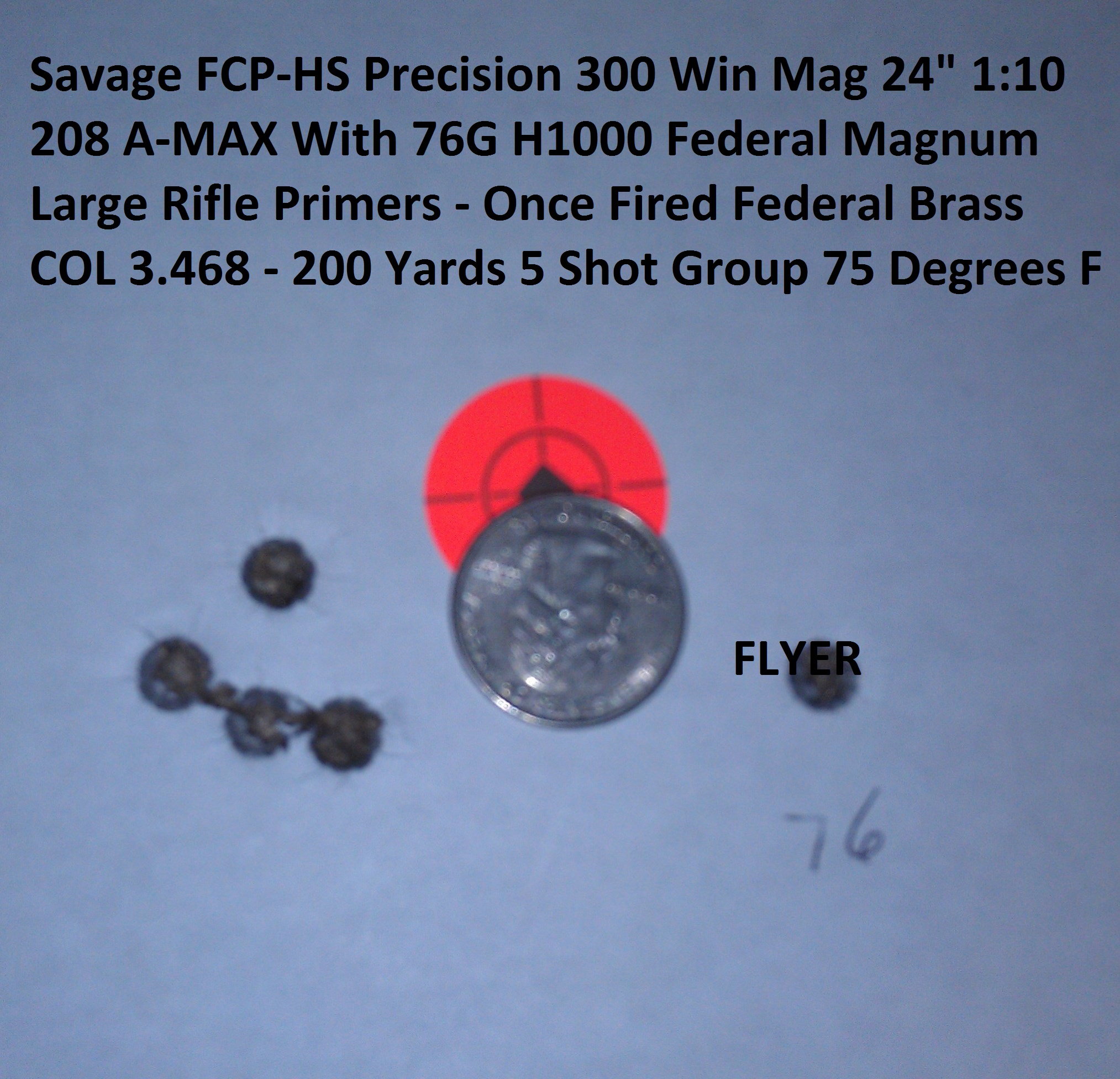

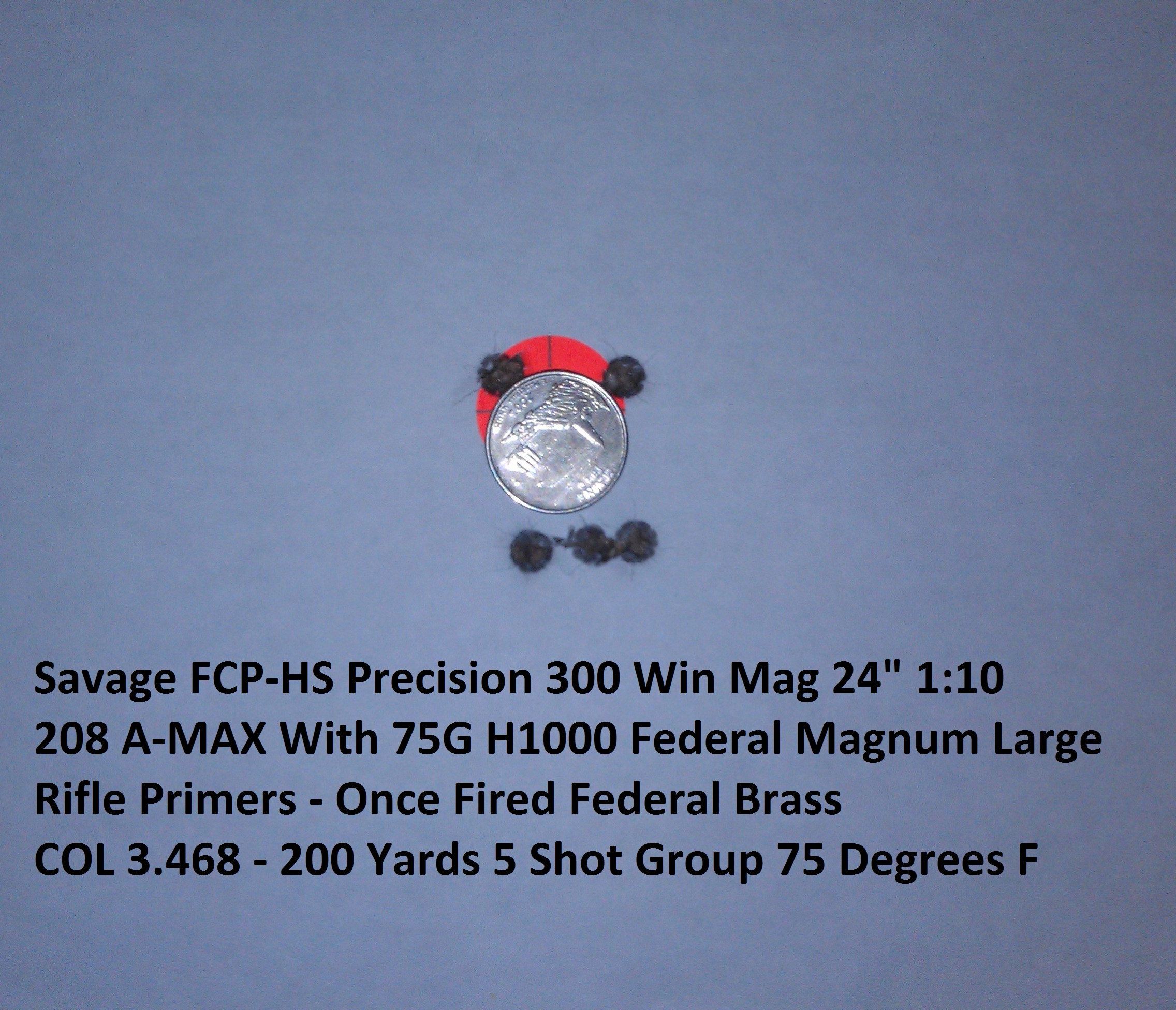

I'm assuming this is the FCP-HS Precision platform with the 24" barrel. I had some initial "good" results with IMR 7828SSC but they were not
consistent with outings. And now I can see H1000 coming back in stock, at least 1lb'ers that is. I went out once with 70 some rounds and the groups
tightened up considerably, even with a warm barrel. I got best from 75 and 76, and for some reason they opened up at 75.5. So I now have 40 ladder loads ready 74.8, 75,75.2, 75.5, 75.8, 76, 76.2, 76.5. I should make some for 76.8 but the original 77 opened up a bit. My AOL is 3.468 and am still having issues where the AMAX tip is getting nicked in the mag. Have you seen this or have you just been doing single loads and no mag? I'm also using once fired Federal brass with Federal Magnum primers. H1000R175.jpgH1000R176.jpg
