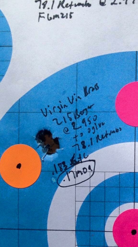

I've not used N570 with the 215's, but it's awesome with the Berger 230 OTM Hybrids.
My 300 Win Mag uses 75 grains N570 with the 230 's, so I'd use the same amount, or back off a grain for the lighter 215's which would theoretically need a little more powder. I use Norma Brass, Federal 215 M primers, and anneal and trim my brass each time.
Just work up carefully, and compare my figures to what Vihtavouri advise.
It's a similar burn rate to H1000.
