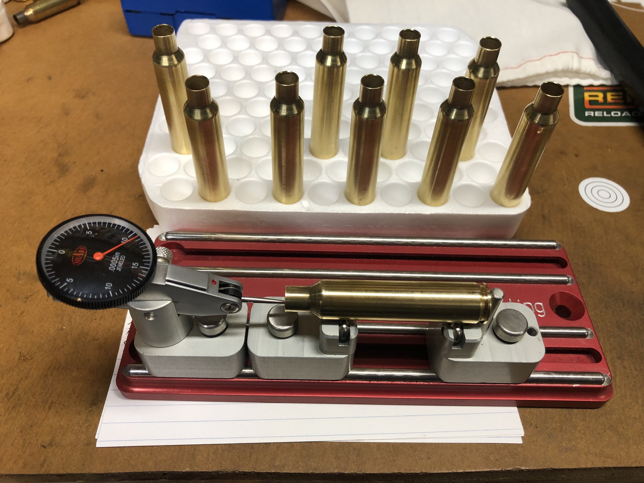

This is great! got an email from RCC making sure the Brass is up to my spec. I don't have a built rifle yet, but was concerned with neck OD (based on SAAMI chamber specs), it's within spec but may be a bit tight in the chamber.
The CAD/CAM engineer turned down the OD diameter some. Really good Customer service on their part.

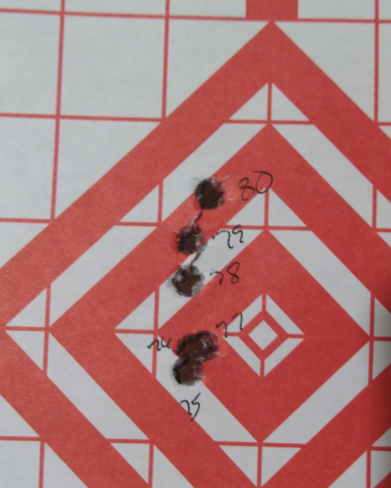

I went to the range today to get the 308 ready for hunting season...and while I was there I decided to shoot some of my load developments for the 300PRC.
I decided to just do a 6 shot test looking for an accuracy node. I used the 225gr ELD-M's instead of the 230gr A-Tips because I have a few hundred ELD-M's that I'm not really going to use...but I can use them in these kinds of tests. I did NOT remember to take the chronograph since I more interested in simply getting the scope on the hunting rifle dialed in at 100yds and as a last minute thing decided to take the 300PRC for the load work up.
So, I did take a few retailed 225gr ELD-M's to see how much different in impact height it was from these work up loads...and to re-affirm Zero. First shot was within half a bullet of zero vertically..so it was good to go...wind was about 20mph right to left.
So fresh target....I shot in order of 75gr, 76gr, 77gr, 78gr, 79gr and 80 grains of Vihtavuori N565. My previous accuracy node using Retumbo on these 225gr ELD-M's was 75.5gr. As you will see...N565 and Retumbo...atleast in my rifle...acted very close to each other.
Looks like the VihtaVuori N565 is ready to play. That accuracy node at 75-77 grains looks really sweet. Probably load some up at 76 grains and work on some seating depths.......but I should be good to go with this load. Brass showed ZERO pressure signs. I'm wondering how far north of 80 grains I can go. Maybe another accuracy node up there with MORE speed... :)
One side note though.... The N565 was noticeably dirtier than ole Retumbo...which was surprising to me.
Edit: Bullet weight errors.

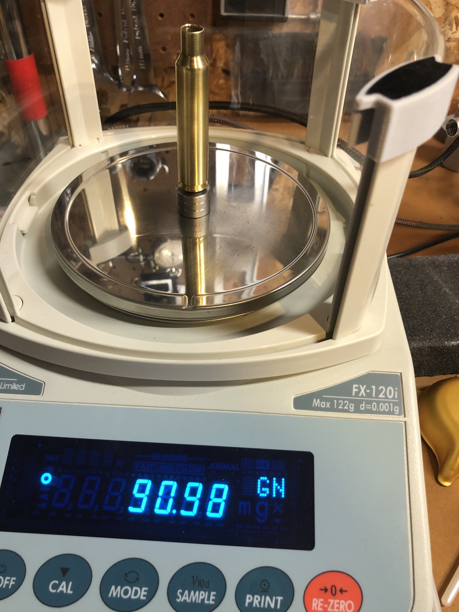

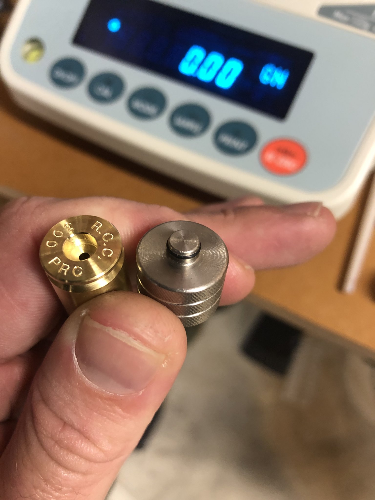

Not that anyone cares, but a Hornady case will hold 95.0 gr of RL 33. I will try an ADG case when they arrive.
Why does this matter? Cause a 6.5 creed Lapua case will hold exactly 50.0 gr of RL 26 and push a 156gr at 3000fps with that 50gr of powder with no pressure and single digit SD. If science can do that, then it can push a 250gr A tip at 3000 FPS out of a PRC. I don’t know what the ballistics are on that, but it changes things.
Reactions: pengilly
You're running the 156 3000 with no pressure in a 6.5 Creedmoor? Or 6.5 PRC?

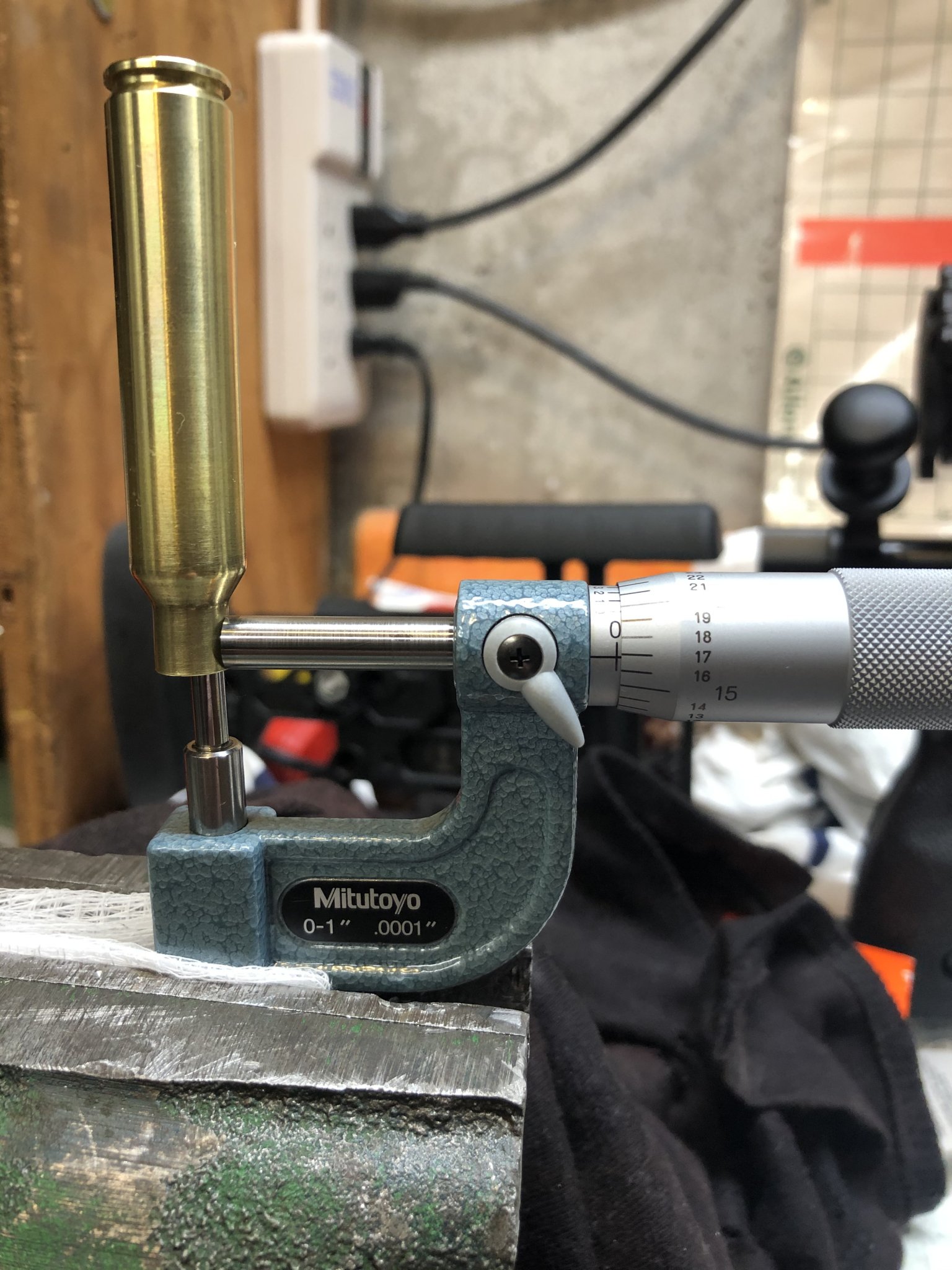

What did you order your neck thickness at? Reason I ask is I'm having trouble keeping 230 BHT's below .75 but this happened after I turned the necks down to .014 (neck variance <.0005, neck runout <.001, concentricity <.001, ES 24). Thinking I maybe should have accepted the .003 variance but kept the lot closer to .016 / .340 OD. Oddly enough the 200 SMK's aren't exhibiting the same variance holding easily <.5 with a higher ES.

My neck thickness will be at .014 i will be using 230 A-Tip. Will tell you what happens later this week i will begin testing. Try different neck bushing put more pressure on it or try bumping powder up untill you reach max pressure. I find my node always right under max pressure. But again be careful, H1000 max is right about 80.6gr with 230 A tip and hornady brass and ES was under 10FPS. I’m at 1100 feet 40 F temp.

Originally RCC had my spec at 0.017" neck thickness. But brought down to 0.014". I don't plan to neck turn
