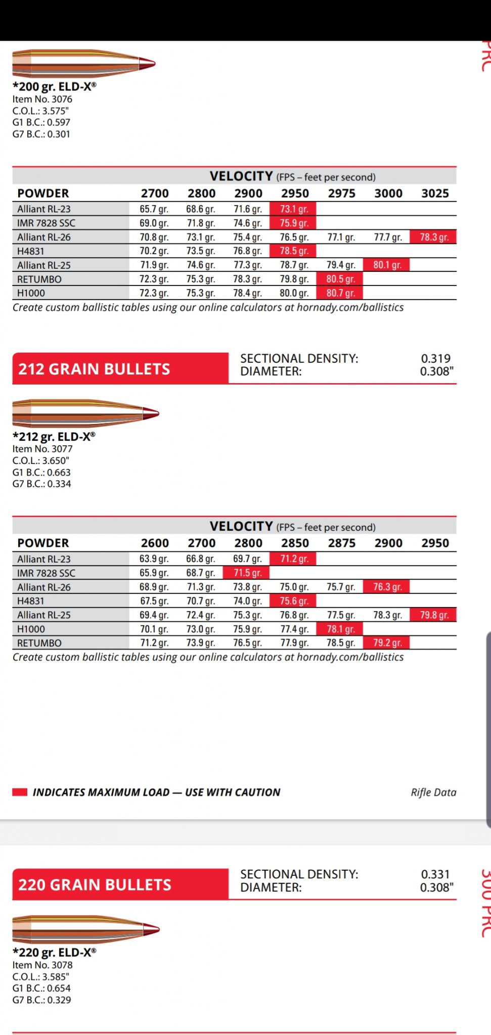

Testing 212s with RL26 28" Bartlien barrel 1:9 CCI BR primers basic case prep. Worked up tp 81 grns of 26 3200 had light ejector mark no stiff bolt. One ragged hole super low SD. Im going to do another ladder and look for a lower node in the 3100s.
jwknutson17
Big Game Hunter
Belligerents
Apr 29, 2017
2,127
1,110
119
Colorado
Dang.. That is some HOT stuff and super fast. Guess that's what you will see when your getting close to 5grs over max.
pengilly
Belligerents
Aug 21, 2007
227
14
22
57
Pengilly, MN, USA
I’ve got a 6 creed with a 26” barrel that shoots super fast too for some reason. I developed a load with the 112 match burners that was 200 fps faster than their max load. It was at 3150. Dropped it down to 3035. Shoots one hole with an es of 5. Also chronoed with a V3. Cant explain it, but I don’t mind it! Lol
I feel like maybe i shouldnt have posted the speed...i assume everybody knows start waay low and work up. Never use anybody elses numbers as a target. Every rifle is different.
Reactions: Joeydias3

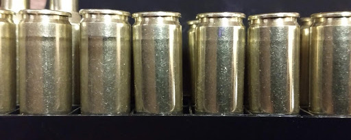

Question: Anyone else getting pressure rings at the base just above the webbing 1x fired not resized?
Merovingian
Oct 6, 2019
37
16
12
Got any pictures ?
1x fired - Not resized - Same result on 225 MATCH & reloads w/ virgin brass (except very bottom end of the ladders.) - **1st Pic - Bases are true, that's camera distortion** OEM/Virgin was -.003 to -.004 at the shoulder and 2X was bumping -.002. No material change to the wall thickness on 2X. Finally got to a point I have to start running 3X but I'd like to see what others are experiencing. I've got a lot of experience rolling my own (.308, .223, 300BLK, 6.5CM, 44Mag, 357 Mag) but this my first bottle neck mag. I'm not used to seeing this before resizing and it makes me twitch.
Merovingian
Oct 6, 2019
37
16
12
What’s the gap between your bolt head and the back of your barrel?
I wish I could answer that with 100% confidence. However, best guess is Tennon 1.503 / Face to Receiver 1.635 so 0.132 +/- with case protrusion .128 +/-. Your question likely just cost me a proper depth mic. :cool: Either way, still just curious how many others are seeing this?
