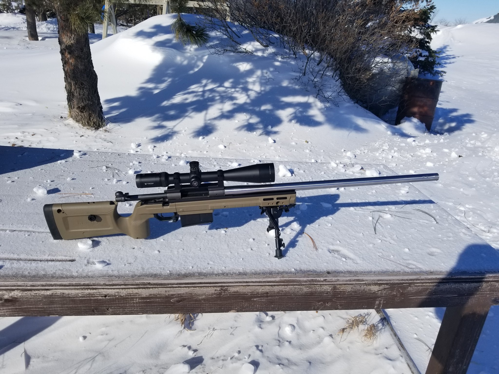

Out of curiosity, why did you go with the lil b brake and not the Fat b?
b2lee
hmmm...good question....most probably because it is a case of go with what you know and have used already.....or I like the target crown look of the lil'b versus the butt plug look of the Fat B. I don't think I put much thought into a choice between them....I was thinking 419...but I went with what I already knew on that choice.
Also, Greg at SPR blended the lil'B to the barrel and it looks like one piece:

This is my 300 PRC that we assembled last weekend. Started life as a Remington 700 300 win. Green mountain barrel 1in 8 twist, KRG Bravo stock, Vortex Viper HS LR. She was easily ringing steel at 832 yards. Was shooting factory 225 eld Hornady. It was 5 moa flatter than my buddies 338 LM with 300 grain federal ammo. Love the cartridge so far.
Using CIP length mags with the 300 PRC?

Planning on running in a KRG Whiskey 3 with Accurate-Mag CIP length? (3.7")

I don't think you are going to be happy with those 3.715" mags...I run the MDT 3.85" metal mags and I can barely place the edge of a Quarter between the end of a retail 225gr ELD-M and the interior wall of the magazine. Now that I'm running some 230gr A-Tips...I'm running awfully close to that inside wall.
I'd probably single feed if I ran the 250's.
Remember...the 3.715" is the OUTSIDE length....the inside length of the magazine says a Max COAL of 3.625"

Just looking at the SAAMI specs... the COAL is listed as a minimum of 3.575" with a maximum of 3.700". So, the retailer could be running toward the high end and not be able to feed into a 3.715" mag whose internal measurement is 3.625" max.
So, a 3.850" MDT Mag has an internal specified max COAL of 3.760"....so if the retailer does SAAMI max at 3.700" you only have 0.060" left over...and the thickness of a Quarter is 0.069"...so yea..that's about what I said I had left over.

Then you'll love those mags....I just wanted to clear up some confusion others might get if they read that the wrong way....I know people build a rifle and pick out all the parts...and then BAM!!! their chassis won't support the mag length they need...and then it is a frustrating mess.
