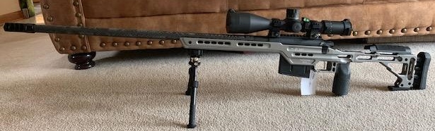

I just got my new 300 PRC ... been waiting for 5 months for it! it's built on an MPA ESR chassis with a Defiance action, a Hart 1/9 29 .75 inch barrel, a Yankee Hill suppressor, and a triggertech diamond trigger. It has been a tack driver, just got i zeroed and hit two small bull's-eyes at 500 yards. I intend for this gun to go out to over 2000 yards, and with the Valdada Recon G2 scope I have 35 mils of elevation!

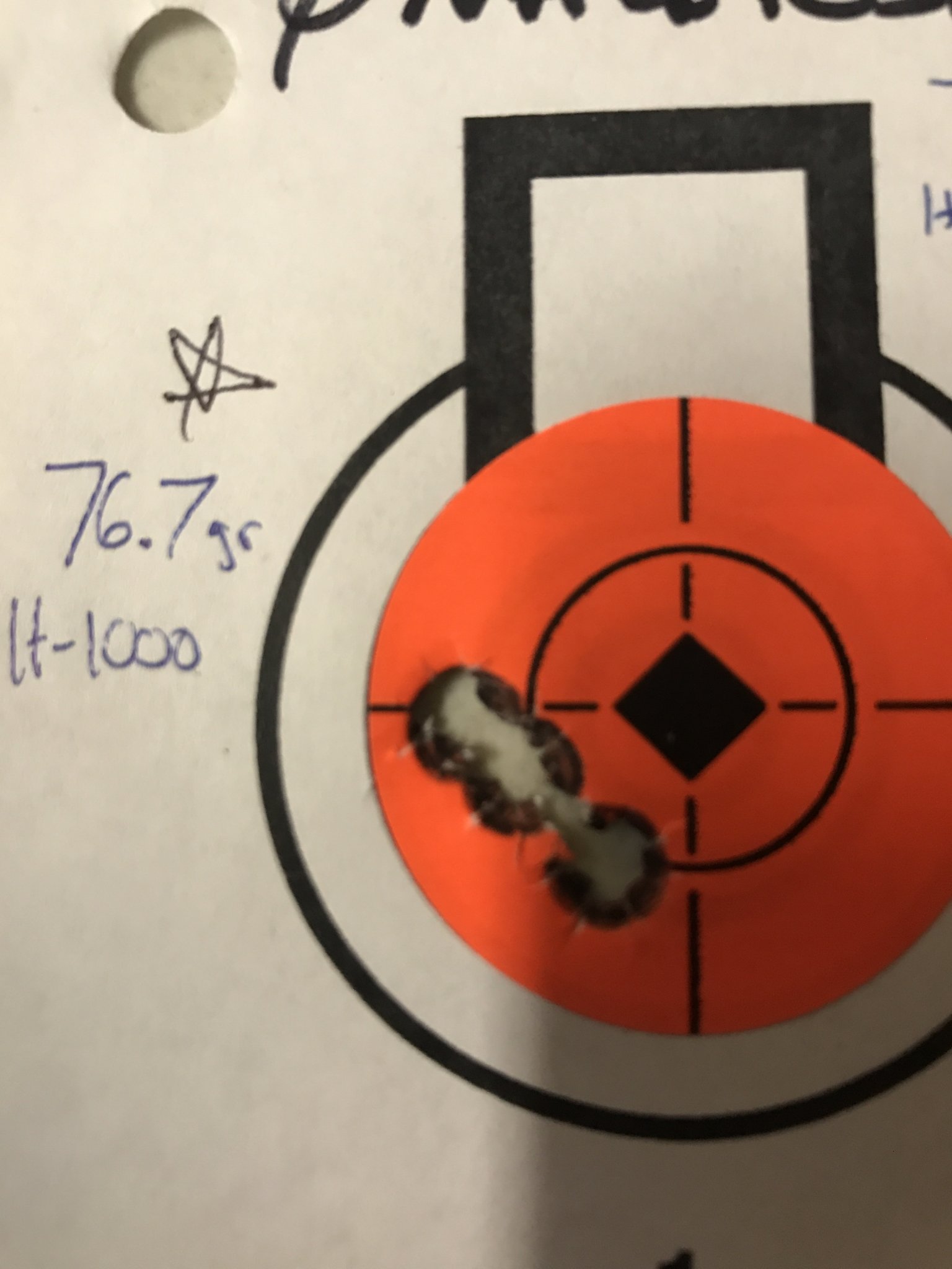

Got mine on paper tonight at 100 yards. I tried 77.0, 77.5, and 78.0gr of H1000 behind some 208 ELD's. 1 of the 3 groups (5 rounds each) had 2 holes, the others all piled into 1 hole; 0.25-0.5" groups judging from the scope, I didn't go down and recover them. About 25fps ES and upper single digit SD's with 77.0 and 77.5, and a little worse with 78.0. I have 25 rounds through the barrel at this point so I imagine it will pick up a little speed as things progress, but the 78.0gr load gave an avg. of 2981fps in my 31" barrel. Cases/primers look fine, super easy extraction, and I think there's still room to boost it up if I wanted to.
Up next I'm going to try RL26 and 225's I think. At this point I'm just trying to get 50 fire-formed cases first before I start any serious load development. So far things are looking very promising, though.
I think you have a lot of room with H1k. Few guys I know run 80+gr of H1k with 215 Berger's over 3k in 26 and 28 inch tubes with no pressure. I have settled in right around 79.0 range. Still playing a little in there. 26 inch tube with 215s at 2950 now the barrel sped up a little. Hit first pressure in one of my guns at 81gr H1k with the 215s. 3050 fps.
I would think with a 31 inch tube and 208s you should be in the 3100 range. I would keep going til you found pressure and back down.

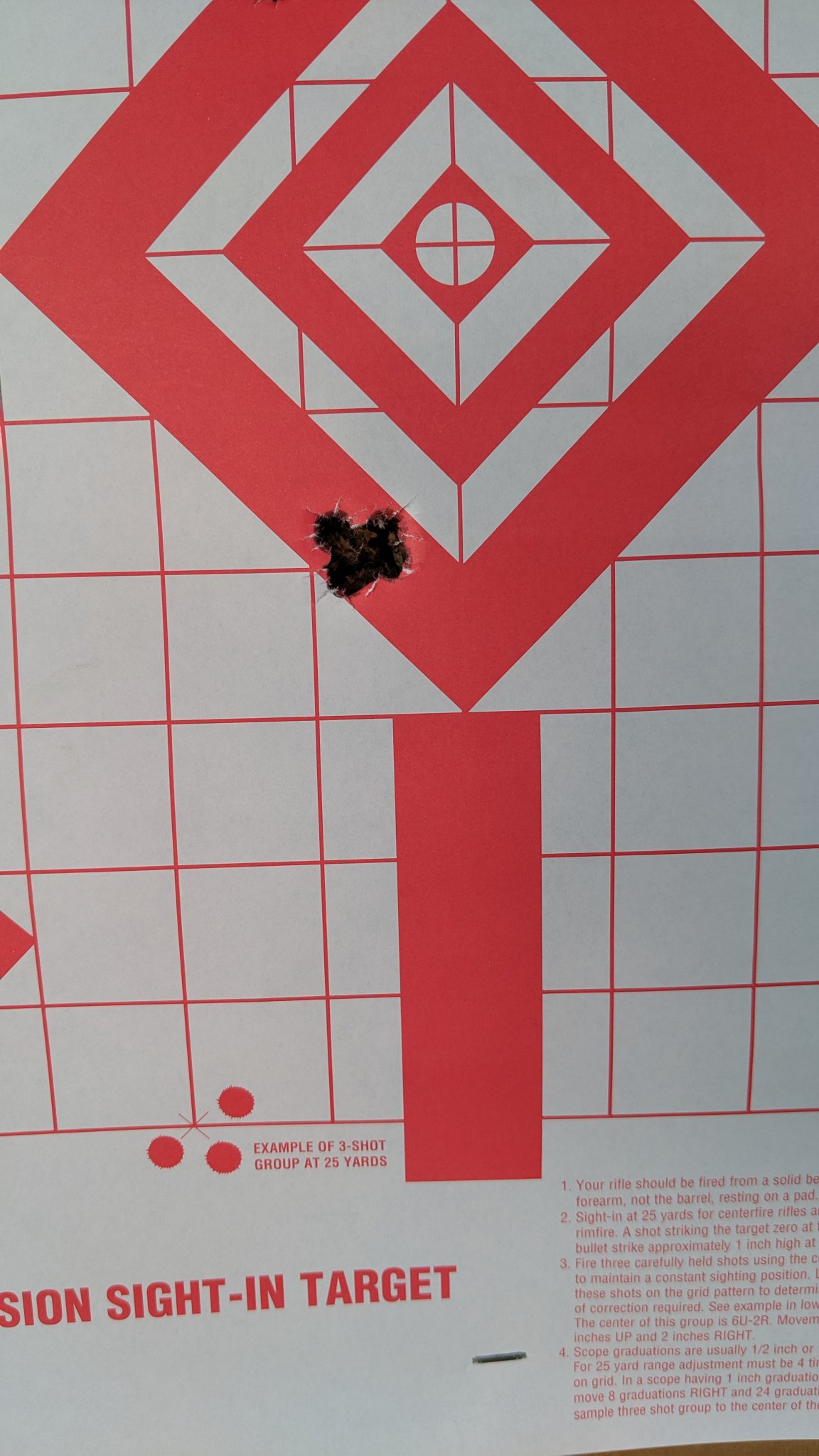

RL26 with 225 ELD-M @ 2.680" COAL
31" Bartlein 5r, 1:9.5-1:9 gain twist
Virgin Hornady brass, CCI 250
Rounds 26-50 on a new barrel:
-74.0gr SD 12 ~0.6" 4 shot group (fouler omitted for SD and group)
2860 <---fouler
2884
2881
2900
2910
-74.2gr SD 13 ~0.7" group
2866
2882
2894
2901
2898
-74.4gr SD 8 ~0.4" group
2905
2902
2888
2910
2893
-74.6gr SD 4 one big knot, 0.25"
2910
2914
2919
2913
2921
-74.8gr SD 6 ~0.35" group
2922
2935
2923
2924
2918
Got all of my cases fired, so I'll resize them, bump the shoulder as little as I can manage and test again around 74.4-74.8, then take it out to stretch its legs. Might be a week or three before I get around to it all.
