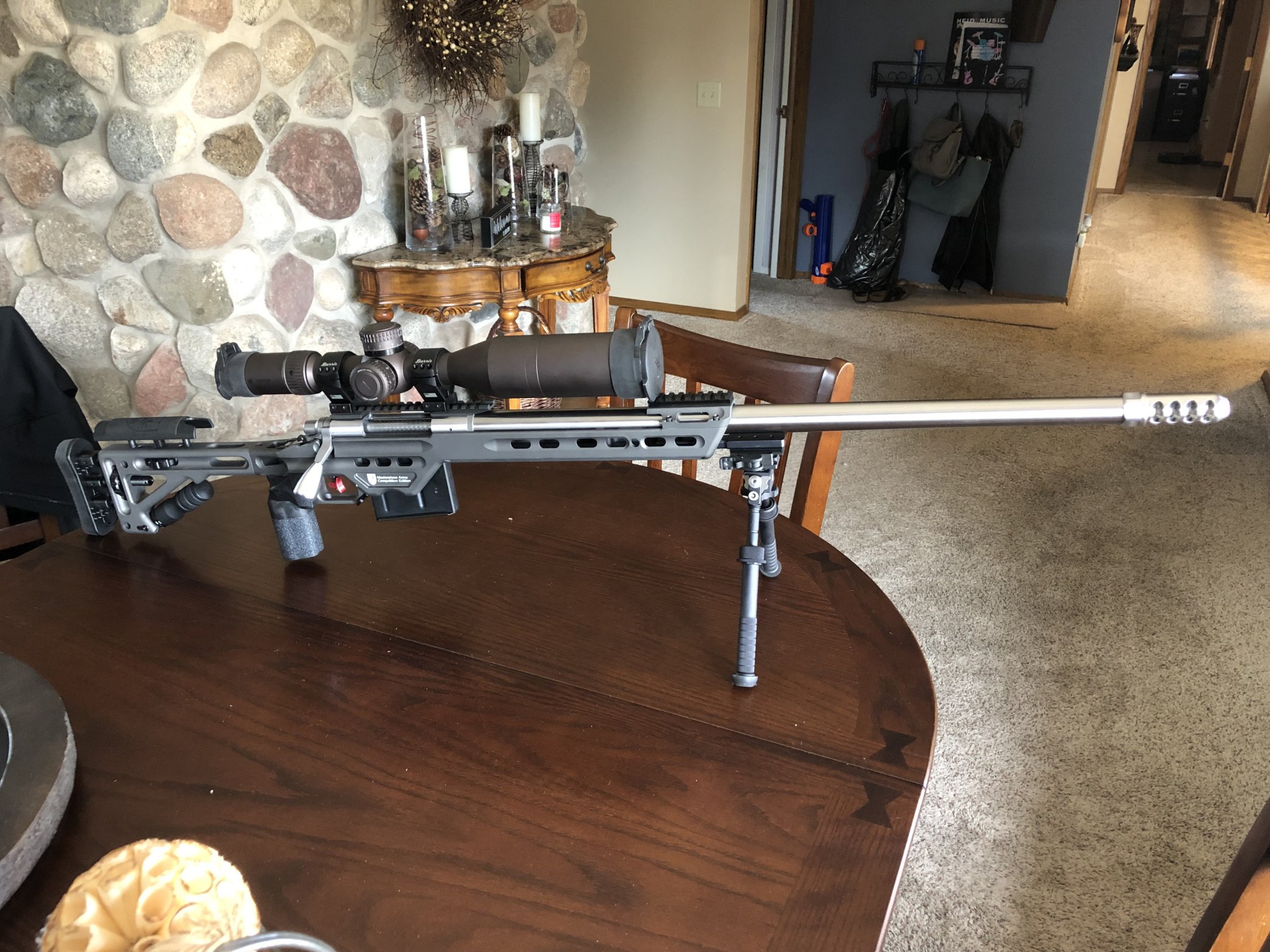

Rifle with the new scope (albeit temporary until my new build gets done):

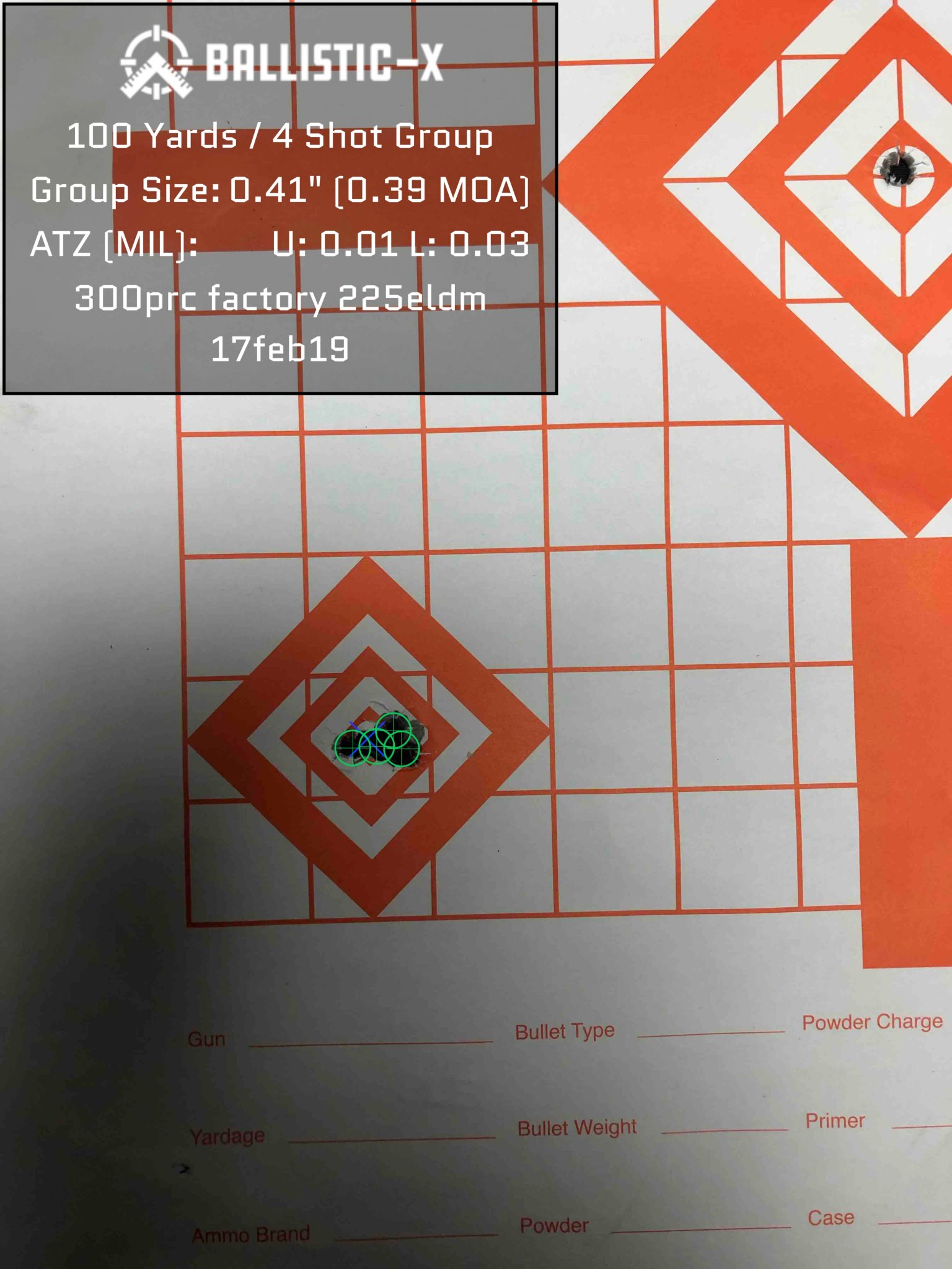

Have my 300prc all together and working good. 26” Bartlein m24 barrel. Broke in with hornady match 225g. Then shot a few groups with the factory 225g. .4 MOA groups. Loaded some rl26 from 74.4-75.6 with 225eld. Didn’t work very good. +1 moa. Using 215m primers. I pulled 3 factory bullets and weighed 74.0g from each. Thinking I may need to work down from 74.4 to 73?
