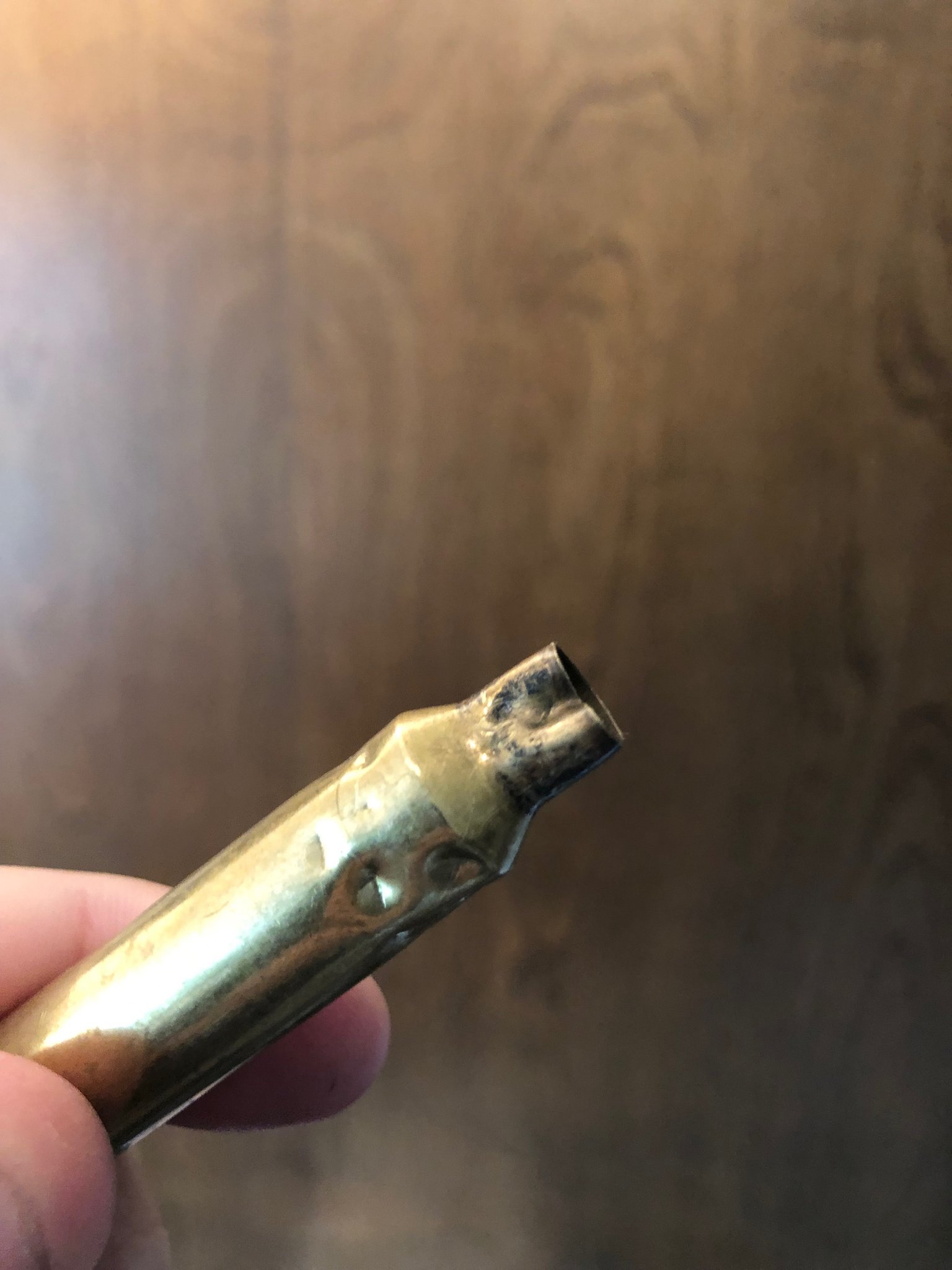

Never seen a carbon mark like that
It does look kind of odd. If doctor hadn't said it was a carbon mark, I would have said that something is wrong with the brass. If you look closely at the edges of carbon marks, they tend to be diffuse, as they are made by gas. These marks have very defined edges - I don't see how the finger-like markings in the first image could have been made by gas. I would suggest sending a picture to Hornady and asking them how these marks could have been made.
The gas marks are consistent on every fired brass that I have out of my gun. Something is wrong.
For a gas to make hard edges like that, the unmarked portion has to be completely sealed. Conceivably, the brass could be expanding and sealing against the chamber before the round exits, but I wouldn't think you'd get those sort of irregularly shaped lines. Do any two pieces of brass have the same or similar patterns?
All the brass has those findings. I should and will check concentricity. I'm guessing something is off with the chamber

I would index 4 rounds with a witness mark, single round feed with said mark into the position of 12, 3, 6 & 9 O'clock.
When fired does the carbon mark always end up in the same spot relative to the chamber? Or does it follow the
concentricity of the brass?
On my larger caliber rifles I anneal after each firing. It will not hurt your brass if done properly and it keeps
the neck/shoulder area flexible allowing the case to expand during the firing cycle which helps with several
issues.....neck tension, sealing the chamber etc. Although this is not a cure if the neck of the loaded round is way too
small vs. chamber neck size.
I hope this makes sense? It did when my little brain typed it out :(
Respectfully submitted,
Chet

So what's my options? Just deal with it and move on?
I recommend to my customers to always start with new brass. The reason is 99.9% of the time, if there is a problem it's traced to the brass that's been fired in a different chamber. Not all reamers are the same size, close but there are -0.000" + tolerances. Then the chamber. Not everyone cuts the same size chamber even using the same reamer.

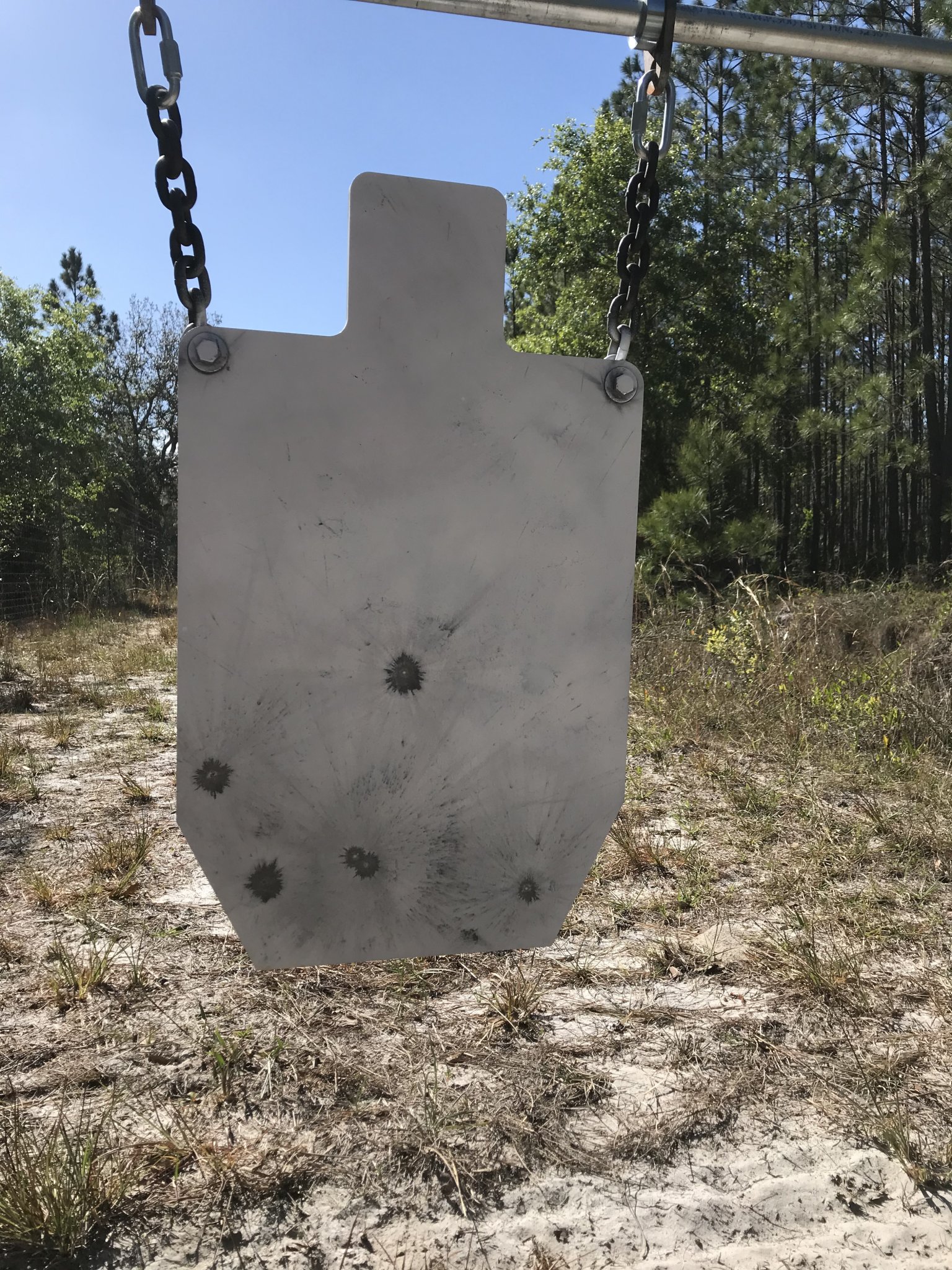

Took the AXMC w new 28” 1-9 barrel I found online while I wait on my 2nd blank. 1050 yards with 2mph to 4mph wind. I did take it to 1,100 too with better conditions and it was a hammer. “Disclaimer”, I am still learning to read the wind...
This is factory hornady 225gr load load and SD was around 8ish.

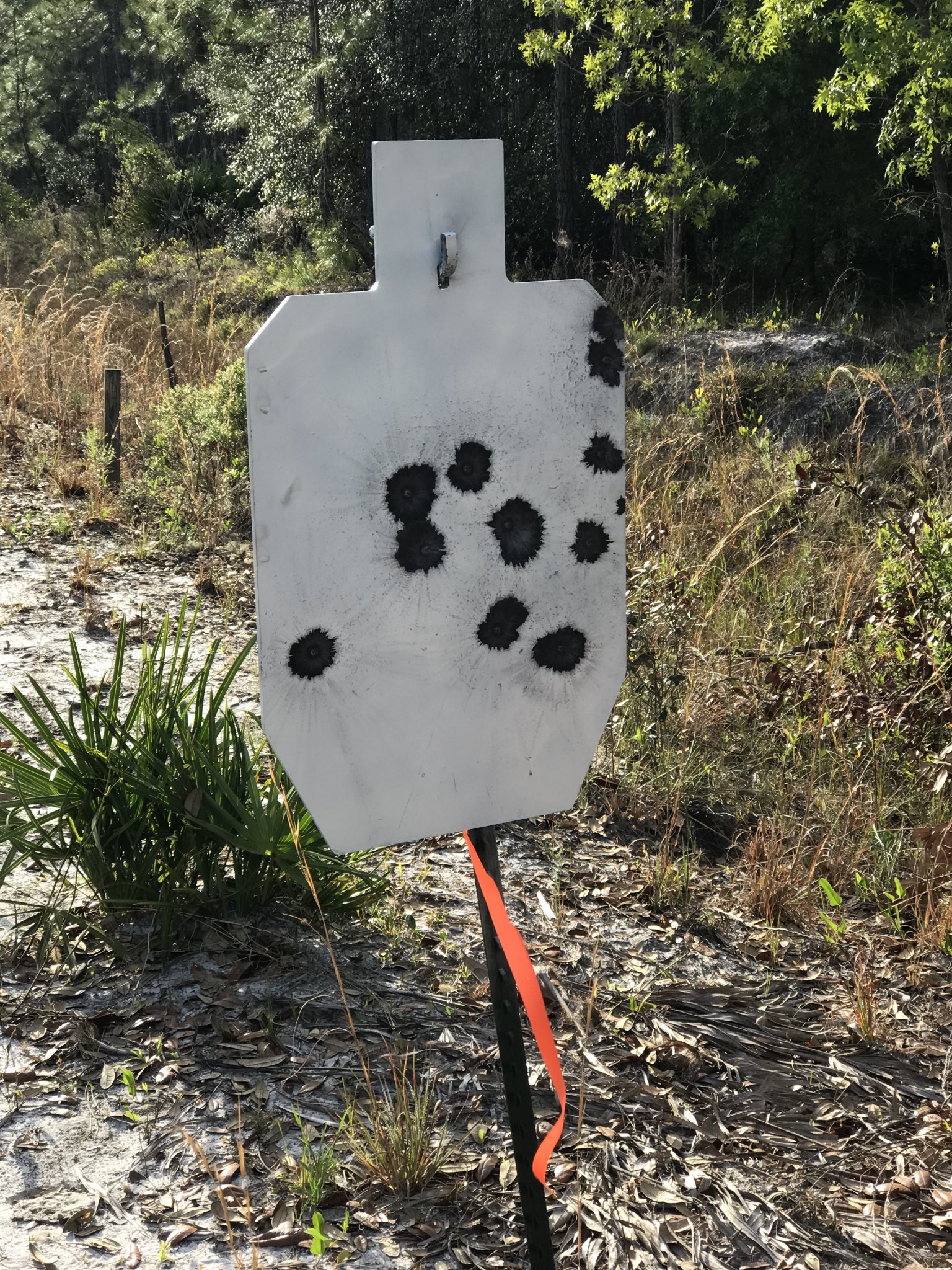

I am a fan boy of the Berger 230gr OTM.
Loaded H1000 and 230grs 0,020 jump. Using regular rifle Federal primers.
75.9gr H1000 2849 FPS SD9.4
76.2gr H1000 2859 FPS SD 5 “some pressure”
76.5gr H1000 2875FPS SD 7.8 “pressure”
5 shot lots, all three were one big hole at 100 yards.
1.9 twist 28” barrel
I am here to tell you that the Hornady Factory loaf ain’t with H1000 for what I can tell.
I am getting 2930 FPS with Hornady 225gr ELD with NO pressure at all.

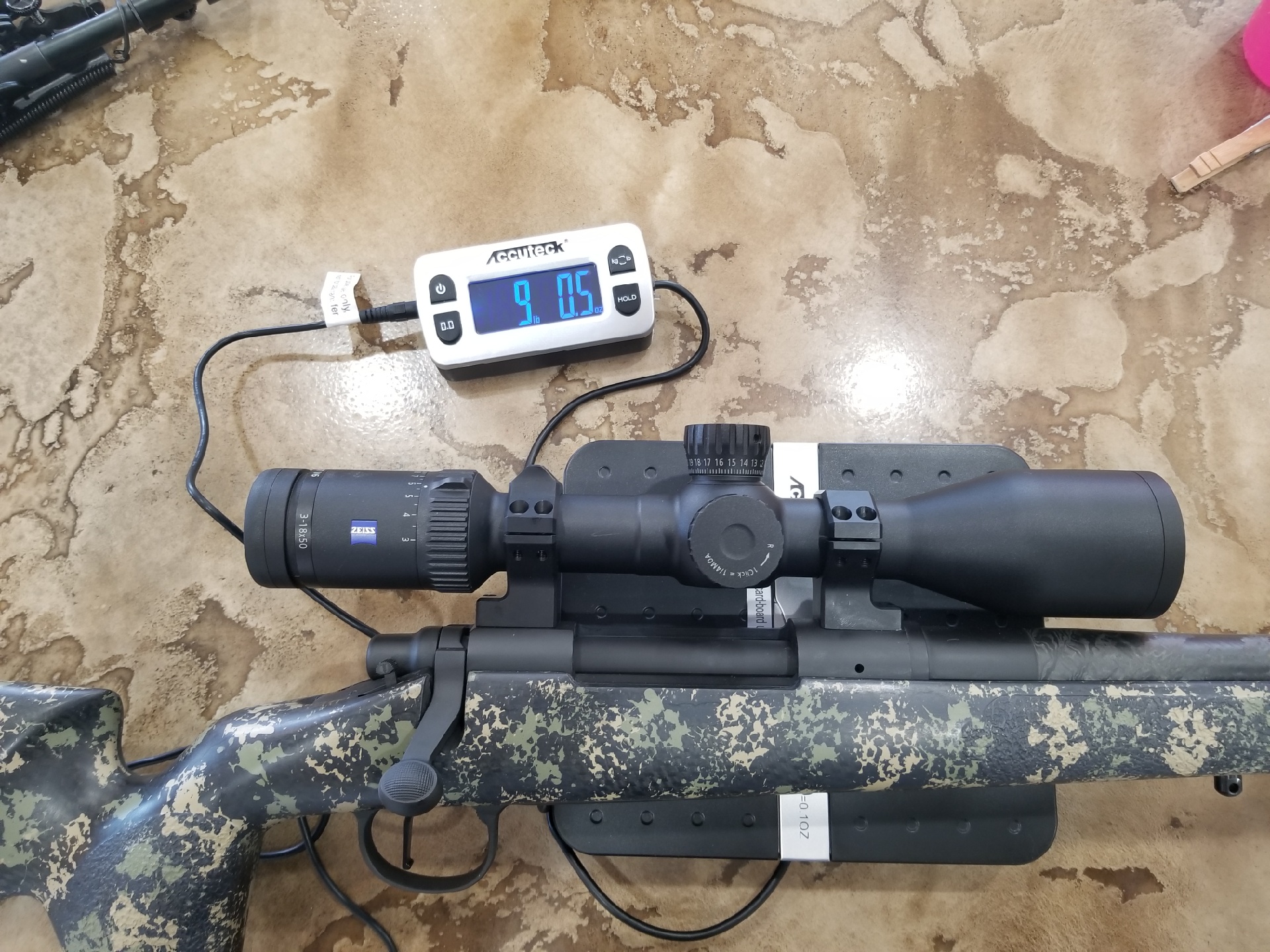

Personally for me anything over 12 lbs loaded up is kinda overkill on a hunting gun specifically. I prefer good glass and that's why I set my weight to that. About 2.5 lbs for scope and rings. Could be little more if using a spuhr mount or alike. Maybe a pound about in mag, ammo, sling. Leaves you 9lbs for rifle, brake, maybe a TB ultra can, and maybe skip the bipod for hunting. I use shooting sticks. If you have a pound for a can and brake, you are at 8 for the gun. This is my top limit on high country hunting guns where I will be hiking a lot every day at elevation.
I am not weighing parts on every gun. I usually choose my parts that tailor to the job, then look at the weight. If it's going to get too heavy with my ideal parts, I then consider buying different parts as substitutes. With the CF proof sendero barrels and Manners CF stocks, it's pretty easy these days to get the weight down without sacrificing.
Lot of guys are looking at super light guns on magnums. And for me, they are much harder to shoot and recoil like a you know what. I would rather carry the 2 extra pounds personally.
