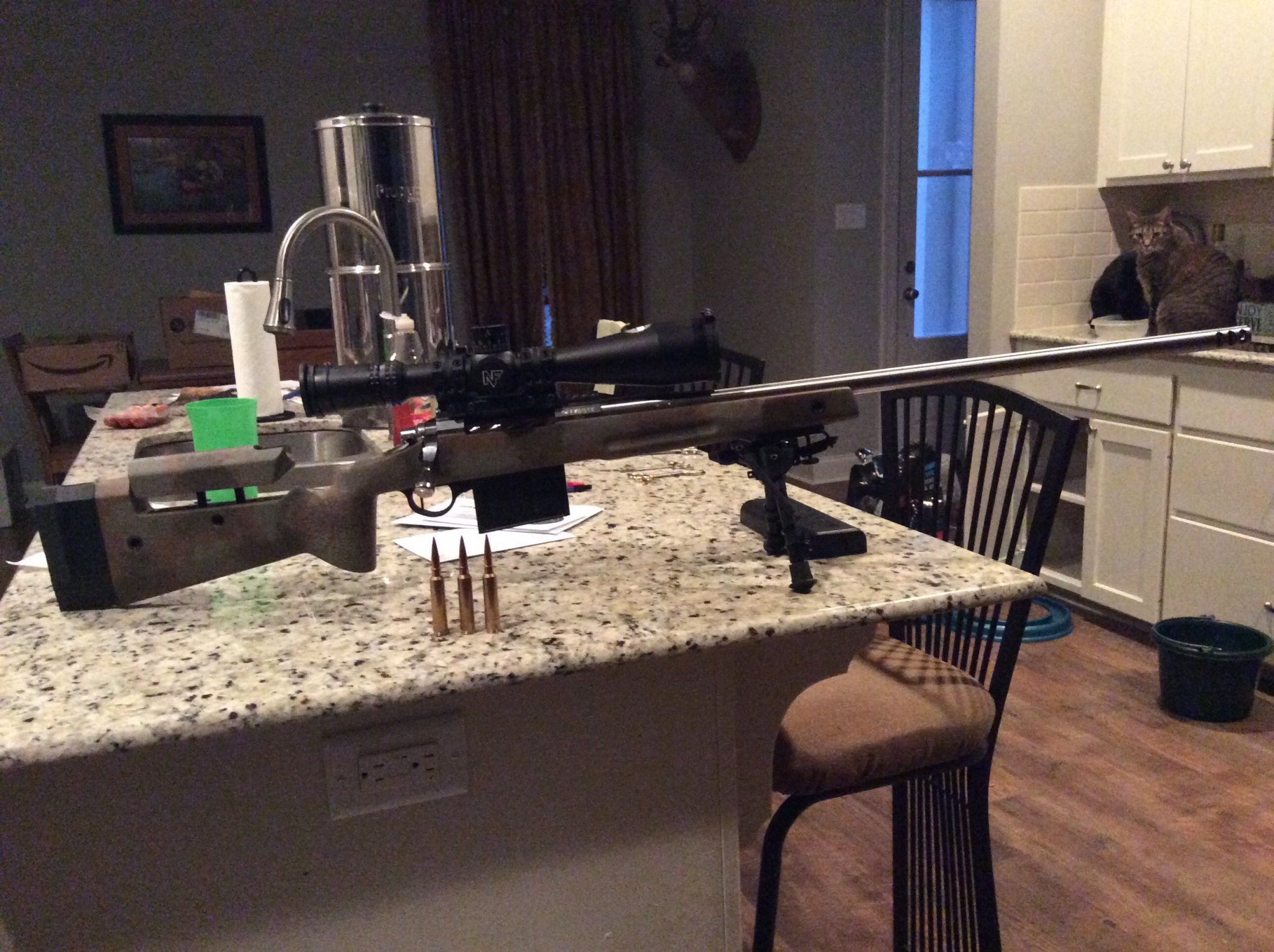

thought I might give some insight to my 30 Nosler that I built late last year and could get some idea of how my set up compare to the 300 PRC. I built my rig on a Defiance deviant with a Bartline sendero contour 1:9 twist. It was chambered with a reamer specifically for Berger 230 hybrids. I sent Manners the seekins 338 CIP length bottom metal to inlet a T6A stock. I'm running 82.5grs of Retumbo at 2,925 fps. I went to 84 grs but only got ~60 fps. I have 2 pounds of 8133 and hope it will be the next step. In a shit storm at the moment as a veterinarian student so I have not given this rifle the time and love it deserves. It weighs 15 pounds on the nose with a NF ATACR and Suphr mount.
