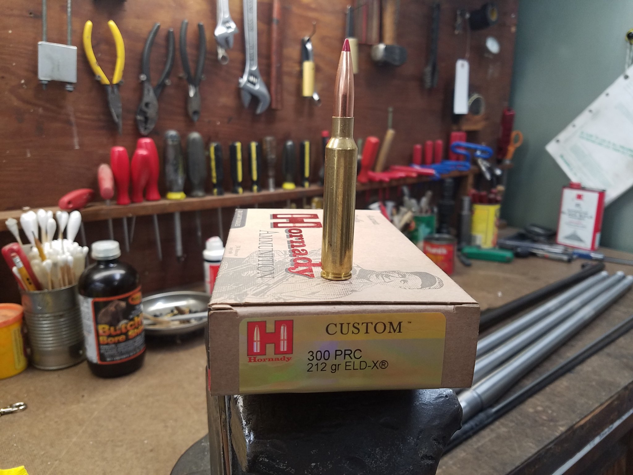

I do. Please keep us posted, I’d love a Win Mag without having to fuck around with the belt. Is there a pic or a print somewhere of this cartridge?
