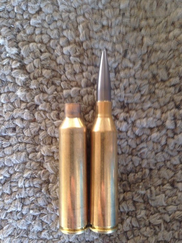

My Norma Improved has a 30° shoulder. 1:10 Bartlein is stoopid accurate with 215Hybrids, irregardless of load. I neck down .338Norma brass to make a false shoulder, then blow em out with an old batch of RL-25. FF load shoots in the same hole, and formed cases do the same thing. Finished load is 91gr. Retumbo, which nets 3155 avg.
Example of FF accuracy: B6895F93-6D15-4906-90E9-858635F2E774_zpsqkhqe5j9.jpg
formed case, capacity increased to 110.0gr B1CA83F8-55AE-4D54-88E7-6304300FC2F4_zpsngswozwl.jpg
Have a custom Whidden bushing FL sizer die, and my 'smith reamed out the sleeve of a Forster .300Norma seater die for a perfect fit. Makes for straight ammo, the rifle does the rest!
