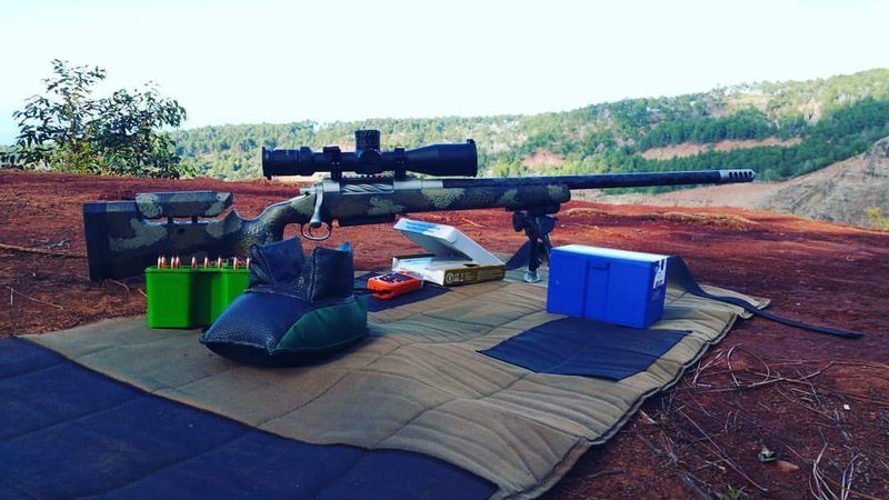

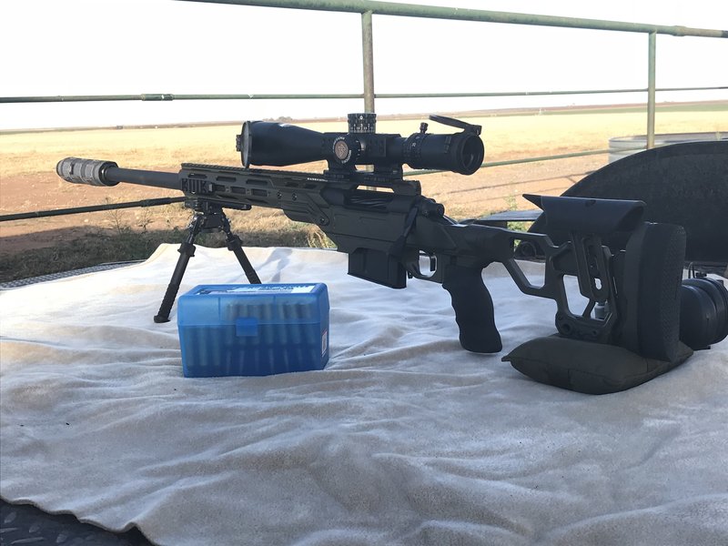

I'm running a 26" carbon fiber Proof Research barrel. My initial load development looks like this.
230gr Berger Hybrid
1/9 twist
CCI 250 primer
92.6grs RE33
2972 fps @ 6.1 SD
There were great nodes at this velocity and at 2880 fps. This barrel still has less than 100 rounds through it, but I needed a load to take it elk hunting. So this is it. My Proof barrels in the past have usually picked up about 120fps by the time they hit 170 to 200 rounds. So I'll rework this load after I get it broke in. I'm sure I'll be able to drop that powder charge down and still stay on that node.

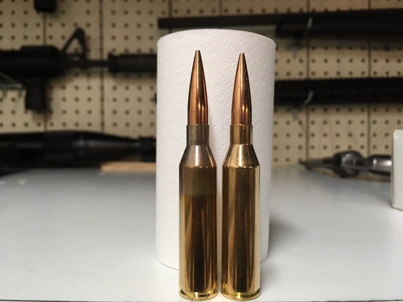

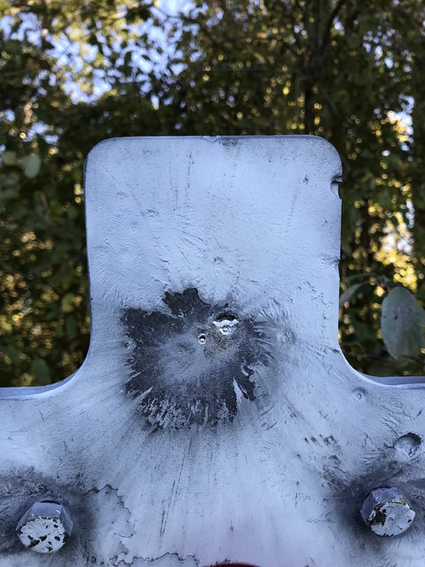

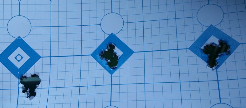

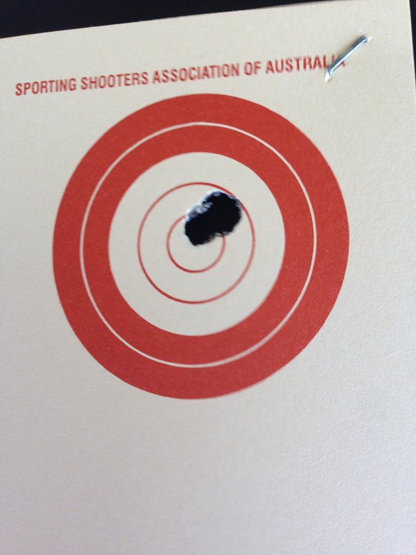

Shot this group yesterday evening. 3 shots, 356 yards, 2/3". This is a hot load but the accuracy speaks for itself!
215 Berger
88gr N570
2.815" BTO
SD: 11.1
3170fps
I am shooting the 215 Berger right now too. I am really impressed with them. I shot this group last weekend at 765 yards. Not to bad for a brand new rifle and this was my first shots fired out of it.
Sent from my iPhone using Tapatalk

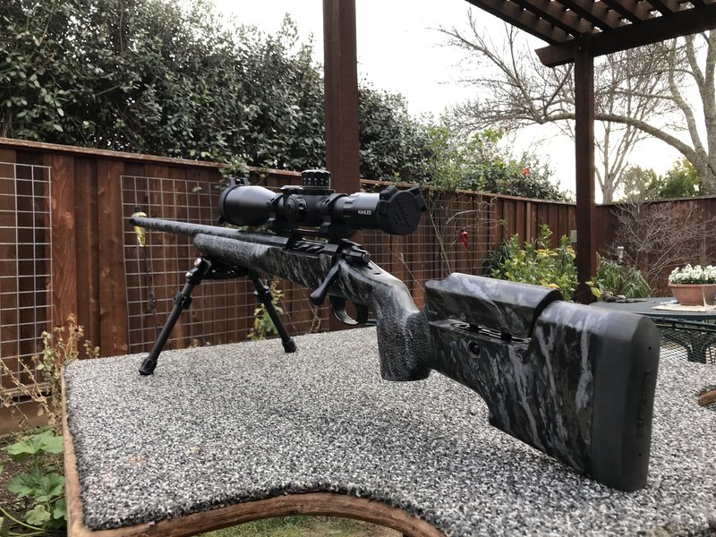

I dropped a nice little 5x6 bull elk with the 230gr Berger Hybrid this past Sunday. The rumors that the big Hybrid makes a pretty good hunting round are true. My bull made it 14 yards from where i hit him. Post mortem showed the bullet performed perfectly.
[IMG2=JSON]{"data-align":"none","data-size":"full","src":"https:\/\/i.imgur.com\/cTHCqcQ.jpg"}[/IMG2]
[IMG2=JSON]{"data-align":"none","data-size":"full","src":"https:\/\/i.imgur.com\/txO3hnz.jpg"}[/IMG2]

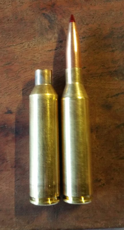

Hi there guys
i loaded up 230 berg in my 300 NM with H1000 84.1 got av 2900 fps very tight group at 100m
though using NORMA brass using 215 Feds I noticed after 1 and 2 firings 2 of the relaoded brass the 215 where loose .
set my die FL sizing die to match as close as possible the gun chamber is it the brass pressures are good fr this load any ideas anyone ?

88.0gr N570 & 215FGMM
3.600" OAL
215 Berger hybrid
1-10" twist
28" barrel
3150fps avg
What a hammer! No pressure signs and extremely accurate. Shot several sub 1" groups at 356y.

69
Brisbane Australia
#62

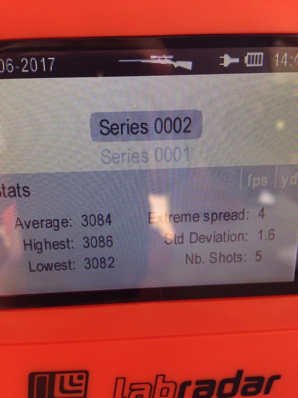

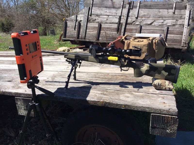

Trentech 300 Norma Mag Improved .
Maddco 9 twist 27 inch
Trentech Taipan custom brake
85 grains of 2217 ( H1000)
CCI 250 primer
215 Berger on lands
3084 fps average
ES. = 4 fps SD = 1.4 / 5 shots .
Group is right on 0.2 for 5 shots .
This is my gunsmiths rifle , I have the same chambering in a Bartlein
9 twist , in an XLR chassis with a Terminator T4 brake . My ES was
similar but only 3 shots as I’m conserving barrel life . The Trentech
Taipan brake is much nicer to shoot than the Terminator T4 : similar
recoil reduction to the T4 with much reduced concussion / blast effect
at the shooters position .
We had issue with hang fires using the BR2 primers we had lying around .
Swapping to 250 Magnum primers eliminated the hang fires and got ES
down from the 30’s to 20 or so .
The biggest benifit to ES and group size was annealing the brass with
the AMP annealer from NZ . This annealer is fantastic : the numbers on
the Labradar ( see photo evidence ) and the group size doesn’t lie . As a
result of this test , I’m annealing every centrefire case every loading , with
the exception of my ancient Enfield which I shoot with irons .
EDIT : there is a very nice node around 89 to 91 grains , but with Norma brass
it is not usable in this application . Trentech Engineering is looking at a system
to re-size 338 Lap Mag brass to 300 Norma Improved : a lot of work but maybe
a solution to run the higher node . Really hoping Petersen Brass can help us
out soon with a better case to work with !
CCI 250 primer
215 Berger on lands
3084 fps average

Well I finally got everything in and assembled my 300 NM a few weeks ago and was able to get her out over the Thanksgiving break and fire the first few rounds down range with it. After a 100 yard zero on the scope, immediately took it out to 626 yards and am happy to say it was even better than anticipated! Rifle was laser accurate and recoil was much less than expected. Rifle is honestly a ton of fun to shoot. Obviously not the cheapest round to shoot at all, but well worth the money if you ask me. Definitely eager to get some personal load data on it, but I will plug a friends ammo company and say that the Cold Zero ammo that I have for it is amazing as can be. Highly recommend it for this cartridge for sure! As far as the rifle, it was built by Texas Custom Rifles, and I must say, Travis does excellent work. Here are the specs...
1:10 twist barrel 24"
Stiller Tac 338 action, Lefty of course.
Timney trigger
Cadex Field Tactical chassis
NF ATACR 5-25x56 F1 scope
Clearlight

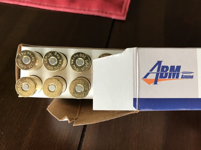

#77

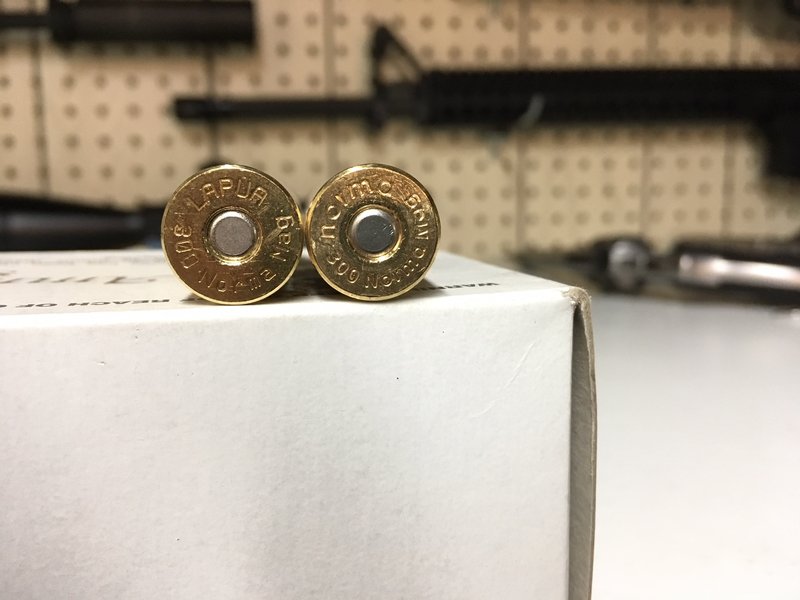

I'm over the moon happy and you should be too! Here's why: I opened a recently ordered box of 215gr 300NM ammo from ABM and was shocked to see LAPUA HEADSTAMPED BRASS!! Crossing my fingers this is the beginning of Lapua to offer 300NM brass to the masses.
bjay
Belligerents
Oct 19, 2009
2,846
248
89
Aloha state HI
#78
O wow... Fire them ammos and sell me brass.. Those things will never get to hawaii :(

Holy crap. This is huge. My emails to Lapua have finally paid off! I just bought a whole case of Norma brass, but I may have to order some ABM ammo just to get my hands on that sweet, sweet Lapua brass.

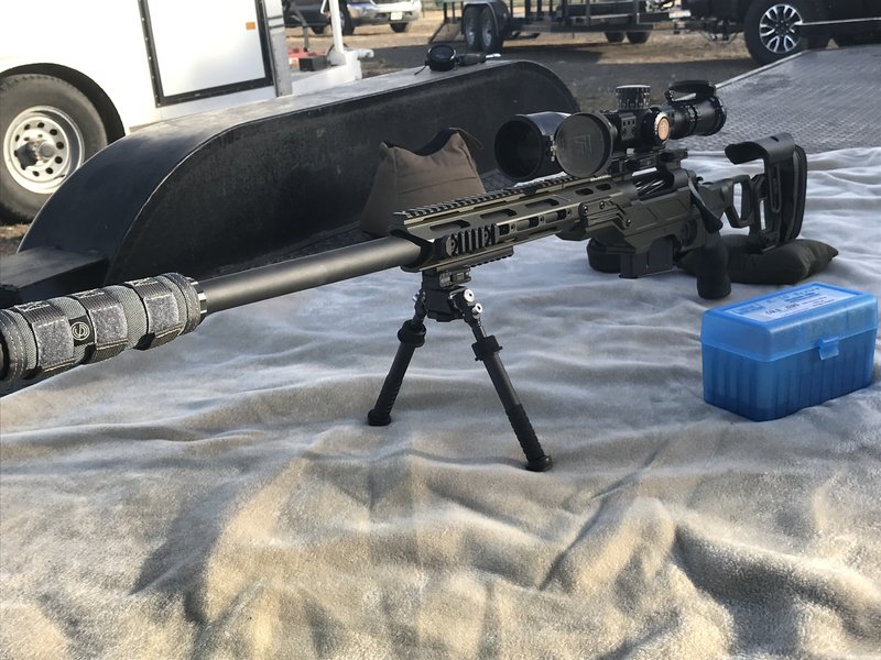

Waiting for a Proof TAC II 300 Norma build (24" proof bull, defiance action)...Here is some factory 215gr ammo. ABM on the left and Nexus on the right. Note the Lapua headstamp on the ABM. Also the ABM is seated out noticeably further. I'm thinking of trying the 180gr elite hunter in this case down the road...any thoughts if this is worthwhile effort?
bjay
Belligerents
Oct 19, 2009
2,846
248
89
Aloha state HI
#83
Im fireformig my brass to 30° for my 24" ive used eld x 212 and tried 215 hybrids.. You know its going be hard to beat them hybrids.. Heres 3 diff powder fireforming with 215

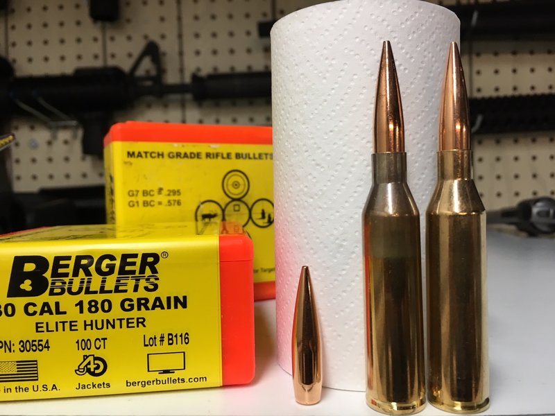

My reamer is .112 for the Warner bullets, which ended up not working for me. Last night I throated it to .250 fb, and my numbers now are about identical to bjayÂ’s.
From my math, a .185 fb will put the 230 bearing surface right at neck/shoulder. With .215, youll be .030 over with the 230. The 215 hyb is is exactly .090 shorter in the bearing surface(nose and boat tail is identical), so the bearing surface will be .120 above. The norma neck is .316 long, so .196 worth of neck grabbing the bullet at “touching”. If you jump, that number will go up of course.
.250 freebore.
208 eld on the left. On the right is a 230 straddled by a 215 and 230. The seated bullets are at the touching dimension.
[IMG2=JSON]{"data-align":"none","data-size":"full","src":"https:\/\/uploads.tapatalk-cdn.com\/20180102\/4e4c957bf5ff0b5e90ca210c6e7af0f2.jpg"}[/IMG2]
AXMC magazine
Oal: 215/230 3.63””
208 3.59””
[IMG2=JSON]{"data-align":"none","data-size":"full","src":"https:\/\/uploads.tapatalk-cdn.com\/20180103\/e93a7687d3a79bfafe0273d200d1623d.jpg"}[/IMG2]

My main concern was getting the 215/230gr berger bearing surface above the neck shoulder junction. I'm having my barrel spun up at GAP and their reamer has a .215 freebore, however they didn't know where that put the bullet in relation to the neck shoulder junction. They also said I could send in some dummy rounds and they could set the freebore off that. Just eye balling it with a 230 that puts my COAL around 3.604". Sounds like I should just be able to use their reamer with the .215 freebore and be fine.
Thanks for the help bjay and supersubes.
