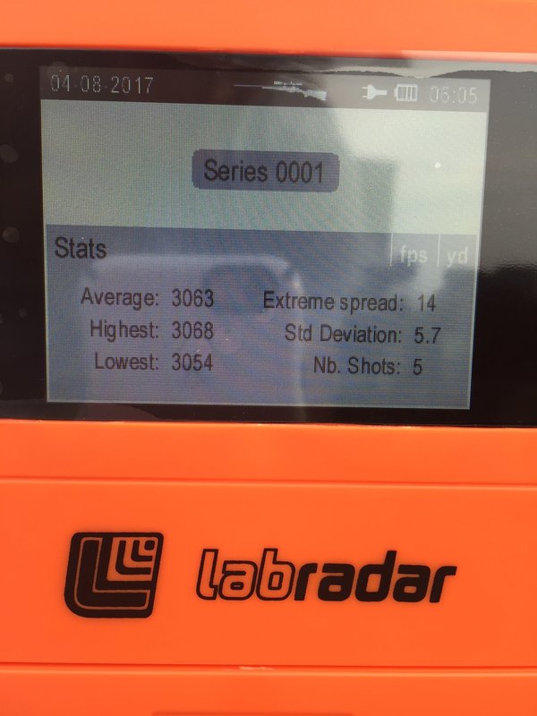

88.0gr N570 & 215FGMM
3.600" OAL
215 Berger hybrid
1-10" twist
28" barrel
3150fps avg
What a hammer! No pressure signs and extremely accurate. Shot several sub 1" groups at 356y.

I am amazed at the differences in the RE-33 powder and the load data on here. I asked Berger for their reload table for the 230 Hybrids, since it is not in my reloading manual, and was a little surprised at the information. They show slower velocities at similar charges than the majority on here using the re-33 and 230's. (Included the table for anyone interested - NOTE: This is Bergers information sent to me by Bob Blaine)
Got bored and tried to match the table they sent to me with the ones in the manual.
I did a ladder test on Monday with 7 loads, starting at 87 grains and going up to 90. I had hoped to see the 2900 mark relatively quick and was concerned about what might happen past 90 grains. That didn't happen. I get it that one rifle is not like the next; however, there are quite a few that have found 2900+ at 88 or 89 grains. I wouldn't think there was a chance there could be up to 300 fps difference.
Specs:
26" 1:9 Bartlein Barrel
Berger 230 Hybrids
Norma Brass
215M primer
RE-33 powder
Used a Lab Radar for velocity
I am not the best shot by any means. I had 1.5" groups at 200 yards. Lots with potential (4 shots inside an inch then ruining the group with horizontal spread due to my inability to shoot) but I am not a seasoned shooter so I have my errors.
I think series 7 would have had better results but I forgot to arm the Labradar. It was the best group of the day.
Rate now:

Picked up the new GAP hunting build and I found a screamer of a load right off the bat! Double based powders (N570, RE-33, etc) are where it's at for the Norma - lower pressures and high velocities.
Berger 215gr Hybrid
Norma brass - 3x fired
FGMM 215 primer
88gr N570
.015 jump
Bartlein 27" 1-10 Sendero contour
3063fps
SD: 5.7
These velocities are through a brand new barrel - 44rds fired so far. It should pick up speed as it breaks in. Couldn't be happier.

Using Norma brass
CCI 250 primers
84.5gr of Retumbo (AR2225)
Berger 230 at 3.650 OAL
2908 fps, 28 inch barrel, SD of 6
Shot 25mm groups at 200m, 4 inch group at 1224m (was losing light, couldn't get more shooting in)
