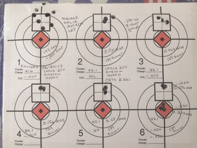

Savage Model 12 260 Rem. HS Precision w/20 moa NF rail/rings and Vortex Golden Eagle 15 - 60 52mm SFP. Lapua brass 2TF, Lapua 139 scenar, GM210M, H4350 42.1 gr. Chrono 10 shot groups:
Jump -.010, Mean velocity 2843 fps, ES 37, SD 11
Jump-.020, Mean velocity 2857 fps, ES 25, SD 7
Could not find high/low node with 142 SMK or 140 Berger Hybrid
To confirm, this is with a 26" barrel?
