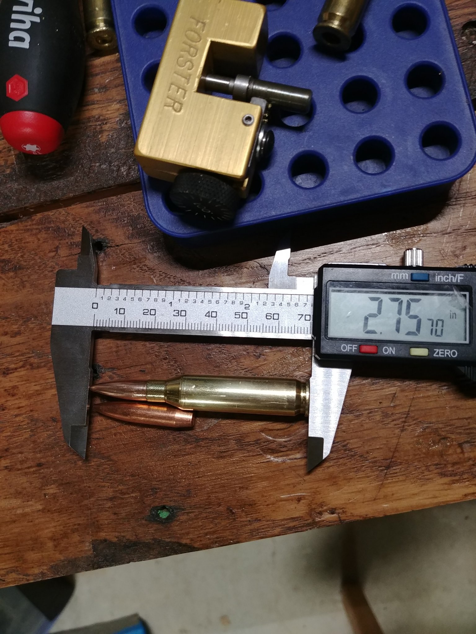

Hey,
I chambered a brux barrel in 2016 with a .260rem floating pilot match reamer. This was my 5th chamber but first "match". The project got set aside until today when I finally got some brass. My issue is that with 140gr noslers at an OAL of 2.70" I'm right on the lands.
I feel like these should be seated much longer or I am going to be compressing my loads with that much of the bullet in the case. Are match reamers meant to be followed with a throating reamer so you can get everything "just right"?
Here is the print of the reamer I used.
Thank you!!!

Post a picture of a loaded round. Which 140 nosler? They make a few different 140 grain bullets. That sounds pretty short for a .260. Your reamer print looks good to me and if you are running a short action I would not run a throating reamer at all. I suspect your measurement to the lands might be wrong. How did you find the lands?

Here is one that has been pushed about .005" into the lands next to a bullet for reference. They are Nosler Custom competition 140gr. Its several years old, I just have a lot of it That I shoot in my 6.5x55.

Your loaded round looks exactly how I would expect for a freebore of that length. I think you picked a good reamer and you are good to go. Shoot up those garbage bullets. Haha. Some of the new 140 class bullets are around a .650 G1 B.C. and you should be able to load them mag length with good results.

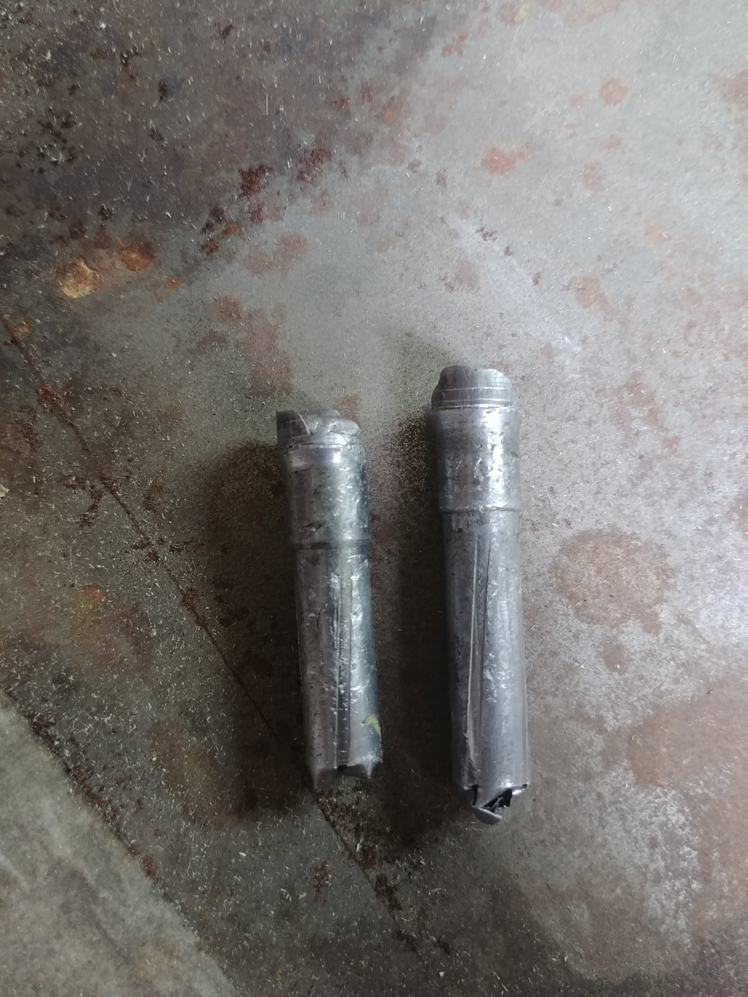

.2915/.2895 is what I am reading on this resized Hornady 7mm-08 brass. I did not spec anything on this reamer, I just decided click "match" when I ordered it elk ridge. I didnt know quite as much back when I did this barrel (aside from how to properly setup and indicate a barrel for lathe work).

That chamber neck diameter scares me. Also, I look at your FB as .048. I have 2 popular 260 reamers. One is .2975 neck/.060 freebore and the other is .298 neck/.090 freebore (I have a brand new JGS carbide reamer for sale in this spec, if anyone is interested). The .298 neck will run any brass. The .090 FB works good with the 140s in the longer mags. The .060 gives room to chase the throat as it moves.
My personal opinion is that reamer is too small all over, if not dangerous in the neck.

Thanks Rubicon. I'll cast the chamber as soon as I get a chance and see what actual neck dimensions are. What would a good neck dimension be on my loaded cases with my .297/.291? Looking at other reamer prints I don't understand why there is so much taper on the neck of this one.

I couldn't answer that. I have not seen a neck with that much taper. I am sure there was a reason for it, and maybe it was a common thing, I just haven't seen it. What I do see is the dimensions are all small, so you could run a more common reamer in it and not need to neck turn and get the freebore lengthened, if you chose.

So I (poorly) slugged the neck area today and the dimensions came out .293/.2925. It some dirty, pure lead so the results weren't great...

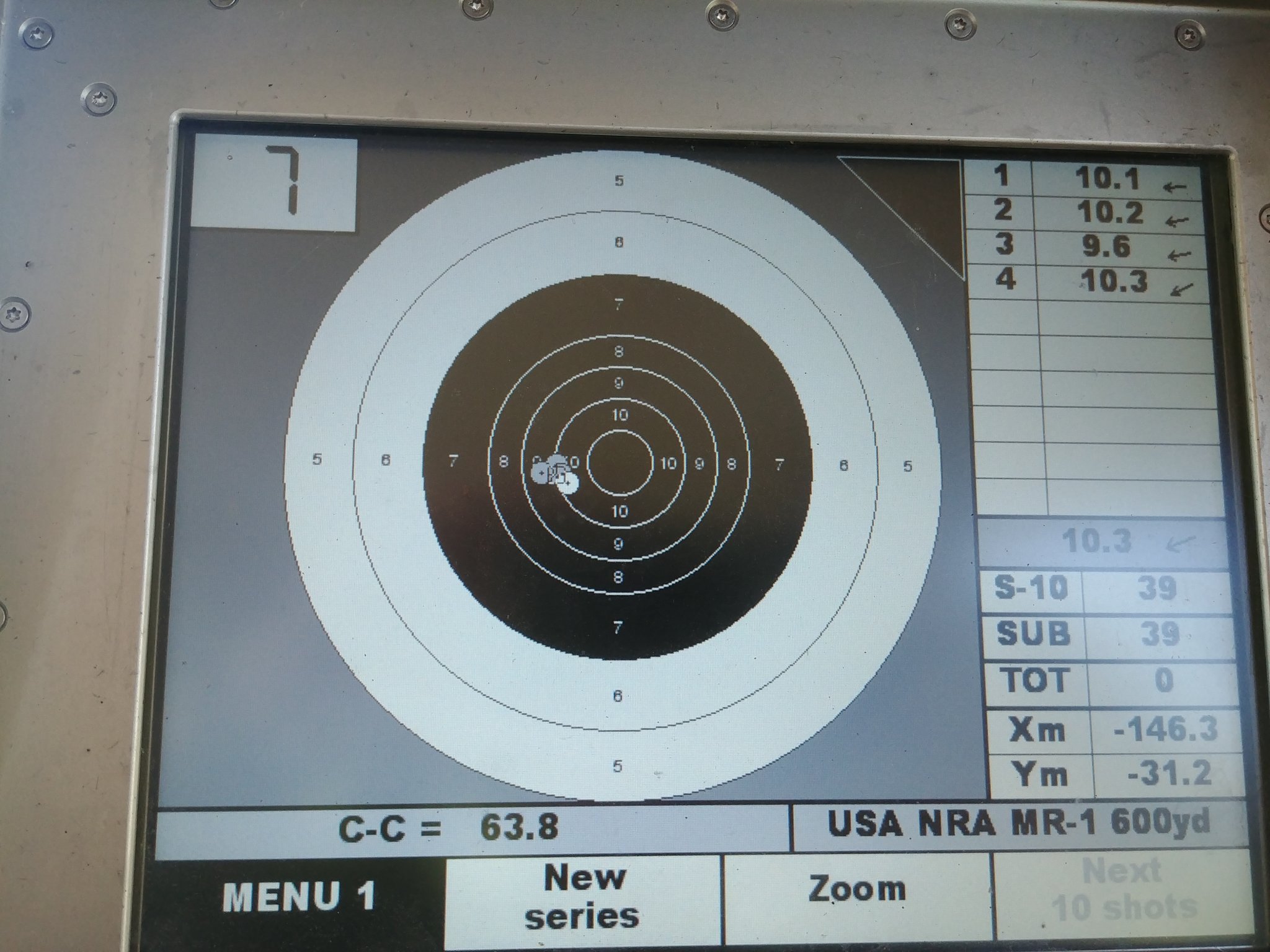

#18
