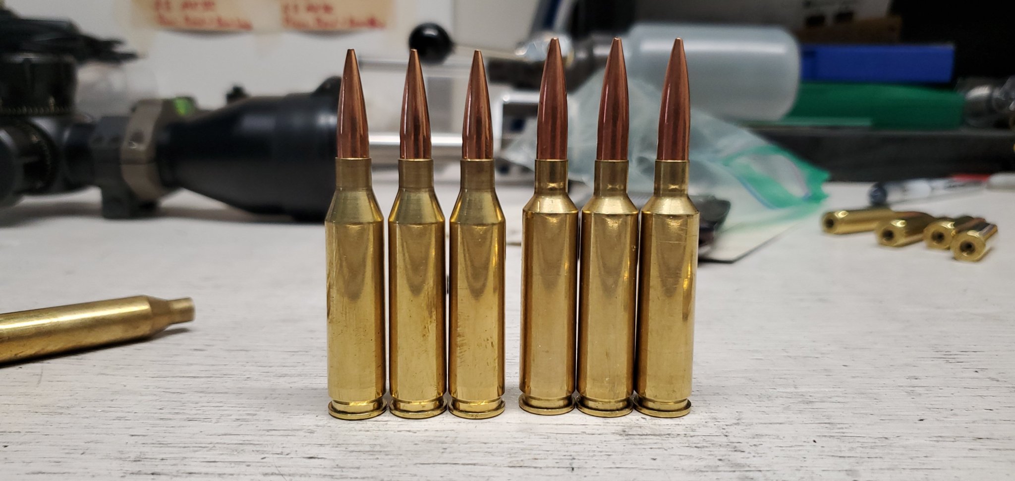

7113906
243w on left and 243 cutright on right. Should have a 7.5tw bart med palma ready for a curtis when I get back from vacation. It is a 243w case ran through a 243 cutright sizer, bumps shoulder back .050. A fireform load blows shoulder to 37.5° and straightens body out to 6br specs. Ends up with a very stable case, with a .135-.185 freebore it fits in aics mags easily. Bearing surface is above nk /shoulder junction.
Mags without plate allows plenty of room to chase rifling, on my high mileage 243/243ai, I haven't saw more than .060 erosion. Use something like a 107smk or 112 barnes and chasing lands isnt super critical. Fireform loads are equal to hot 243w and will shoot in the .3s7113913

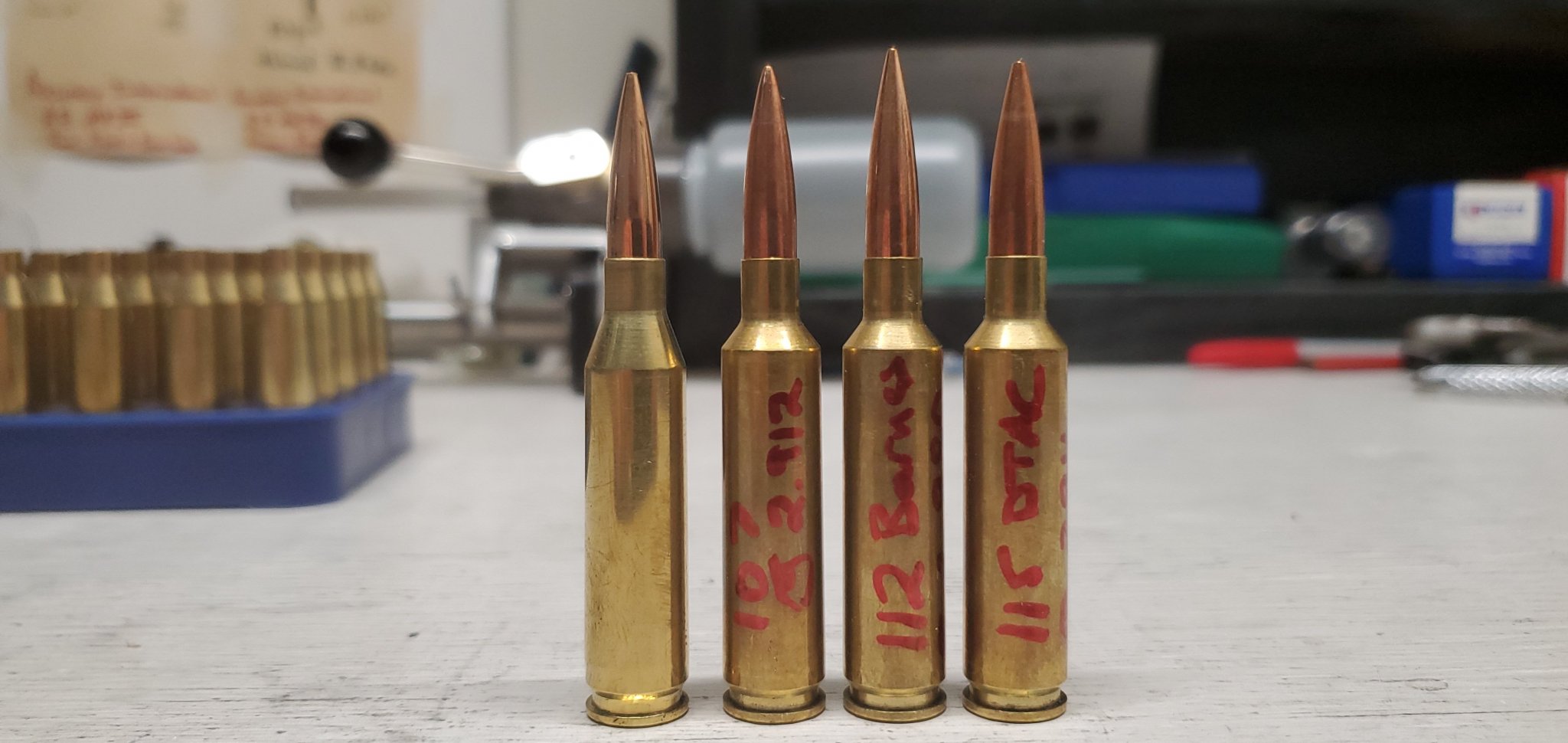

Heres some dummies I set up for a .020 jump in a .185 freebore chamber. The 112 barnes still has .050 to chase rifling before it's at max mag length.
