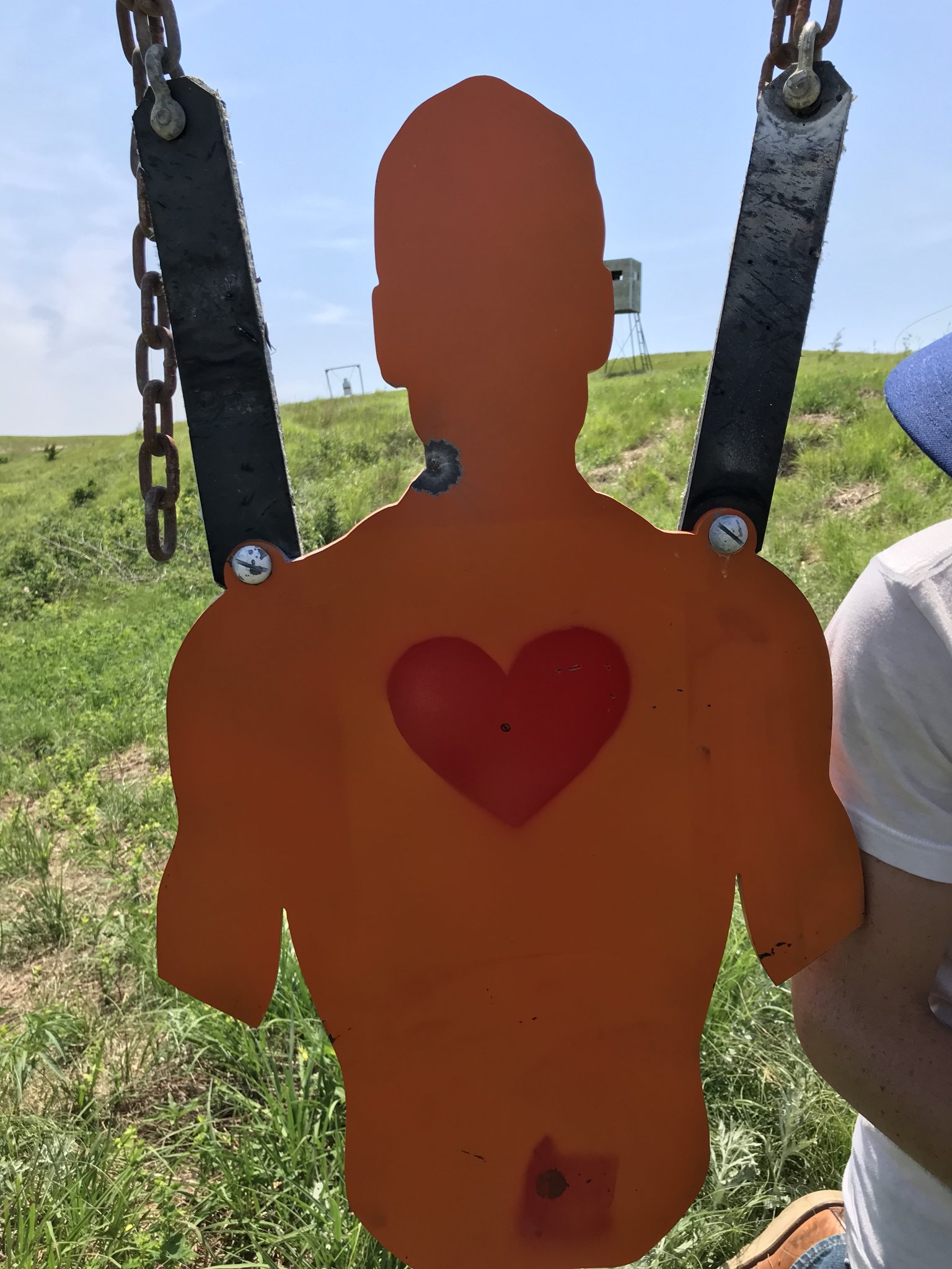

had a good outing and was pleased with how the 225 ELD’s shot. Got a cold bore hit at 1604yds, then several hits at 1516 and 1675 which were all in the transonic zone. Overall was good enough for 4th place (out of 15).
A G7 of .370 was pretty spot on for me.
I didn’t get any hits past 1675. Was close and was dancing around the targets but couldn’t connect. Everyone was having issues with the wind (22mph, gusting to 30mph quartering wind) and very few people got hits at 2200yds in those conditions. I think only a 50BMG, 416 Barrett and 338 LMR were the only cartridges to score impacts.
All in all, I was pleased with the 225 ELDM’s and will use them for another match in July, hopefully with less wind.

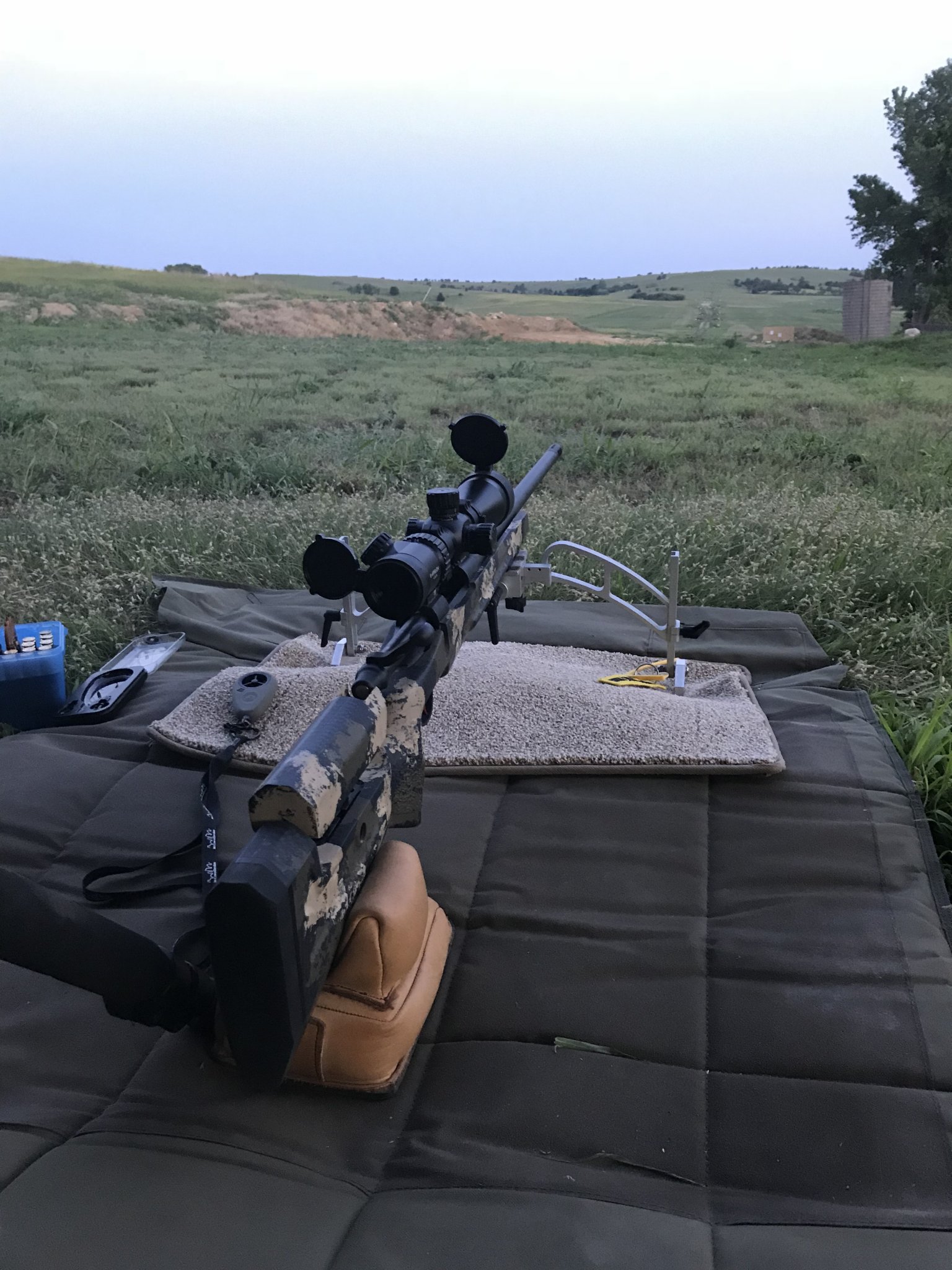

Rifle Specs:
Remington 700 LR barreled action
26” Factory BBL, 1:10 twist
Manners PRS-2
Calvin Timney Elite
225 ELDM, Noller Brass, CCI-250, Retumbo
2784fps
