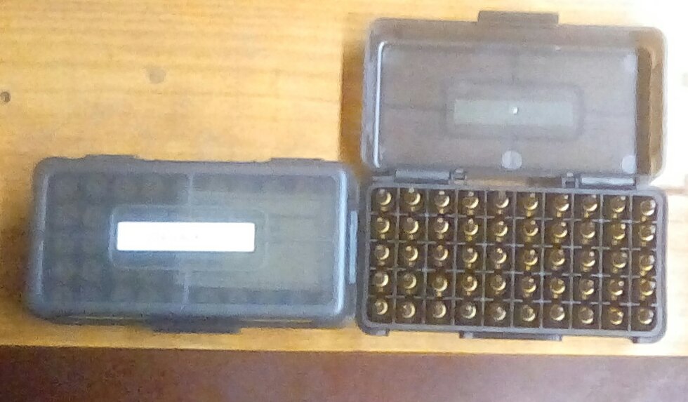

Silly question for those reloading 224 valk. What ammo containers are you using? I really like the 100 round MTM boxes with the handles but they don’t really hold the 224 well. 223 three containers are two small on diameter.
The MTM boxes for 22-250 and 7.62x39 work well, I got four of the 50 rounders from Amazon.

The Caldwell 7.62x39 boxes noted below are working well for me and the price is hard to beat - just $10.20 for a pack of 5 boxes.
Caldwell Ammo Box 5 Pack (AK 7.62x39) Small, Black https://www.amazon.com/dp/B00RPAGOAS/ref=cm_sw_r_em_taa_xO8ZBbTNF18QHView attachment 6960230
Thanks for the link. I have been having one heck of a time finding a box that is the right size. It has either been for 223 and to small or for 308 and the round rattle around in the box. As you said it is the nice price too and should work for my 6.5 Grendel as well.

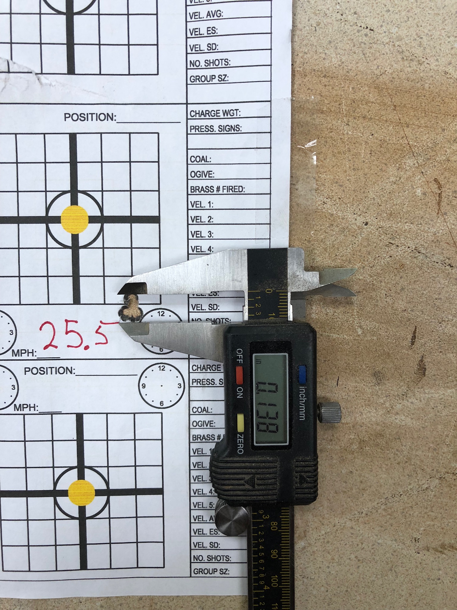

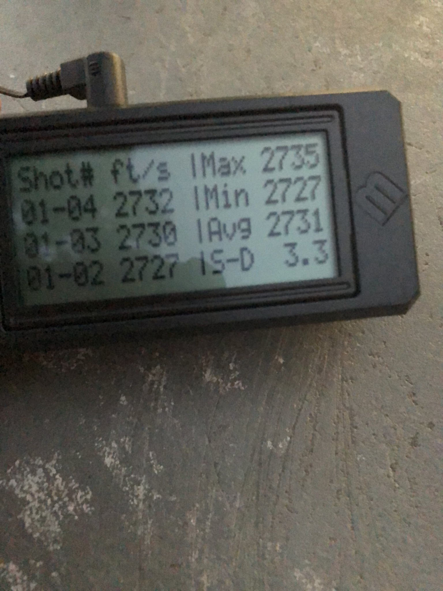

Here's a seating depth test I ran today with the 88 ELD's and 25.5gr CFE223. I am done with 8208XBR. I tried the 80 Amax's again today and tried an OCW with 88 ELD's and 8208. This powder does not want to cycle the rifle reliably no matter what gas block setting or buffer setup. CFE223 runs 100% reliably so Ill explore other powders but done with 8208 in 224V.
Very happy with this load. Its accurate and very soft shooting. Velocity is 2650 and single digit SD's.
