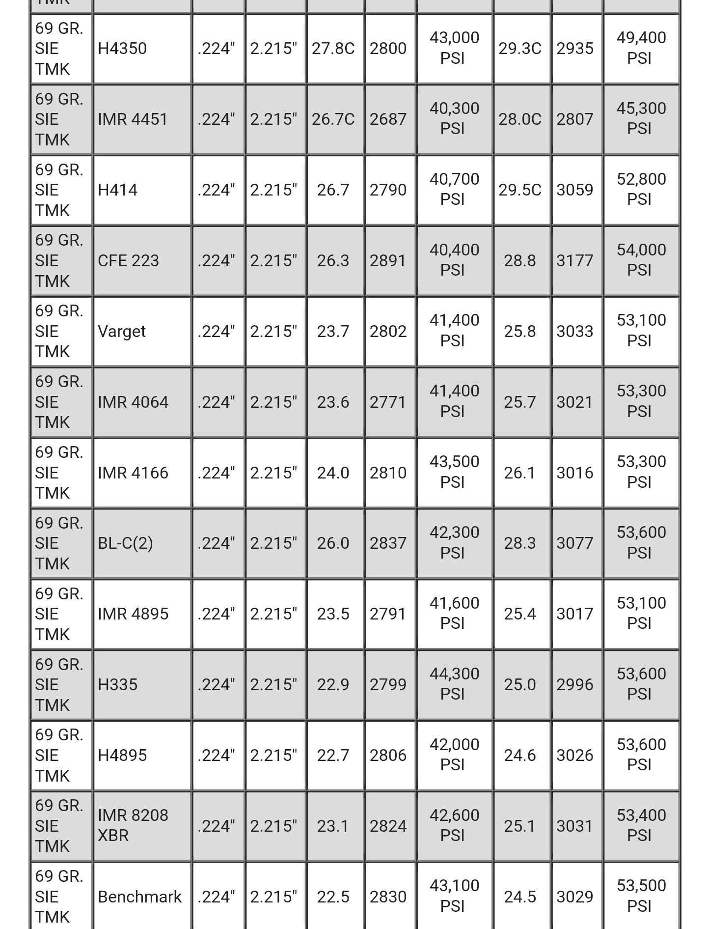

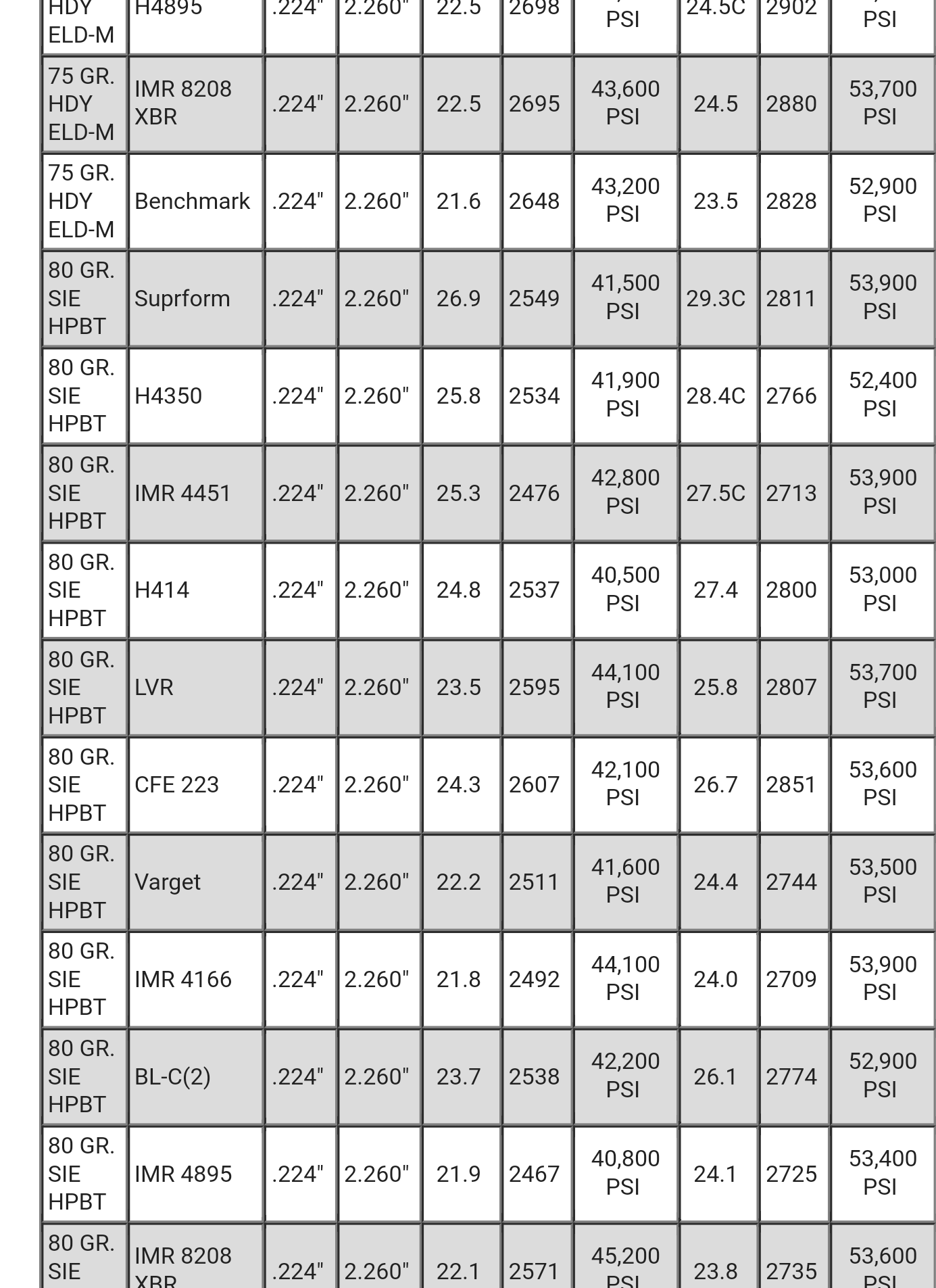

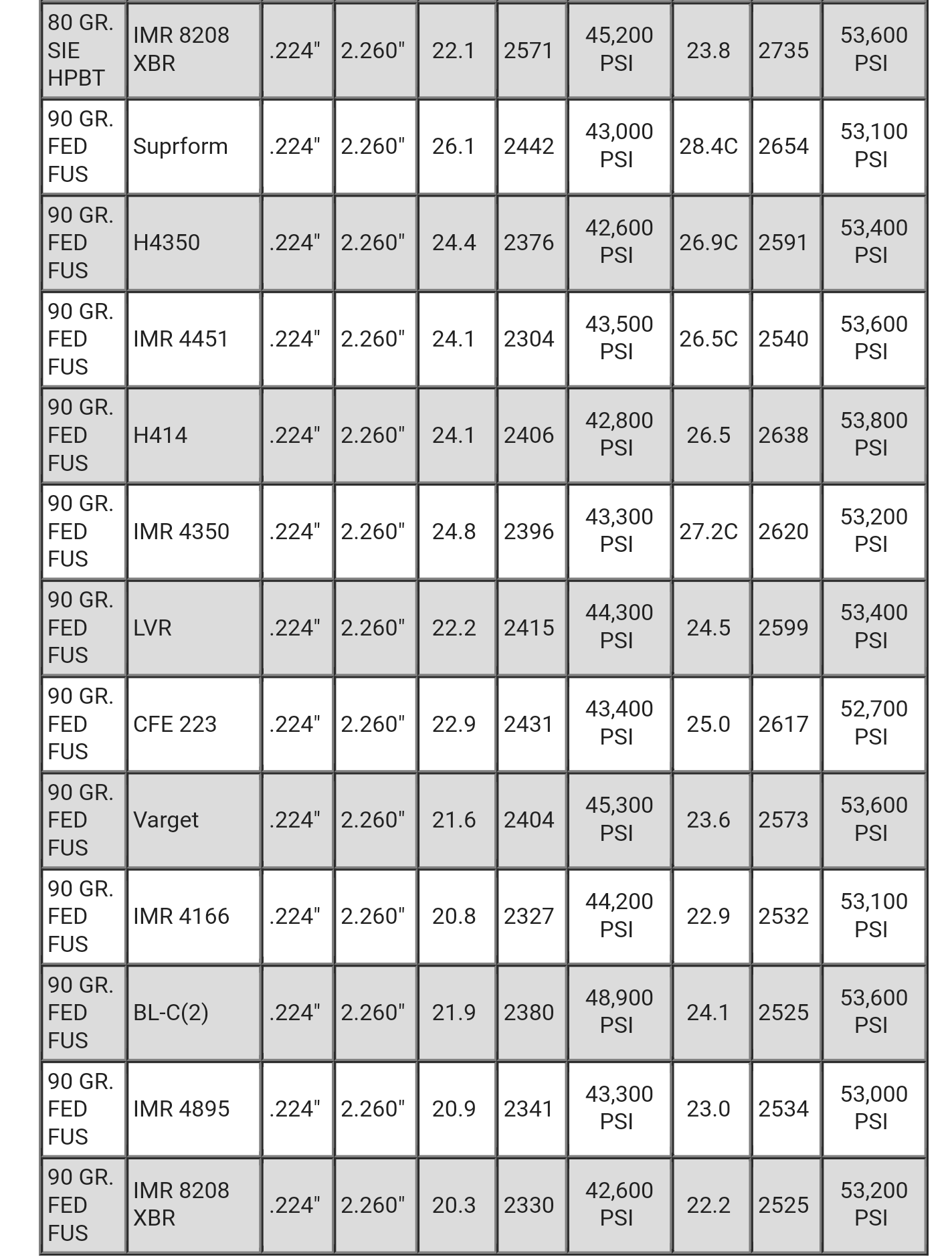

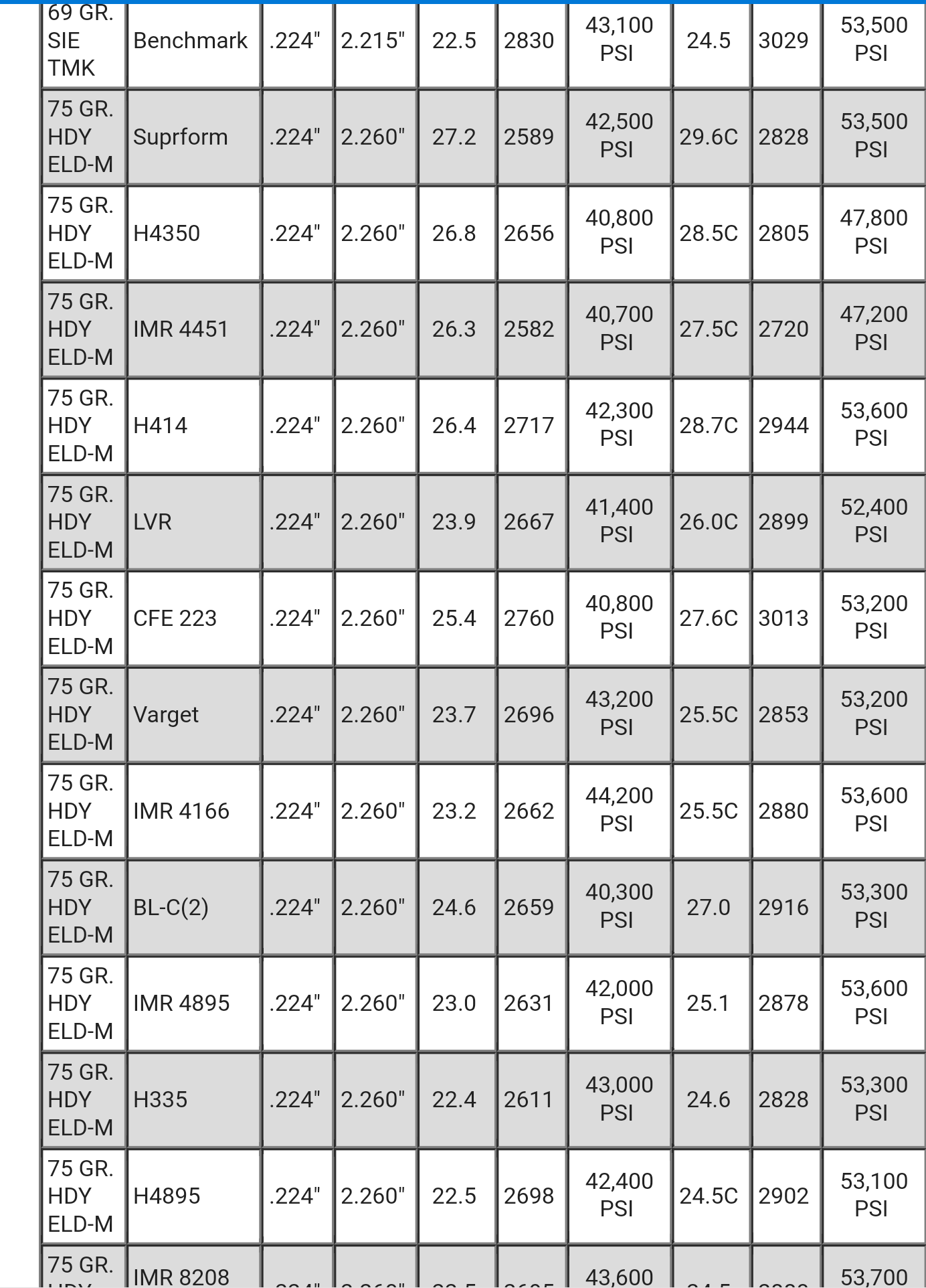

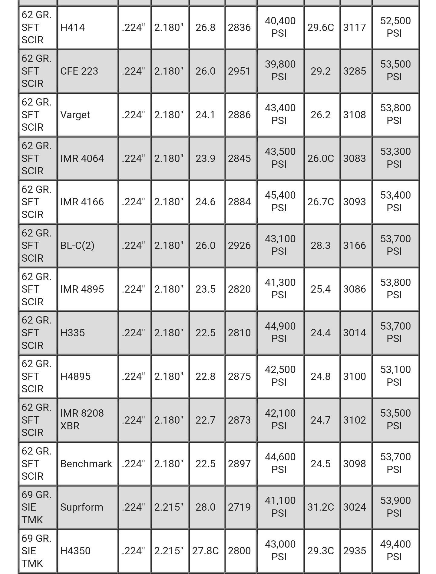

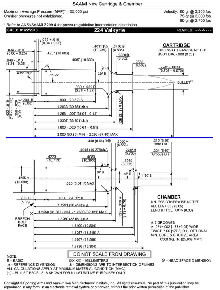

For those having issues finding accurate loads in an AR, I found this on the new 224V forum:
It seems there is a bunch of bad reamers going around. If you can load a 90gr SMK to 2.3 without jamming the bullet into the lands the reamer used to cut the chamber was out of spec. The SAAMI spec for freebore is 1.676 from the base of the cartridge.
Turn a flat based .224 bullet around and seat it upside down in a 224 valkyrie case. Seat it so it barely touches the lands. Measure from the base to the forward most part of the .224 diameter of the bullet. It should be very close to 1.676"
http://www.224valkyrieforum.com/index.php?topic=75.0

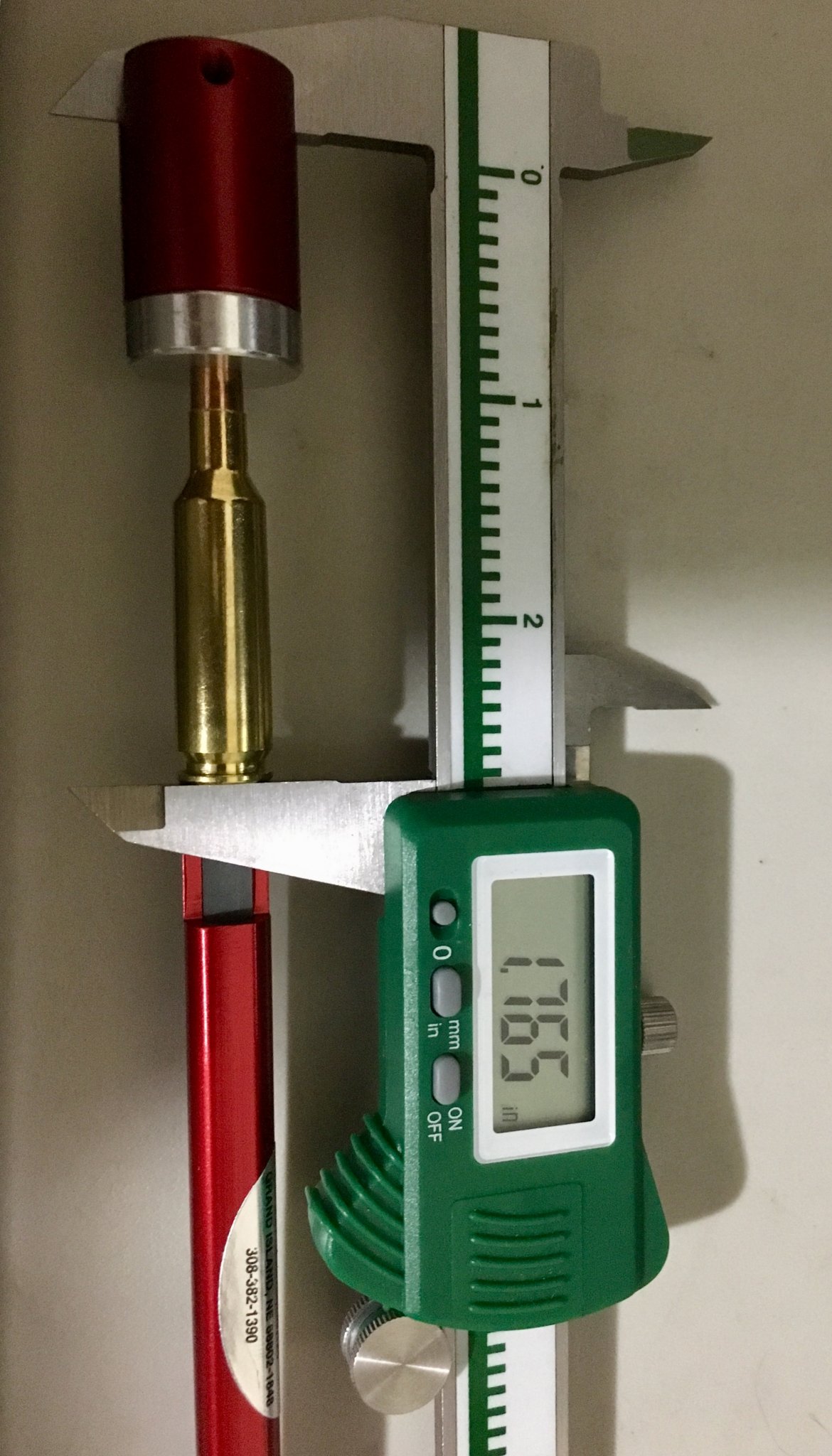

I took a measurement as well and mine came out to 1.765" with the 90gr FGMM. 1C753C44-C48E-4210-8245-651ABCAD4A3B.jpeg

To me it looks like the SAAMI drawing is showing 1.783" because there's a 1 degree angle. Which would make it a compound throat just like the 6.5 Grendel. This makes sense because it'll work well with a wider array of bullets to include Secant Ojives and Tangent Ojives.
DacianMH
May 8, 2018
30
4
12
Fort Worth, TX
I took the average out of 5 and ended up with 1.763" which would make it .010 into the lands. I'm using a Rainier Rock Creek 18" rifle +1 gas and it shoots the 90gr FGMM ok but not spectacular by any means. It loved my 75gr ELDM loads with 27.3gr of Power Pro 2000-MR. It's also looking very good on the 80gr ELDM, and I'm going to be loading some 88gr ELDM as well. I'm not running a chronograph until I pin down what's shooting accurately.

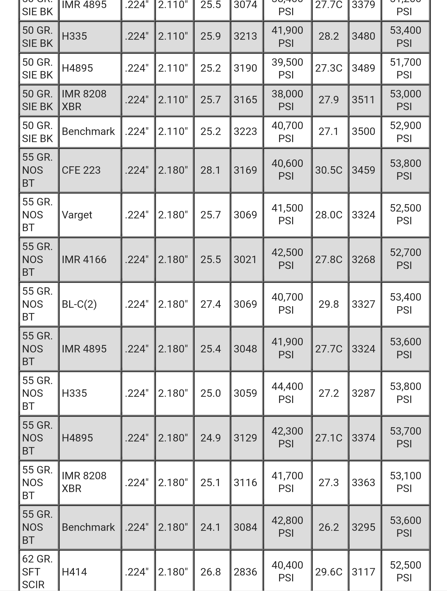

Be careful with the AR Comp. I loaded some 77s with a standard Varget or rl15 load and primers dropped out of the cases when they ejected.
is it federal brass? i have some factory federal that after the first firing 15 out of 100 the primers fall out of.

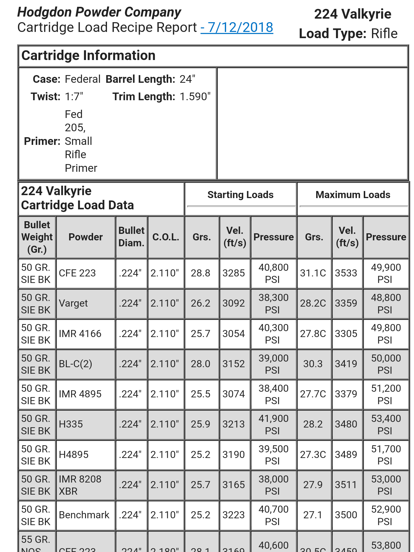

What powder would yall recommend for pushing the 88gr ELD-M and a 77gr TMK? I'm not very experienced with burn rates in an 18" barrel with heavy pills.
PA Valkyrie
Jun 23, 2018
26
12
6
The jury is still out on that for me. I went to the range today (hotter than hell here today) and had some preliminary success with Varget with 100 yd test ladders of the 77 TMK’s and the new 95 SMK’s. Both were barely under 1 MOA though. I know the rifle (and me) can do better. The 77’s preferred mild charges. I got two boxes of the 88’s last week, but I haven’t loaded any yet. Still playing with seating depth, etc. I just got a PRI “cut”magazine on Saturday and a buddy is making a 224V “modified case” to work with my Hornady OAL gauge. I’m running a 24” barrel. The four powders I have to work with now are Varget, CFE-223, RE15, and RE17. Stay tuned.
VelvetFletch
Jun 13, 2018
12
1
6
I've been running RE15 and H4895. However, this has been with 50 and 55gr pills. I'm just not sure if Varget is slow enough, or if RE17 is too slow. Both of those powders are on my list, though. I'm going to pick up some 17, the 77gr TMK's and start case prep this weekend. I'd post my data, but my chrono crapped the bed...

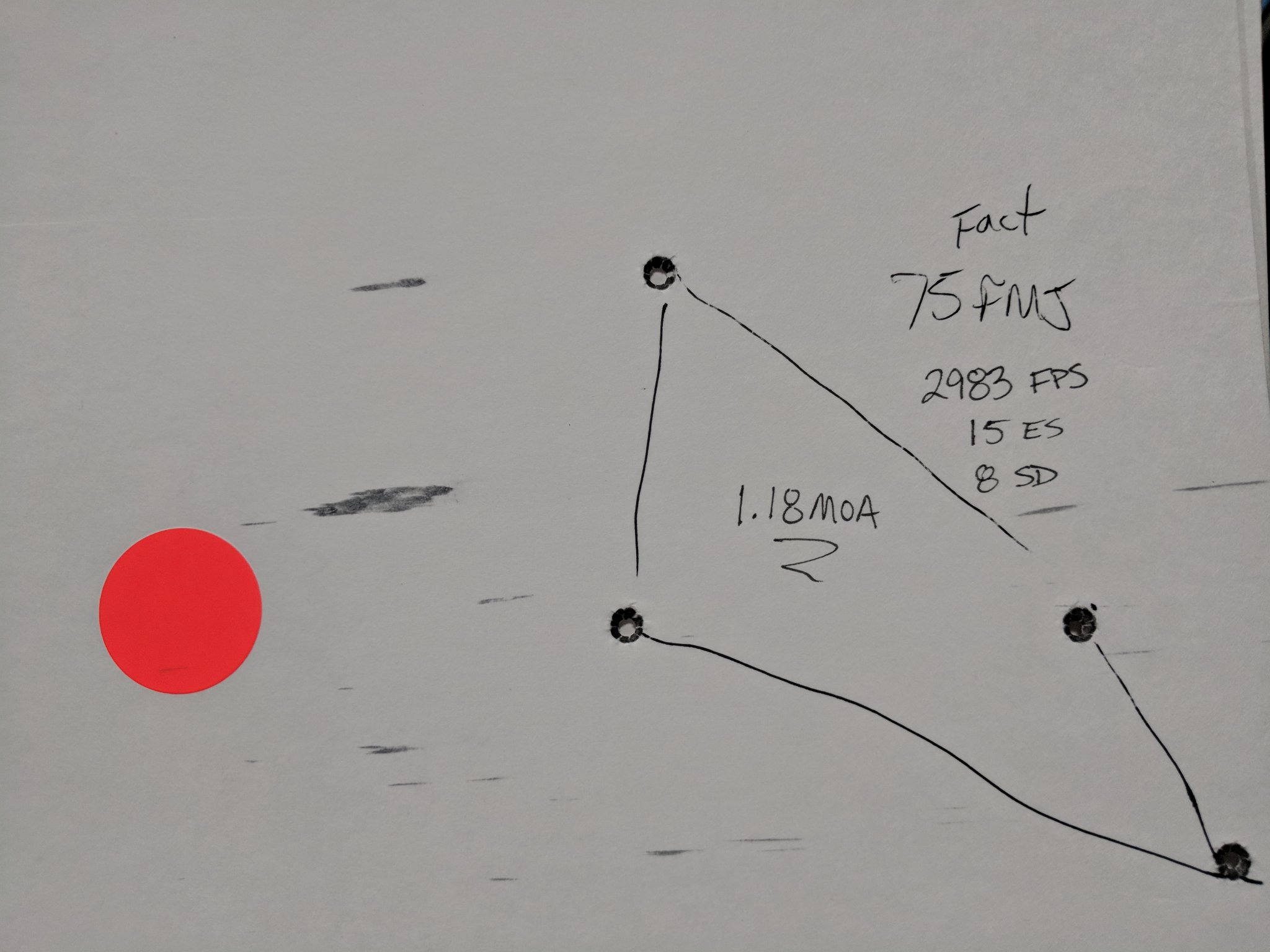

Factory 75 FMJ: 4 Shot - 1.18 MOA @ 2983fps, 15 ES and 8 SD (missed a few shots so likely off a bit)

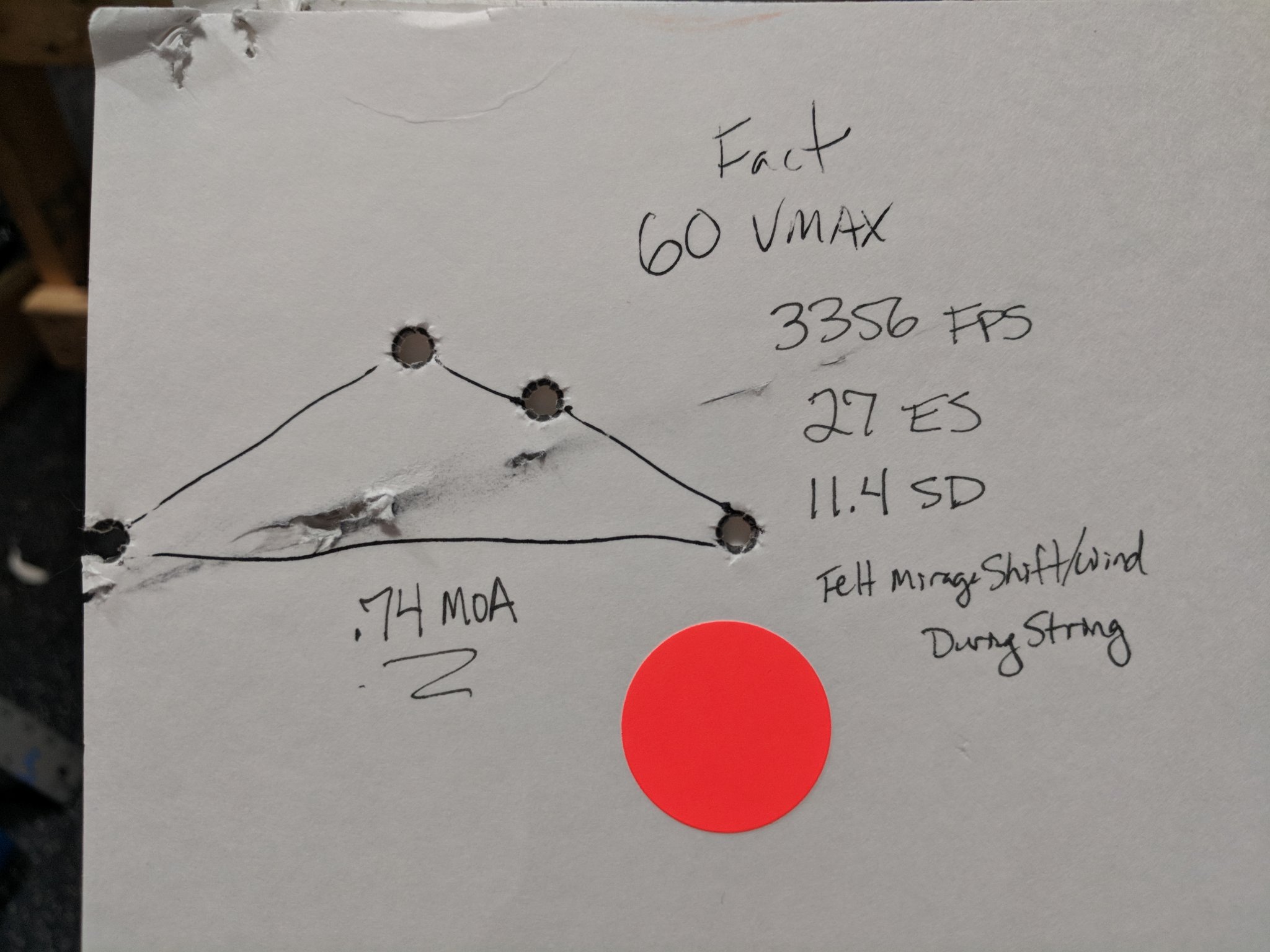

Factory 60 Nosler: 4 Shot .74 MOA @ 3356, 27 ES and 11.4 SD

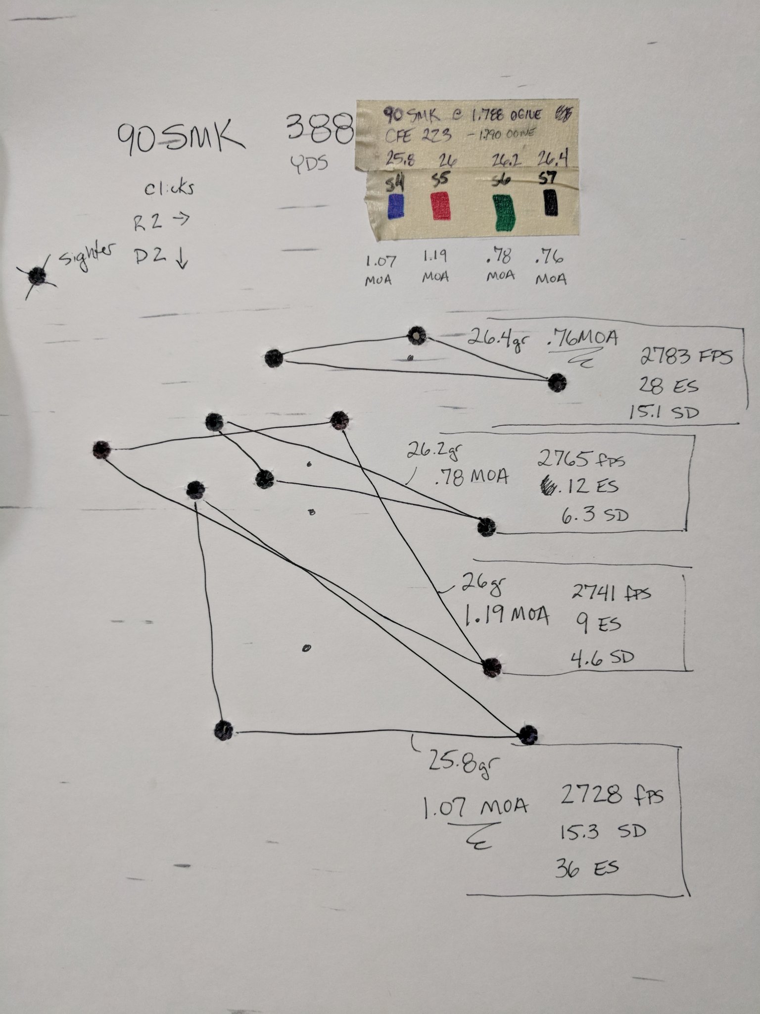

CFE 223 - Sierra 90SMK 2.280 OAL, .013 off lands, 388YDS, CCI 400, Virgin Federal Brass
  • 25.8gr 2728fps, SD 15.3, ES 36 - 1.07 MOA
  • 26gr 2741fps, SD 4.6, ES 9 - 1.19 MOA
  • 26.2gr 2765fps, SD 6.3, ES 12 - .78 MOA Best node and great speed; seating depth could tighten up left/right.

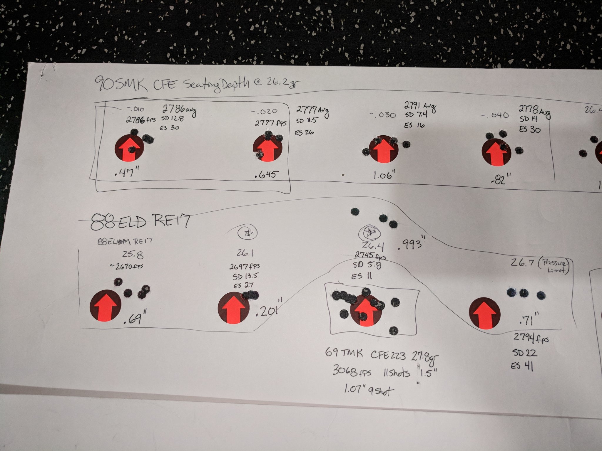

    • Seating Depth test:
      • -.010 .45 MOA, 4 shots 2786 avg, SD 12.8, ES 30 will get better with once fired brass
      • -.020 .62 MOA, 4 hots 2777 avg, SD 11.5, ES 26 will get better with once fired brass
      • -.030 1 MOA, 4 shots 2791 avg, SD 7.4, ES 16
      • -.040 .8 MOA, 4 shots 2778 avg, SD 14, ES 30
  • 26.4gr 2783fps, SD 15.1, ES 28 - .76 MOA

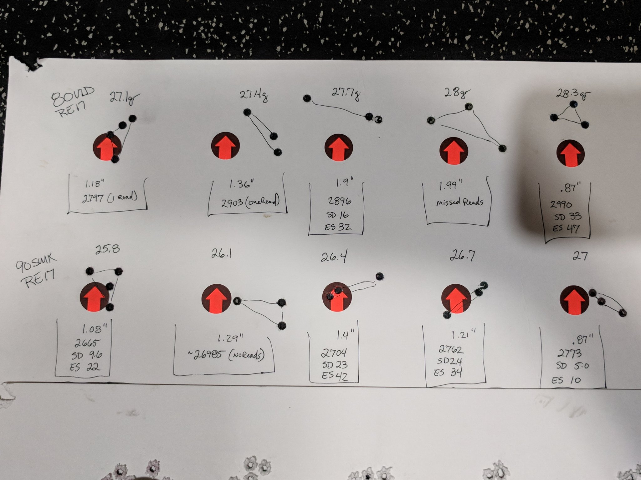

Edited to Add RE 17 Data and Updated SMK/CFE223 testing. Basically, RE17 is no good (for me anyway) except with the 88ELDM. It is super picky and very pressure sensitive, velocity picks up in a hurry with very small charge changes. Seems to work with 88 ELDM but I had similar results with CFE223 and velocities where much easier to control. Take group sizes with a small grain of salt though as mirage was TERRIBLE, HORRIBLE, RIDICULOUS at 100yds. That said, its hard for mirage to make a 2" group at 100yards.
RE 17 - Sierra 90SMK 2.280 OAL, .013 off lands, 100yds, CCI 400, Virgin Federal Brass
  • 25.8gr - 2,665fps, SD 9.6, ES 22 - 1 MOA 4 shot
  • 26.1gr - ~2,685fps, 1.2 MOA no reads from chrono (estimated based on charges above/below)
  • 26.4gr - 2,704fps, SD 23, ES 42, 1.4 MOA
  • 26.7gr - 2,762 fps, SD 24, ES 34, 1.2 MOA
  • 27.0gr - 2,773 fps, SD 5, ES 10 .87 MOA this is the pressure limit and max load according to Hodgdon and Quickload. Might work but right at limit of pressure if you believe that sort of thing.. lol.
RE 17 - 88 ELDM 2.300 OAL, .030 off lands, 100yds, CCI 400, Virgin Federal Brass
  • 25.8gr - ~2670 missed reads, .69 MOA 4 Shot
  • 26.1gr - 2697fps, SD 13.5, ES 27, .2 MOA Best group of day but a bit slower than I'd like. If it shoots well consistently, I'll use it though.
  • 26.4gr - 2745fps, SD 5.8, ES 11, .97 MOA. I think this could tune better just a bit lower or with seating depth adjustments. May have pulled shot due to mirage.
  • 26.7gr - 2794fps, SD 22, ES 41, .7 MOA. also decent group but poor ES/SD.
RE 17 - 80 Berger VLD Target - not good with RE17 unless you like under 2800fps.
  • 27.1gr - 2797fps, No other reads, 1.1 MOA
  • 27.4gr - 2903fps one read, 1.3 MOA
  • 27.7gr - 2896fps, SD 16, ES 32, 1.8 MOA
  • 28gr - no reads, 1.9 MOA,
  • 28.3 - 2990fps, SD 33 ES 47, .8 MOA but at pressure limit.

Adding some load data to the mix. I use Quickload to test for theoretical max and velocity, so BE CAREFUL! these are mostly the upper limit of pressure. Pictures at the end for those that want to read instead.
Test Conditions/Setup:
388yd 3-shot ladder test; best loads will be re-tested after trying RE17 and maybe RE15
26" Rainer Ultra Match
Aeroprecision M4E1 Enhanced Upper/Lower
LabRadar Chrono
CCI 400 Primers
NOTE:Virgin Federal brass is very short in my chamber and grows .012 after firing, so I expect these groups to be larger than with once-fired, properly sized cases (.0015-.002 shoulder bump). My 69 SMK load shot .4-.5 consistently in once-fire, properly bumped cases but only .6-.8 in virgin brass.
Factory 90 SMK: 9 Shot Group - .77 MOA @ 2728fps, 36 ES and 12.3 SD
Sierra 90SMK 2.280 OAL, .013 off lands with CFE223, 388YDS, CCI 400, Virgin Federal Brass
Hornady 88 ELDM @ 2.300 OAL (.030 off lands) CFE 223 388YDS, CCI 400, Virgin Federal Brass
  • 25.8gr 2740fps, SD 17.4, ES 38 - .78 MOA
  • 26gr 2780fps, SD 8.3, ES 15 - .76 MOA Should tune better with seating depth.
  • 26.2gr 2786fps, SD 21.3, ES 42 - .81 MOA
  • 26.4 expected to be too hot. didn't shoot.
Berger 80 VLD 2.275 OAL (.010" off lands) CFE 223 100 Yds ,CCI 400, Virgin Federal Brass
  • 25.8gr 2778fps, SD 23.6 , .38 MOA
  • 26.1gr 2806fps, SD 7.8, .61 MOA Node here for sure; can clean up with seating depth.
  • 26.5 2852fps, SD 11.2, 1.01 MOA
  • 26.9gr 2897fps SD 12.0, .79 MOA - Should be node just past this ~ 27-27.2 with seating depth change.
  • 27.3gr 2949fps SD 16, 1.06 MO
View attachment 6920088 View attachment 6920089 View attachment 6920090 View attachment 6920078 View attachment 6920079 View attachment 6920080

I just heard from Hodgdon's that they have finished up development of the Valkyrie dataset for Hodgdon powders, and that data will be published in the online Reloading Data Center "with the next update". They didn't say exactly when that would be, but it should be soon. However, if you ask them nicely from their website "Contact" page, they will send you the info right now.

I'm a bit surprised that CFE 223 seems to take cake across the board for best velocities in the 69+ grain bullets. But perhaps more surprising, is that NONE of the powders shown push a 90gr bullet to 2700 out of a 24" test barrel. That's either conservatism on Hodgdon's part, they don't make a powder that will "safely" push it to 2700.
Lastly, they don't list the 90 SMK which is very surprising given that it's been the primary bullet discussed relating to the 224V. I'm sure the 90 Fusion is close but.... Maybe more to come?
Any one else find that odd?

I'm thinking Hodgdon will have more data published in the future. In addition to no data for the 90 he SMK, they don't have data for IMR4064 for any projectiles heavier than 69 gr, even though Sierra lists data for IMR4064 for projectiles all the way to 95 the SMK.

I wonder how lawyered down those numbers are, all the 75 ELD numbers look identical to my 22" 223 data.
I thought the same thing. I'll run through Quickload using factory brass capacity, Hodgdon seating depth and standard settings to see how closely they match.
Any specific powders/bullets you want me to check?

Just spoke with their CS team: awesome service. Super friendly and very fast reply.
No word on "accuracy" as they only test for pressure. But here is the data:
Thanks, Subwrx300...you beat me to it! Been a crazy day here, had the house painted. After 3 days of prep, today was the “big day”.
So far, the best powder I’ve tested has been CFE223, across the board. Varget is a close second. Haven’t had much success with PP2000-MR or RE17. Haven’t tried RE15 yet, but I’ve got some on the bench. Vihtavouri of some type has crossed my mind, since N160 is such a good performer in my .243.
Yes, I am disappointed with the velocity numbers. I think that field data is going to prove these loads to be very conservative.
RE: 90 SMK...I have had such success with the 95 SMK that I quit working with the 90.
When looking at the Hodgdon data, I see two things at play here: 1. Hodgdon apparently didn’t get the memo that said that the Valkyrie was designed to throw long, heavy bullets a long way, thus lots of lighter bullets are listed; and 2. It is taking some time for new long, heavy .224 bullets to come down the supply pipeline. That’s probably why the 88 ELD-M wasn’t listed. And we don’t have any real entries in that field from Berger, Lapua, and maybe Nosler yet (at least I haven’t seen anything).
It’s all so new with the Val, give it time. A year from now I’ll bet we will be drowning in bullet choices, component availability, and load data.
