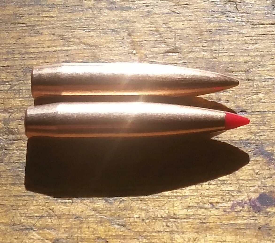

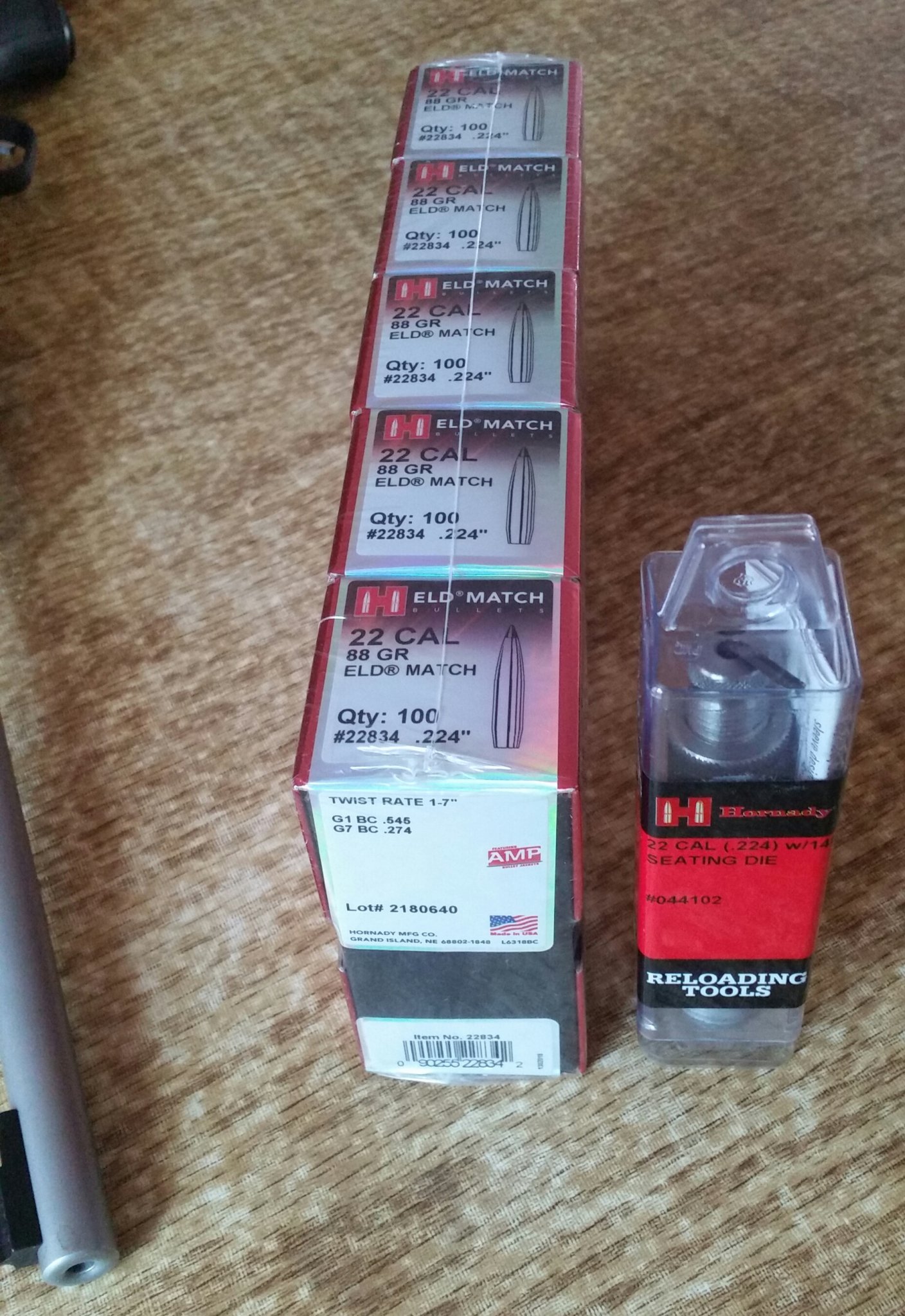

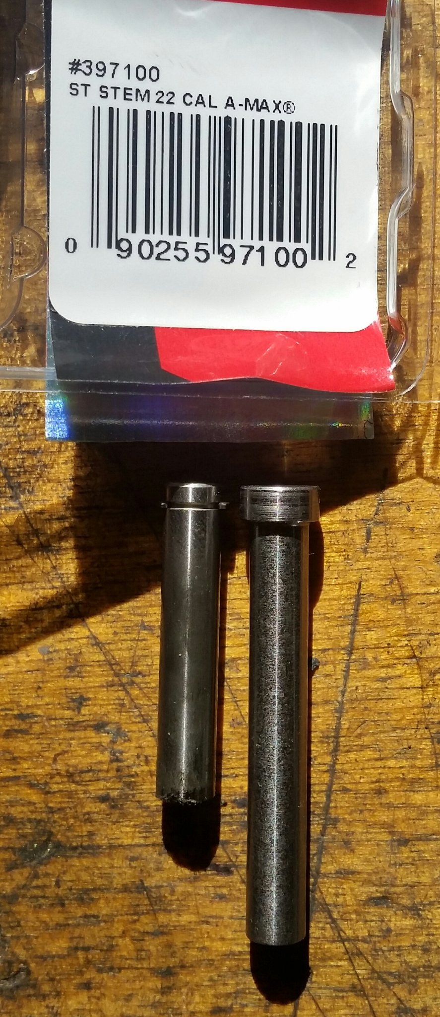

New 88gr eld arived, the bullet length over ten shows 1.240-1.242"
I also bought the new Hornady seater with the A-Max/ELD stem, purchased separately, and it is giving consistent seating depth with no, let me repeat that... zero stem imprint on the bullet.
pictured with the 90smk for comparison.
Mine should be showing up tomorrow. Still waiting on dies though.
Is the Hornady stem compatible with Redding dies? If so, do you have a part number for it?

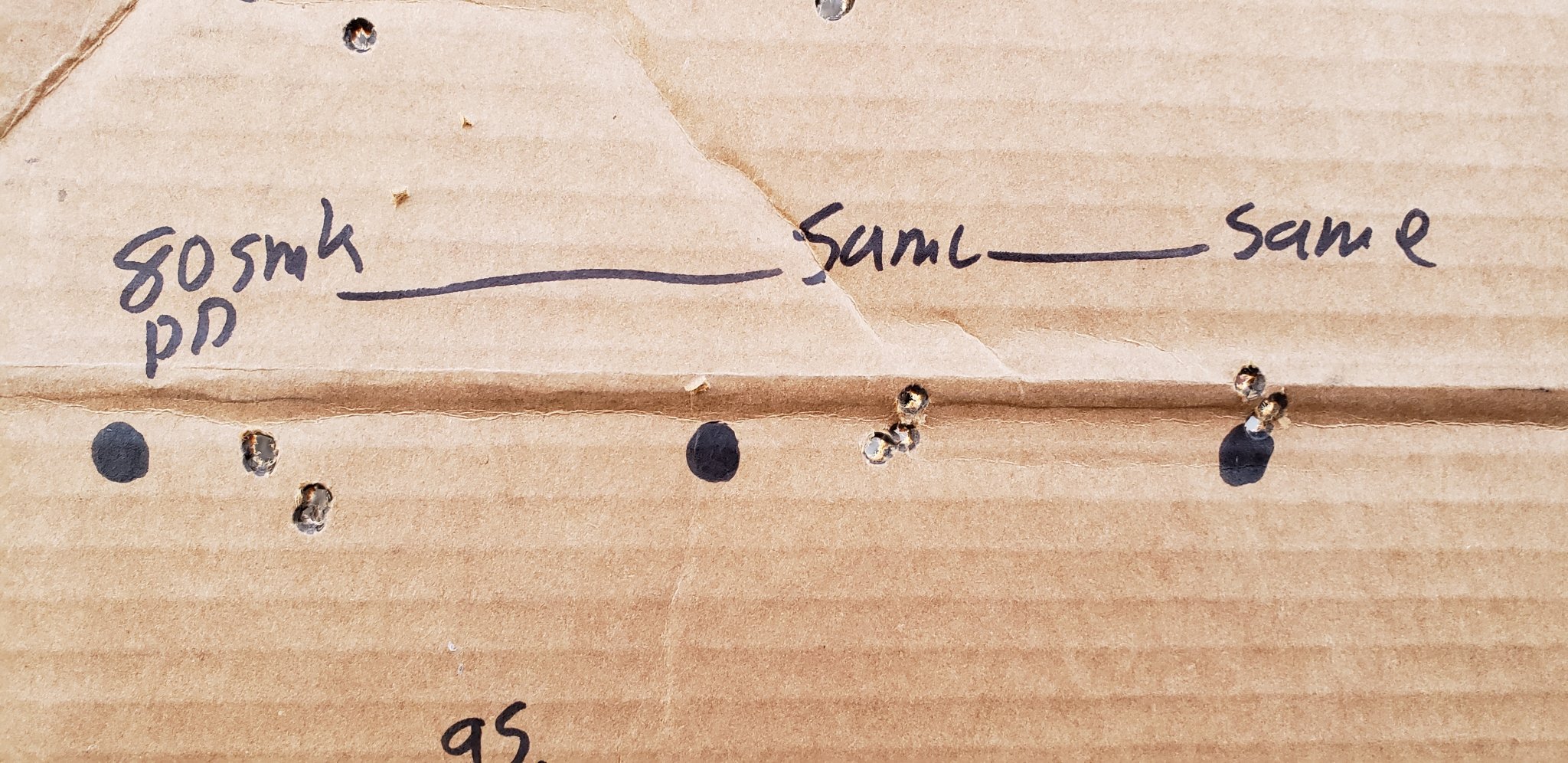

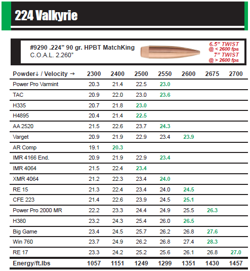

Did some initial load development today with Varget and Power Pro and 95gr SMK.
Barrel: Craddock Precision 22" 6.7 twist Rock Creek +2 gas
Brass: 1x fired Federal. Match prepped. Deprime, SS tumble, Redding FL sizer .003" bump, Sinclair expander mandrel, trim to 1.590" on Giraud.
Primer: Remington #7.5 Small Rifle Benchrest seated .002" deep.
Bullet: 95gr Sierra Matchking seated 2.30" OAL. .049" jump to lands.
Varget ladder over Magnetospeed V3:
21.2gr 2280
21.4gr 2310
21.6gr 2328
21.8gr 2354
22.0gr 2356 21.2-22gr went through one little ragged hole, sub .1mil outside to outside
22.2gr 2437 .2mil POI shift left
22.4gr 2427
22.6gr 2446
22.8gr 2470
23.0gr 2488
23.2gr 2507
23.4gr 2519 light ejection mark
I picked what I thought may be 3 sweet spots and loaded 3 each to test. These are the ones you see on the top of the target:
21.9gr 2397, 2365, 2358. SD 20 .582" group
22.3gr 2416, 2432, 2418. SD 8.7 .475" group
22.9gr 2473, 2474, 2479. SD 3.1 .090" group
Retested 22.9gr because it had the best SD and group and the second string was 2480, 2483, 2487. SD 3.4 .295" group. The barrel was very hot at this point and I was taking longer to fire the rounds due to mirage off the suppressor which I believe is the reason for the slightly higher velocity and the group opening up some. Shots broke clean but the image was slightly distorted.
I got the info I needed and moved onto Power Pro 2000MR. Decided to do .3gr increments on this one since it was a wider window.
22.9gr 2361
23.2gr 2364
23.5gr 2392
23.8gr 2401
24.1gr 2443
24.4gr 2455
24.7gr 2481 this round shift down and left out of the main group. It's the one high center in the red dot. Broke clean.
25.0gr 2514 this round was still low but shifted back right some. It's the lowest one at 2 o clock just out of the edge. Broke clean.
25.3gr 2549 this round went partially through the same hole as 25.0. Broke clean.
25.6gr 2593 this round made it's way back up into the main cluster.
25.9gr 2611
26.2gr 2670 this round went high of the main cluster, the more left hole.
26.5gr 2685 this round is the one just to the right of 26.2. Possible light ejector swipe. Very faint
Test charges which you will see towards the bottom of the target:
24.3gr 2411, 2405, 2435 SD 15.8 1.028" group. All shots broke clean but the last shot went low and a little left. It also cooked in a chamber a few seconds longer than the others which may partially explain the velocity jump but not the flyer.
25.7gr 2582, 2591, 2592 SD 5.4 .248" The was some mirage off the suppressor but image didn't seem too distorted, doubt it cause the one to go out a little.
26.3gr 2639, 2653, 2676 SD 18.6 .437" group. Some good mirage coming off the can at this point but not much distortion is seemed. None of these rounds cooked in the chamber any longer than the other ones. I believe this just starting to get into pressure and doing weird shit.
Retested 25.7gr 2600, 2585, 2603 SD 9.6 group .423".. I dialed my dope down .5 mil so that I could use the same dot on this one since I forgot to put a 4th. I was battling heavy mirage off the suppressor on this one, there was no air moving at this point. Shot 1 and 2 I got a clean image but shot 3 I waited and waited and sent it with a distorted image when I figured it had cooked enough. Round 2 was in the chamber a solid 10 second less than shot 1 and probably 20 seconds less than shot 3.
All in all I'm very happy with the initial testing. The barrel is shooting great and seems to loves the 95 SMK's. I also got a reminder of how dirty power pro is, you can even see on the target how much blacker the bullet holes are on the paper from the fouling as it progressed. Pretty crazy.
Tomorrow I'll be testing RL15 and H4350.

I just spoke to Redding regarding the seater stem on my premium die set leaving a ring on 95gr SMK's, 90gr SMK's, and 88gr ELD's. I can't figured out for the life of me why they wouldn't supply the Valkyrie set with the VLD stem since the whole point of this round is long high BC bullets at mag length, but...
If you get them you will need the entire Redding VLD replacement assembly which is part number 09183 and retails for $39.99 at midway. This also drops into their standard die set, so you don't have to buy the premium die set and then buy this. The premium die set does get you the carbide sizer button which would be $30 to add to a standard set if you like to size like that.
If you use an expander mandrel like myself and only plan on shooting the longer bullets I'd suggest buying the standard die set and then getting the VLD micrometer stem assembly. You'll save a few bucks in the process too.
Hope this helps. Also it was reported that Redding is offering a competition Type S FL bushing comp die set as a standard option, according to the rep I spoke to that is false. They're offering it as a custom die set currently but have no plans to offered it as a standard item unless the round catches on more.
On another note, Midway seems to have the best price on the seater stem, and they currently have 95gr SMK's on sale, and they have a free shipping code that applies to sale item orders. Needless to say another 1K 95gr SMK's and a seater stem is on the way.

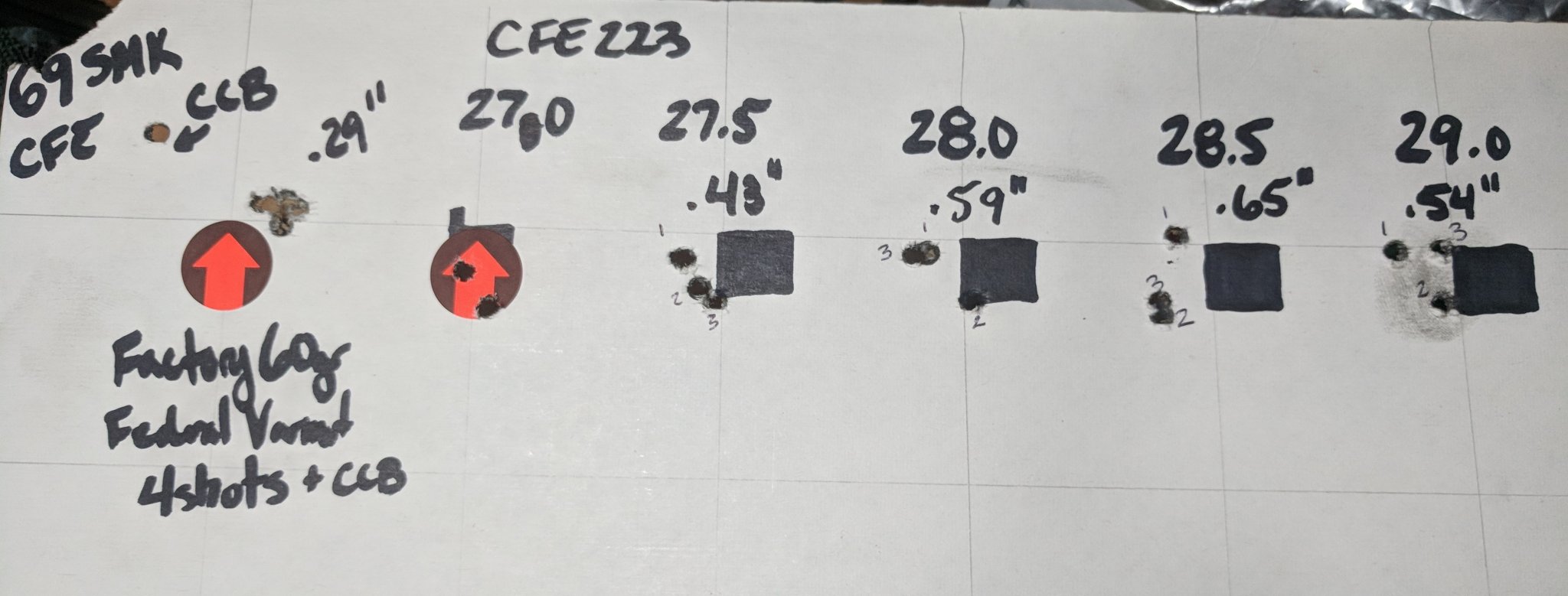

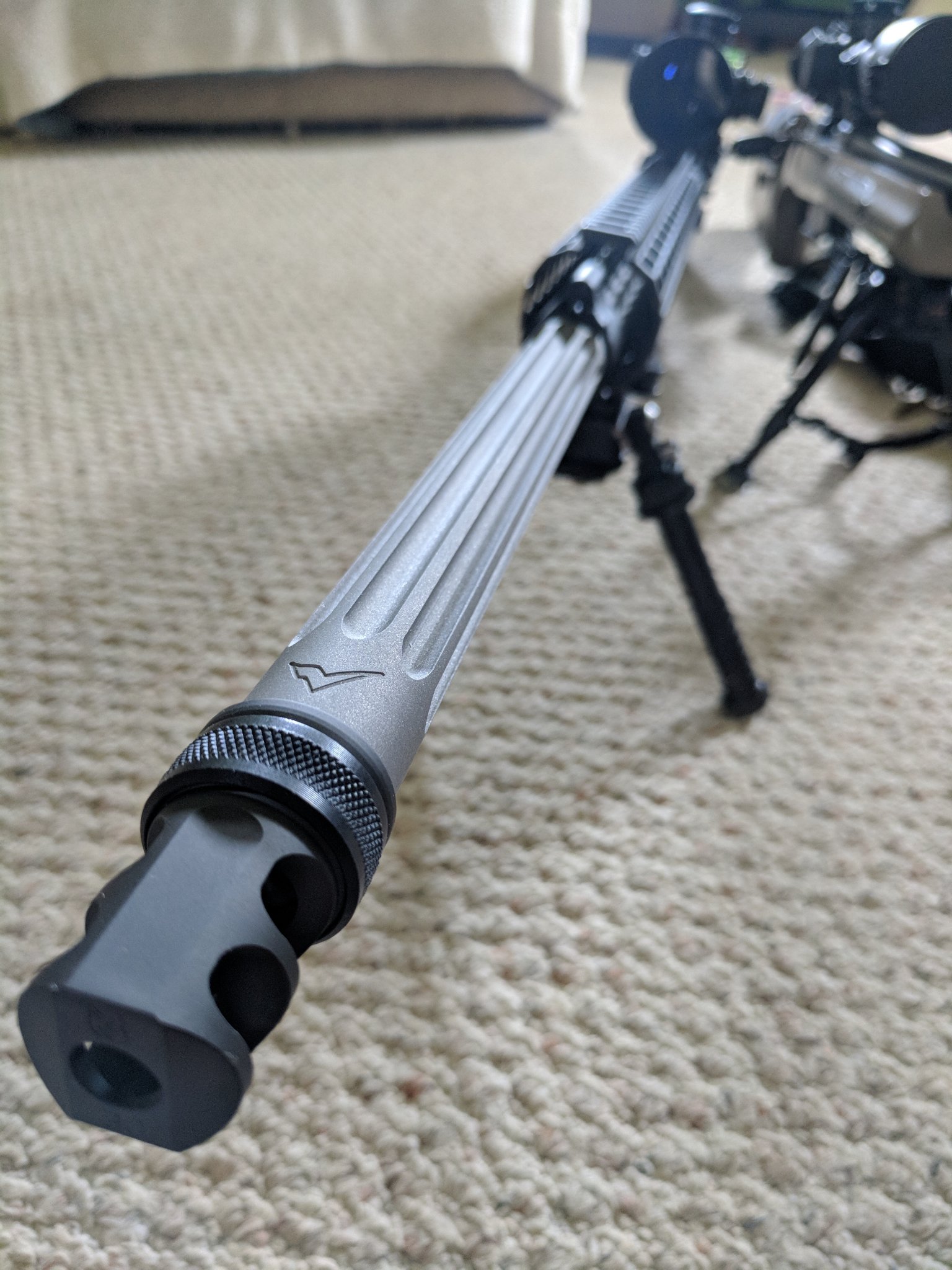

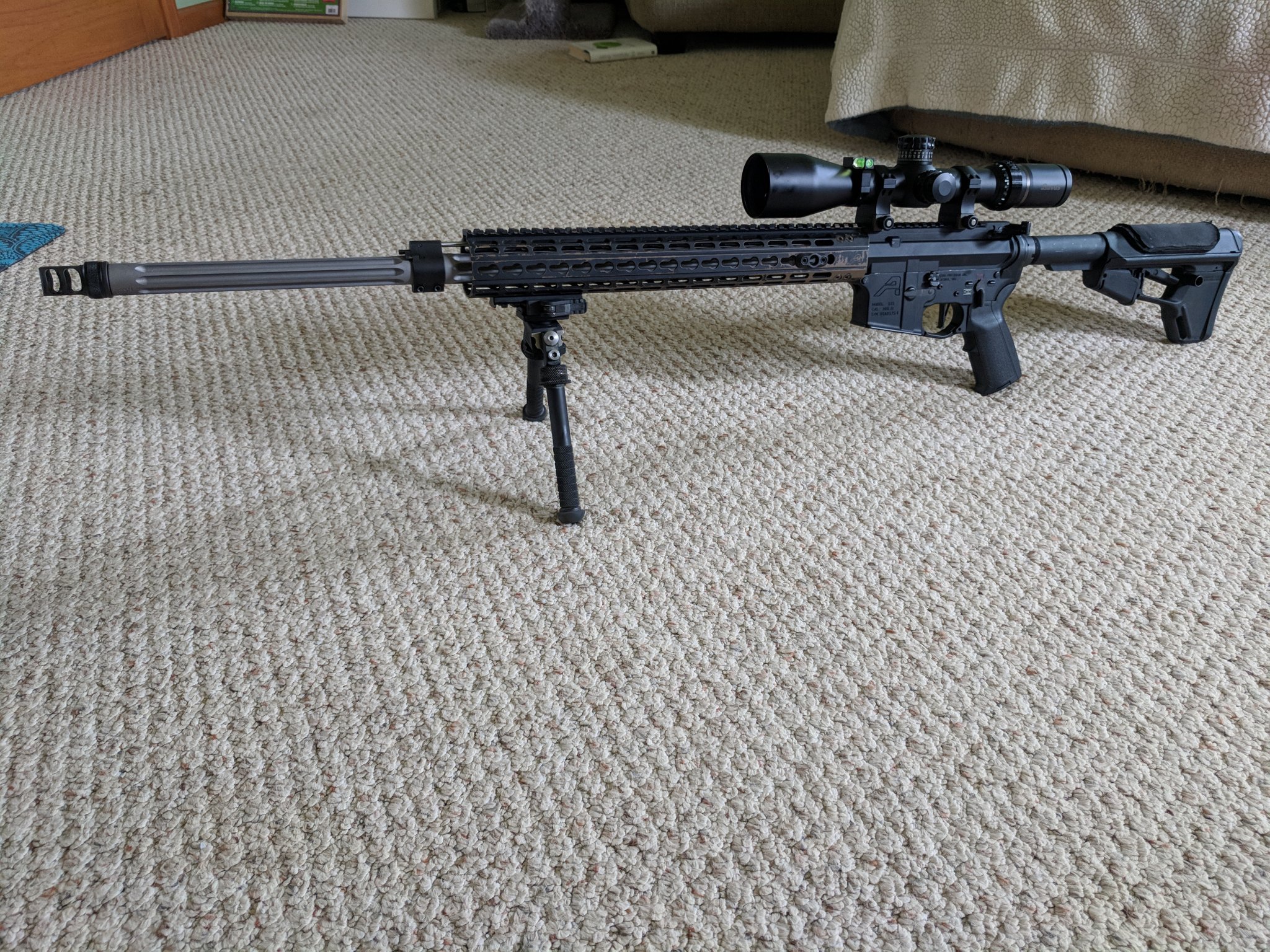

Quick addition to the 224 Valkyrie load library. Will be posting full results in next week or two (have to travel a lot for work next two weeks).
26" Rainier Arms Ultra Match 1:7.5T Fluted
Aeroprecision M4E1 Enhanced Upper & Lower
(Super impressed with barrel weight; feels much lighter than expected)
Note: ran this load through Quickload and verified pressure "safe" in my barrel and I tested for pressure. No signs other than slight crater in primers. Happened with factory ammo too.
69gr Sierra Matchking @ 2.220" OAL
CCI400 primer
Powder: CFE223
Federal brass: 32gr H20 volume after firing
Node @ 27-27.5gr
Tested 27.0 gr through 29 grains. 27gr should be around 3025fps and 29gr hits ~3205fps. Will verify with chrono during complete test.
Leftmost group is Federal Factory 60gr Nosler Varmint as control. Squeaky clean CCB is high left, next 4 into .29" just right of POA.
Complete bullet test will include 69SMK, 69TMK, 73 ELDM, 75BTHP, 77SMK, 77TMK, and 80SMK (if I can find them).
Powders will include R-17, R-16, R-15, CFE223. May try Varget if Quickload shows any promising loads but nothing jumped out so far...

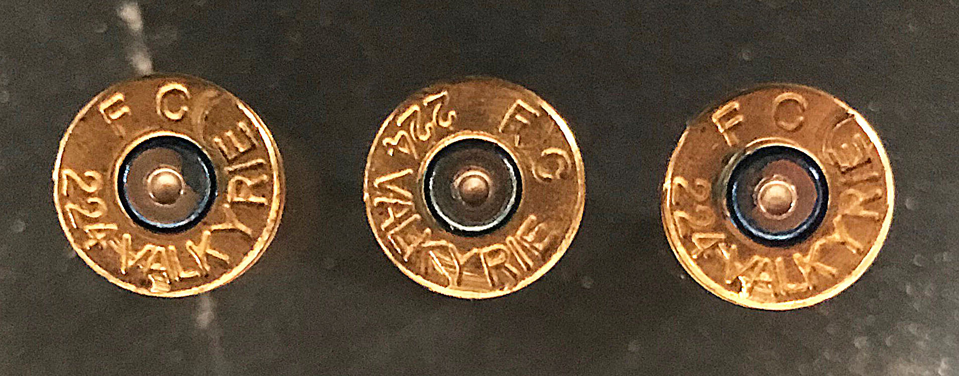

Got my modified case back and starting to work up loads for the 53 grain Varmageddon (IMR 8208 XBR and AA 2520), 70 grain RDF (IMR 8208 XBR and CFE 223 or RL 15) and 88 ELD-M (RL17 and RL15). The ELD-M's are long, .069" longer than the 90 SMK.

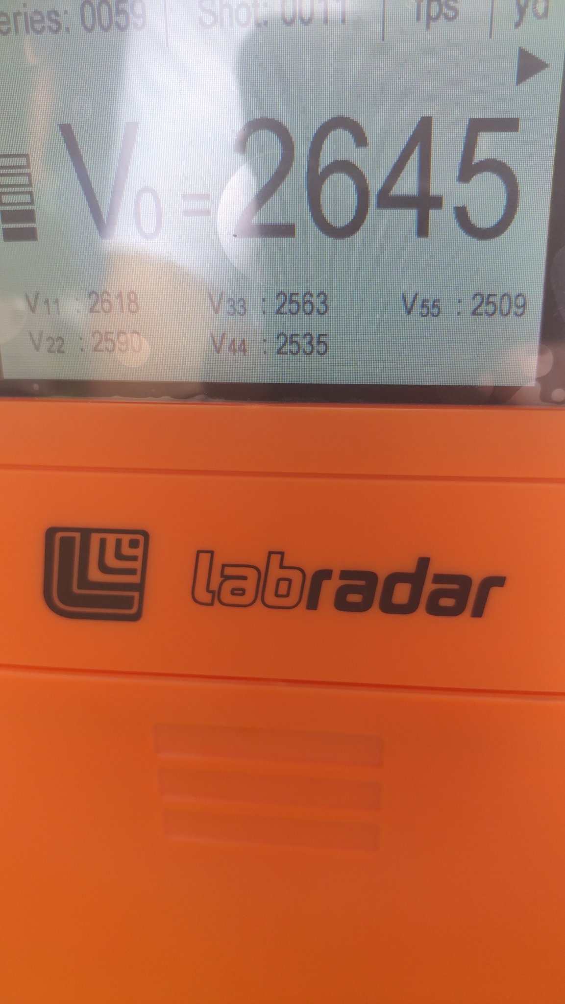

Federal 90gr Fusion Soft Point.
Specs: 18" PSA 1-7 twist
- 11shots
- FPS: 2645
- SD: 14

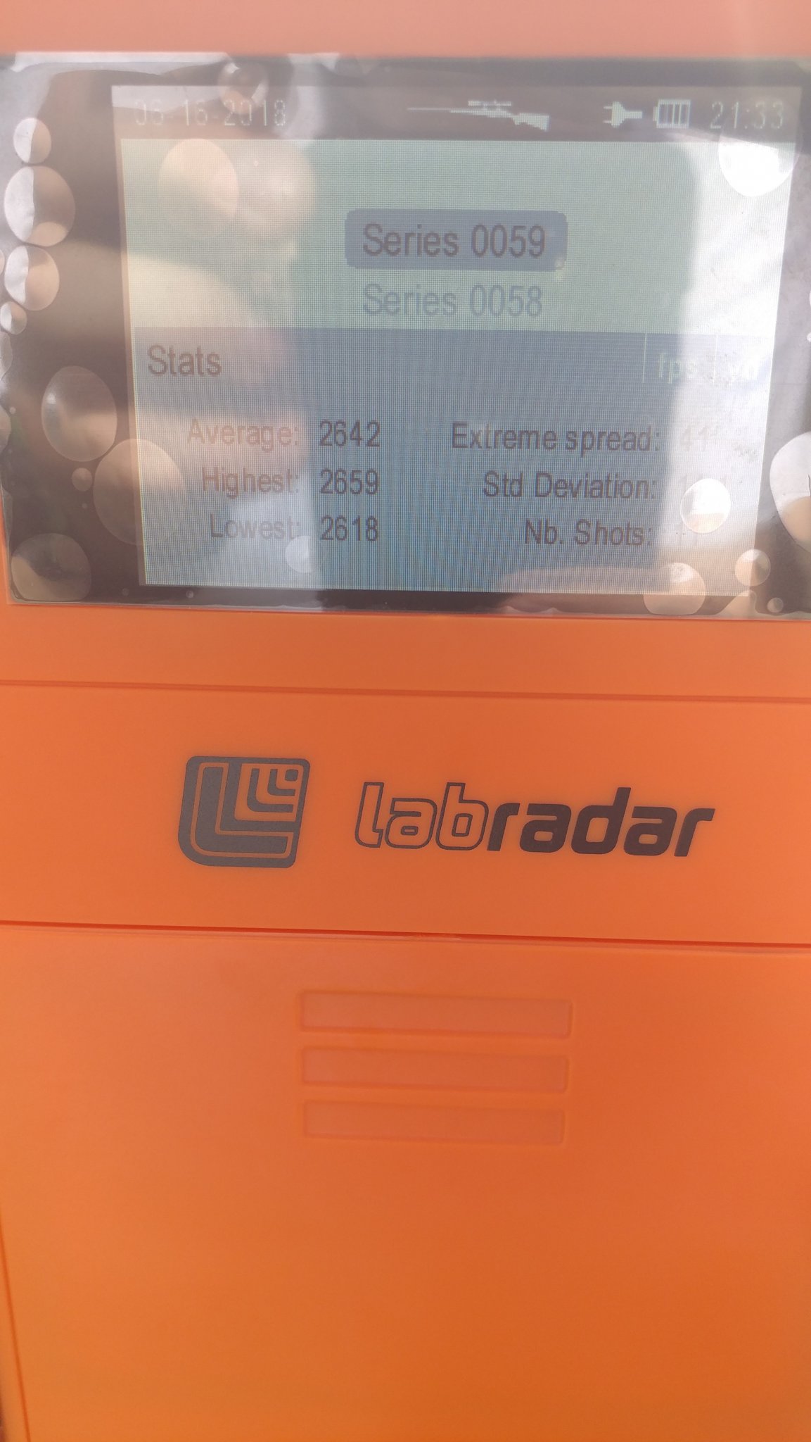

NoVa

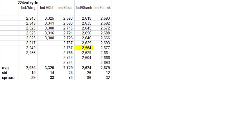

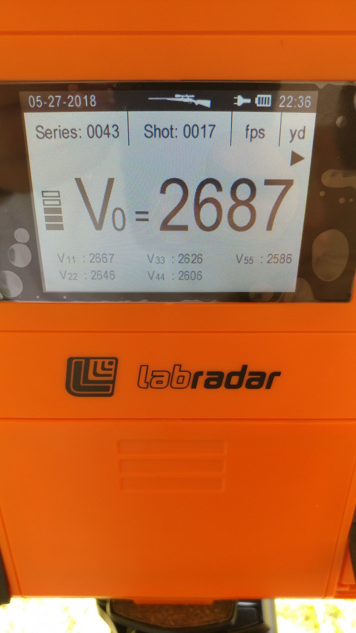

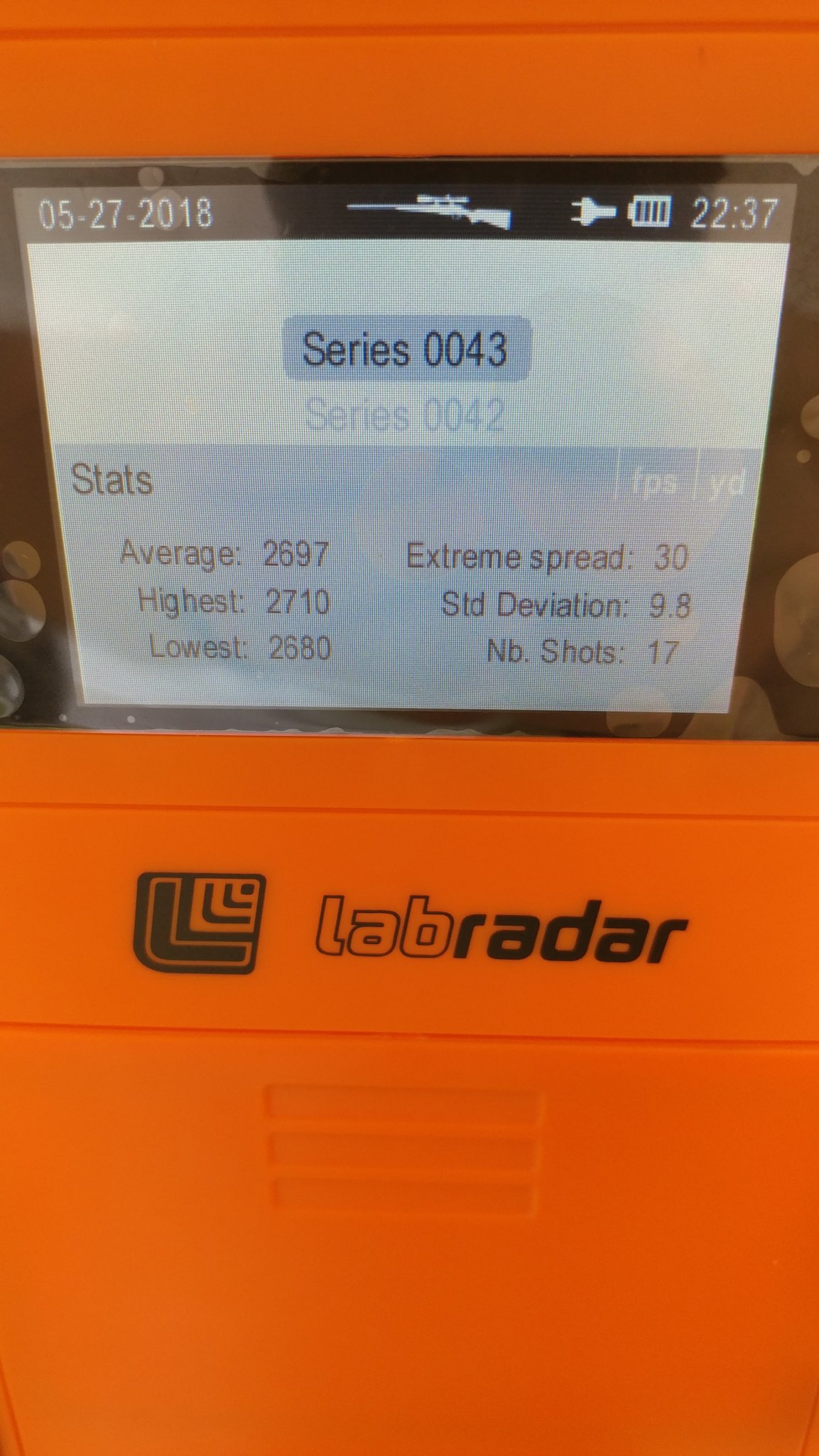

Also waiting on my modified case so meanwhile I got some chrony time with factory:
Federal 90gr SMK.
- 17shots
- FPS: 2687
- SD: 9.8
wow you're a little faster with 18" 1-7 than i am with 24" 7.5twist! i was using one of the 'old school' pro-chrono's, although you're slower with the fusion's.
Subwrx300
Major Hide Member
Belligerents
Jan 15, 2014
1,077
650
219
Cedar Springs, MI
alView attachment 6915478
Yeah, that's odd. There are a couple of blogs on barrel length vs speed and they found a 26" to be the same speed (and slower in once case) as a 23-24". I wonder if the factory 90gr has a relatively fast powder than can't keep accelerating in the longer tubes. I have a 26" that I'll pick some up for and try over Chrono.
@bigbore74 what is the lot number of your 90gr SMK Federal?
@davsco do you have your lot number by chance?
I thought I read of a couple guys getting major swings lot to lot of the early batches (really fast early lot and then they slowed it up). Could be mistaken though.

s33e043 and 041 are my two lot numbers, not sure which i shot above (though i should have kept track...)
PA Valkyrie
Jun 23, 2018
26
12
6
This is what I had happen with an early lot of Federal 90 SMK...extractor swipes and ejector marks. These were the three worst of maybe 10-12 that showed marks. And dummy me, I didn't save the box for the lot number. No such problems with other factory stuff or any handloads (so far). I'm also thinking of getting a heavier buffer spring or a JP H2 to maybe head this off in the future. What do you guys recommend? I'm running a Sanders Armory 24" side-charger upper with a rifle +2" gas tube, non-adjustable gas block. I have a Magpul PRS on a rifle-length buffer tube. I've been shooting for over 60 years, but I'm pretty new to the AR game, so suggestions are most welcome!
