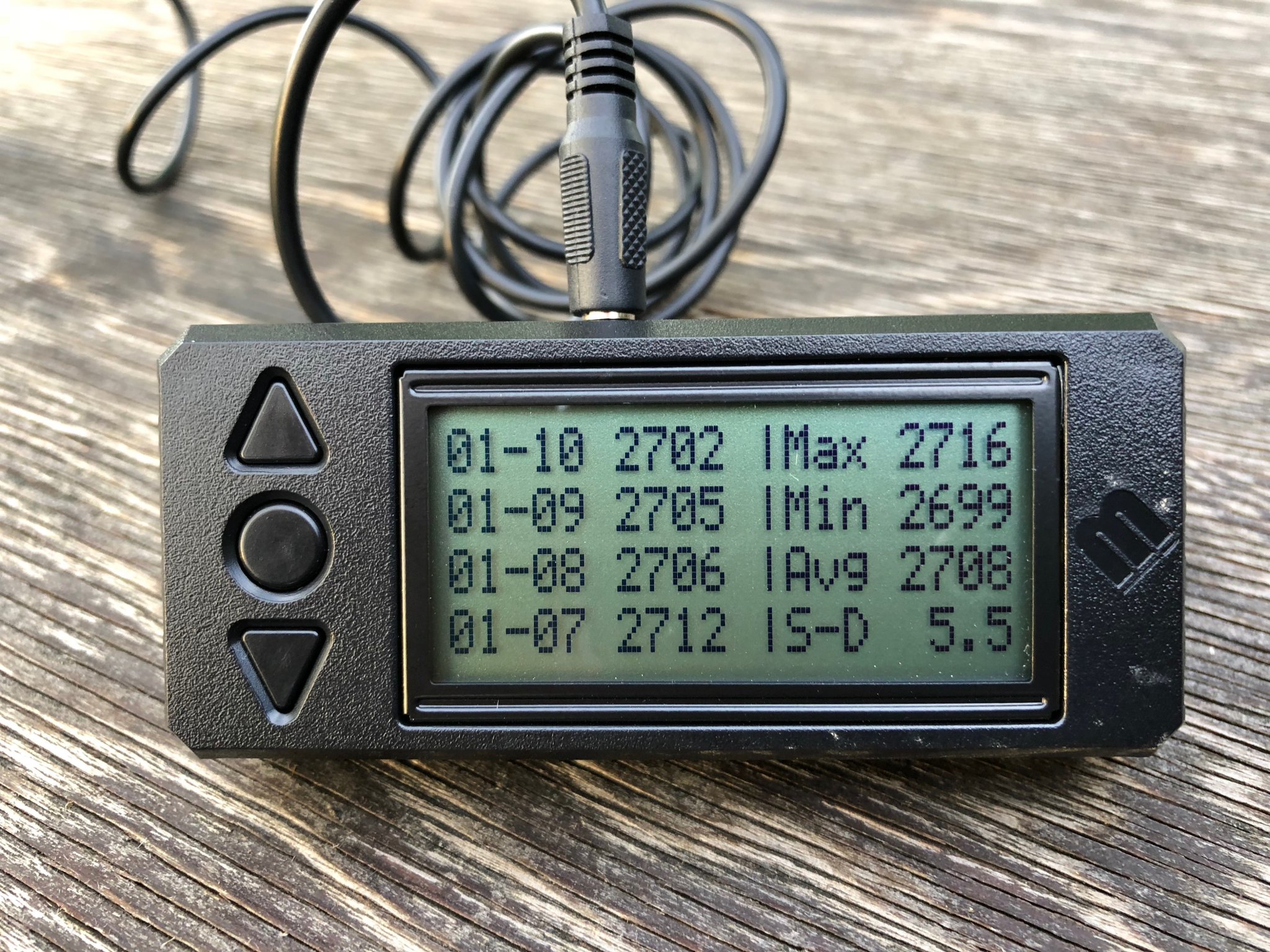

Velocity testing, 95gr SMK loaded to an overall length of 2.290 with RL-17 in new starline brass and CCI #41 primers.
two shots each charge weight over a magnetospeed from my 22" Bartlein barrel with rifle +2" gas system smithed by Craddock Precision.
25.4gr= 2557, 2554
25.7gr= 2583, 2589
26.0gr= 2605, 2608
26.3gr= 2670, 2693

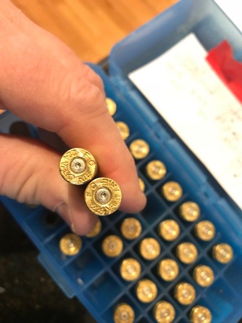

I stopped right there as that is a huge jump in velocity. 26 and 26.3 had ever so slight ejector polishing on the case head. One thing to note I was running my gen 1 JP SCS buffer system with the lightest spring weight so switching to the gen2 H2 SCS and or a heavier spring may delay the opening enough to get rid of the slight ejector marks.
Next up will be group testing and I think I'll start around 25.0 and go up to 26.0

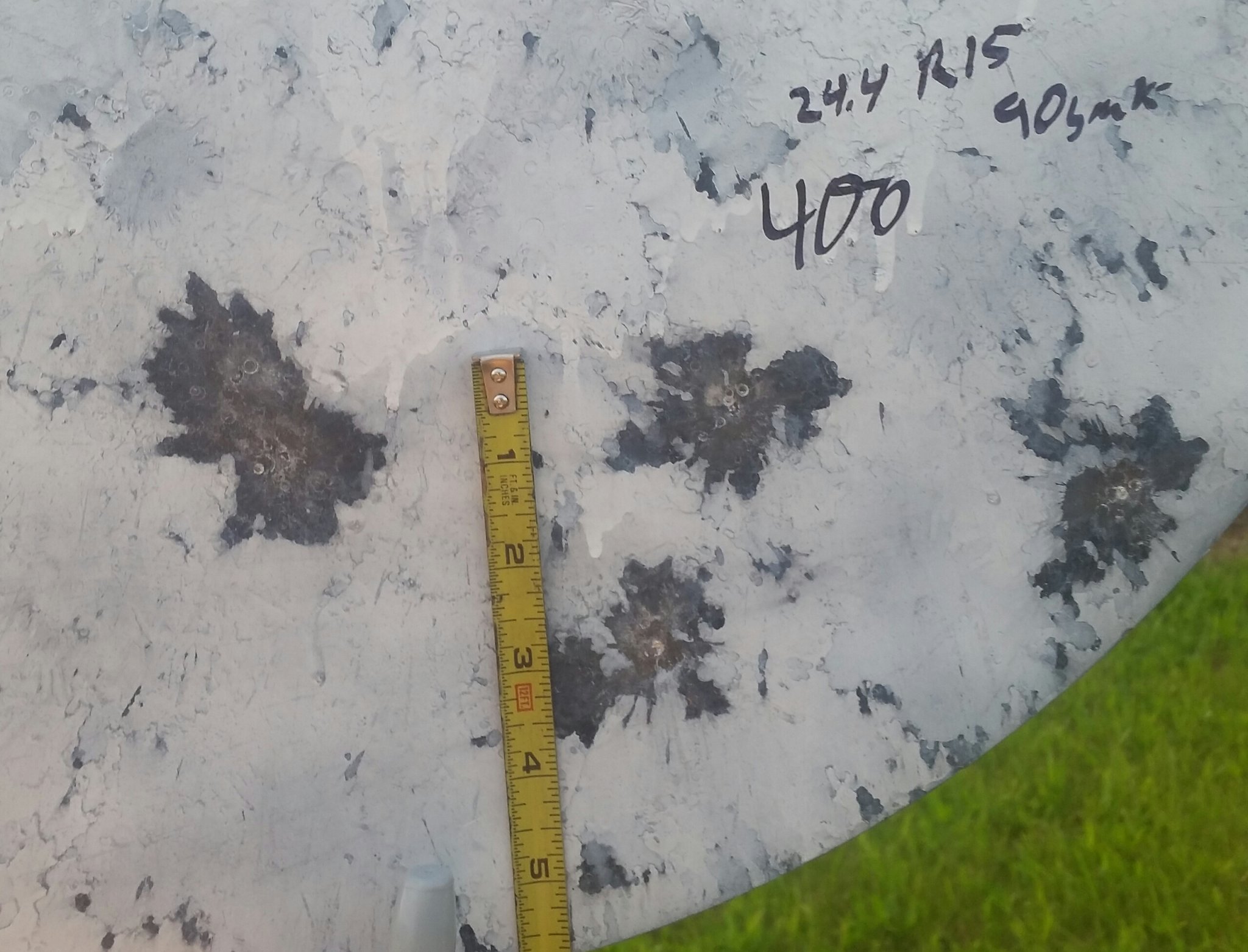

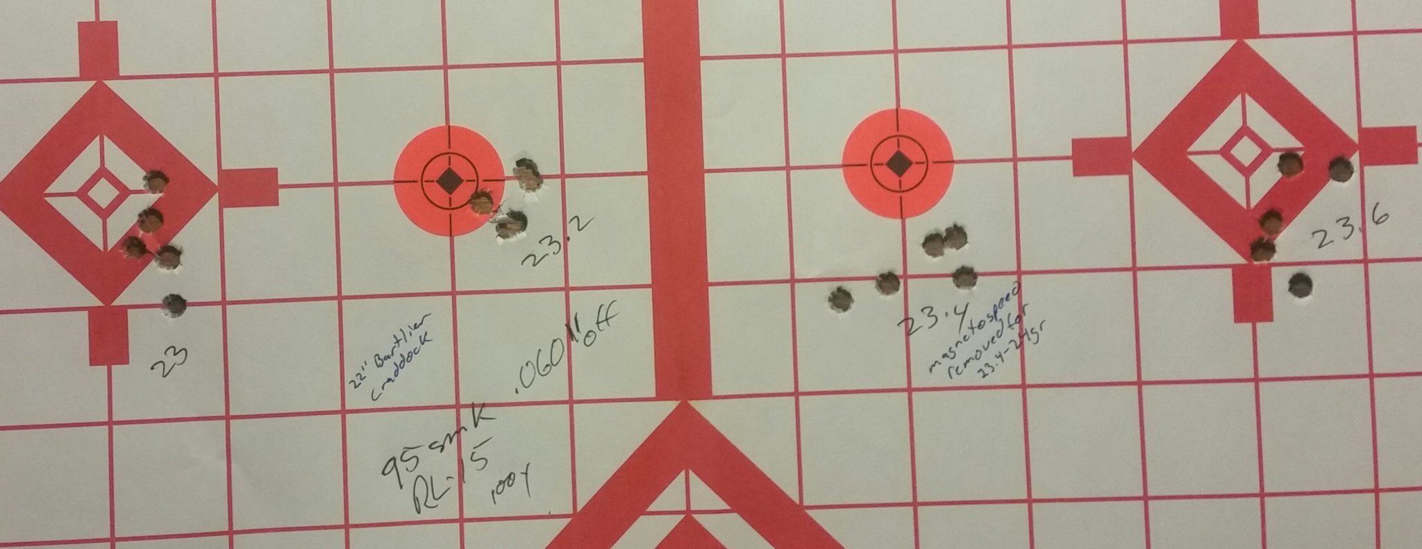

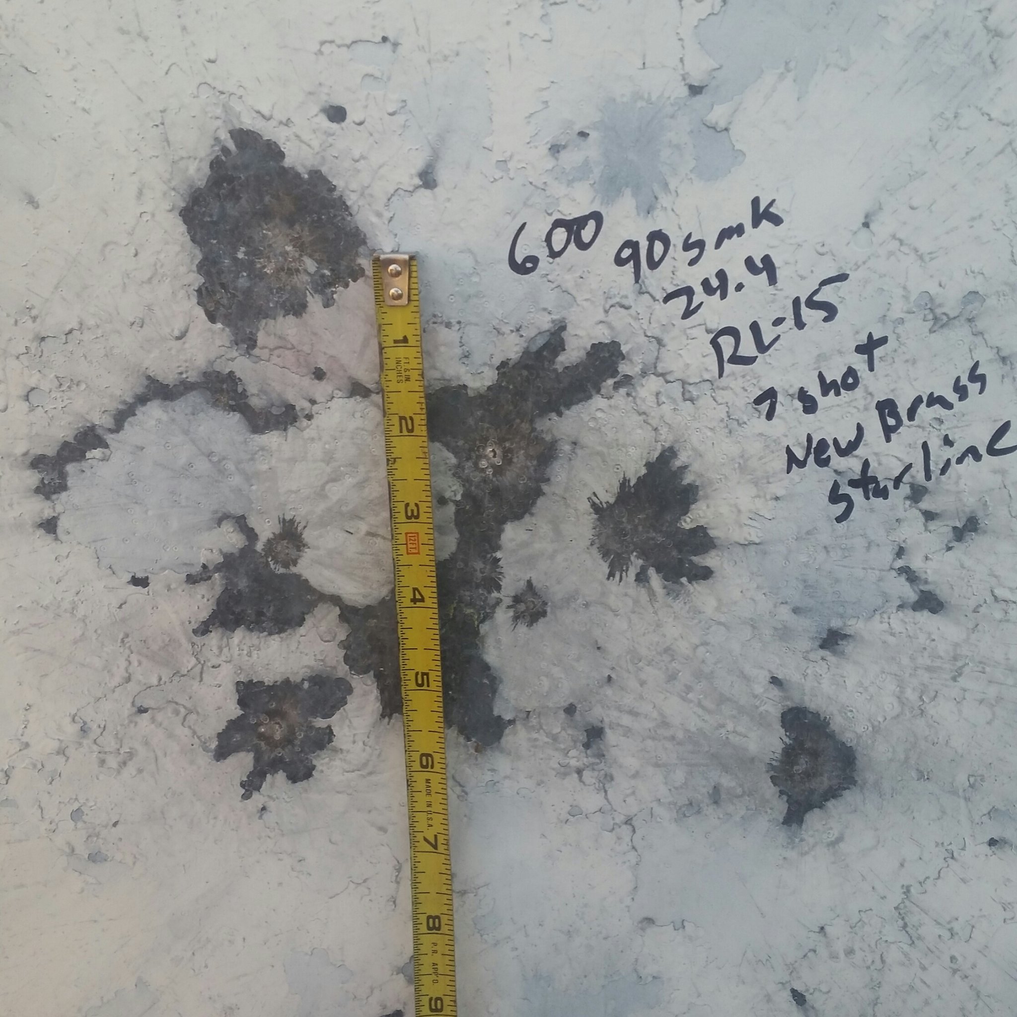

Load testing 95smk and RL15 at 100, 23.2 looks promising. My magnetospeed was attached for the first two groups but wasn't picking up velocity for some reason. Took it off for the rest groups got progressively larger to 24 grains which measured 1.1" ctc, 23.2 is right at .5" and if I had to guess 23.2 would be mid to low 2500's as yesterday 24.4 was clocking 2630.
Also attached is 90smk with 24.4gr RL15 at 500 (mis-marked 400) on fired starline brass and 600 on new starline, both are 7 shot groups.
Those groups look good at distance!
