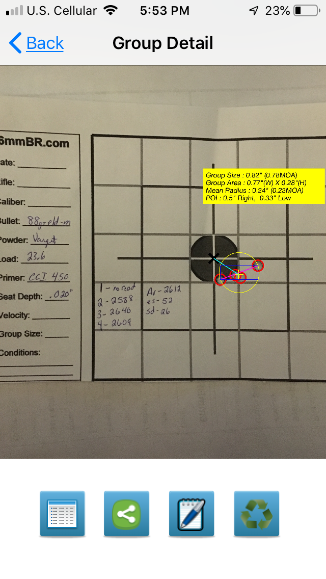

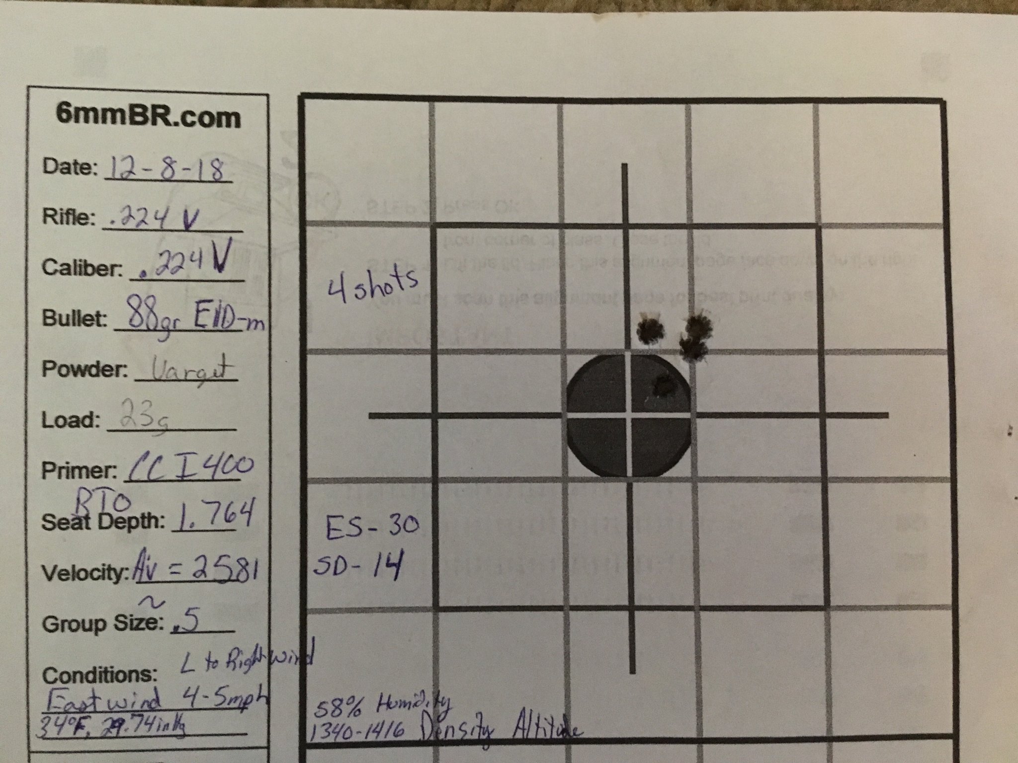

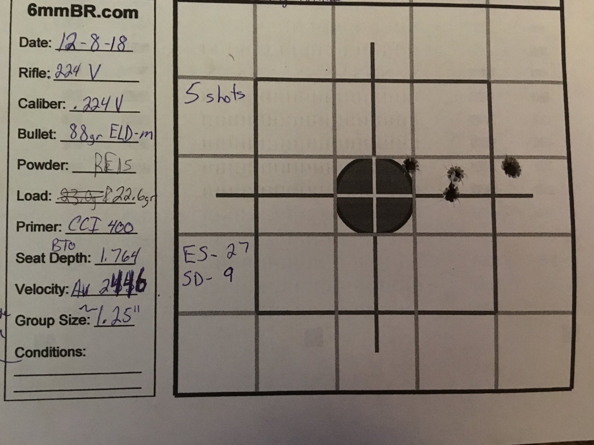

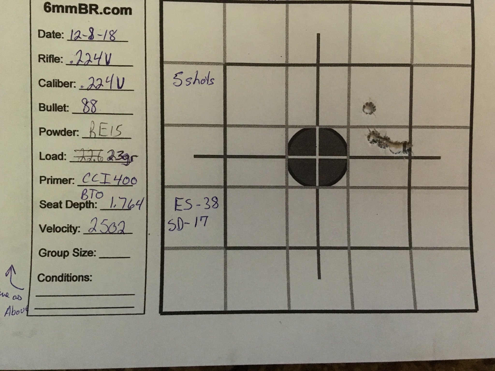

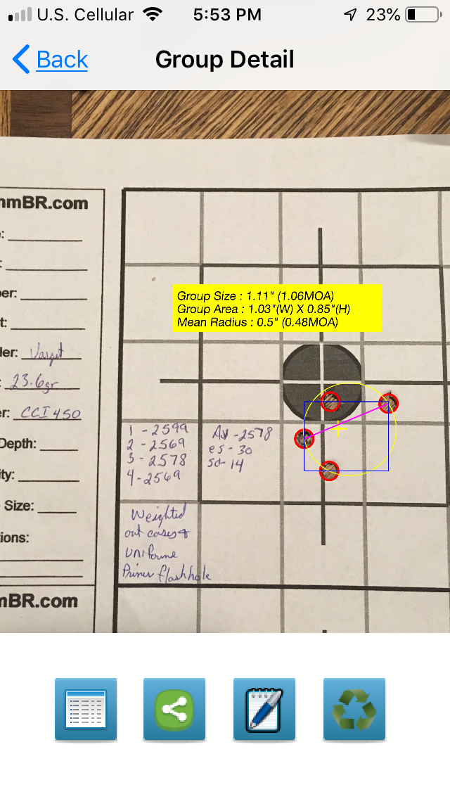

Ok I finally have some data to post for this thread:
Weather:
34*F
29.74 inHg
58% relative humidity
density altitude was going between ~1340-1416
overall length-2.318
base to ogive-1.764
.002 off the lands
Varget:
22.0gr
1-2473
2-2473
3-2501
4-2534
5-2464
average-2489
ES-70
SD-28
22.6gr
1-2574
2-2515
3-2525
4-2534
average-2537
ES-59
Sd-25
23gr
1-2599
2-2569
3-2588
4-2569
average-2581
ES-30
SD-14
Reloader 15
22.0gr
1-2415
2-2415
3-2419
4-2437
5-2442
average-2425
ES-27
SD-12
22.6
1-2433
2-2446
3-2460
4-2442
5-2450
average-2446
es-27
Sd-9
23gr
1-2520
2-2520
3-2492
4-2496
5-2482
average-2502
es-38
sd-17
What are your guys' thoughts.....es and sd isn't the best, thinking of going .010 off with the better of the loads then I may do the same loads with CCI450's after I get the 50rds I have primed with CCI400. Let me know, this is the first time reloading so any guidance would be appreciated.

You've got another .5-.8 grains before getting near max pressure (according to book). Did you get significant pressure signs at the highest loads shown? If not, I'd try loading up and slightly over past max to see if SDs come down and your velocity should jump another 50-75+ fps.
And don't change seating depth yet. Use the same -.075 off lands until you find peak pressure, then you can run seating depth forward in .010 increments with the best SD load to see if you can tighten groups.
My .02 cents anyway. Good post!
Yeah I was going to load some more tonight and take the loads up that showed good accuracy but warmth and good movies kept me from loading more, so tomorrow morning loading and then sometime tomorrow shoot hopefully again lol. No significant pressure signs yet, when I loaded my very first rounds and shot them during the week they was loaded on the very low end and top end and the primers on the top end was starting to crater a little. I didn't get any data on speed or anything because a damn cloud covered right when I was ready to shoot and the crono would not pick anything up. I modified the crono now with lights and picks up great now.
I'm only .002" off lands,
Thanks Subwrx300, appreciate it!

Is this a bolt gun or semi-auto? If it's a semi-auto, I would strongly encourage you to seat bullets further off lands than .002. A semi auto loading the next round (which comes to an abrupt halt in chamber) can slightly unseat bullets, which would possibly push bullet into lands creating MUCH higher pressure.
Also Ogive shape variation (.001-002 in some lots) could cause a few bullets to be closer to the lands and also cause high pressure issue.
This could easily be the reason for your high SD numbers. I would seat at a minimum of .005" to .010" off lands for any semiauto. Bolt guns can be loaded closer but not usually advisable for field guns (i.e. anything other than benchrest guns).

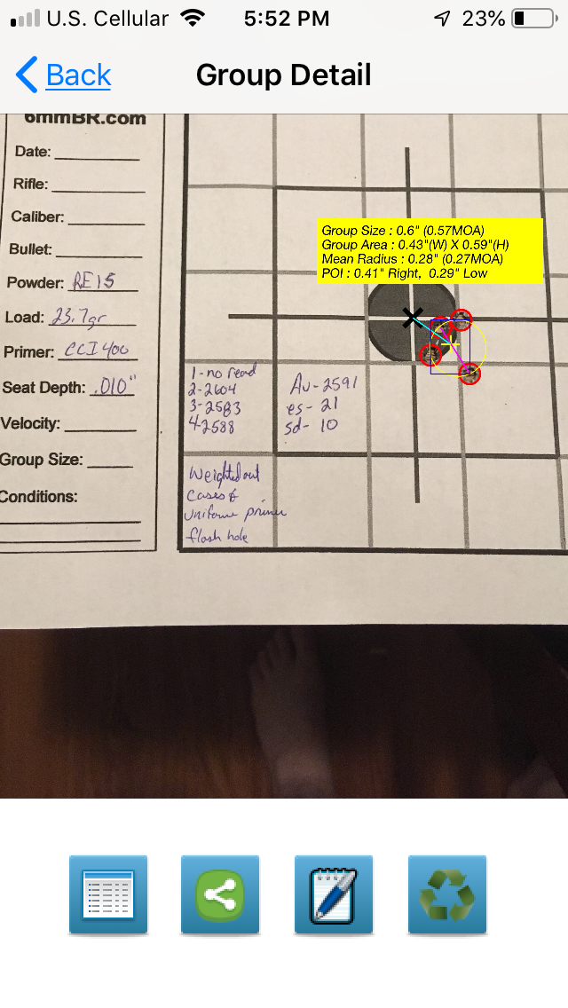

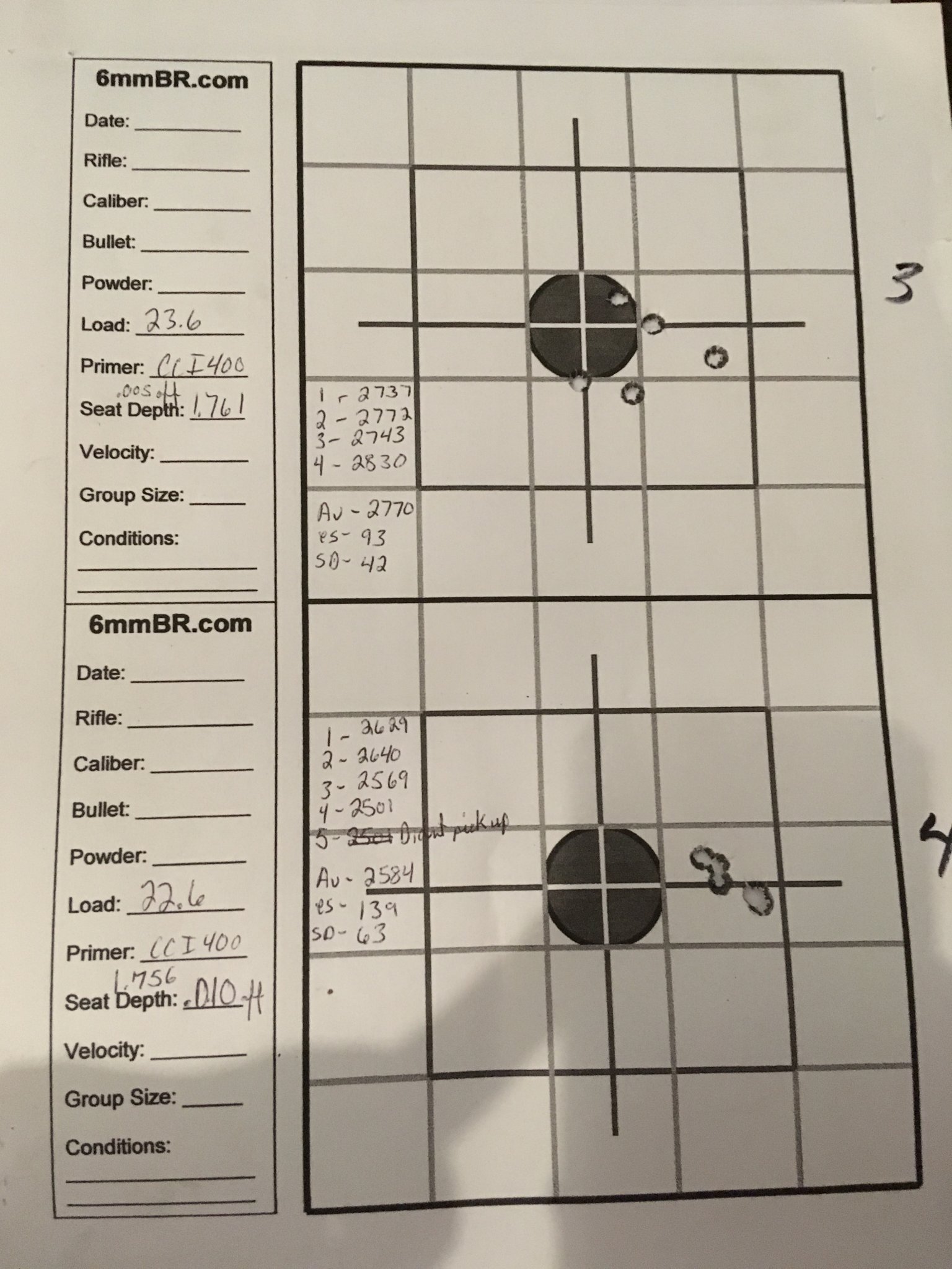

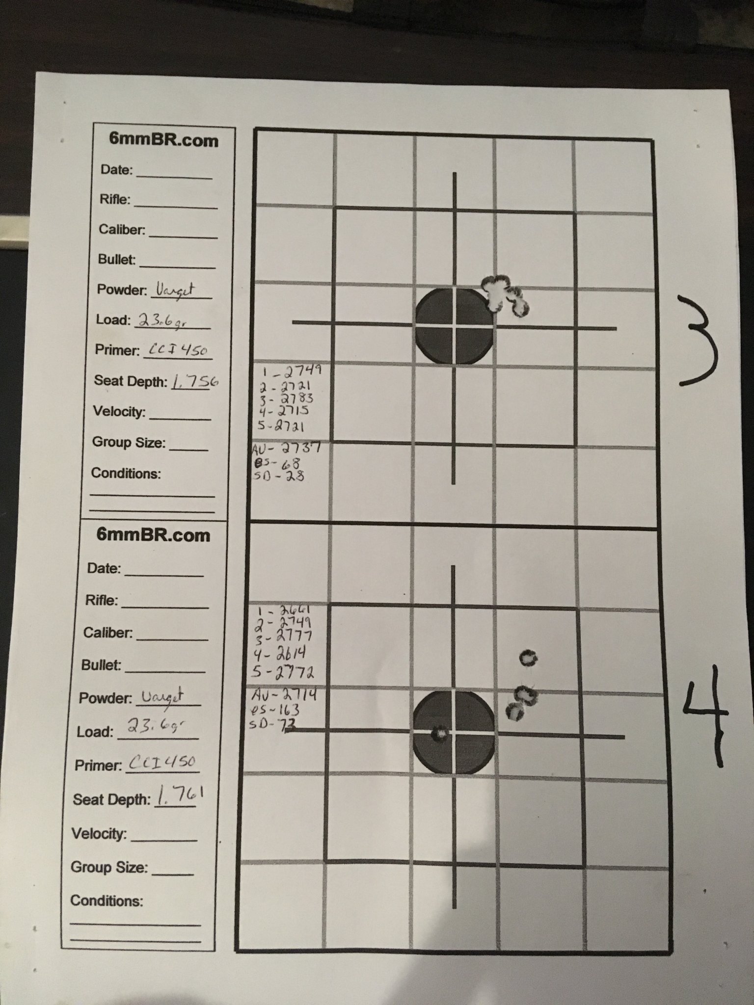

Round 2 of reloading, I decided to just do one powder to simplify. I started to see ejector marks and cracks in necks in some, mainly in the ones with CCI400 primers. The shells have been FL sized, necks turned on the second loading and on the third, just neck sized.
Loads with CCI400 and varget
23.6gr .002 off, Coal-2.318" BTO-1.764
av-2665
es-90
sd-33
.635 ctc
22.6gr .005 off, coal-2.315" BTO-1.761
av-2613
es-62
sd-26
.900" ctc
23.6gr .005 off, coal-2.315 BTO-1.761
av-2770
es-93
sd-42
1.230 ctc
22.6gr .010"off, coal-2.310 BTO-1.756
av-2584
es-139
sd-63
.605" ctc
Loads with varget and CCI 450
22.6gr .002 off, coal-2.315 BTO-1.764
av-2590
es-35
sd-18
.605 ctc
22.6gr .010 off, coal-2.310 BTO-1.756
av-2575
es-60
sd-26
.765 ctc
23.6gr .010 off, coal-2.310 BTO-1.756
av-2737
es-68
sd-28
.460 ctc
av-2714
es-163
sd-73
1.355 ctc

Wow. Those are some crazy SDs. I'd start looking at another powder if you can (most likely slower). Doesn't seem to be working in your favor. Maybe H4350 (but velocities will most likely suck) or something in between Varget and H4350: CFE223, BLC-2, Reloader 15 (I think) or maybe MR2000.
But a couple of questions before you do (and please don't take offense; I'm asking because, honestly, those loads are easily some of the highest SD/ES I've seen posted here from a bolt gun.)
1)Do you reload for other cartridges?
2)If YES, do you get similar SD/ES?
3)If YES to #2, how are you throwing/weighing your powder charges?

CBE4D239-AB3A-4CE3-9A42-0FF6809122B0.pngCB2F771A-8DF3-4118-BAC7-C985785C5866.pngB372FAFE-704B-482B-B765-C944DE6BFA6D.png
I think I’m done with varget for now which sucks because it’s temp stable.....the es, sd numbers just suck for me and my rifle. Would different primers help?
I’ve done more case work with varget and still not so good numbers, I’m at my max charge and starting to see ejection swipes.
Going to try reloader 15 and cfe223, sure wish varget worked because it is temp stable.
Has anyone had issues with cfe being inconsistent as far as es, sd numbers and speed?

I've heard good things from people about H4895 being used with the heavier bullets. Hodgdon doesn't give any data for it, but it's supposed to perform around the velocity of cfe 223 but with the temp stability of other hodgdon extreme powders.
Lol damn it!!! Another powder to get sometime! Do you have any load data, velocities, ect with loads built using H4895?
Thanks for the reply.

I haven't started building mine. So I dont have any personal data to share. If you get on Facebook, there is a group called 224 Valkyrie Reloaders that if you search there you'll see a ton of great info.

View attachment 6987079View attachment 6987078View attachment 6987077
What app is that on your phone?
