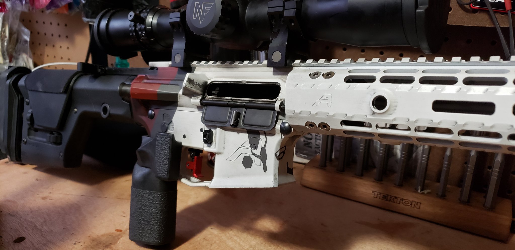

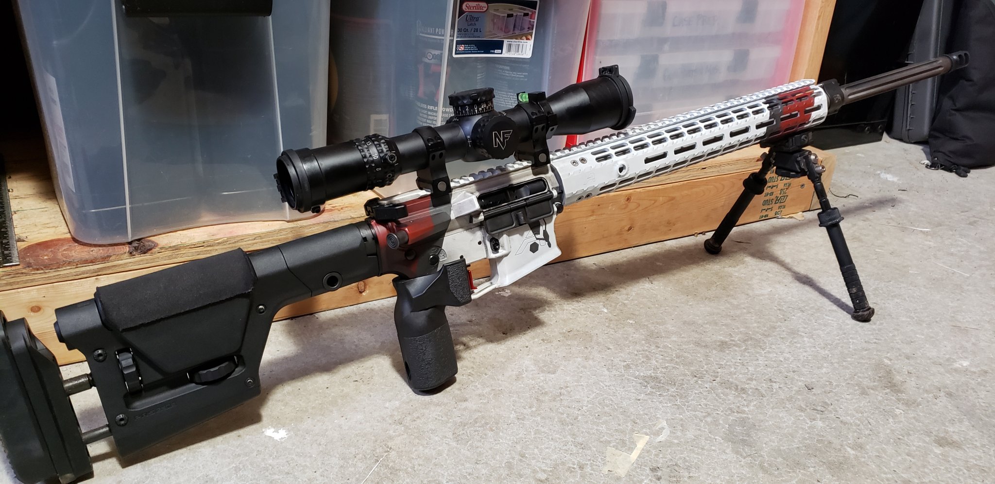

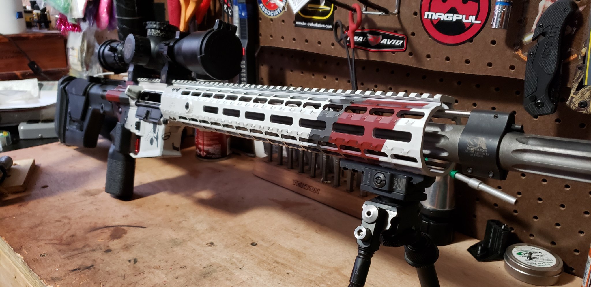

My 224V built as follows:
  • 26" +2 Gas 7.5T Rainier Ultramatch Fluted Barrel (they have since made 26" barrels +3 gas system) $500
  • Superlative Arms Bleed off block .936" $100
  • Aeroprecision M4E1 Enhanced Upper/lower matched set $550
  • MPA Vertical grip - need to drill hole for safety select spring; super easy mod. $80
  • Calvin Elite 1.5lb single stage - Fully Adjustable Position Trigger (best precision AR15 trigger I've run of 5+ triggers!)$275
  • Magpul PRS Gen 3 stock $225
  • JP Silent Captured Spring - standard buffer weights; using green (+1) heavier spring, may go to yellow. $150
  • Brownells 6.8 bolt and BCG (great value and wipes very clean in one pass) $100
  • Thunder Beast CB Brake for Ultra 9 suppressor. $125
  • Nightforce ATACR 4-16 scope with High NF rings 2200
Total w/o optic: $2105
With optic: $4,305

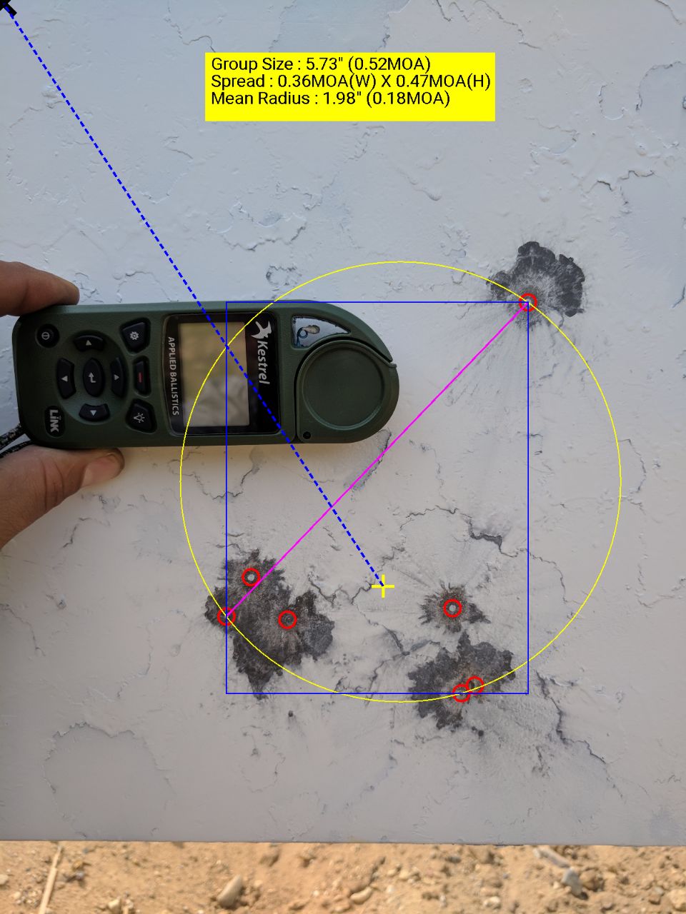

Shoots great! Average .5-75 moa depending on bullet and load.
20181203_145456.jpg20181203_145506.jpg20181203_145155.jpg20181130_184524.jpgtarget_image-1.jpg
Shot above at 1060 yds with 88ELD handloads.

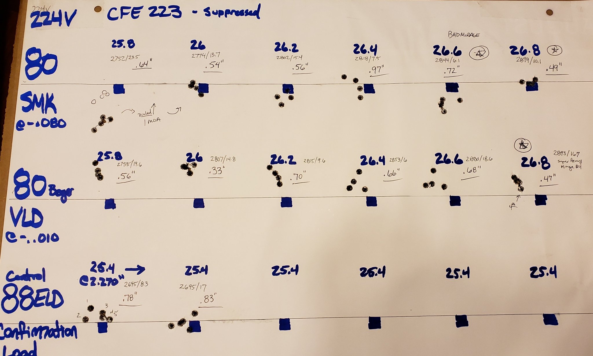

Loving my 224V and 88 ELD-M's with CFE223. Super soft shooting and extremely accurate to 700 which is the furthest Ive shot it to date.
22" Rainier Ultramatch Fluted +2 Gas
MEGA NiB Billet Matched Receiver Set
Seekins SP3R V3 Handguard
Superlative Arms AGB
JP 6.8/224V Bolt Assembly (headspaced to barrel by Rainier)
Toolcraft NiB Carrier
JP SCS Gen2
Magpul PRS Gen3
ERGO Tactical Deluxe
BAD Ambi Safety
Geissele SD-E
Rugged 3 Port QD Brake
88 ELD-M/CFE223 OCW Test
88 ELD-M/ 25.5gr CFE223 Seating Depth Test - 5 shot groups
636yd - 20mph Wind - 88 ELD-M/CFE223
Reactions: lash

I can say when I played with various load development with 75's, 80's and 88's....the tune is different for them vs 88's. The 88's cycle 100% and the gas block is maybe a 1/4 of the way open. 75's/80's need more weight and less gas. BCG was cycling too fast.
