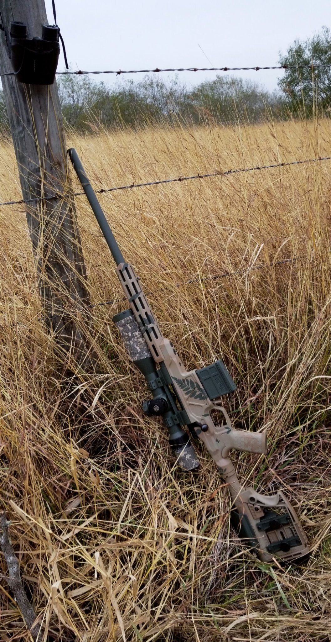

It's a Howa 1500 in 6.5 CM 24"
Had a temporary Tango6 4-24x50 while my primary scope (Bushnell LRHSi) got some warranty work done to it but I ended up breaking my Sig and now I don't have a scope. My Bushnell should be here pretty soon though!
