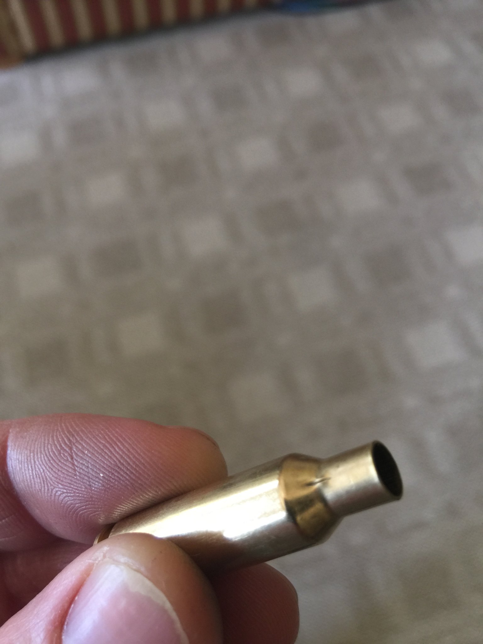

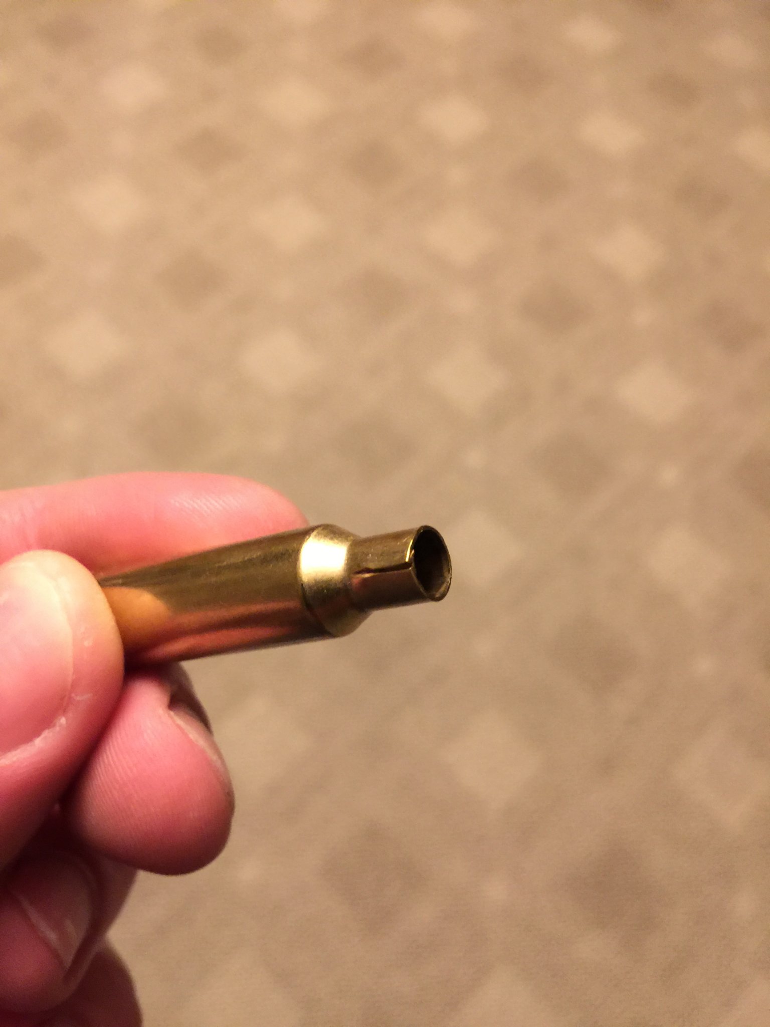

In the meantime I received 300 brass from Federal. Upon inspection for brass prep I was horrified at the quality. I had several pieces straight out of the bag that had splits in the neck and shoulders. The primer pockets feel sloppy.

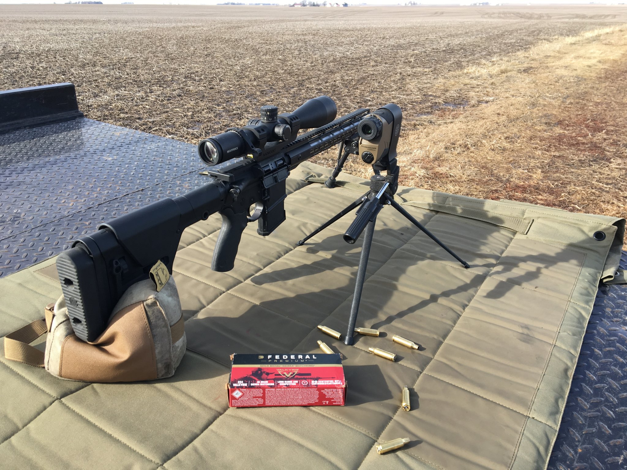

I had zero issues through 80 rounds yesterday. It was plenty accurate enough for me as well. A4E88FAB-47B2-4D82-9453-CAADBB1F5858.jpeg

That sucks about the brass, I had the same issue with a bunch of Winchester brass last year, about 20% of the cases were folded like that.

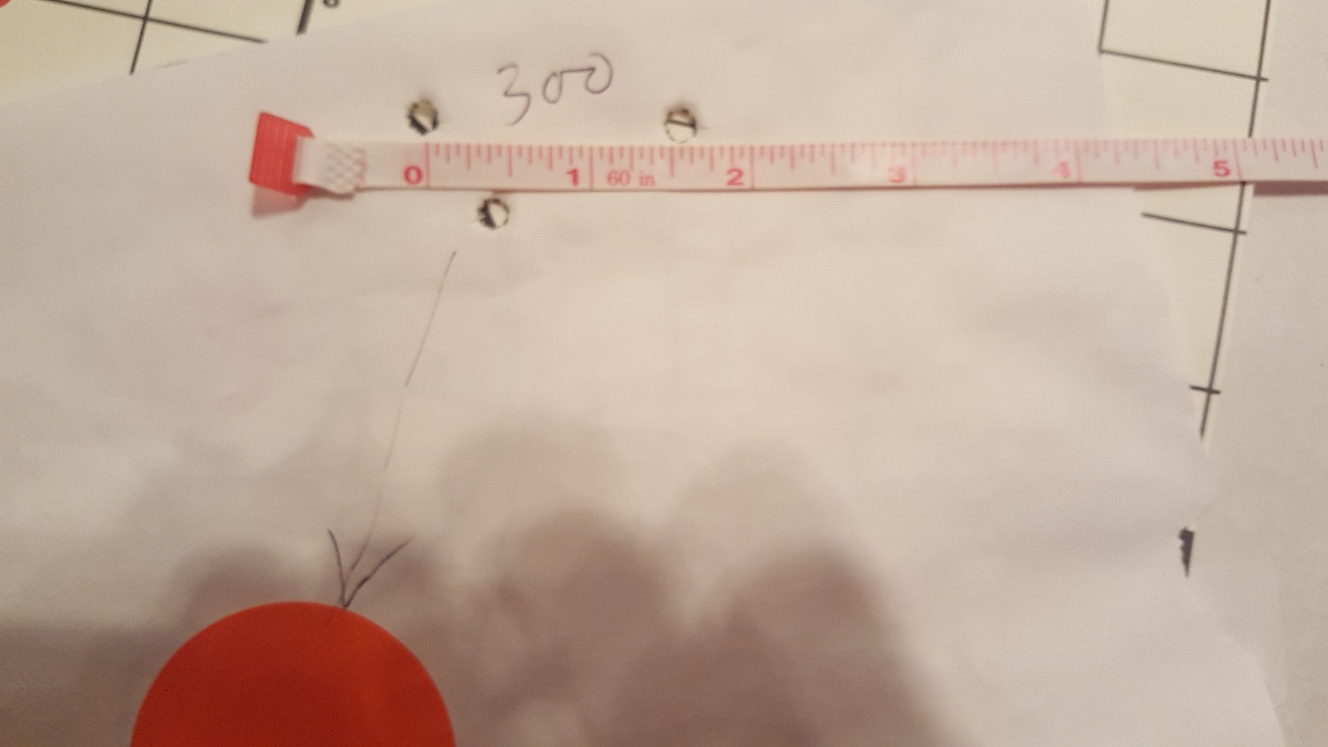

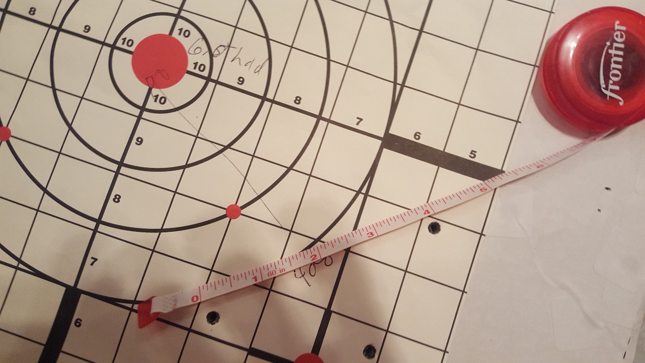

a bunch of valkyrie threads, not sure where to post these from today. have a 24" 1-7.5 twist, which most say won't stabilize the fed gold medal 90's. but so far so good out to 400yds. just some 3 shot groups as i was low on ammo but all sub-moa with no indication of keyholing. next time will shoot at 500 and 600. what's weird with this ammo is it is well left and low from all the other valk ammo i have shot, including the fusion 90. at 100 it is roughly 3" low and left from the others, and all the others have a pretty close POI. also will shoot the hornady 88 eldm when they arrive.224v rainier 200yds.jpg224v rainier 300yds.jpg224v rainier 400yds.jpg
