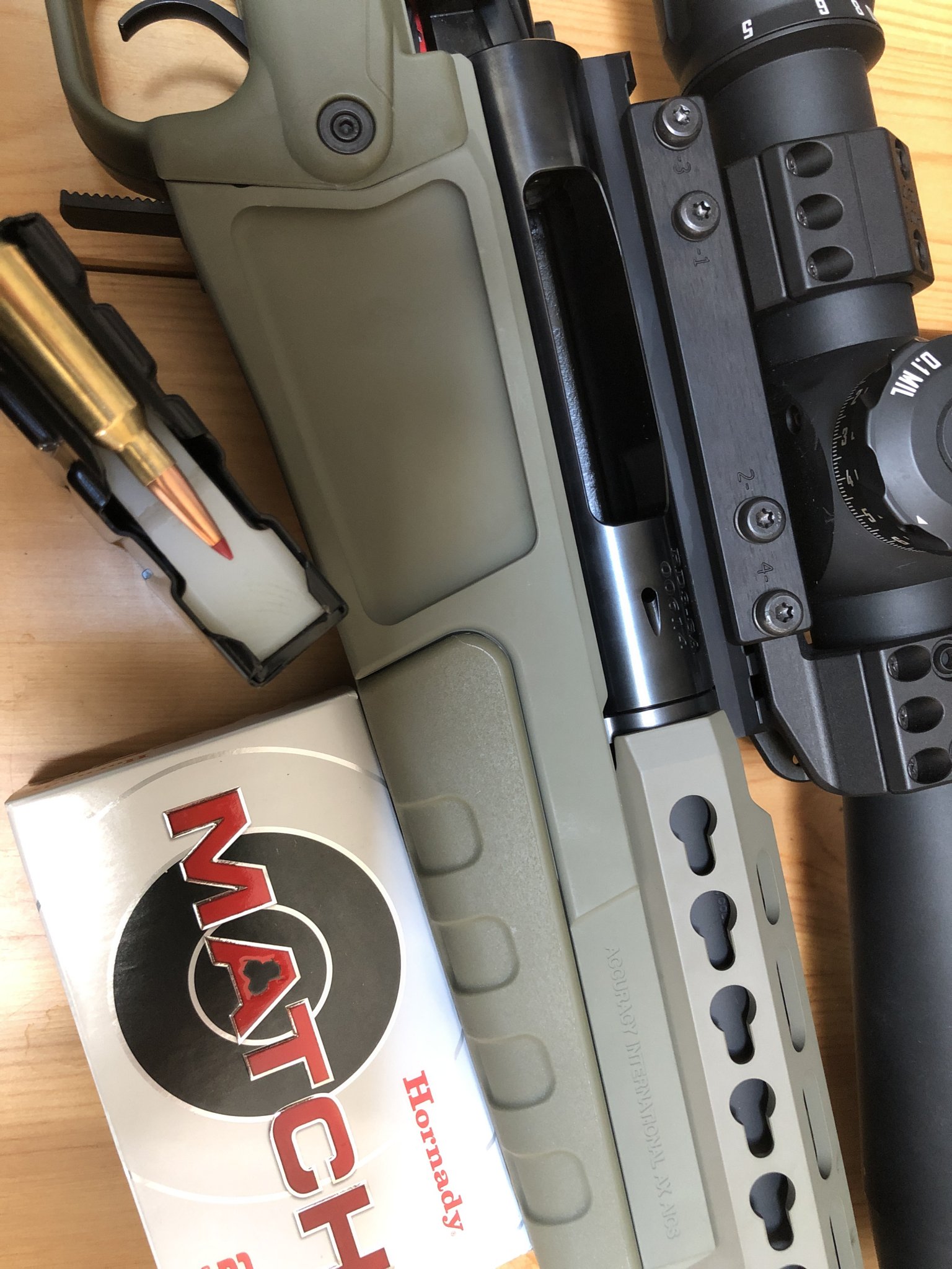

Bighorn Origin, with Bartlein LH GT Barrel finished at 24" dropped it in an AX chassis.
Will be interesting to see what kind of velocity you get with that factory ammo.
224V/88 ELD on the right loaded with the boattail/bearing surface junction just below the bottom of the neck for .110 freebore reamer getting 2800 out of a 26" 7 twist button barrel in an Origin as well.

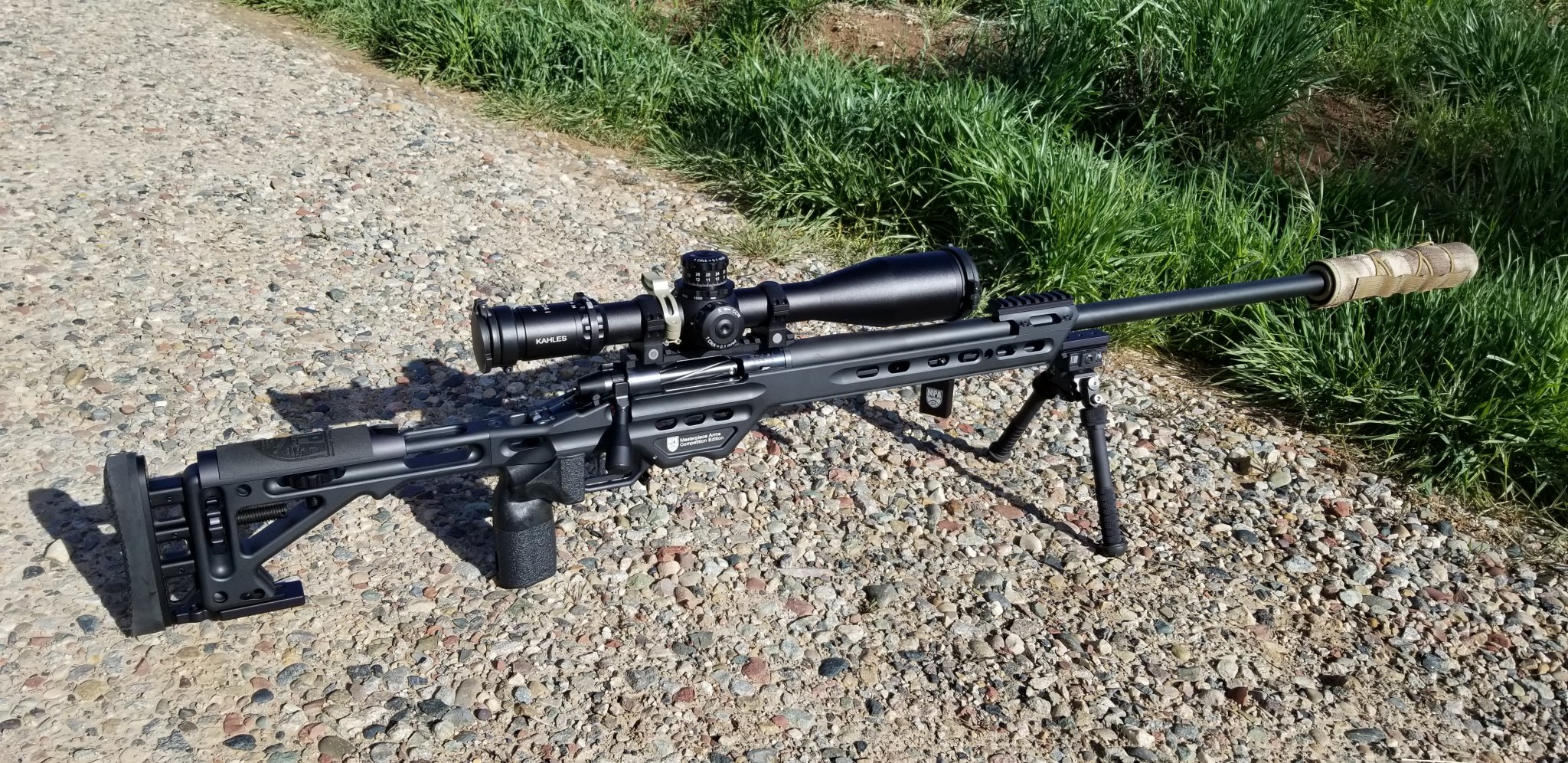

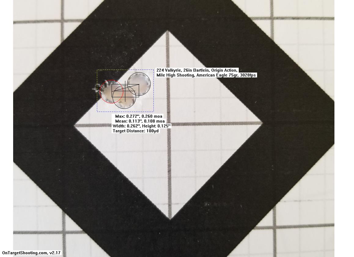

Mile High finished mine up a couple weeks ago. Almost the same as Frank's. Origin, 26" Bartlein LH GT, Triggertech Diamond flat trigger, MPA Comp Chassis. Waiting on dies, so I just picked up some cheap American Eagle 75gr and was very pleasantly supprised.

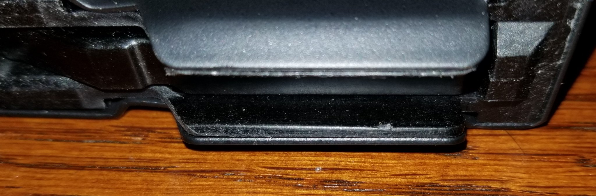

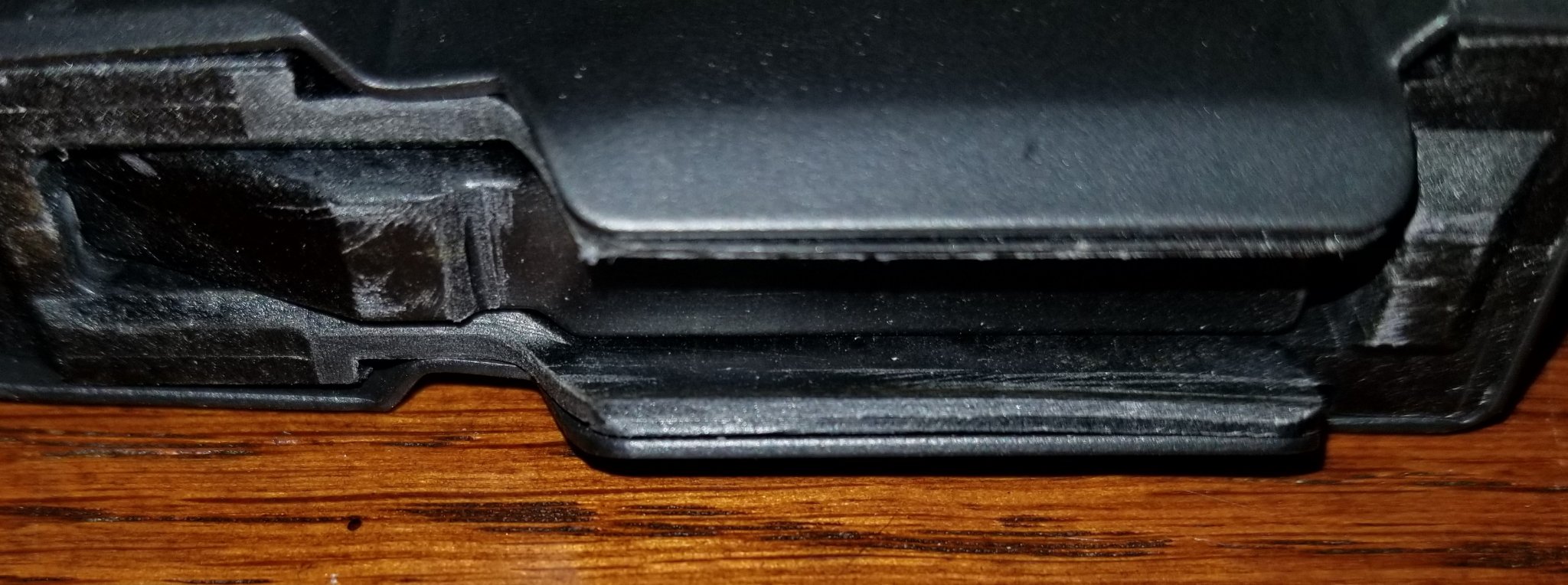

I used 223 Accurate Mags. I can only get 9 rounds in them, but they work great. My pictures aren't the best, but all I did was sand the plastic feed lips.
Before
7074833
After
7074834
