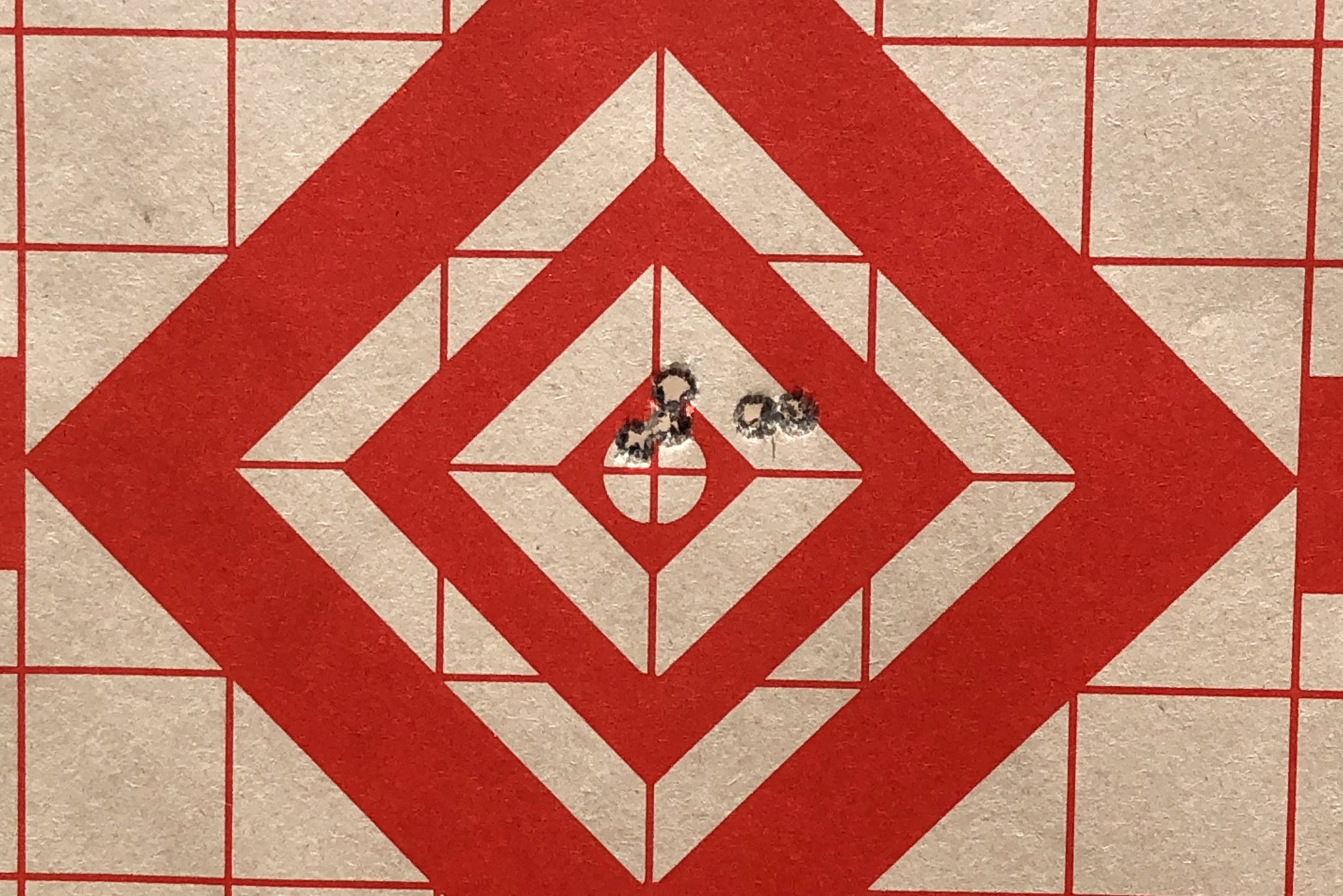

It seems no one has started a thread with this chambering yet, so I guess I will.
My barrel is a 24" heavy barrel with 1:7" twist and Rifle+2" gas system length, with a matched bolt head.
* Norma 6.5 Grendel brass, necked down in stages using Redding bushing die with a .249" final bushing .
* Sellier & Bellot small rifle primer
* Hornady 88gr ELD-Match seated to 2.26" COAL
* 29.1 gr Reloader 16
* 2825 fps
* single digit SD (need to verify)
I'll verify my E.S. and S.D. and chrono'd velocity over the holiday or next weekend, maybe even true it from 800y dope if I can get enough loaded and some cooperative weather.
I've been fiddling with QuickLOAD and I believe this load is just a hair over the 50,000 psi that Bill Alexander recommends for 6.5 Grendel (52,000 psi SAAMI max), so it should be a safe load that won't grenade the bolt head.
Best group so far is below. The barrel only has 57 rounds through it so far, so hopefully it picks up a bit of speed and settles into some nice tight groups.

Barrel has sped up a bit. 29.0gr load is now going 2835-2840. Accuracy is probably sufficient but I wish I could tune the groups a bit tighter. I may try some different bullets and powders soon.
