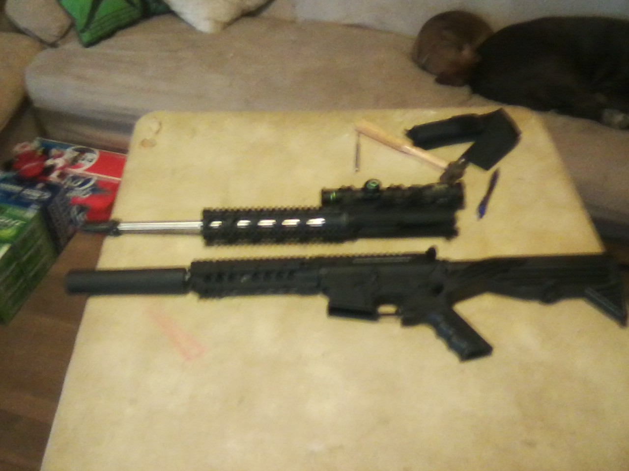

I think you may be happier with a 300blk build for reliable fun.
My 10.5 " upper will shoot subs, supers, suppressed or not without malfunction.
I did stamp a standard lower for it no mods necessary.
