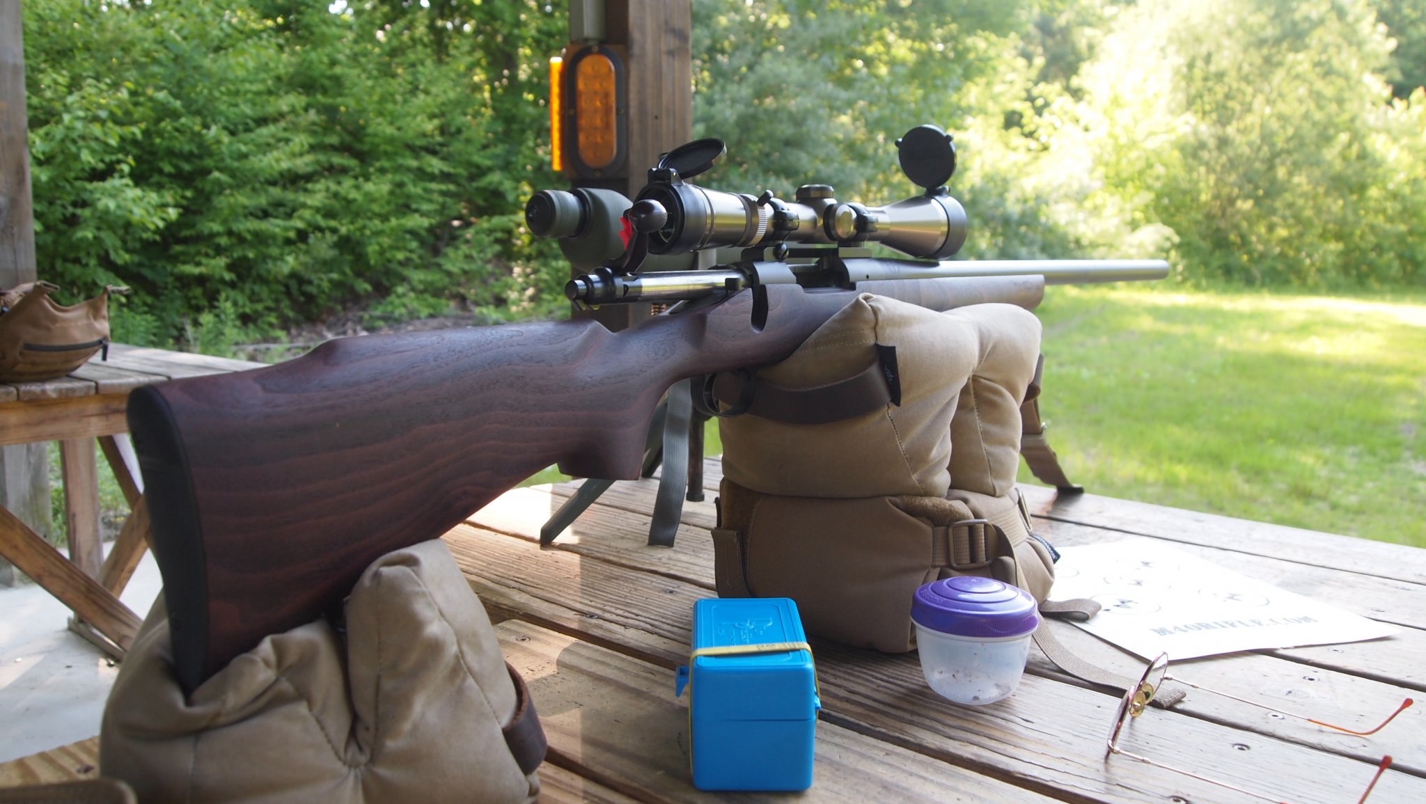

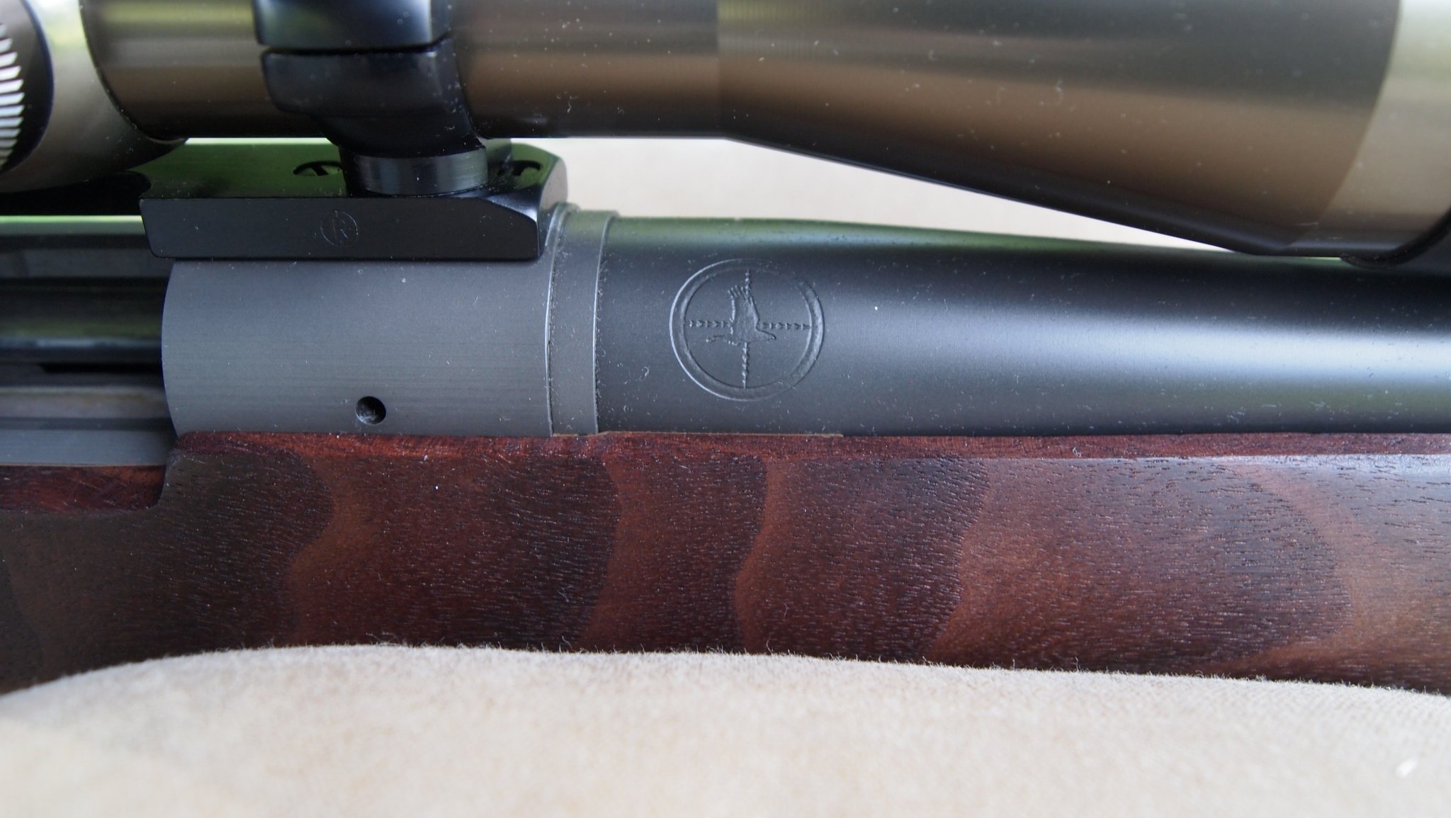

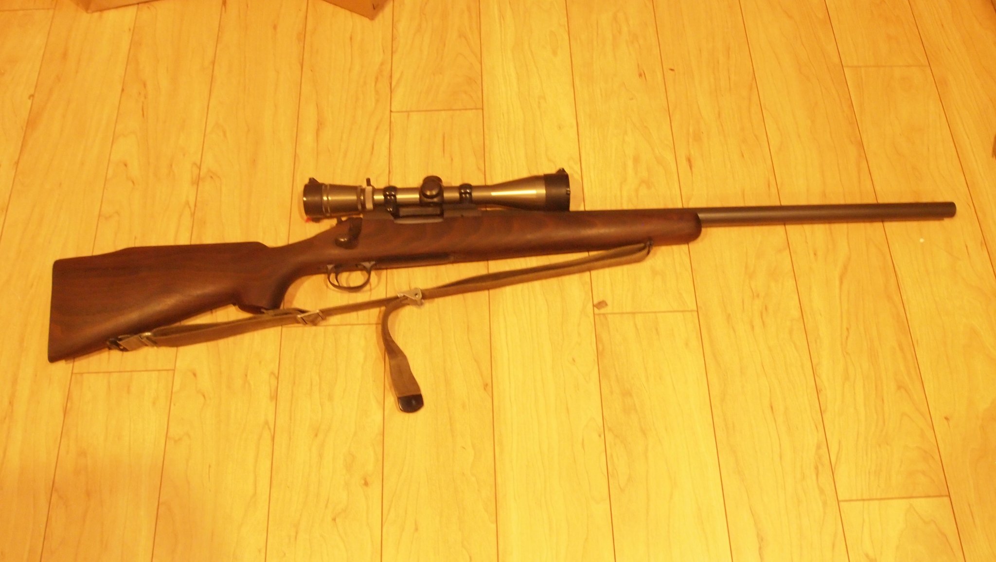

.308 receiver I picked up here. Really clean have the .308 bolt stashed as a spare.
Picked up the old school .223 bolt here.
Barrel is a Bartlein. Think I went 1:7.7 left the chamber up to the builder - Raven Rifles.
Stock is an @deptaylor production. Good guy hasn't been around much.

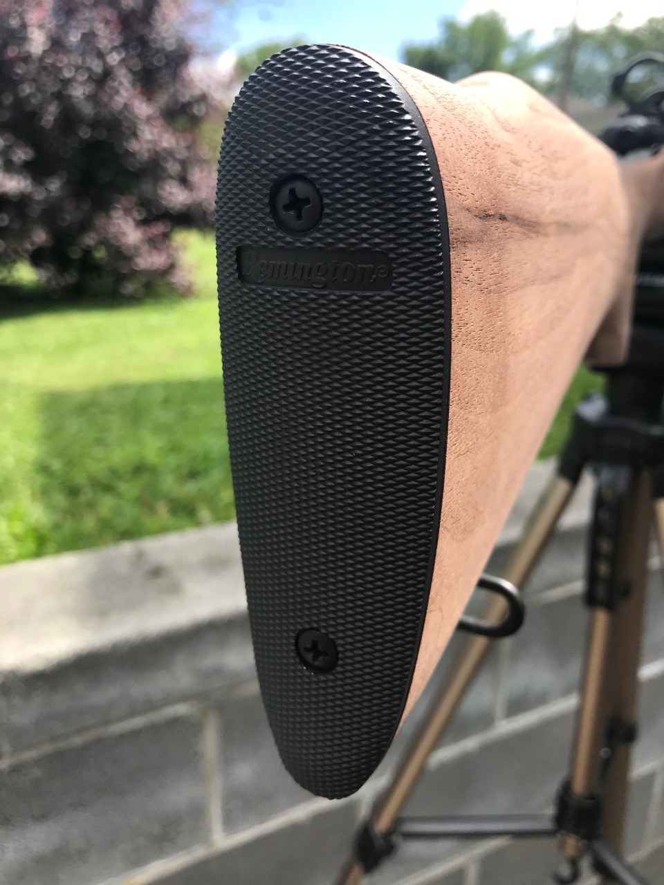

@deptaylor also provided the buttplate and old school sling swivels
BDL metal is off a 1968 rifle I had made into my M40A1ish.
Scope base is one @USMCSGT0331 provided to me.
Scope will be a green Leupold M40 3-9X replica with mil dot reticle.
Trigger is an old Remington tombstone variety.

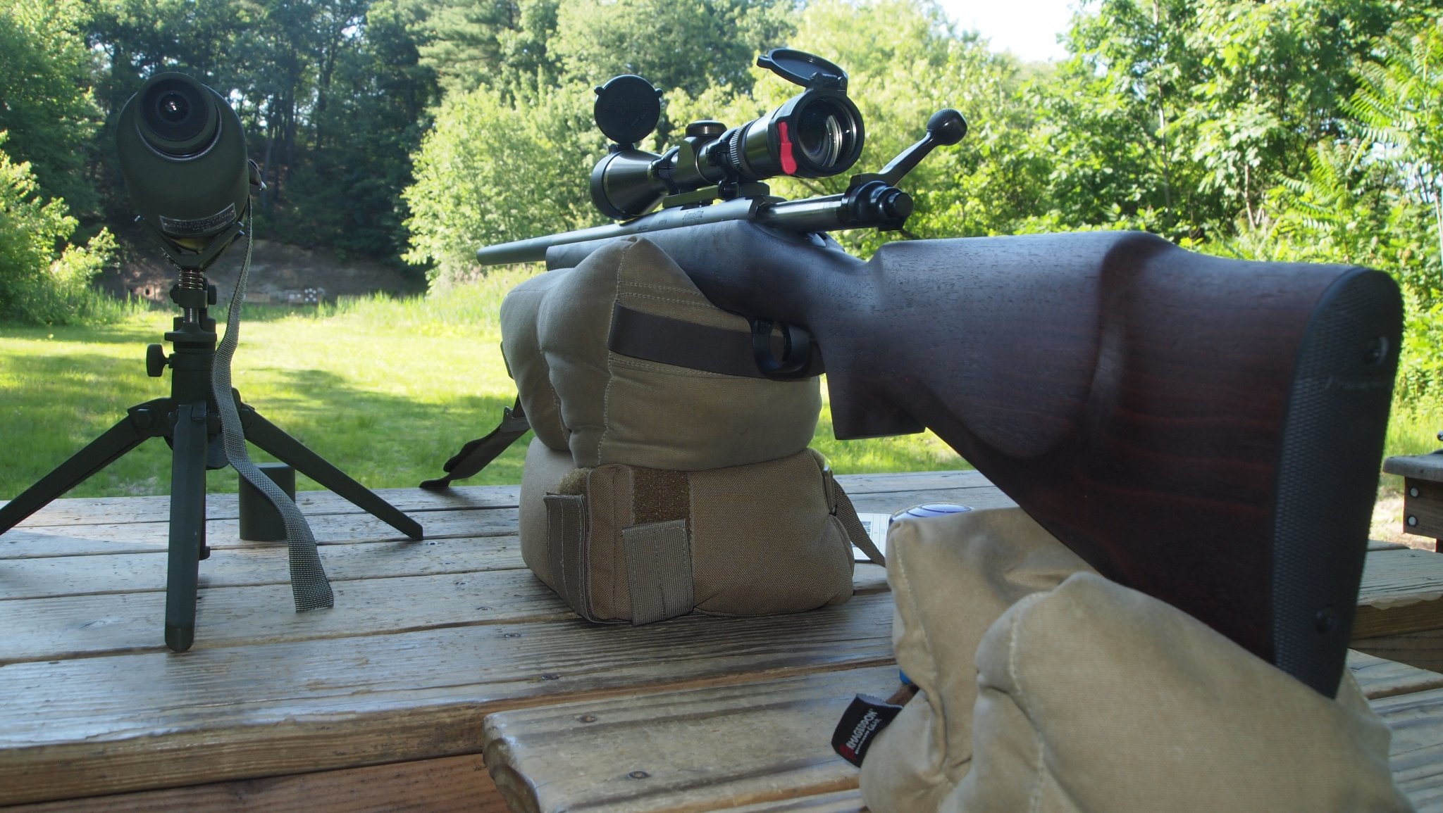

Your method is solid but Im going with time and friction.
Got 6 coats on as of this AM.
The oil Im using is burrowing deep into the wood, the stock is like a sponge drinking it up.
Im getting three coats a day right now because the wood is drying it right up.
Ill be hitting it to the point the oil starts to stay on the surface than I cut the amount applied a little bit and keep trying to light that thing on fire through hand friction.
Nothing finer than an oil finished stock, looks great, easy to maintain.

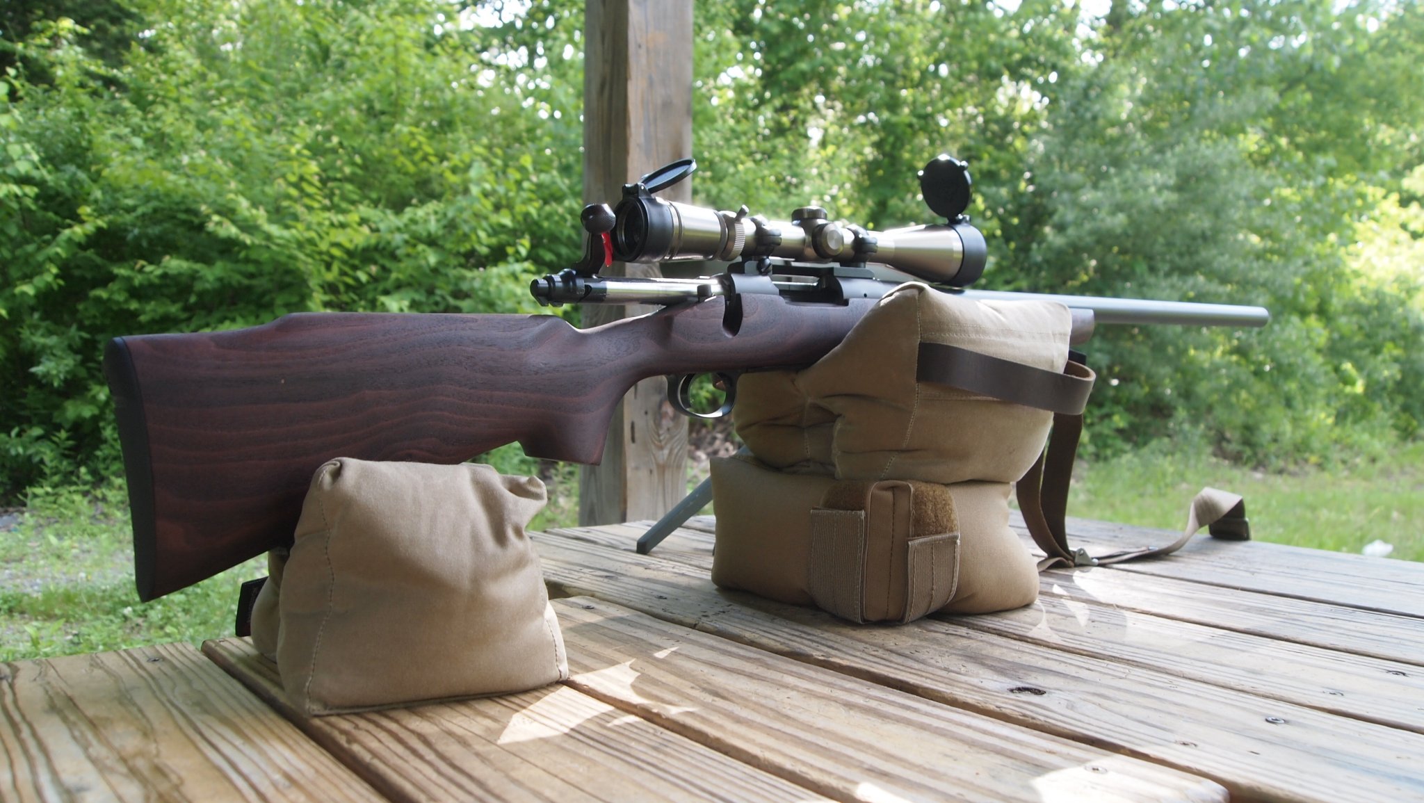

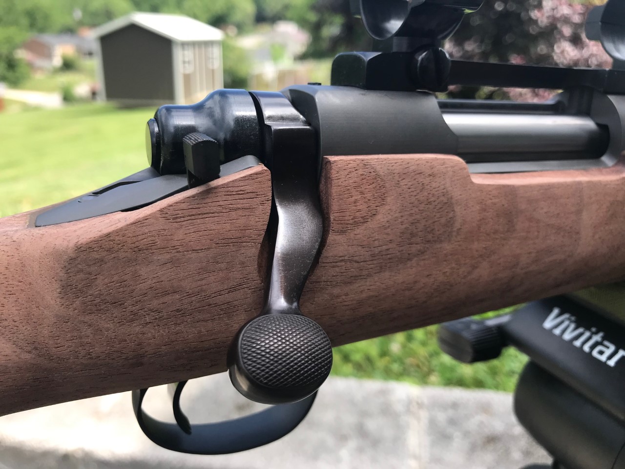

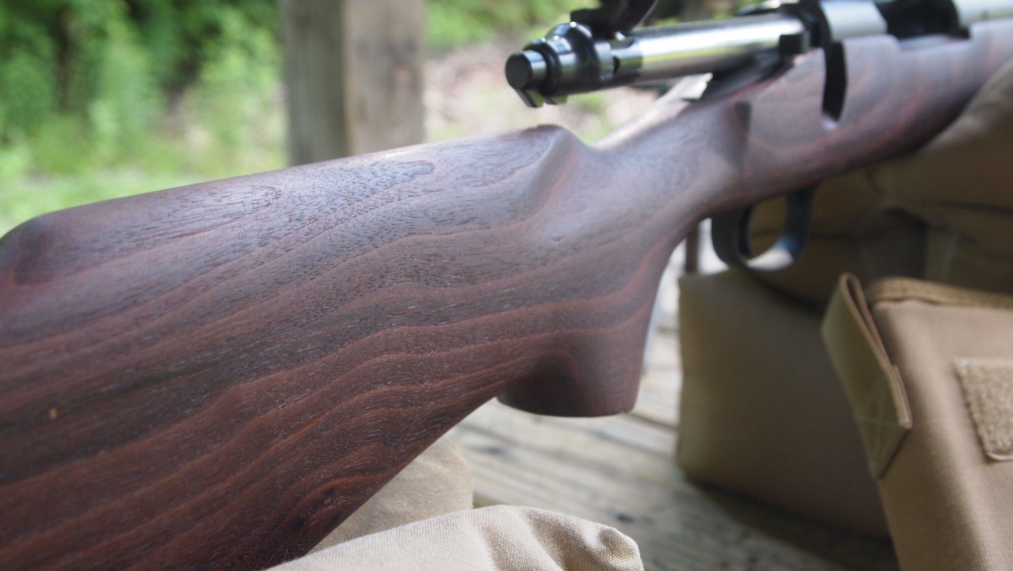

That stock looks like it has some really nice figure in it. Cant wait to see it finished.
Its looking kind of dark right now.
Kind of looks like one of those old school burl wood pipe bowls but you have to get up to it to see it.
It will be another week or so.
The park job on the metal is dynamite.
If I could only unlock the secret to making it "green" like old WWII milsurps.
I think the only answer is cosmoline, blood, sweat, tears, coal tar based cleaning products and time to get that patina.

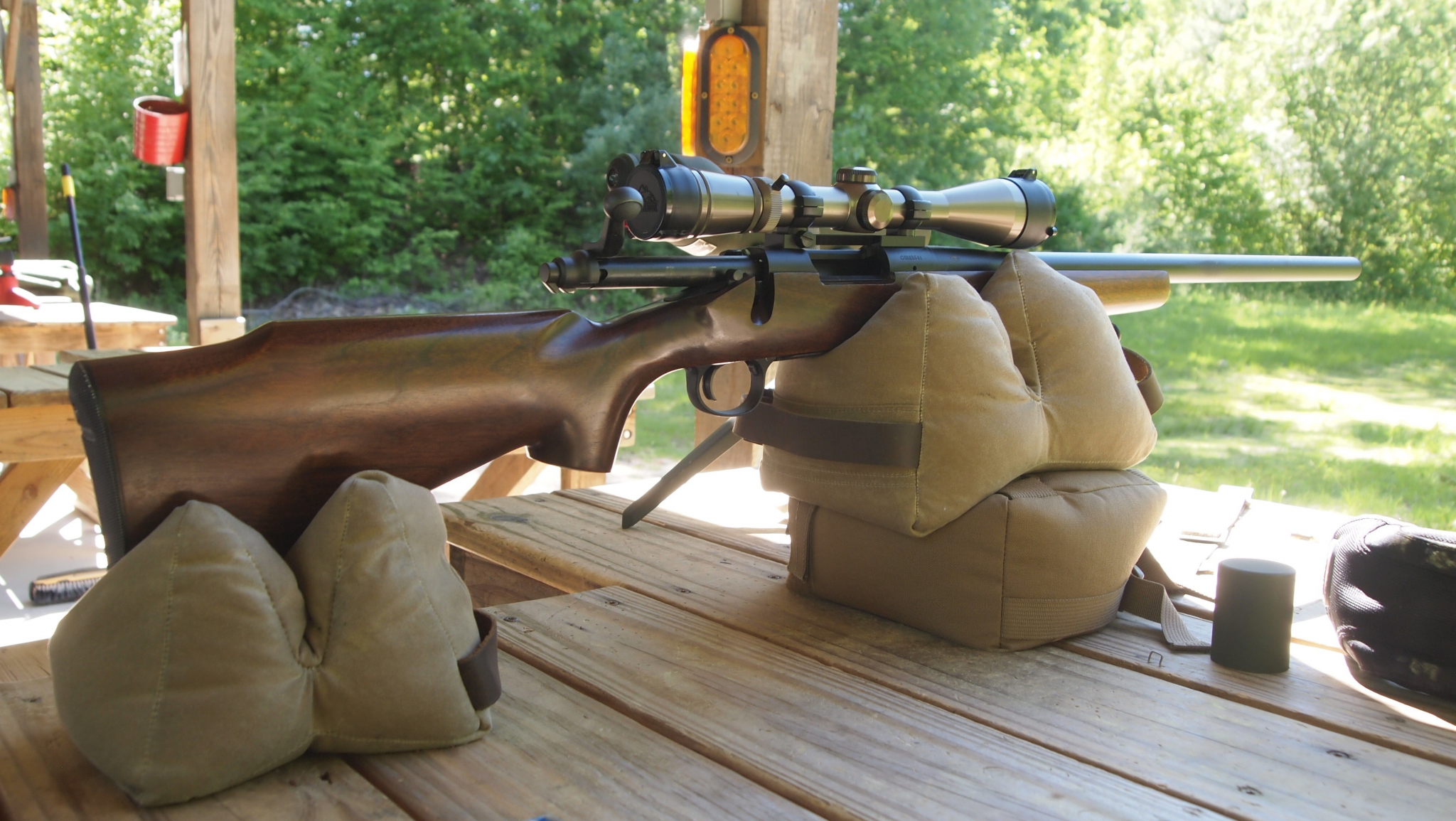

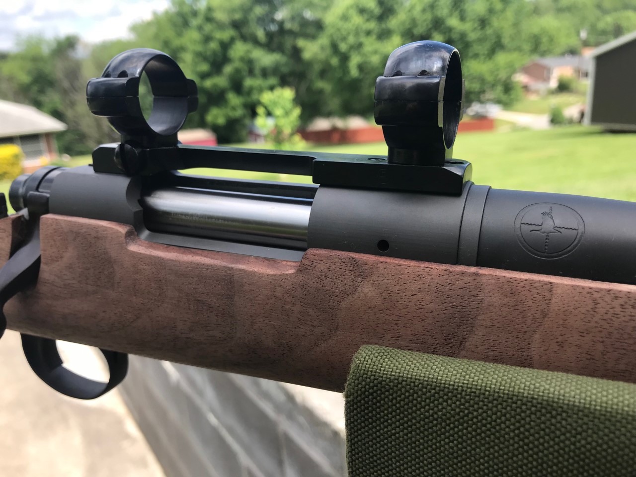

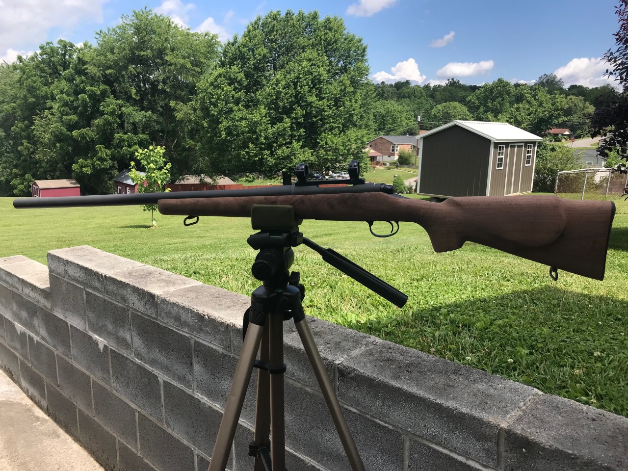

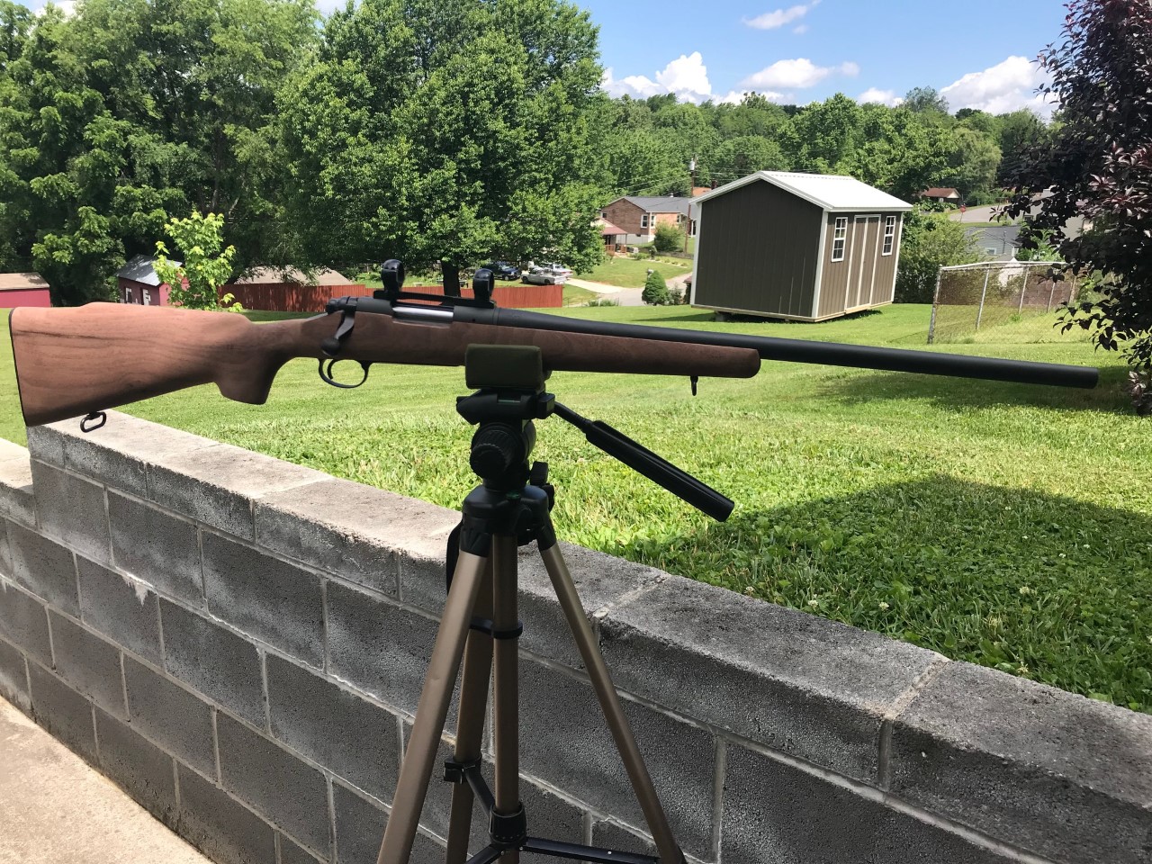

Got it all together today.
Anticipating shooting it Saturday which almost guarantees I get an over time or something and cant shoot it.

I have a glossy one in .308 win. The finish on this one is Pure Tung Oil....
7097904
The new one is a cold pressed raw linseed oil. Its a more GI finish. Im hoping it will turn "red" with some sun and useage.
EDIT - Sorry forgot I included pics of the .308 already in this thread but who doesnt like gratutitous M40 pictures?

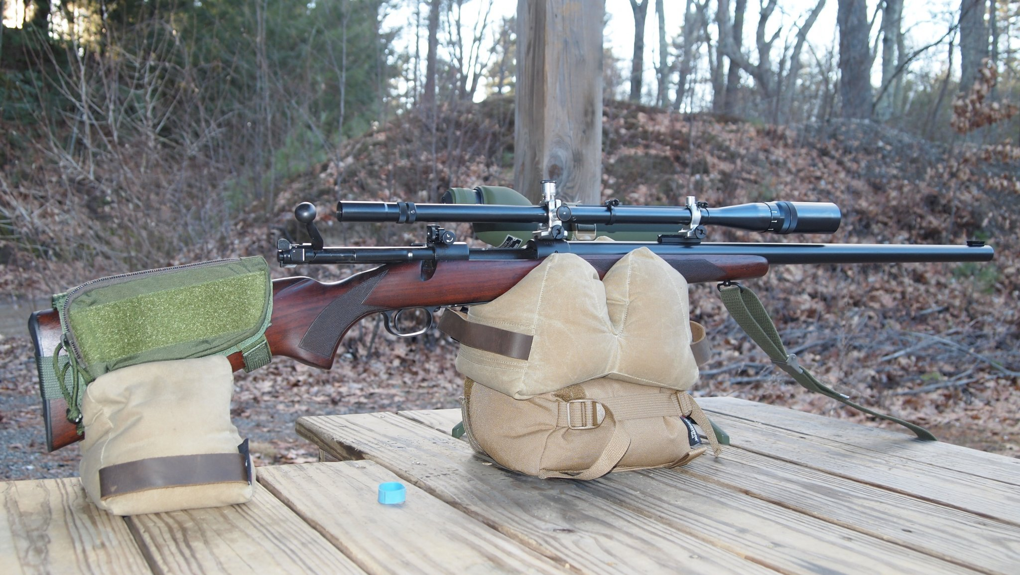

Im hoping it turns the color/sheen of my Model 70/Unertl pictured above.
Only reason I bought that rifle and spent the money rebuilding it was I fell in love with the color of the stock at Cabelas

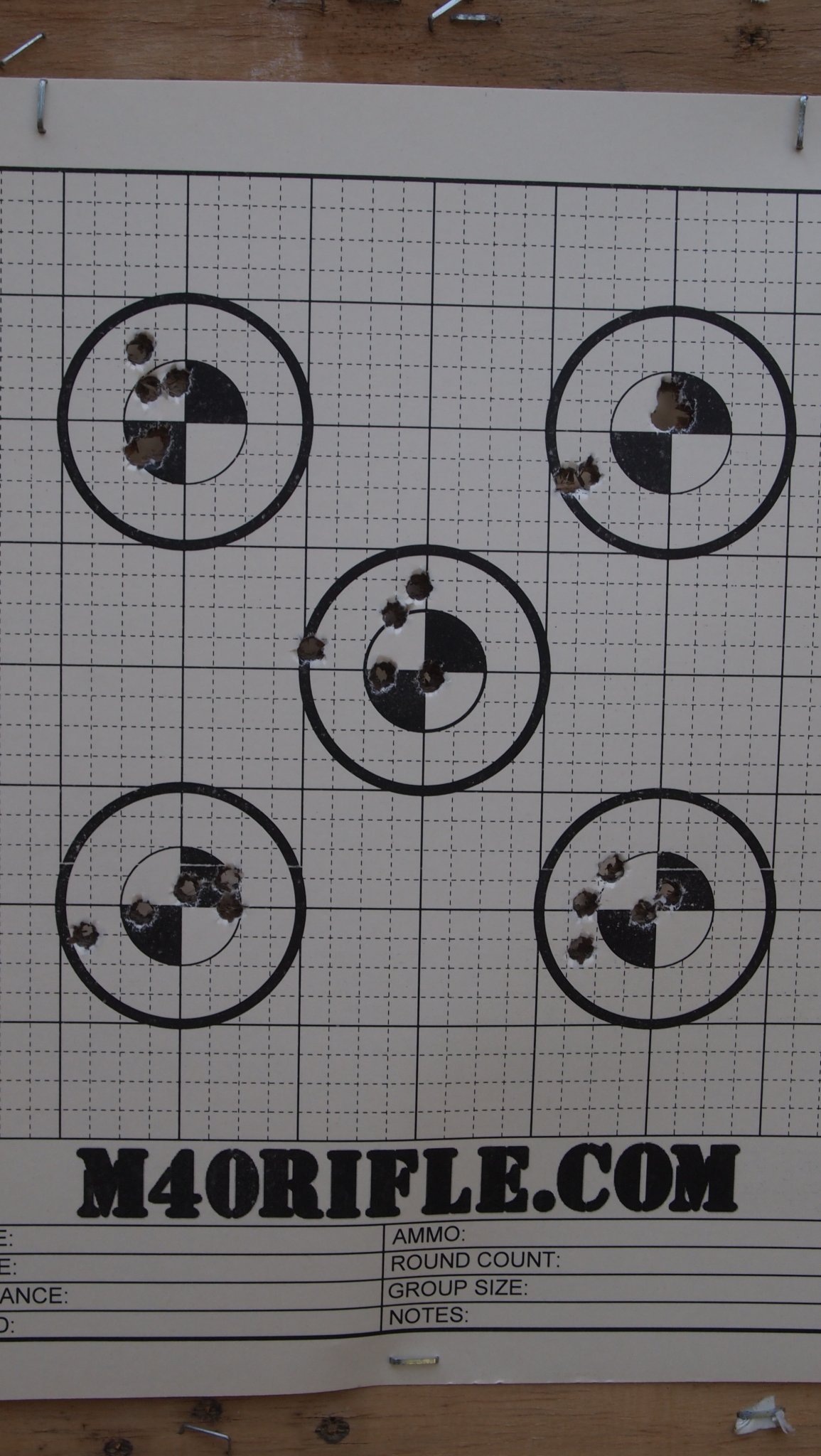

Is your rifle bedded? I was thinking those groups might shrink up if the rifle was bedded, and or pillered.
Just a thought.
It's fully bedded.
Those groups will shrink up just fine if I shoot a load tailored for it not my 16 inch carbine which is what that ammo was made for.
I think it's a little anemic at 22.9 of 8208XBR, and let's not forget the barrel has all of 50 rounds or so through it. It will be a different gun at 200 rounds.

It's fully bedded.
What bullet weight?

Most times I see people list there 8208XBR loads they are running 23.3 +/-.
Its a great powder for running in a Dillon.
Thinking of switching my .308 over to 8208 from 4064 next go round.
Tired of tiny logs of 4064 falling over my loading bench.
The tiny short cuts of 8208XBR dont get hung up in the drop.

Unless you are running a .223 Wylde, 5.56 Nato chamber or have significant erosion, 23.2 gr. is the max for a 77 gr. bullet in a straight up .223 Rem.
I'm not saying more powder can't be used, but you definitely have to work up to it in each individual rifle.
PMC,
It's only been in the last couple years that I've seen 4064 with Enduron technology. Which is pretty much how Hodgdon (who now owns IMR) makes all the "Extreme" powders. They have better applications of burn retardant, that allows you to run at max with less chance of overpressuring due to heat, i.e. outside air and long strings of fire. It's not intended to run over their numbers. But, there isn't really good guidelines as to where/when to stop with a good thing. Knowing the "why" in each case of each rifle would help. If you can get the "new" 4064, you'll find it meters as well as anything. The old stuff as you said, is like mini-logs.

I just hand finished.
Probably could have made it look "prettier" adding some stock finishers pumice or some very high grit sand paper but I was going for GI finish on the .223.
It will finish itself with use and additional oil.
My .308 I used tung oil and got a real deep shine finish.
