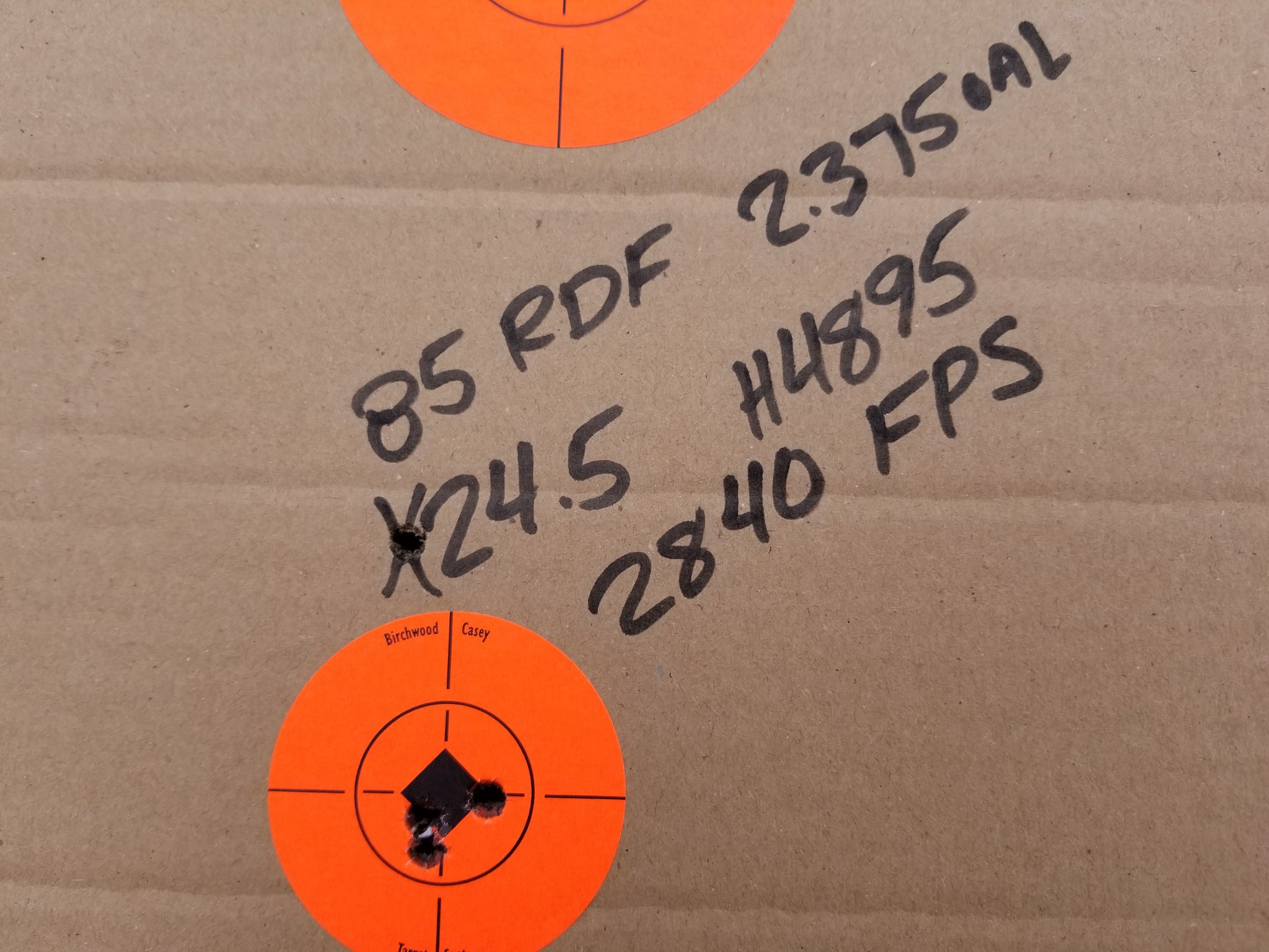

Rumblingdwarf
Aug 19, 2018
68
54
24
RPR 7 twist 20 inch barrel
85 Nosler RDF
2.375 oal (.015 off)
Cci 450
24.5 gr H4895
2840 fps
Solid 1/2 moa load. Also took it to 996 yards today. BC seems higher than published.
.250 G7 lined up for me. Velocity measured with a LabRadar.
