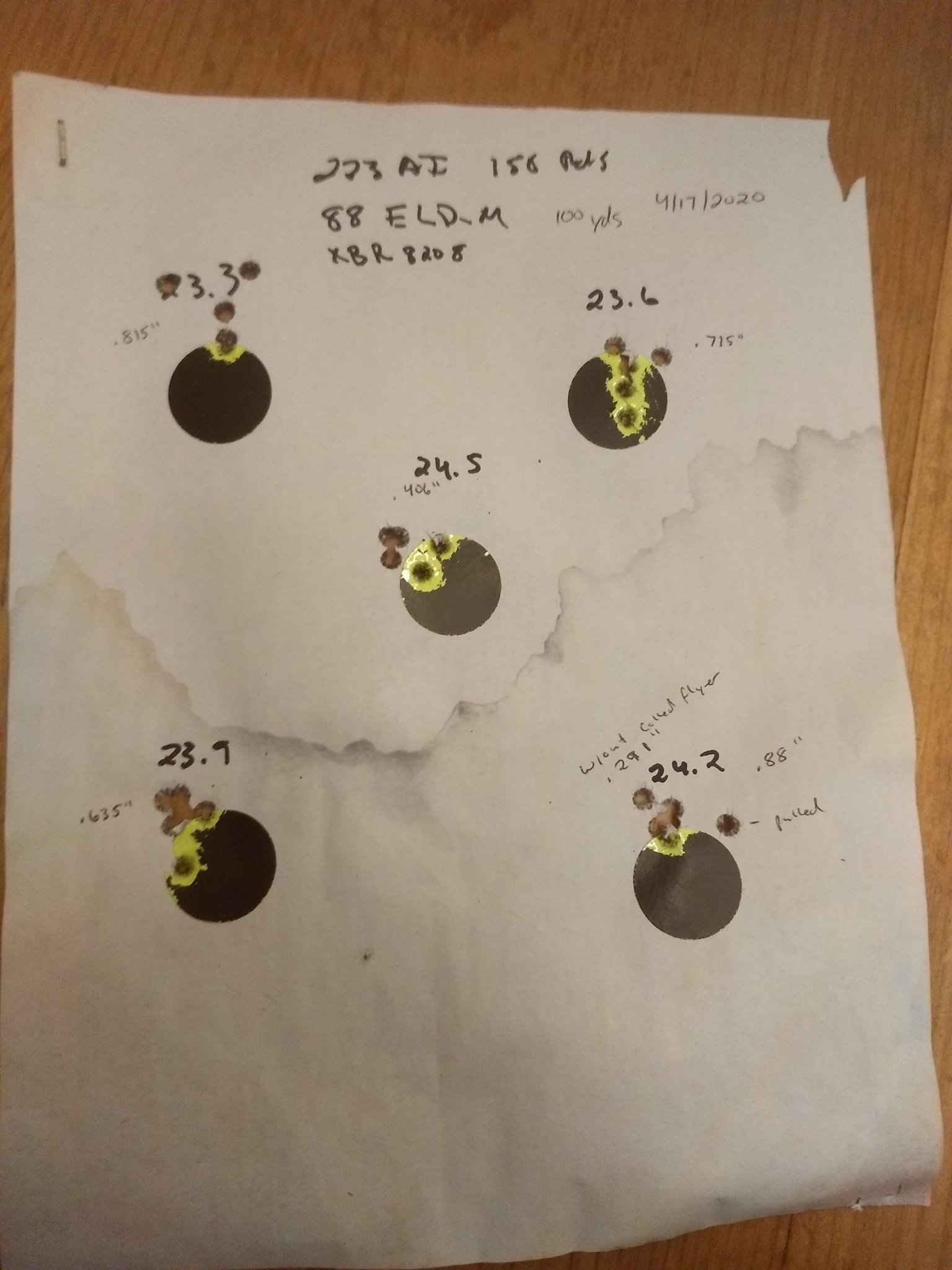

So anybody out there running 88 eld-m's in their 223 AI? Currently running a .223 Wylde with 88 eld with a charge weight of 24.4 grs of Varget. Running 2833 fps.
