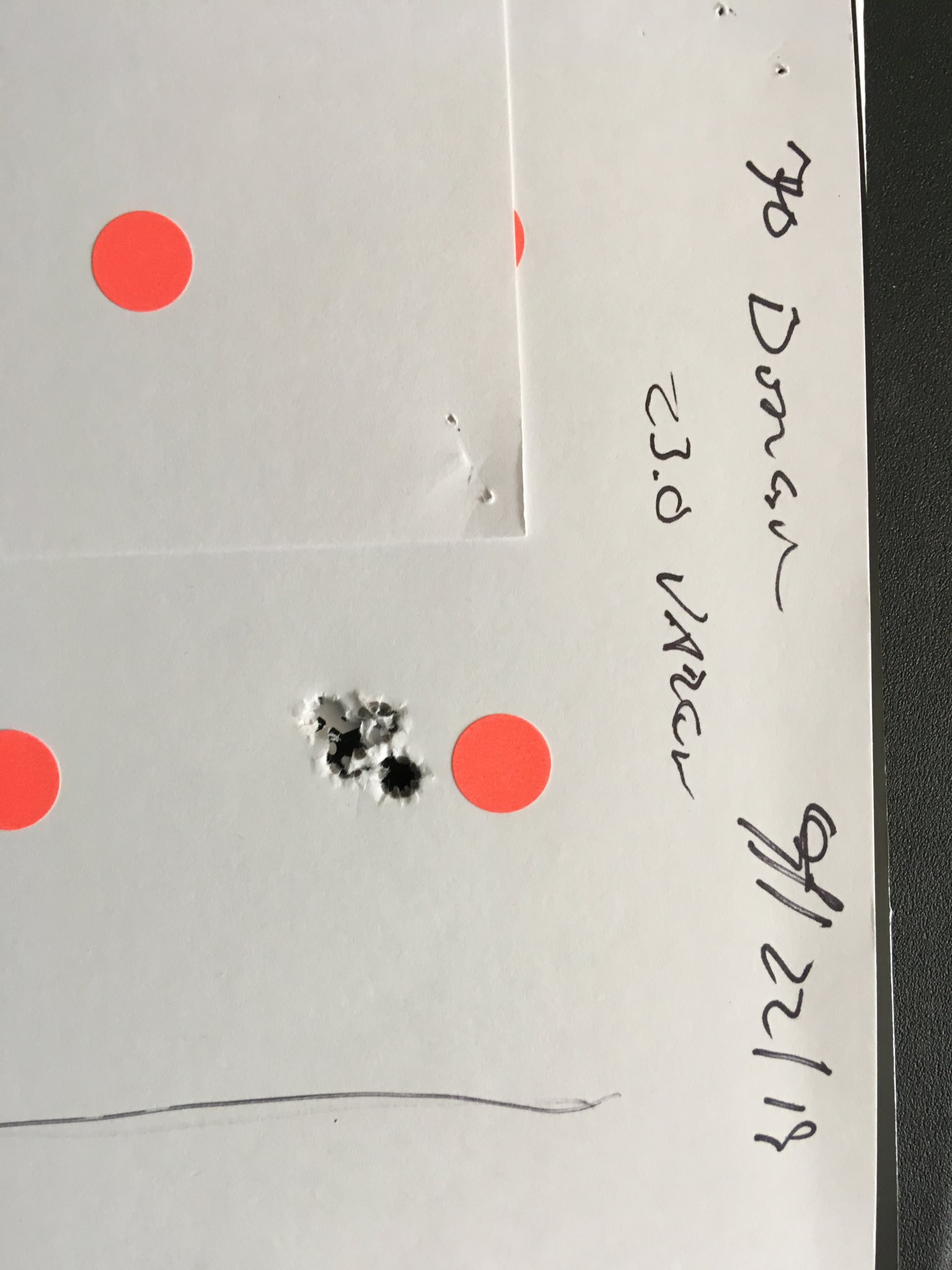

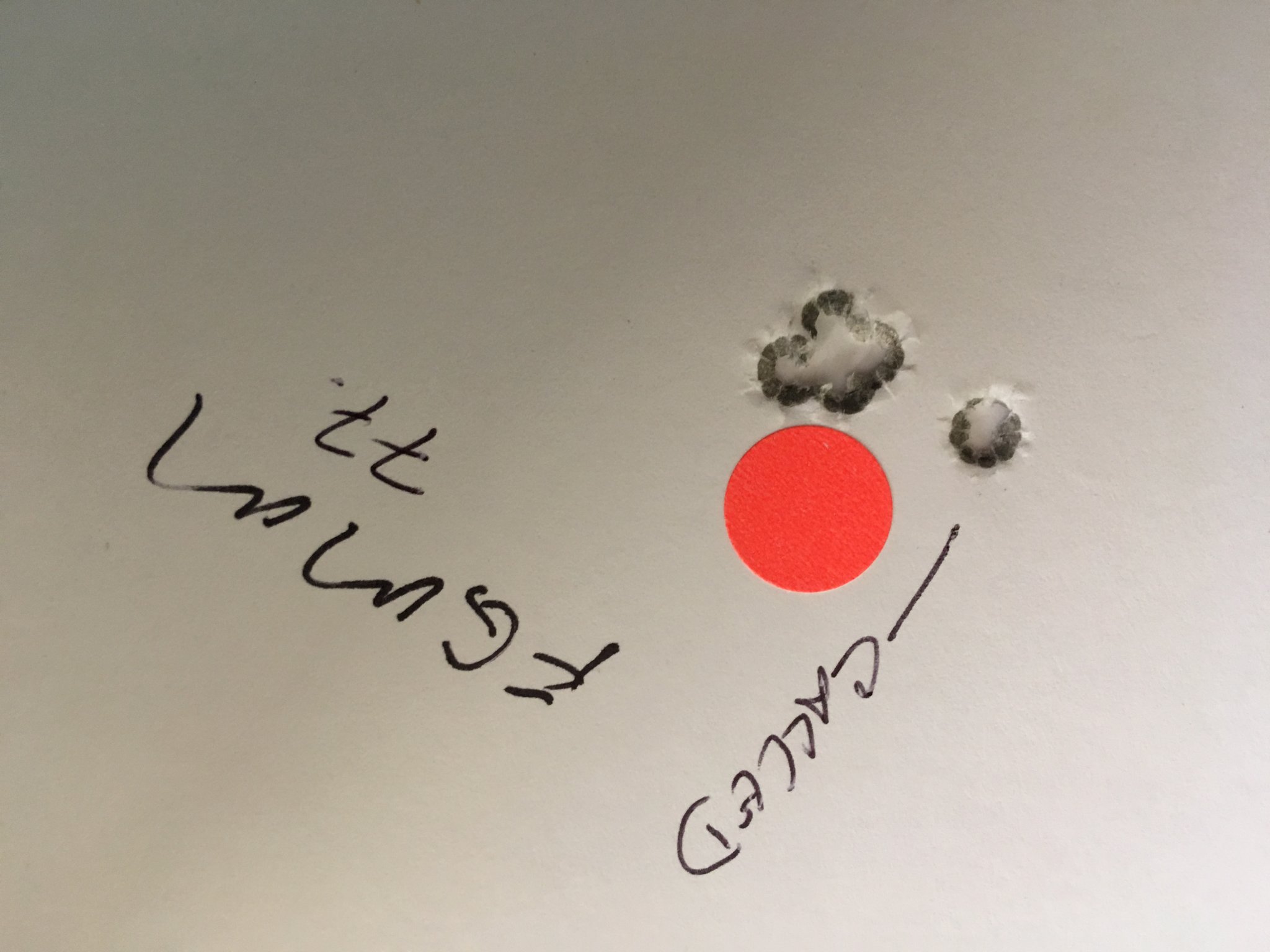

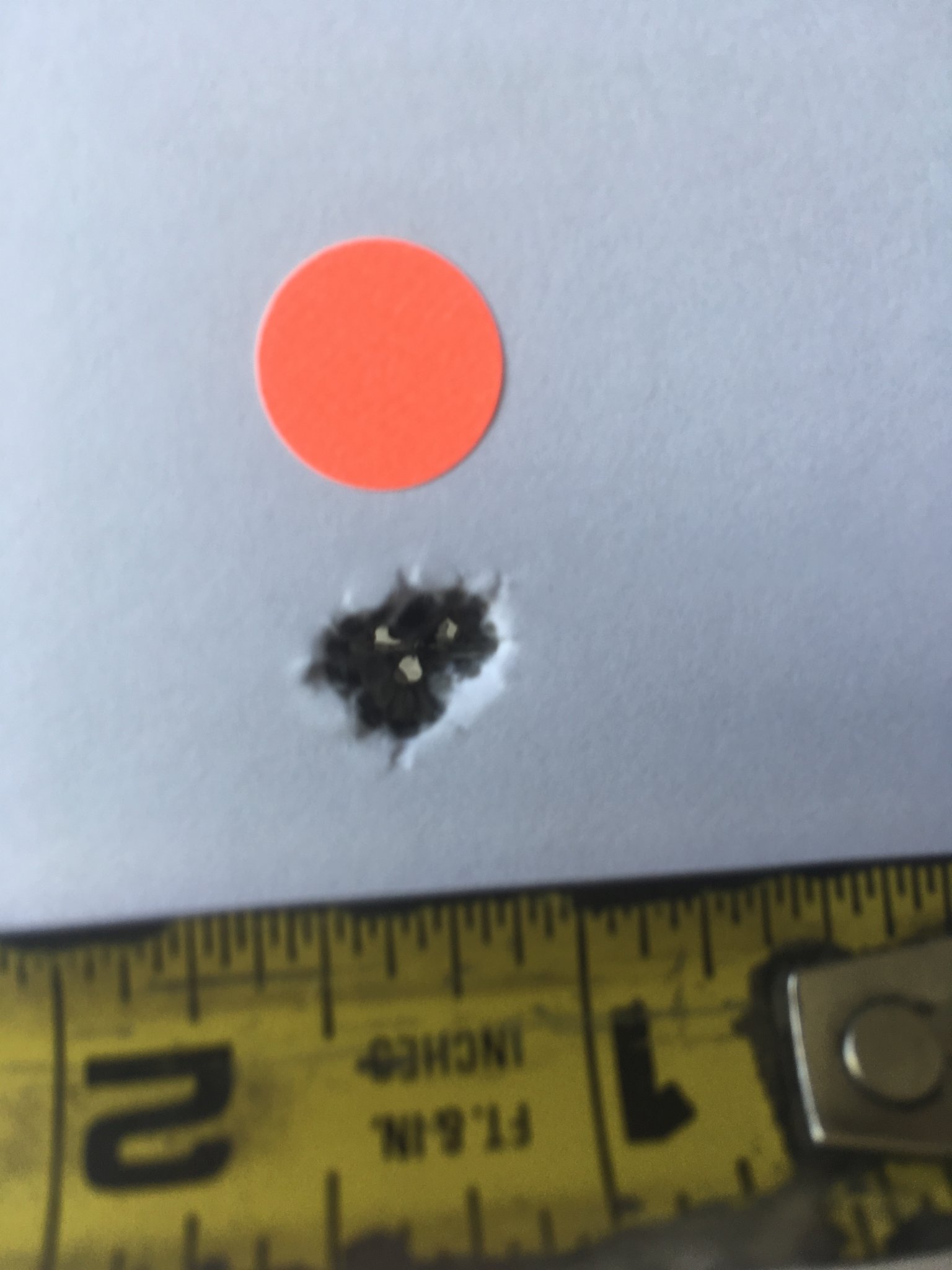

I have been having pretty damn good results with 25.5gr of 8208 using the 52gr Berger FB Target bullets. What charge weight are you suggesting for 77gr pills (TMK or SMK) ?
Pretty well known node for 75/77gr pills between 23.2 - 23.8. Most people find their node at 23.6. Load charges from 23.2g in 0.2g increments up to 24.

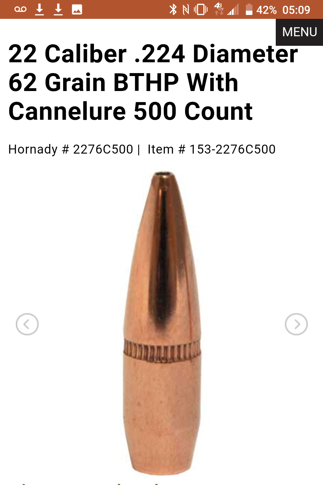

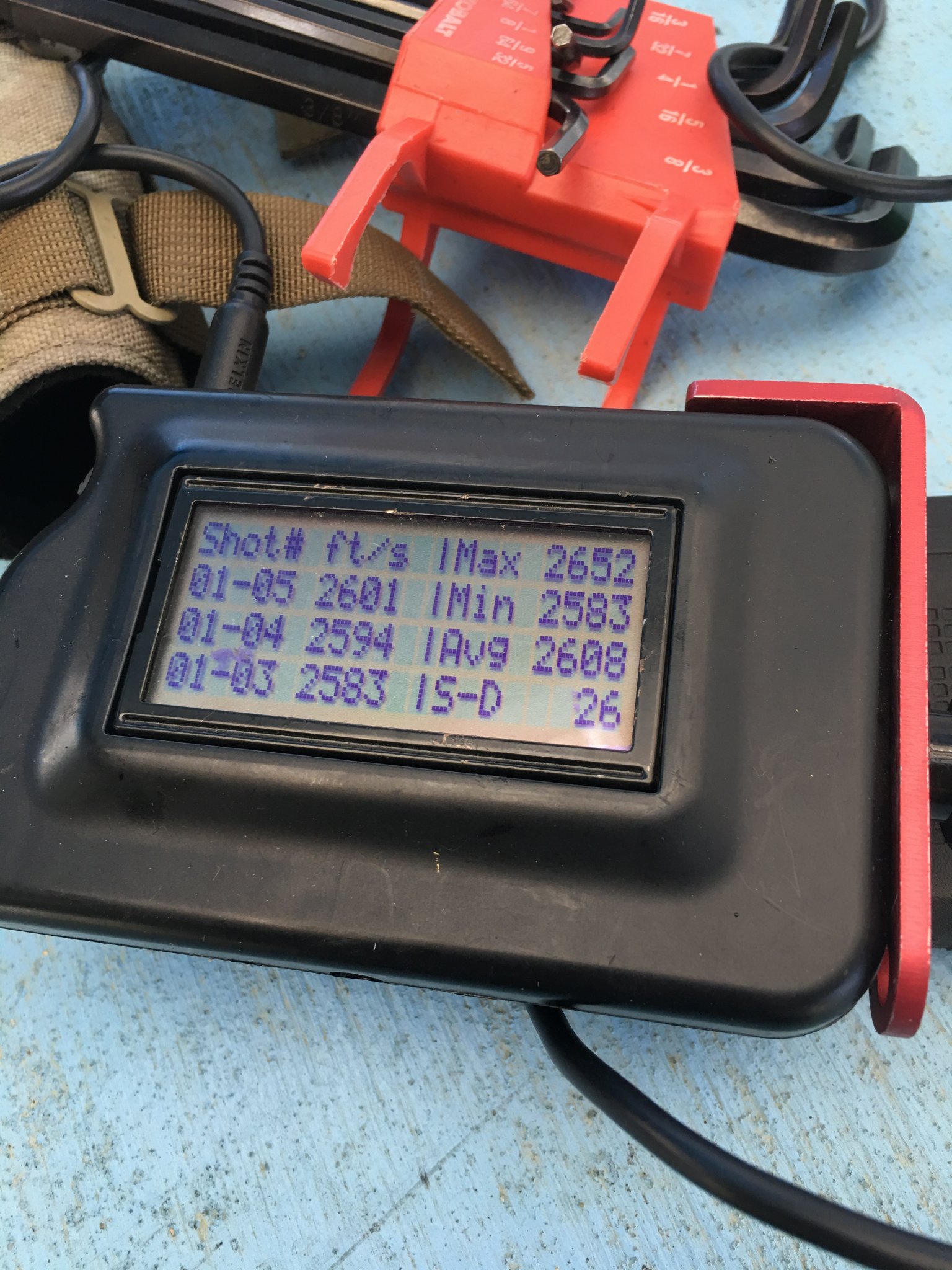

Anyone loading the 62gr hornaday cannure hpbt with h335 and if so what kind of results you getting ?
I'm loading them at
23.9 of H335
coal of 2.235
2680 fps
lc brass and cheap norinco brass
1x7 twist
AR-15 Ballistic advantage 16 premium barrel
I might step up to a 77 hpbt sierra match king later but got alot of these right now and looking for some options.

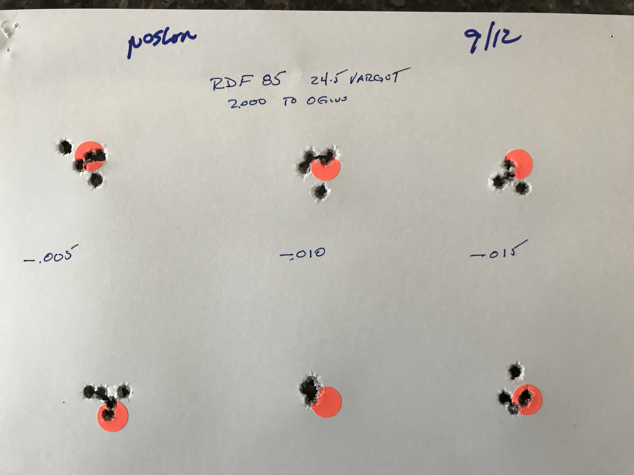

Where did you get that target at?

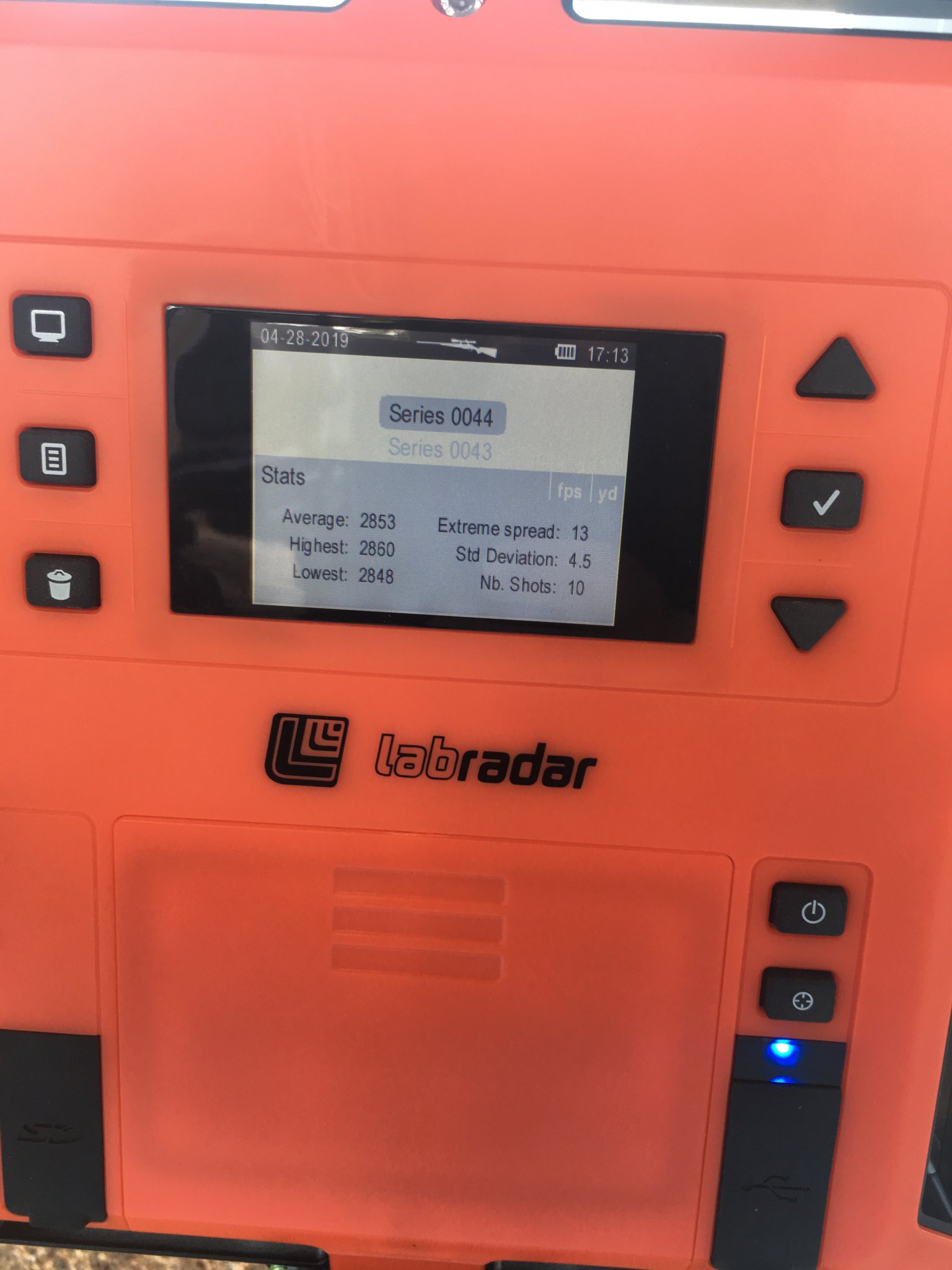

Rifle is a trued Remington 700 with a 24 inch Kreiger barrel chambered by Andy at the Firm.
70
Lapua Brass
Federal 205M Primer
Berger 70 VLD
Varget 24 grains
Seated .020 of Lands
Velocity 2912
SD 8
77
Lapua Brass
Federal 205M Primer
Berger 77 OTM Tactical
Varget 24 grains
Coal 2.260
Velocity 2738
SD 15
J.Boney
Resident Sheepdog
Belligerents
May 10, 2006
530
136
49
48
NC - USA
77 SMK
Winchester Brass
Rem 7.5 primer
24.1 gns Reloader 15
2.300 COAL
2780 FPS out of trued Rem 700 w/ 22” Krieger Hvy Palma 1-7.7 twist

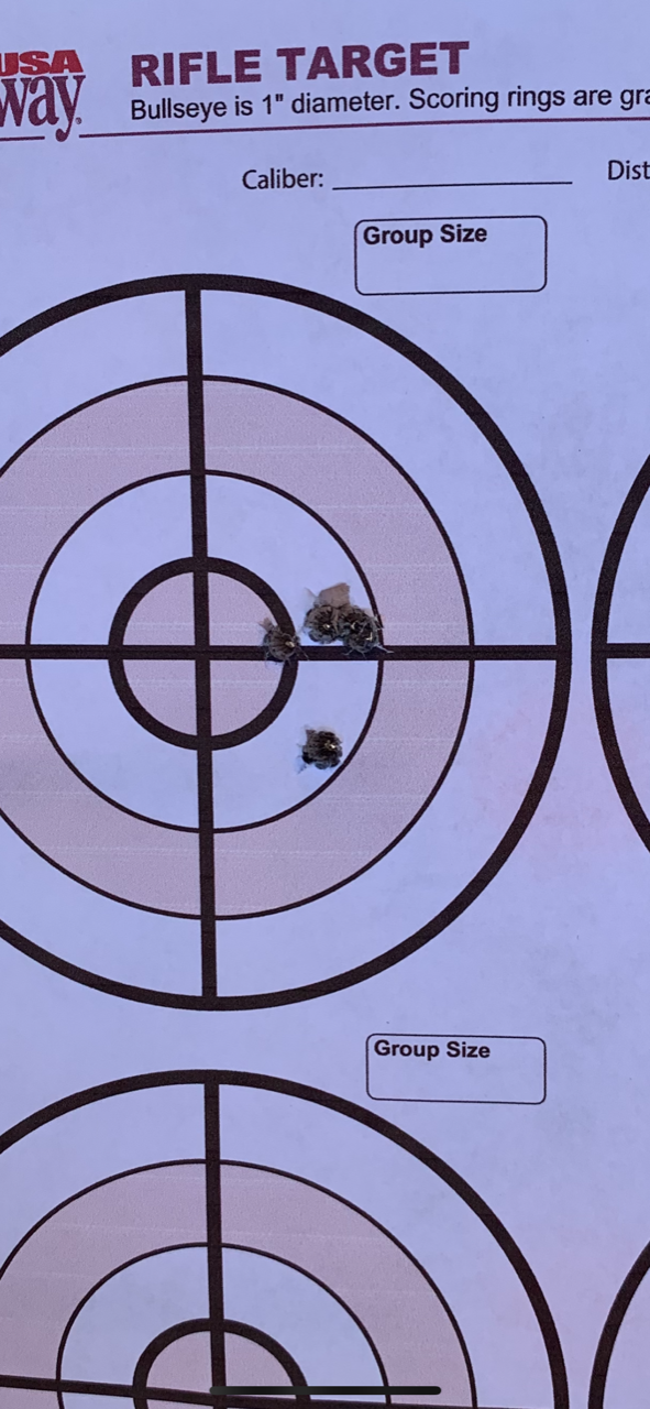

21Bravo
Belligerents
Oct 17, 2008
192
7
22
45
Jackson, MO
Hornady 75 grain ELD-M, 25.5 grains of Varget, virgin Lapua brass, Federal 205M, 1.975 measure to ogive with Hornady comparator. This comes out to be 0.020 jump. Velocity average 3045. TL3 with 26" 1-8 twist Criterion barrel with suppressor. No significant pressure signs. DA -300 puts it at 5.9 mils to 840 yards (longest on my range) with 0.14 mil drift per 1 mph full value.
Lapua brass (Virgin)
75 ELD-M
25.5 Varget
Fed 205M

SPS Tactical 1:9
Lapua brass
53 grain VMAX
26.0 Benchmark
CCI 400
COAL 2.275"
3250 FPS 20" Barrel with 7" silencer
5 shots into 1 hole with single digit SD
