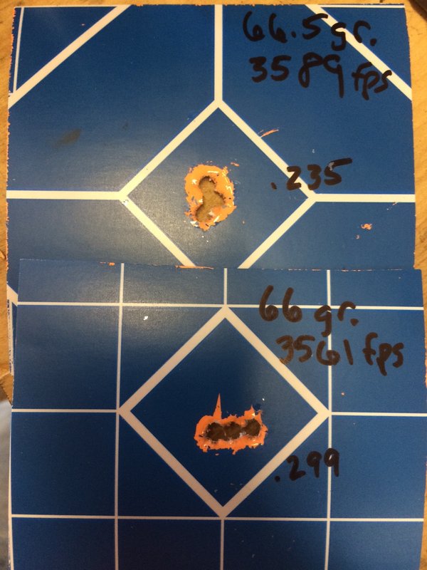

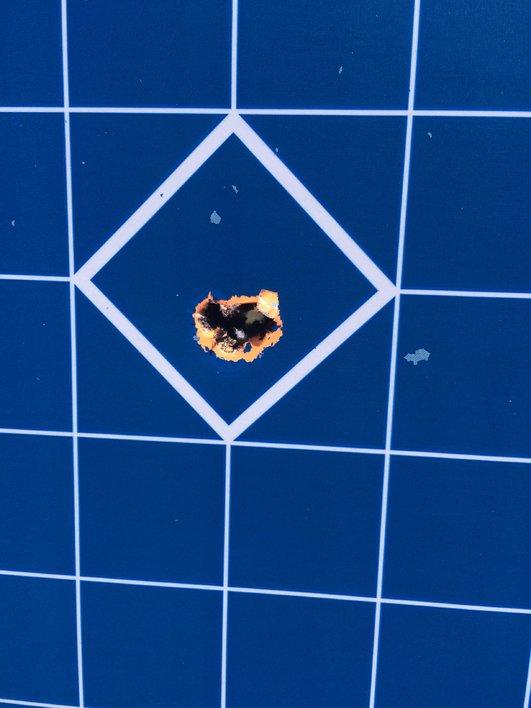

Thought I'd post this here since there was discussion of barrel life. I thought my barrel was toast with around 900 rounds but I shot this yesterday at 100. That's five shots. Note, I shoot without stopping so much so that bullets will discolor sitting in the chamber. I can actually smell the heat.
That looks well within "minute of coyote". Have you tried any of the new Lapua 6.5cm brass with the small primers? I have sized a box of it down, but have yet to fire form any. It should allow a guy to lean on it a little more.

I worked up a load with 22-250 brass that had been fired in the 22 Creed with 39 grains of R26 and a 77 TMK. With a CCI200 primer I got the following with an 82 grain Berger. All with R26.
47 grains and the case was full. No pressure signs.
46.5 grains - 3589 FPS, SD 9.
46 grains - 3561 FPS, SD 6.

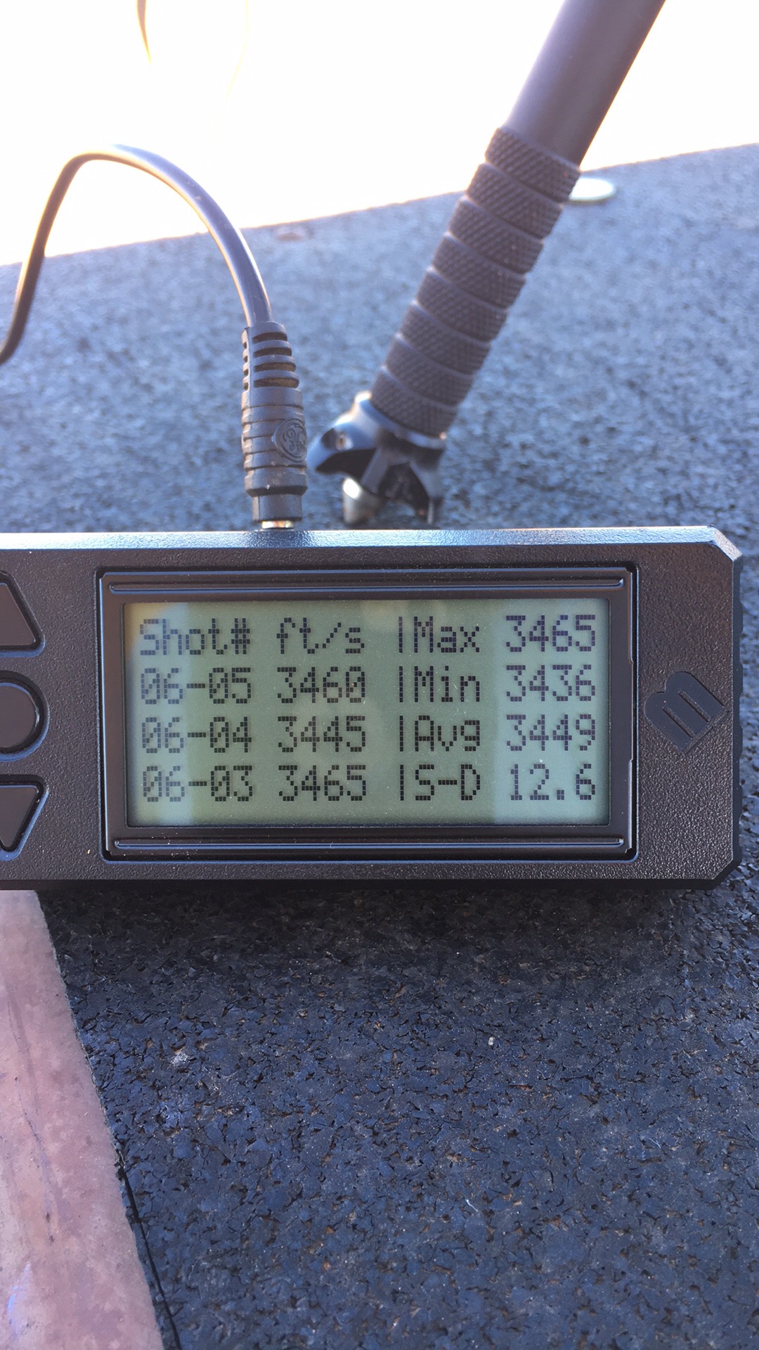

Hornady 6cm brass necked down to 22
H4350 42.2 grains
80.5 Berger Fullbore
24" 1-8" twist #3 Rock Barrel
shooting suppressed
Fed Large Rifle Primers
3440fps

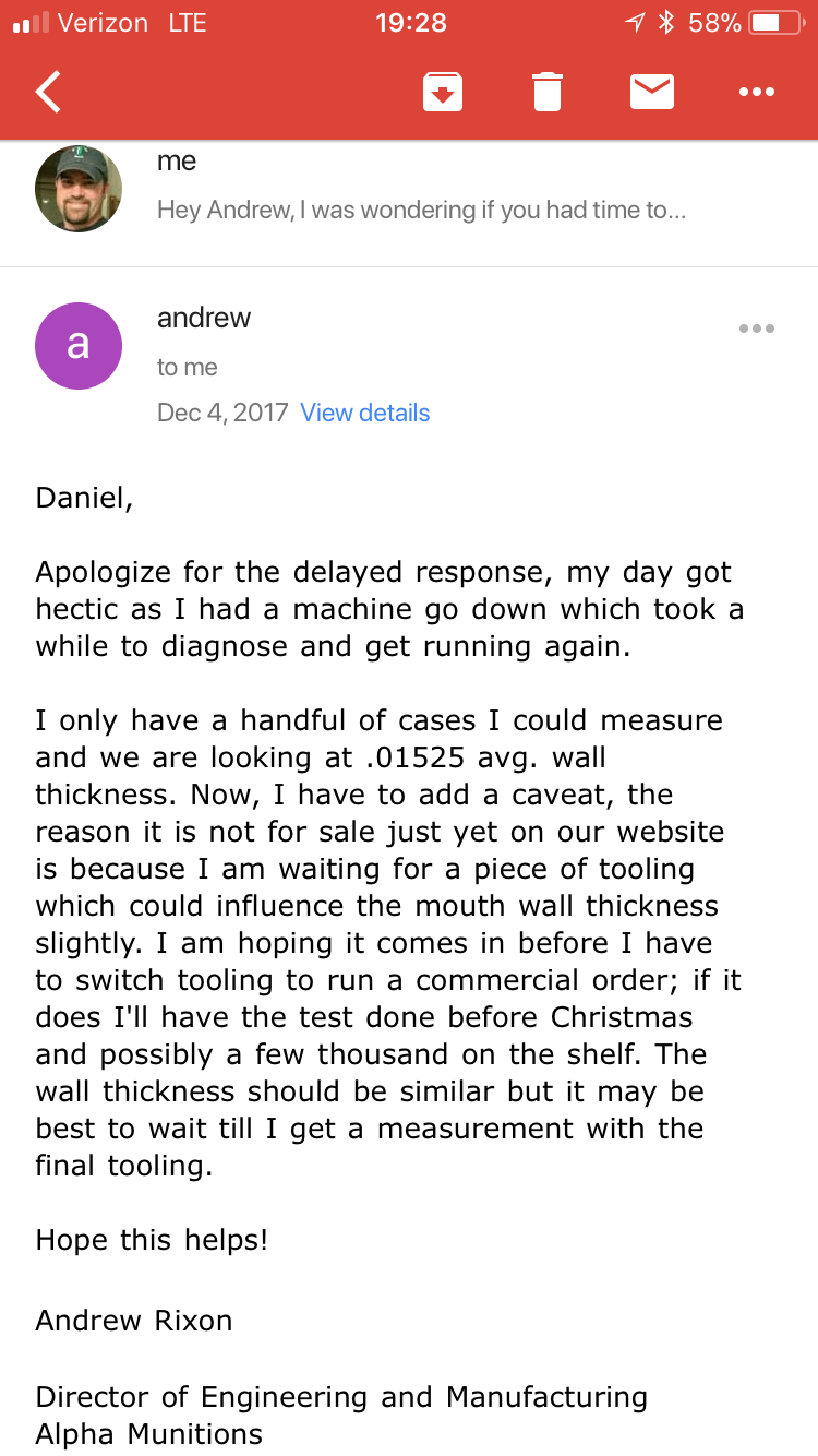

I got an update from Bob at Alpha Munitions (alphamunitions.com). They plan on having 22 Creedmoor brass by the end of January. I use Lapua in my 22-250 and making it into 6.5 Creed was a disaster. I think I over cooked the cream of wheat. Now fire forming 22-250 Lapua into 22 crdm is a different story, that is some great brass. The choice will depend on the individual user and the quality of Alpha brass. I can not speak to the virtures of Alpha brass, but I haven't heard any complaints about their other offerings.
