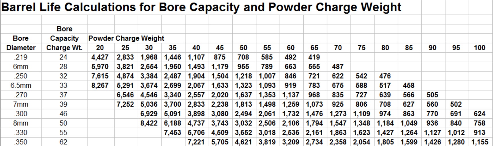

With all that info I don't know why anyone would decide against a build. Still would like to get estimated barrel life in the 70-90 gr bullet range so that I can see whether I buy a proof carbon or not.
